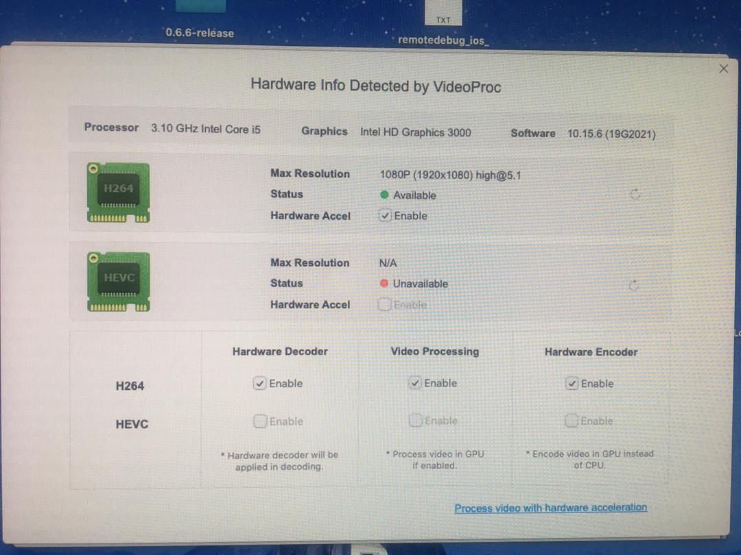

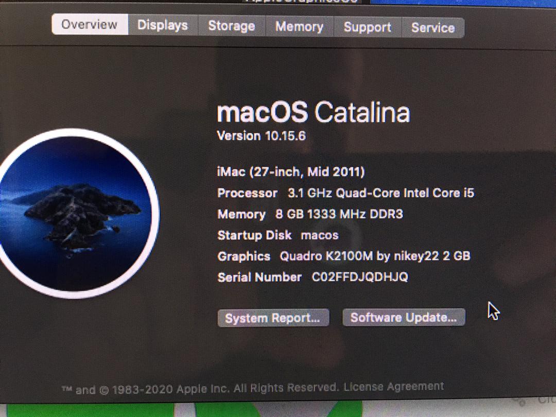

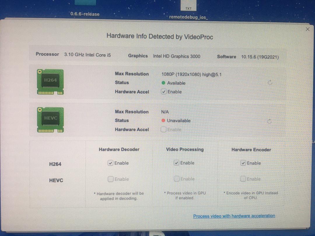

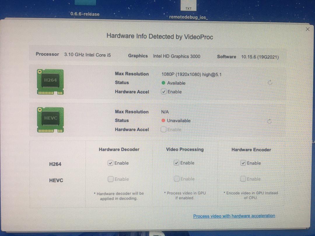

Please help me.
imac 2011 27" gpu upgrade to nvidia quadro k2100m with elpida memory falshed by nikey22 .
how can fix ( HEVC ) acceleration problem ?
I have tried all the installation steps.

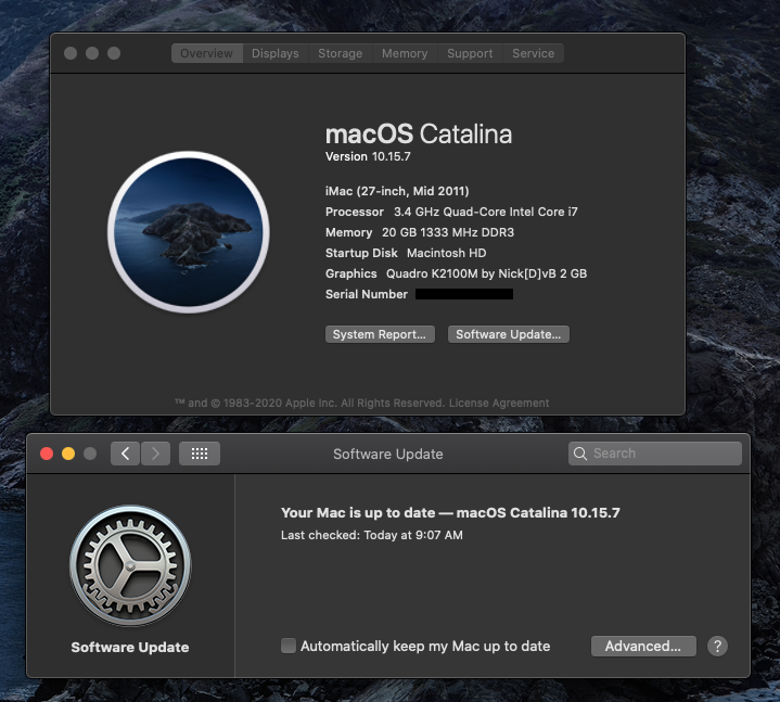

Quick question: after spending a couple days trying to get Big Sur to work, I finally gave up and installed Catalina on my 2011 27" iMac. I followed the post 1 instructions and everything went smoothly with no issues and it's all working perfectly now. Except I got a notification right away saying there's an update for Safari 14.0.3 (it's currently running 13.1.3). Is this a safe update to run since it's not a system update? If not, is there another way I can update Safari? Thanks!
Just in case anyone else has this question, I found an answer on reddit. It's safe to use the system update to update Safari. I just did it and it worked normally.

Why do you think this Nvidia Kepler GPU is capable of doing HEVC?
Check the first post Nvidia and AMD section, again.
I do not know what HEVC is !😯
I just want to have graphics acceleration under Catalina .
currently it is not possible to use Catalina . extremely poor system performance. 🤯
how can fix it ? 🙏
Check out the first post how to install Catalina avoiding the legacy video patch.
Nvidia Kepler cards do not offer H.265/HEVC. But this is not your problem. You missed the entire information about macOS updates.
