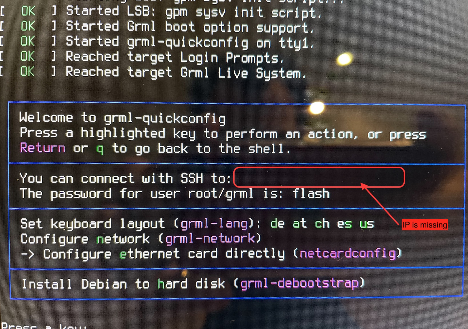

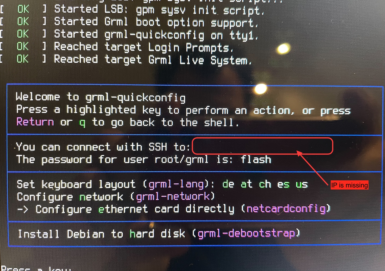

Sorry Ausdauersportler, but no-one said that DHCP is not activated by default. I am convinced DHCP will work on xanderons boot stick in most cases. But in my case DHCP boot automation doesn't work (maybe network setup or whatever). And I strongly believe there are others also getting stuck at this point for some reason. I found some hints here in that forum. I tried different USB sticks, iMac is always connected via ethernet and I never changed configs on xanderons boot stick. And of course, I waited plenty of minutes to give GRML more than sufficient time to boot completely (went out with the dog i.e.). Situation is still the same and I can proof this easily by looking at GRML on internal display and keeping an eye on router information, only coming up for GRML by using key strokes described. This is not meant to confuse somebody and I really appreciate this thread and all the good work and information, especially your work Ausdauersportler (I am following you for good reasons). I am just glad to help Kranny36. I don't need to get this information on page 1 or in xanderons post.View attachment 1731970
Hello, I think I have the same problem. I am unable to update my iMac 2011 via ssh command after installing the new AMD 4170. I am not able to update the bios because no IP is assigned to the iMac. I have tested my USB key several times and it works on other computers. The router is configured with automatic DHCP and all other devices are correctly recognized with assigned IPs. Anyone able to help me? Other solutions to update the bios? Other solution to receive an IP from the router? Thank you

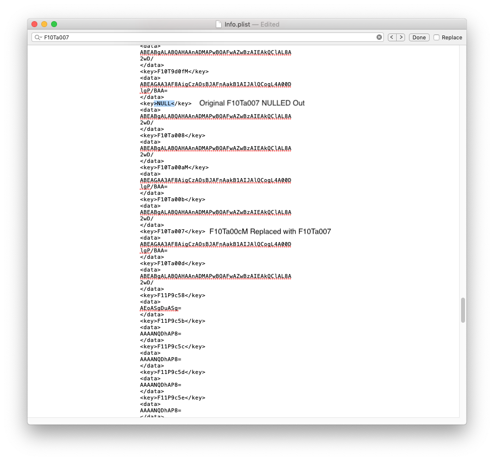

The following guide will work on any MXM swapped card that has Brightness control enabled either through OpenCore (K2100m/K1100M) or Natively (K4100M) doing so allows for the Native Apple kext to be used and Not AppleBacklightFixup.kext

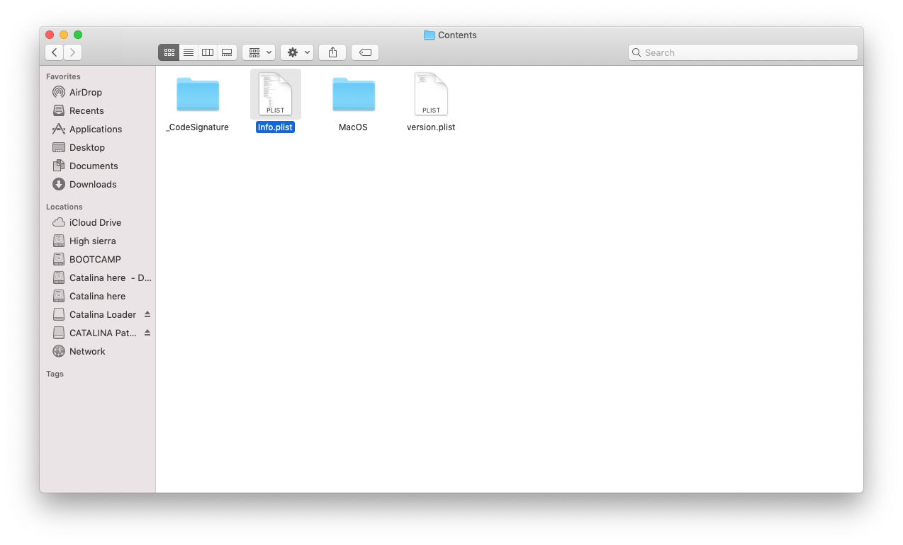

Here is a short guide on how to create your own AppleBacklight.kext for the 27” 2011 (F10Ta007) iMac. The same could be done for the 2010 iMac (F10T9cd7) and 2009 iMac (F10T921e)
1. Navigate to /System/Library/Extensions, find the AppleBacklight.kext and drag it to the Desktop.
2. Right click on the kext to show package contents open contents/info.plist. with TextEdit.
3 With info.plist Open in we need to Find the original value “F10Ta007”/“F10T9cd7/“F10Ta007” and NULL it out, This value is based on your iMacs Display year/Model. Enter Null or whatever value you want here.
4. Now to Fix Brightness we need to Replace the screen Value to the one that belonged to a 21.5” iMac, this Value is F10Ta00cM. Find this value using Find in TextEdit.
5. Replace Value F10Ta00cM with the one for your iMac’s Display model, I’m using a 2011 27” so the value is “F10Ta007”
Code:
<key>F10Ta007</key>    (2011 Model used)
<data>
ABEAGAA3AF8AigCzAOsBJAFnAakB1AIJAlQCogL4A00D
</data>
Make sure your Data entry looks like this one above. Save info.plist

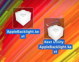

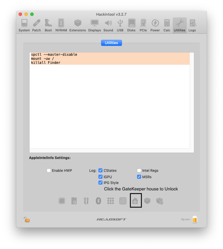

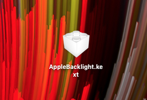

6. Reinstall AppleBacklight.kext using kext Utility. Catalina users need to Unlock their System Partition using Hackintool first.
View attachment 936408. View attachment 936409
You should Now have proper (2009-2011) 27” iMac Backlight stepping that will properly Dim and raise you’re LCD to full brightness.

I see you have a 21.5" iMac what size MXM card did you fit into your iMac?
Dear highvoltage12v,
Thanks for the amazing work! Can I check if "2009 iMac (F10T921e)" was a typo? Because I cannot find the key F10T921e in the plist. Later on you mentioned the following:
Do you mean that we can just treat the display key for 2009 iMac as F10Ta007?
Thanks!
Thanks!
Hi!
I wonder how you guys dig this post out of 10.000 others. From my current understanding the AppleBacklightFixup.kext has included these kind of patching. For that reason it has been included to all OC packages and I guess to all installer packages I provided for Sierra&HighSierra/Mojave/Catalina , too.
Once in a while we find a rare white unicorn, i.e. a new display type that has not been added there. In case adding the AppleBacklightFixup.kext to your installation does not fix the max brightness issue your have likely such a display.
What was you question exactly?

Reset the connections from your router and clear the lease table to make sure you are not interfering with other devices. The reality is you have to deal with your network and hardware problems yourself. Nobody can patch this remotely away.
