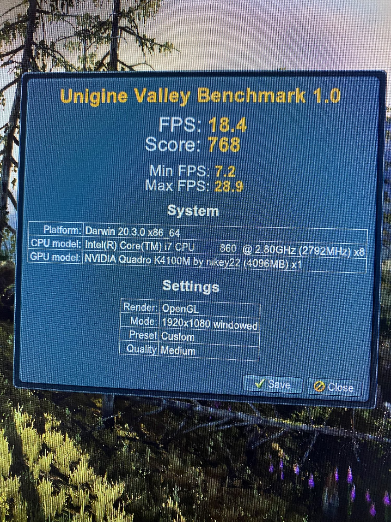

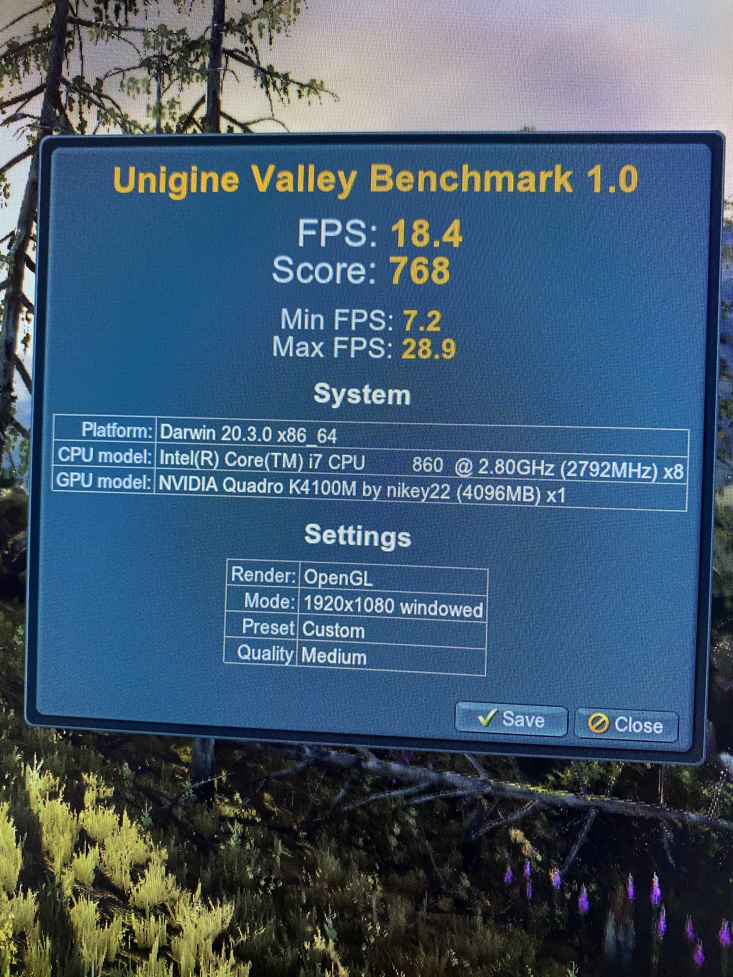

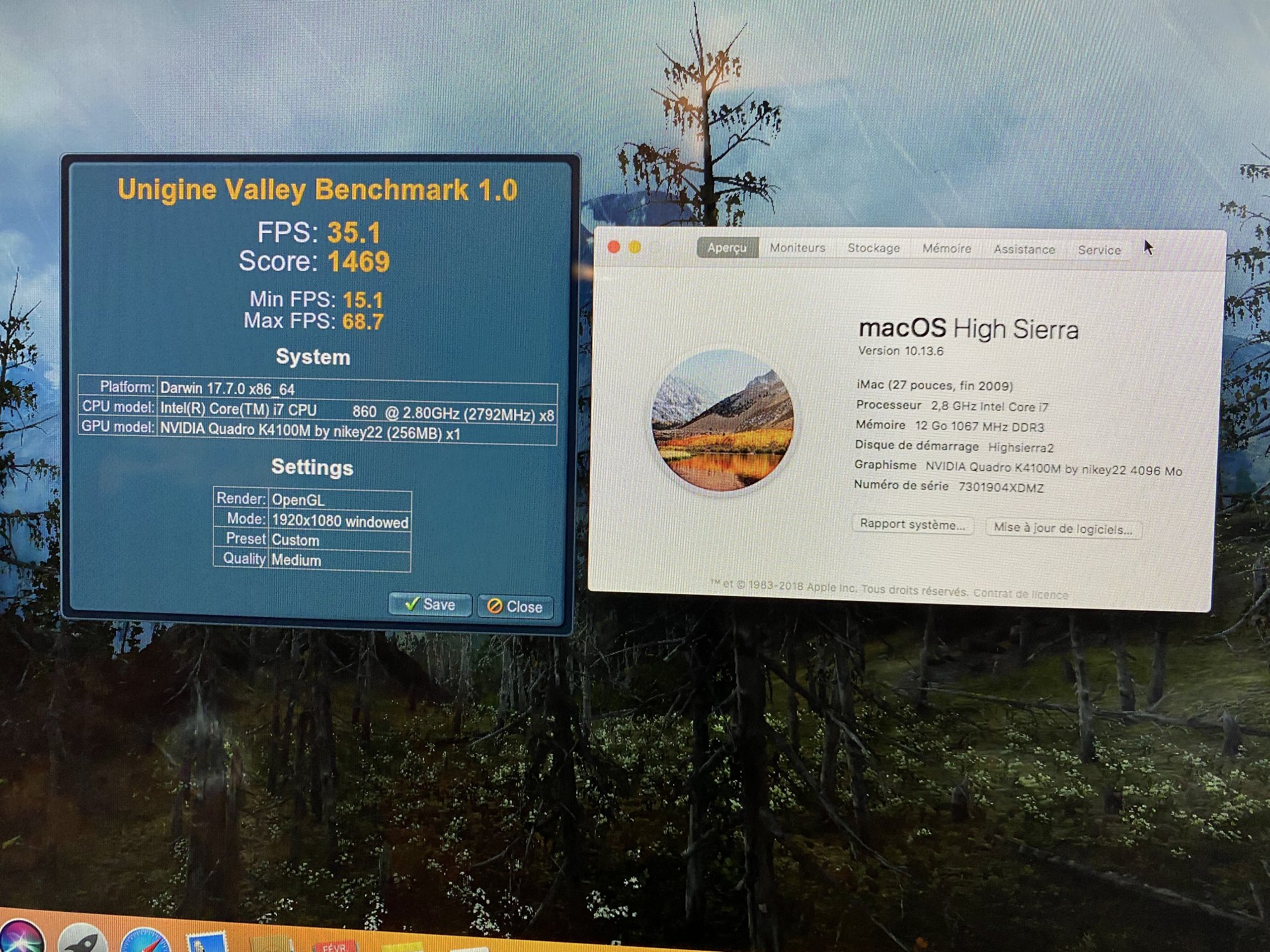

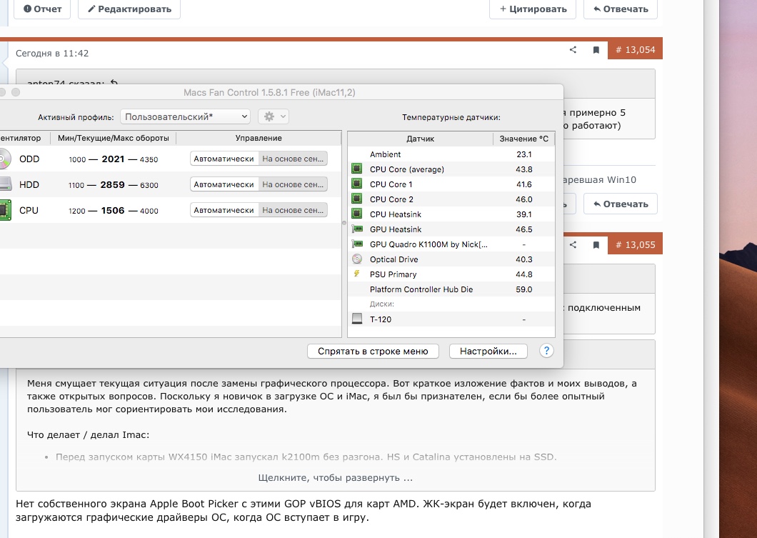

Why then do others (with the same I7860S processor and 1100M video card) have about 21 FPS in the Valley. Do I have about 5 FPS? What could be the reason? (Bootrom: 99.0.0.0.0, SMC ver: 1.64f5, BOOT SCREEN and dimming fully work)
What are your temps like?

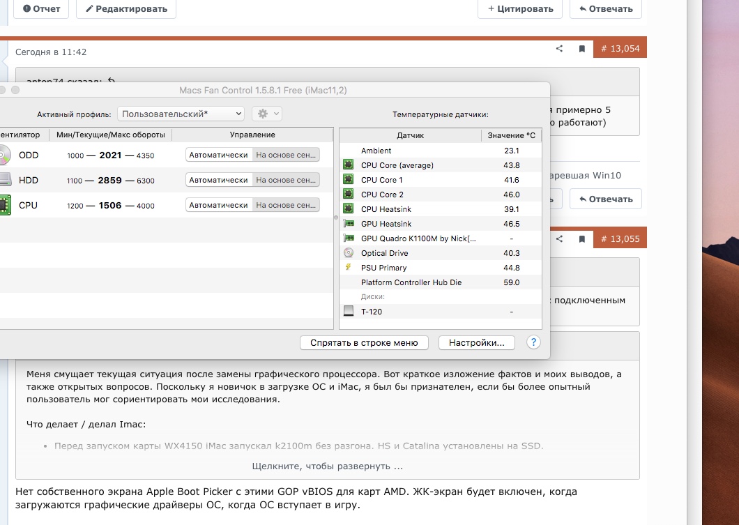

Have you run AHT or ASD? A damaged or disconnected sensor will cause the system's CPU to throttle.

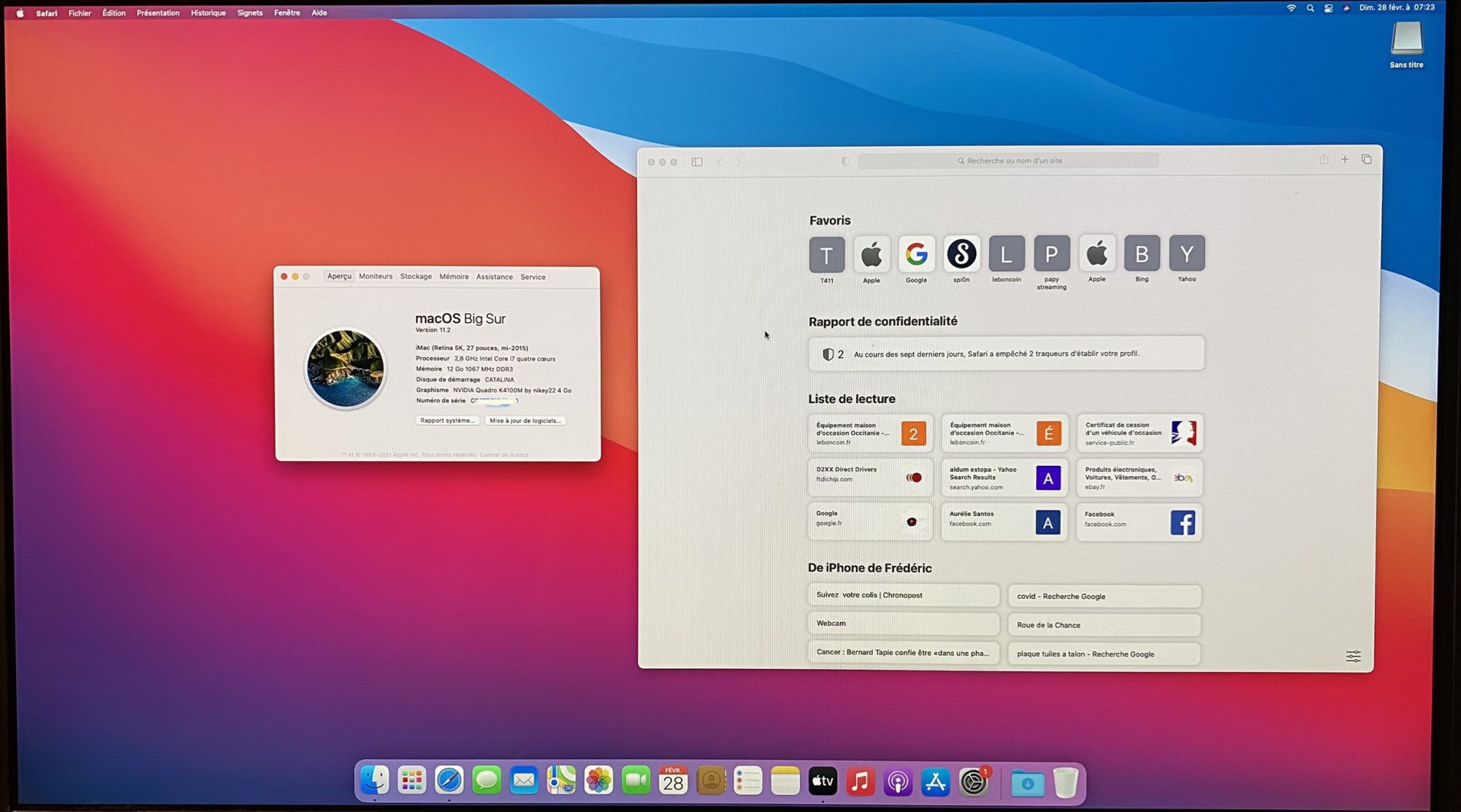

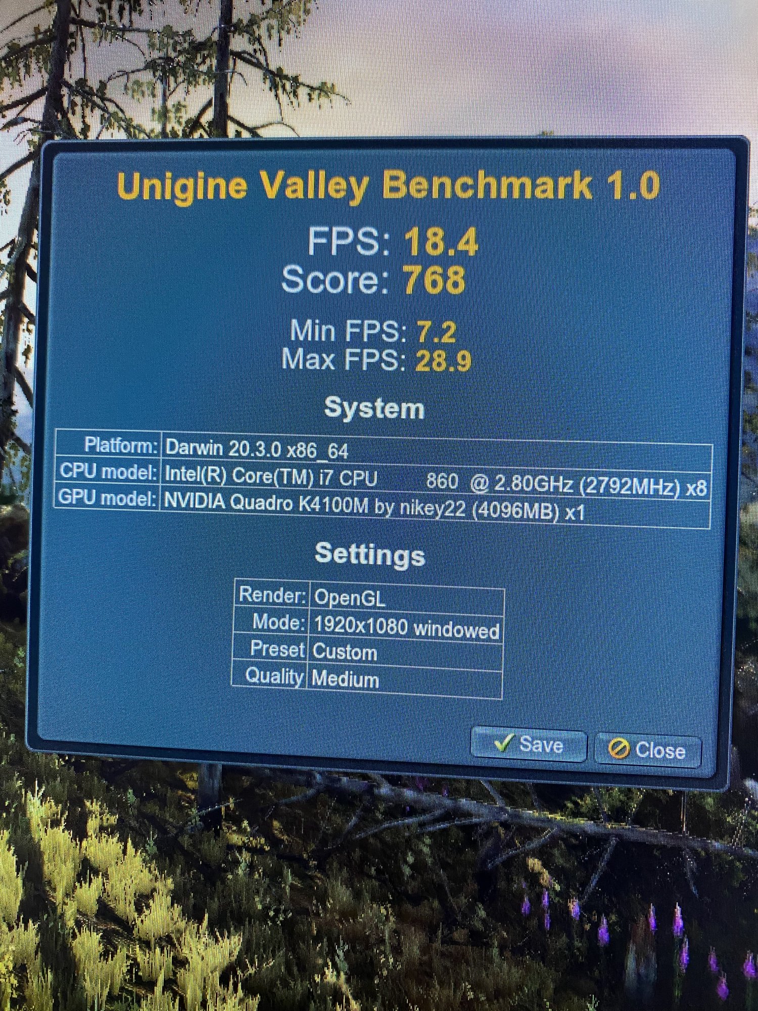

Hello,
I succeeded thanks to ausdauersportler to install BigSur on my imac late 2009.
i used opencorelegacypatcher.
however the bluetooth works very badly (I only managed to connect my mouse once) and the sound also works badly (it looks like there is only the treble)
are these problems known?
thank you
edit:
the mouse seems to work
the sound always the same problem
I have a score of 728 in the benchmark valley when I should be over 2000

OCLP is the single option you could have picked with no sound or only lame quality via VoodooHDA.kext - which sounds terrible.
About the Valley Score I cannot help right now, have no 2009 system running right now. But my NVIDIA cards all work well with each Big Sur installer/patcher option.
Ok, thanks for the response
I thought OCLP was the best solution for my setup, so I'm going to attempt a forked install of the micropatcher, and hopefully that will solve my graphics performance problem.
here are my scores under HS and BS it's weird valley tells me that I only have 256mb of ram

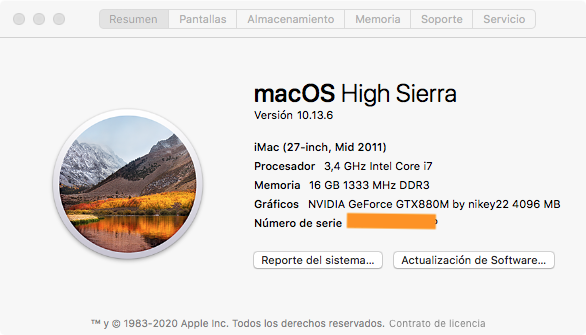

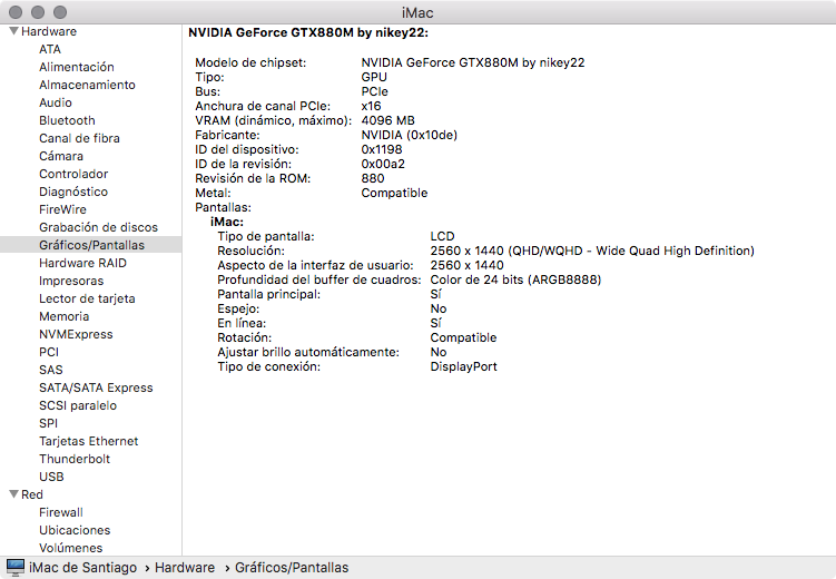

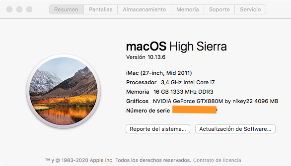

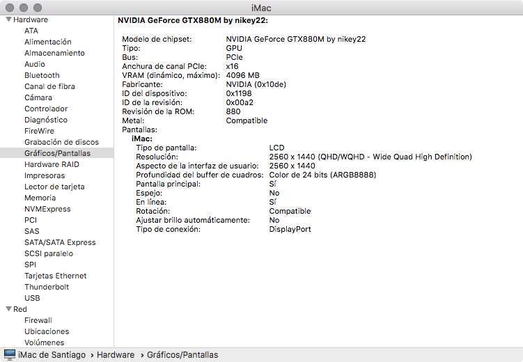

Hello i have a question I successfully upgrade to a gtx 880m but about this Mac is showing 4096 VRAM available instead of 8192. Did this card have such version or its an error? Thank you in advance
Yes. I believe there are 4GB and 8GB of GTX880M. You should know the VRAM size before purchasing it.

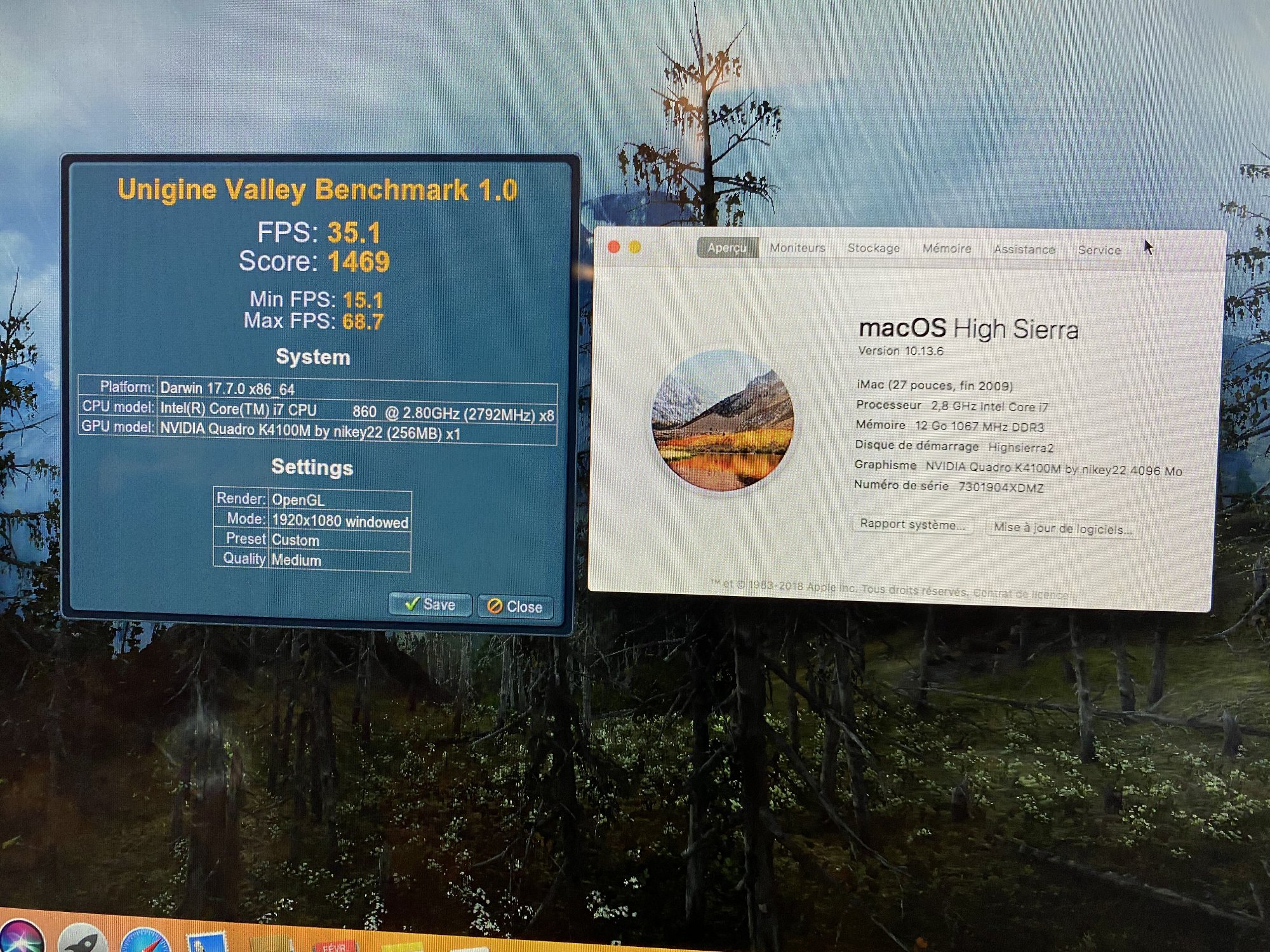

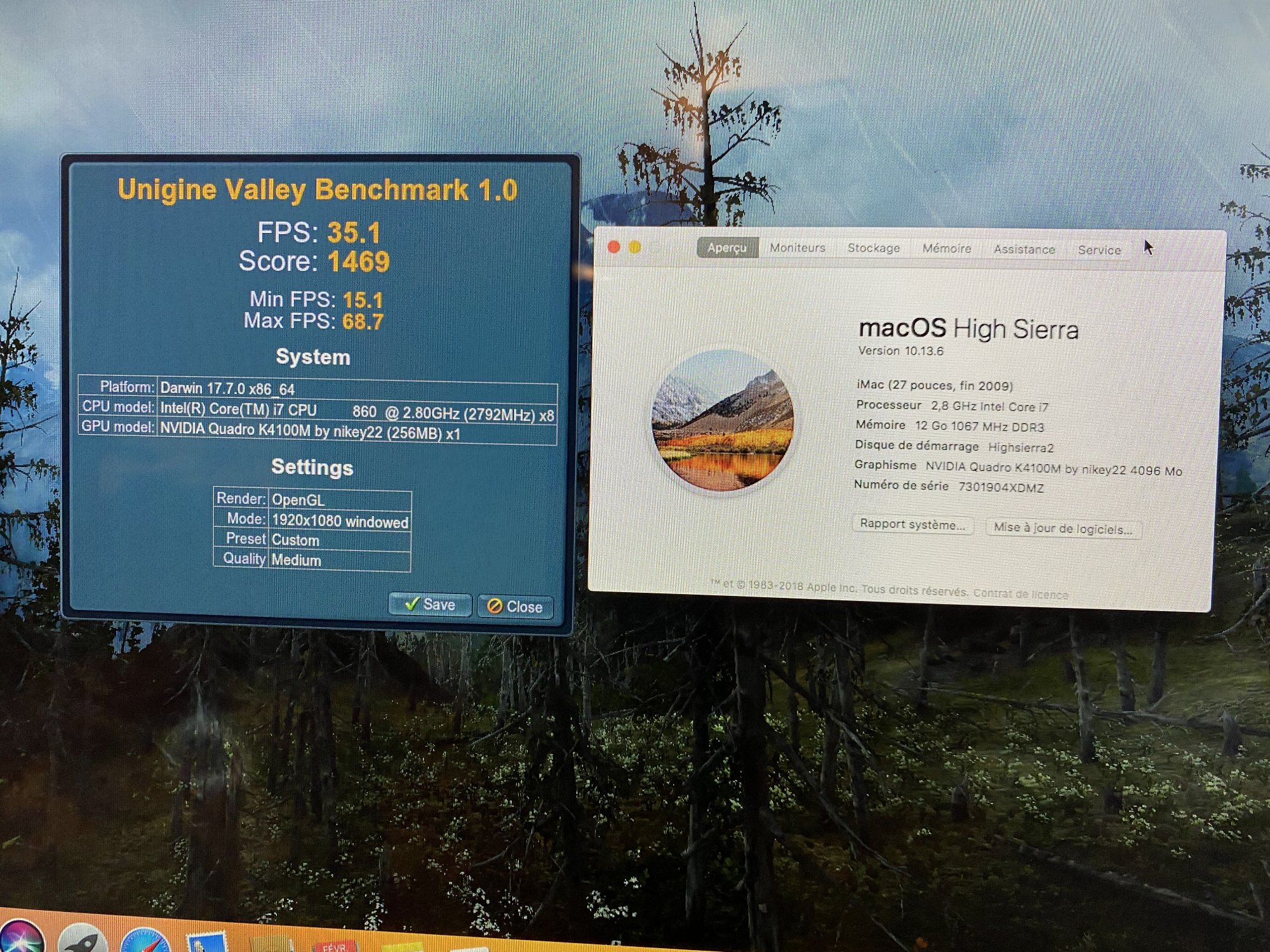

View attachment 1736710View attachment 1736711
256MB VRAM is just a Valley bug in HS. It will be shown correctly in Catalina or BS.

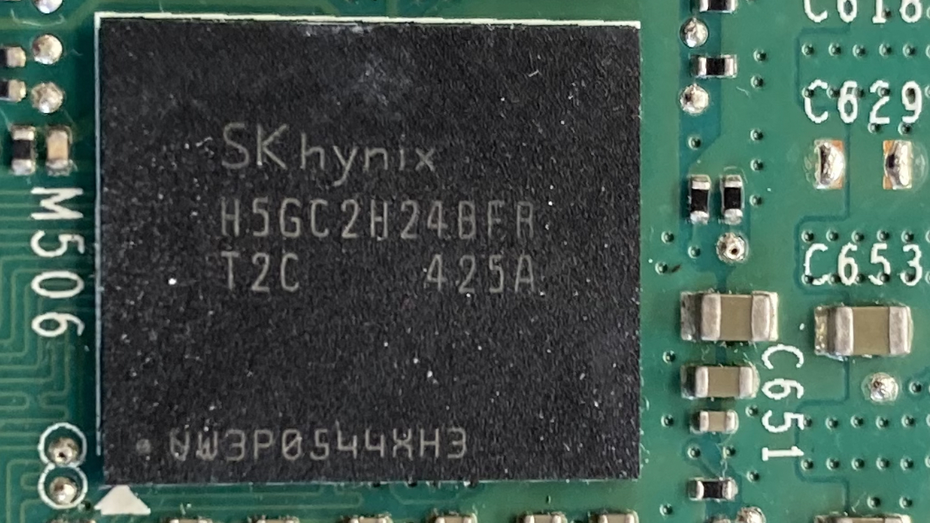

Good point! I'm sure they do. Some manufacturers cut cost by using cheaper vram. I've never had issues with Hynix vram, but there are different die-generations that have given us some troubles in the past (-AFR vs. -BFR). I'm starting to see issues with various manufacturers, which is I think why we should start to stick to baseline boost for TDP, mem etc. Samsung vram seems to be able to handle more overclock. The Elpida latency definitions are not even found in all roms! I've had to add them in recently.

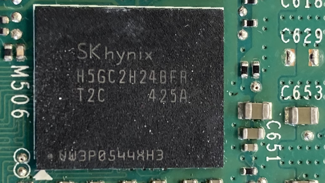

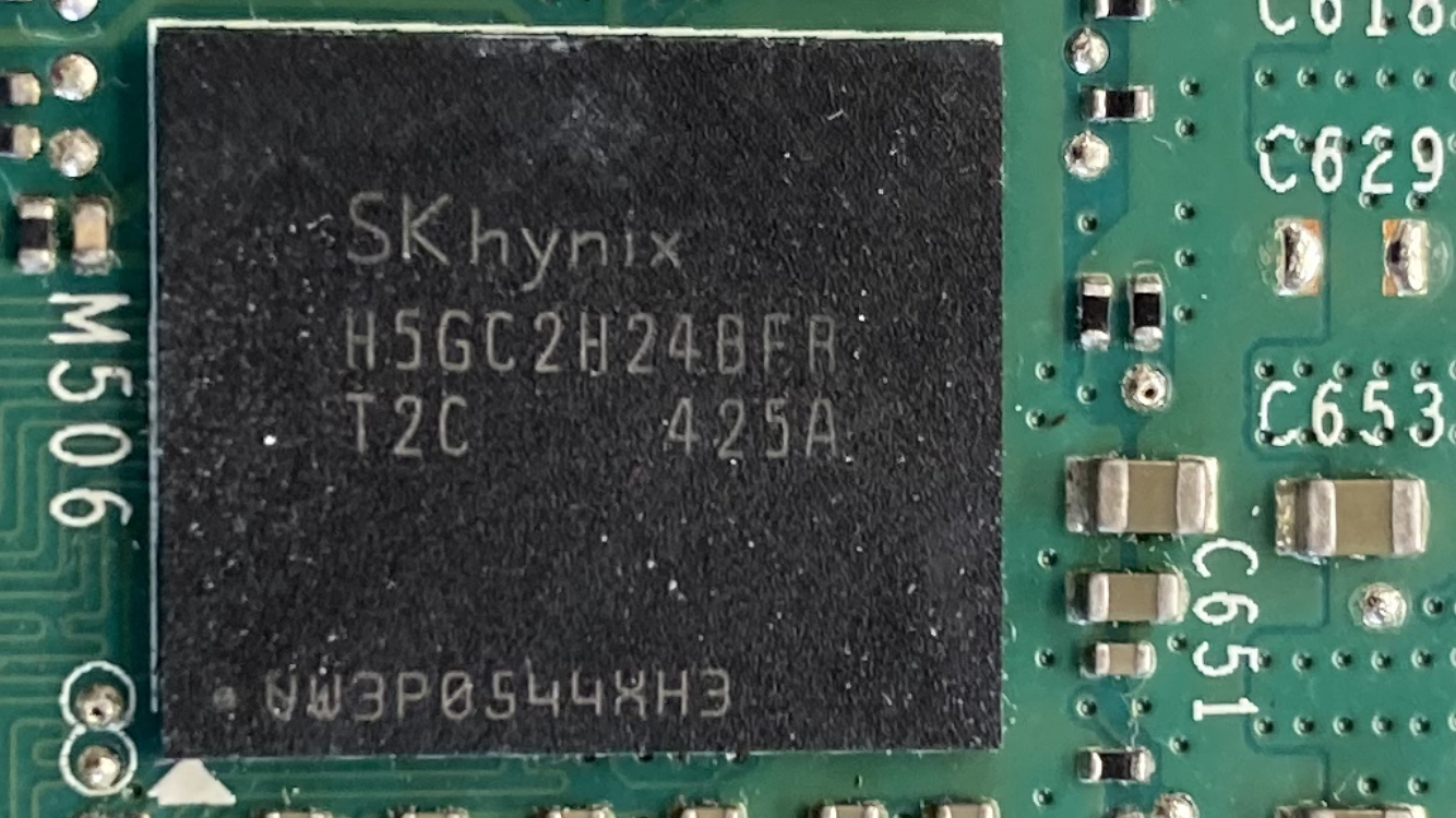

Ok, after testing my 780m over the weekend, I can confirm the new BR3 rom works like a charm 🙂
With previous overclocked BR2 rom I get (in Catalina) kernel panics after ~15 minutes of heavy stressing with Unigine Valley at high or ultra settings, but with the standard clocked BR3 rom I have been unable to make it panic, not even after 2 hours of running non stop at ultra settings: temp of GPU Die stabilizes at about 75º sometimes peaking at 80º, and odd fan runs at full speed, but no panics at all. Gpu heatsink stays below 70º.
For reference, my 780m card came with Hynix -BFR memory: H5GC2H24BFR
