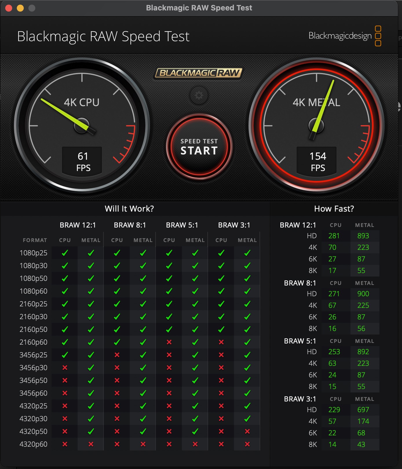

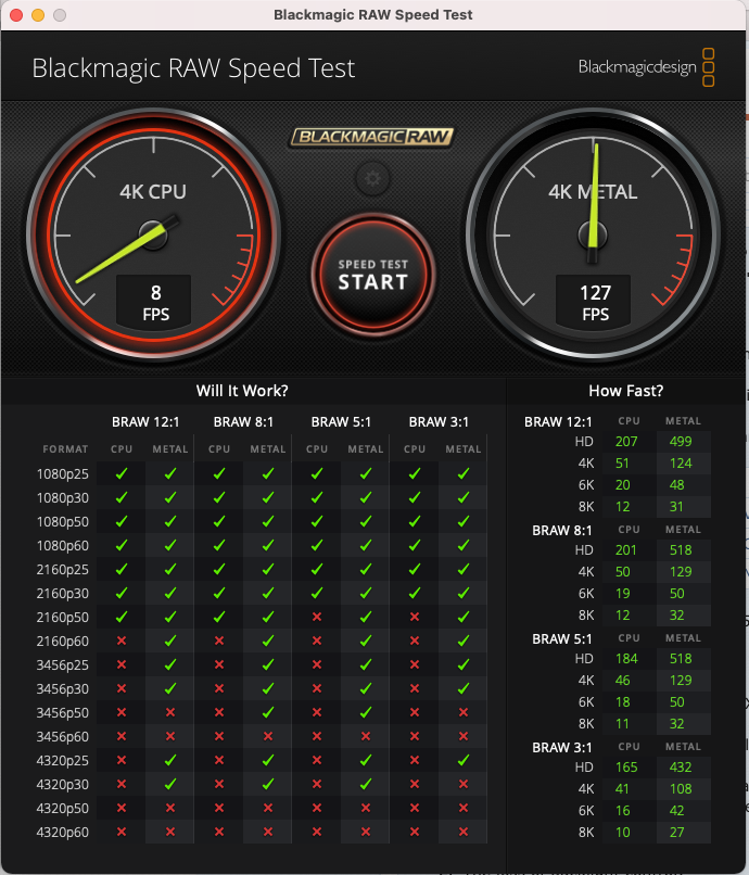

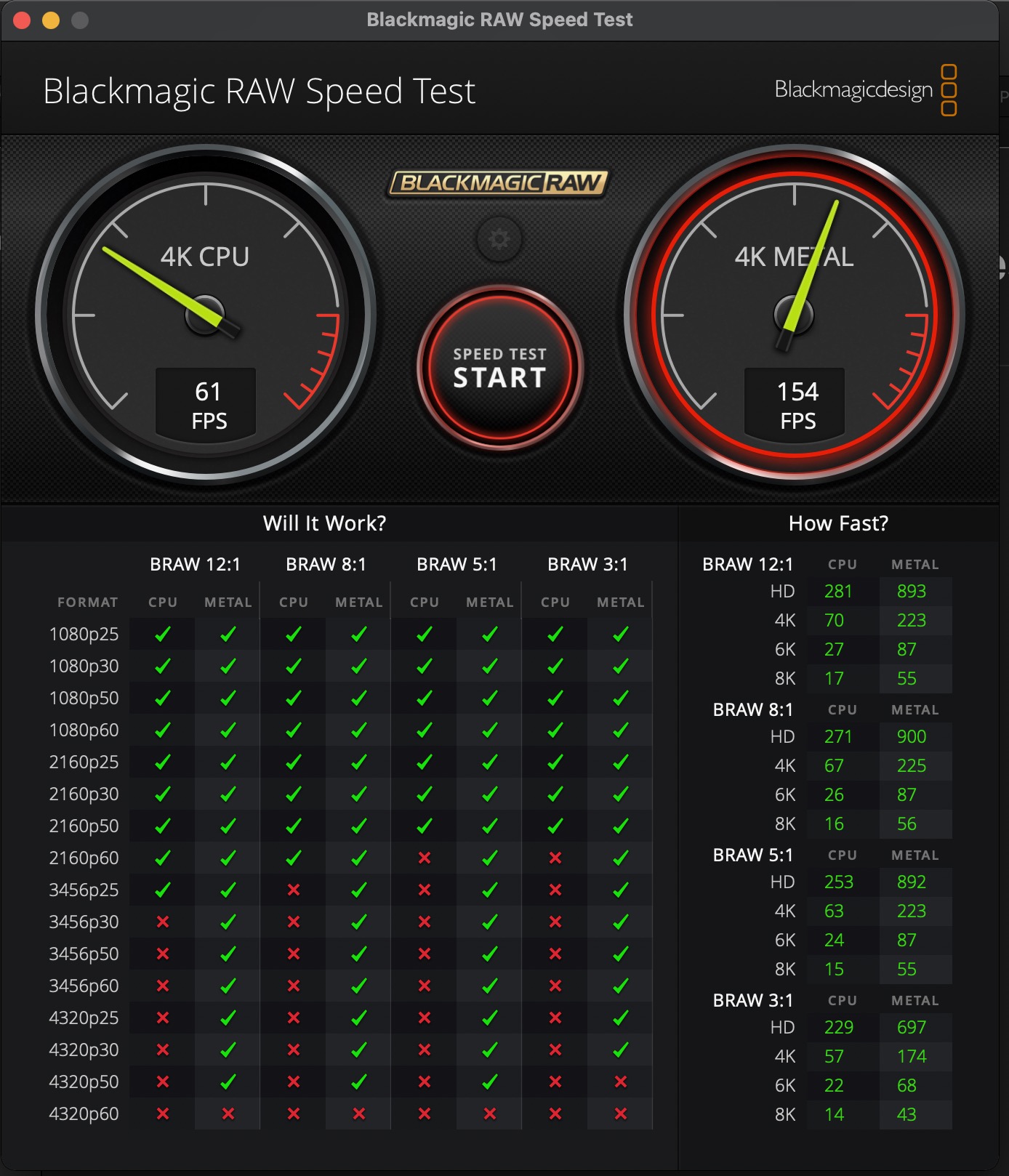

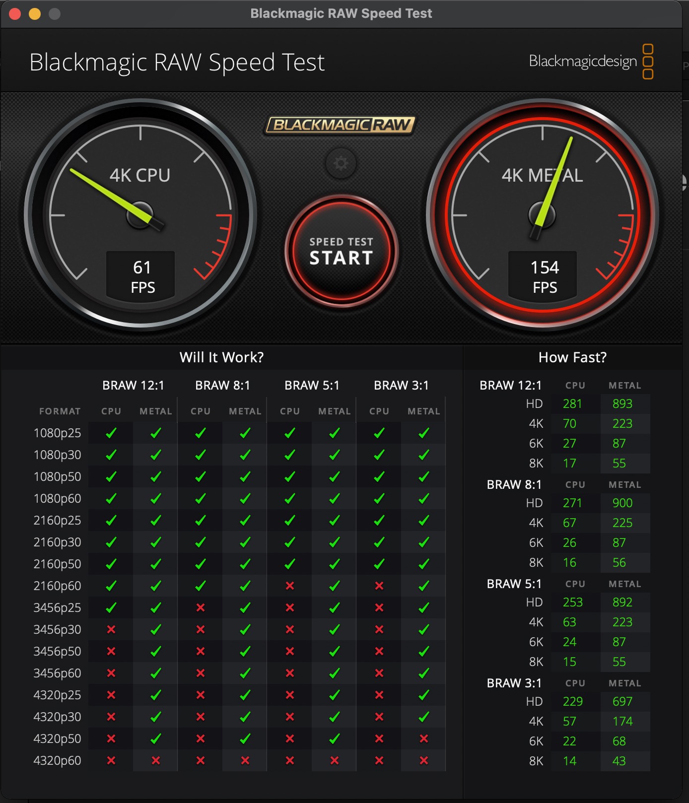

Lately I found this little tool to measure the video encoding speed of the AMD GPUs and my oldest son got finally his new MacBookAir M1...attached you will find two pictures of the M1 and iMac12,2/WX4170 performance in this area, not too shabby 🙂
It measures the ability of the CPU and GPU to perform in video encoding of different screen resolutions and frame rates. Of course not the ultimate benchmark, but we are talking about GPU performance all the time.
BTW:
All the AMD GPU known here (WX4130/WX4150/WX4170/RX480/WX7100) perform in this benchmark nearly on the same level.

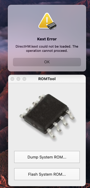

The operating system message: "kext error DirectHW.kext could not be loaded.The operation cannot procceed"
What did I not understand?View attachment 1737235
when I click on OK the software closes
it's nice to create software but spending your time denigrating beginners like me is less so
Hi there,
I had a similar problem. Tried the solution that @Pascal Baillargeau suggested but it didn't work for me.
Eventually I found the solution in another thread: I used Appcleaner (you can google it) to remove RomTool completely and then reinstalled it. After that it worked flawlessly every time.
After reading more in the other thread, I found that the culprit was an antivirus I was running on my iMac (Catalina 10.15.7) at the time, so I'd suggest you check that, too.
In my case, I uninstalled the AV software, then removed RomTool with Appclieaner, and that fixed the problem.

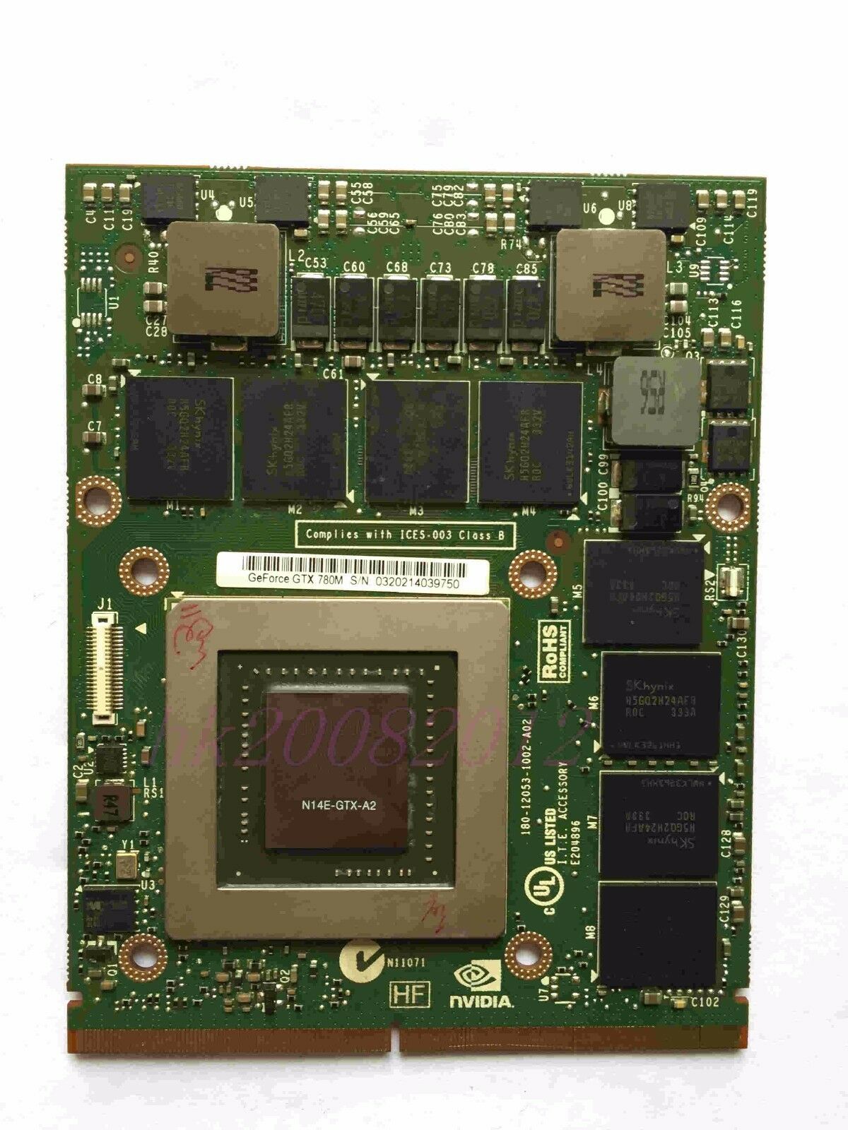

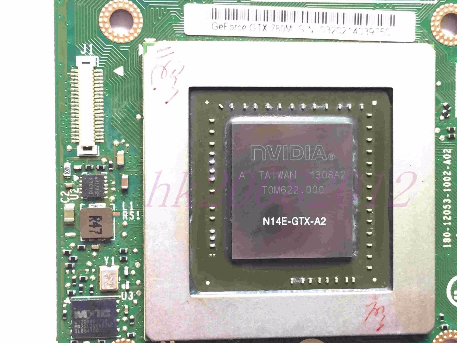

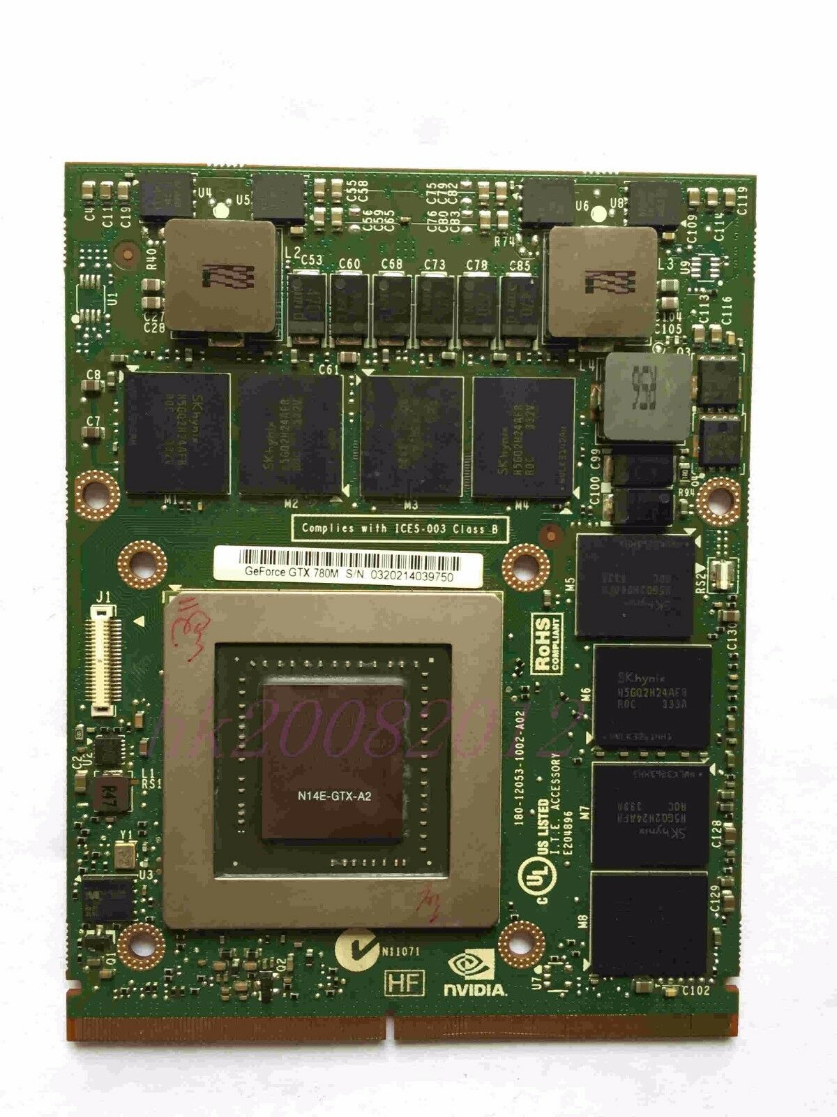

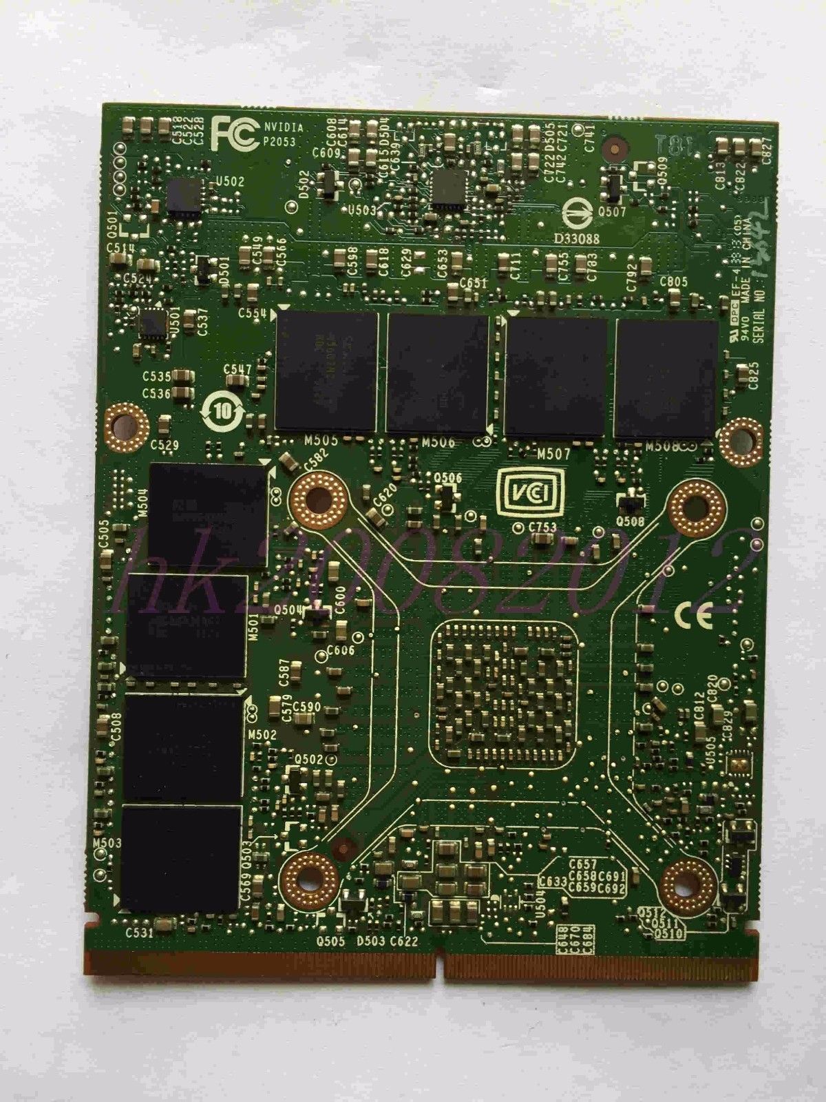

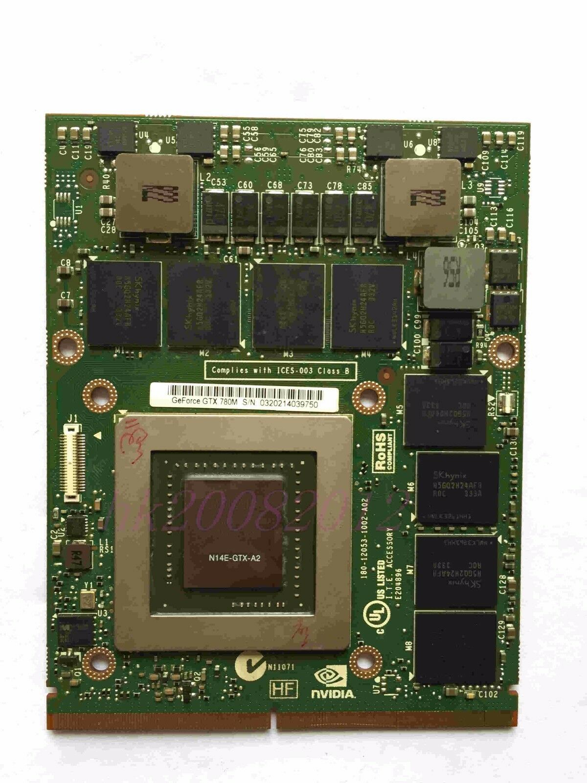

Hello everyone,

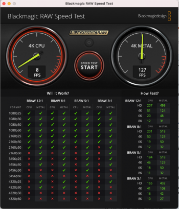

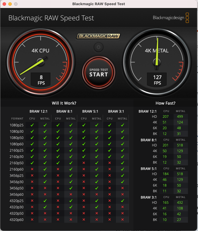

I've upgraded a time ago the imac mid 2011 with an AMD WX4150 and i7 2600 CPU. I use Mac Catalina OS (It's more stable for me and sleep works well).
All seems to work perfect except Final Cut Pro X: when I try to export to Facebook (H.264 codec) it shows an error and no export is possible (only Master export).
I've upgraded Opencore to 0.6.6 Catalina Loader but no success.
Anyone with this error?

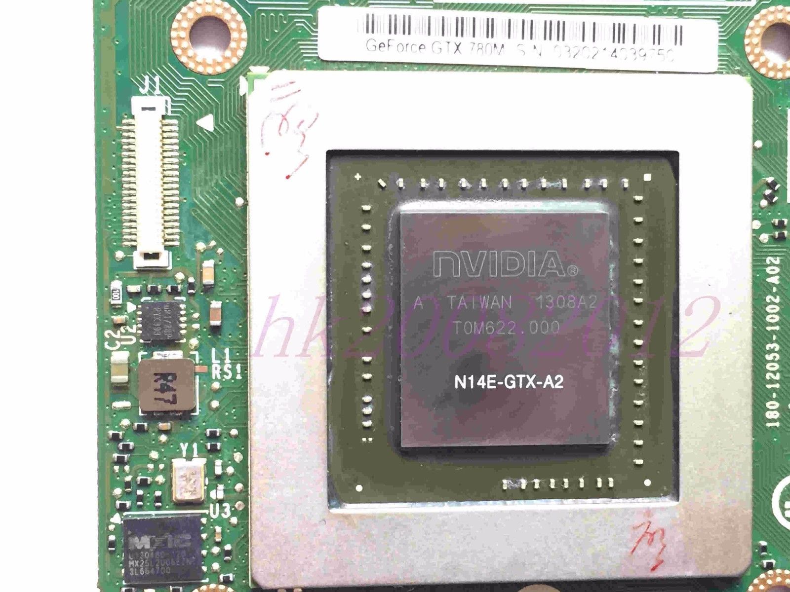

I installed 11.2.1 with BenSova/Patched-Sur, on iMac Mid-2011. Everything works with upgrade Nvidia 780M - vBios 780M_EG2.rom
I don't use OpenCore at the moment.
With 780M_EG2.rom, I don't have the boot screen, but the possibility to select the boot disk (Alt-cmd) and no possibility to adjust the screen brightness (frozen at 100%)
With 780M_BR2.rom and 780M_BR3.rom, I have the boot screen but the brightness is adjustable but the maximum displays 50% of the screen brightness.
Is there a hardware modification to do ?

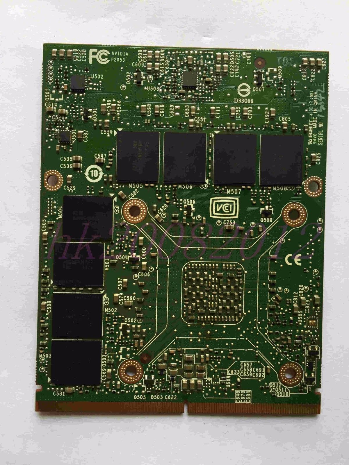

I'm using a 780M card from Dell.
