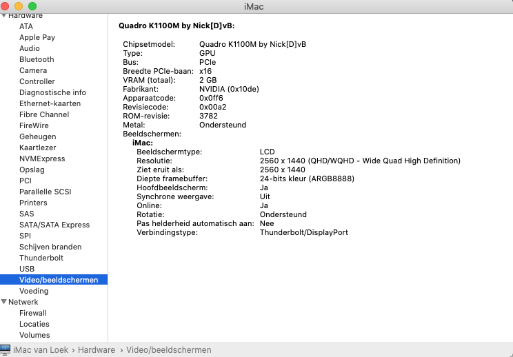

Hello all,
First, thank you all for all this helpful content in this community. Wouldn't have come this far anyway without this thread.
But now I'm stuck. After spending half the easter weekend in testing and searching this thread I'm lost.

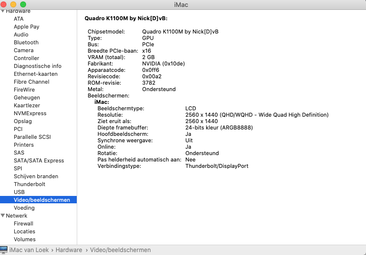

I'm working on two stacked 2009 i7 11,1 iMacs, and the goal is to run them eventually on Catalina/ Big Sur.
Replaced the GPU for an K1100m board, which went fine. Worked in HS natively, no bootscreen nor Brightness.
Flashed the firmware using the SSH client solution, which also succeeded, but ended up with a black screen afterwards.
Went on with the Catalina Loader in order to sort things out.
After hours of swapping SSD's with HS/ Catalina, swapping GPU for an original one I figured out that somehow my output is mapped to the displayport/Thunderbolt, see image. this is why I get a black screen on my mac,but ofcourse an external screen works. Doing a PRAM reset allows me to get in normally, but restart is black over again.
Mounted the GPU in the other system, did a fresh install of CL and ended up with the same issue, so I guess this is stored in the GPU firmware.
How do I change the display default output from displayport to internal?
I used the K1100m.ROM which is linked on the first page.
thanks a lot for your help!

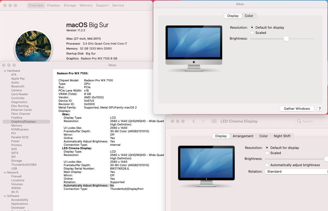

Yes, it is the Late 2009 and the well known total black screen. Since I do not own a working iMac11,1 myself I cannot predict what happens, but I would assume the AGC patch will do the job or this OC mod.

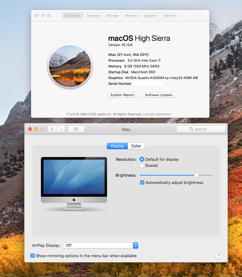

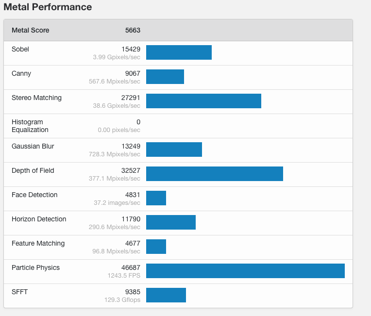

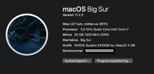

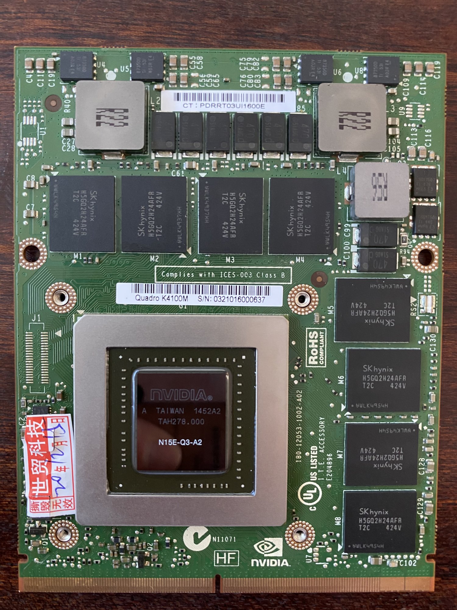

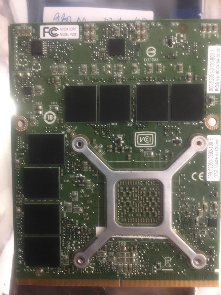

Ieri era il D-day! 🙂
Dopo aver atteso a lungo il mio K4100M è arrivato finalmente.
Quello che mi preoccupava era il tipo di RAM che non era lo stesso per cui Nikey22 ha scritto la rom.

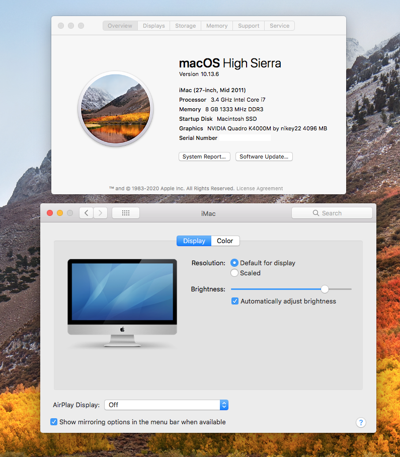

GPU installata e avviata direttamente in High Sierra.

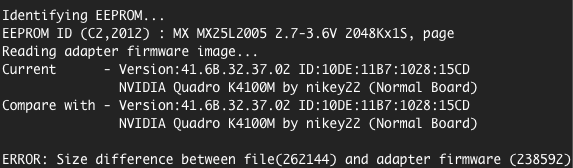

È ora di eseguire il flash ... Ho deciso di utilizzare il metodo di avvio USB e di eseguire il flashing in remoto tramite SSH.
Backup e flash sono andati bene, ma la verifica mostra che c'erano diverse dimensioni della ROM, mi sono spaventato un po 'ma nikey22 mi ha detto che non dovevo preoccuparmene.
Dopo il riavvio ho ottenuto la schermata di avvio e ogni cosa ha funzionato come previsto. Utilizzo dell'UGA (rom overcloccata)
tutto è super stabile sui benchmark e sui video di YouTube 8K.
Non ho ancora avuto il tempo di testare nessun gioco, ma immagino che andrà bene lì.

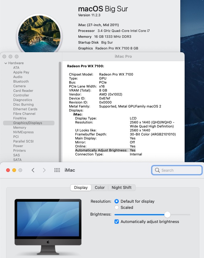

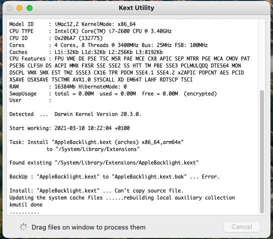

La luminosità dello schermo in High Sierra è stata corretta installando AppleBacklightFixup.kext ma non riesco a farlo funzionare in Big Sur. Ho provato sia AppleBacklightFixup.kext che modding AppleBacklight.kext già installato.
Immagino sia una sorta di problema di sicurezza?

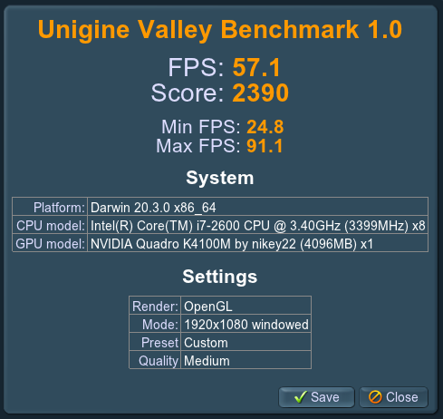

Ad ogni modo il computer sembra molto più scattante con Metal Support e una buona GPU che può togliere lo stress dalla CPU.

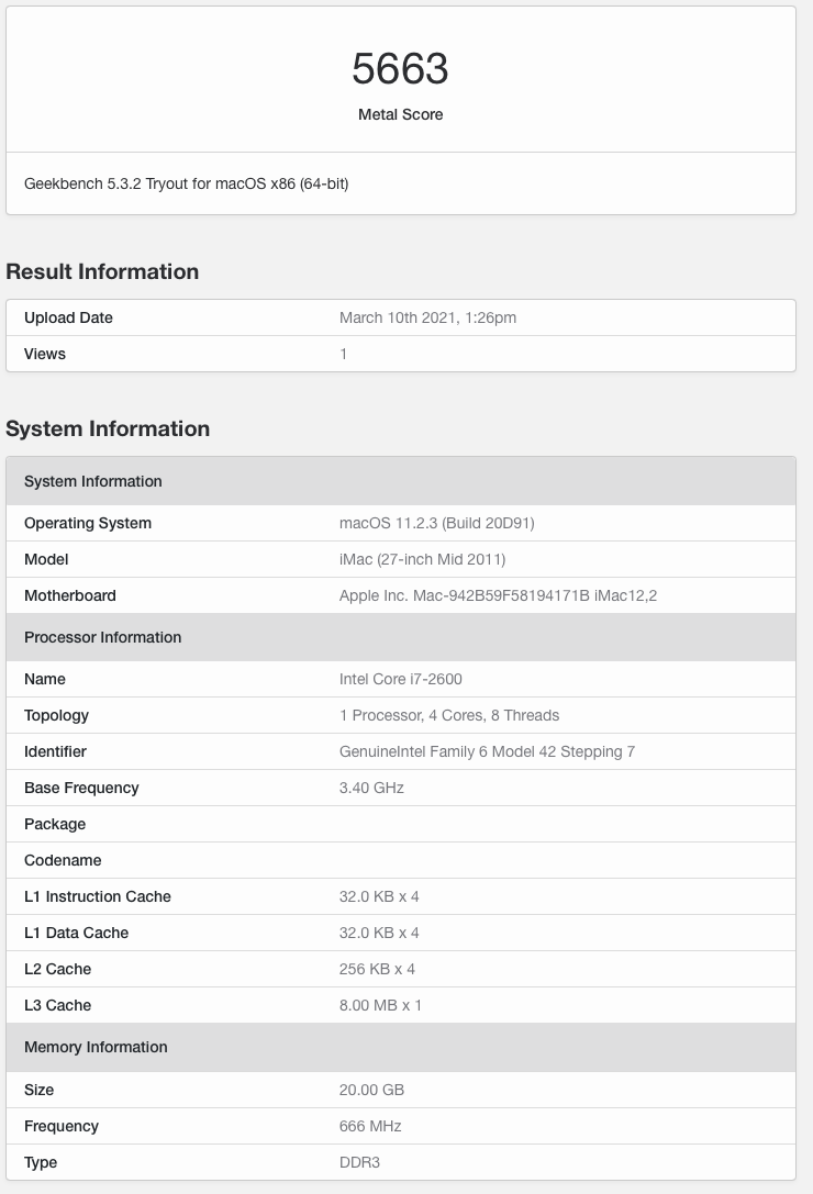

Ha fatto alcuni benchmark per te.
Valley - Antialiasing off
Tutti i benchmark sono effettuati con Big Sur 11.2.3
Grazie mille a Nikey22 per aver reso possibile tutto questo e anche per aver assistito durante la realizzazione del flash!
Quando riuscirò a risolvere il problema della retroilluminazione con Big Sur, lascerò High Sierra per sempre.

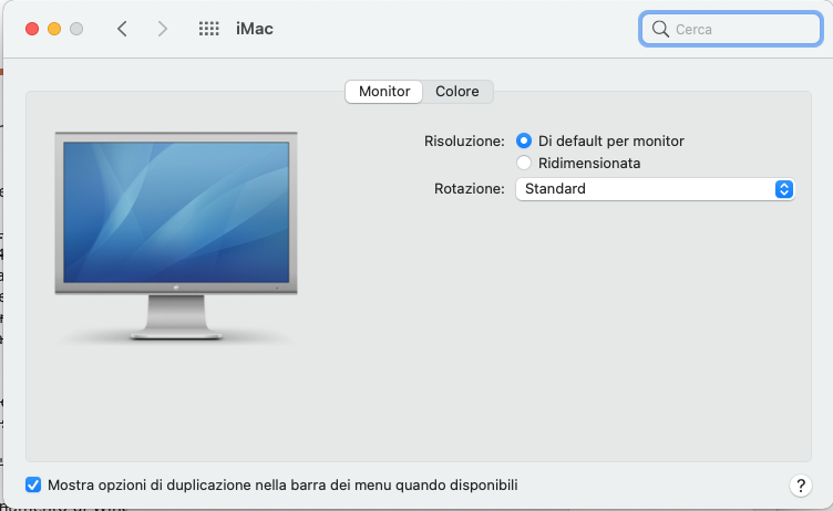

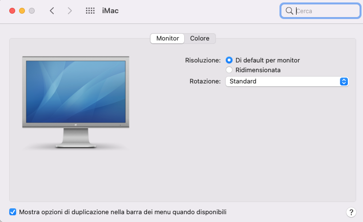

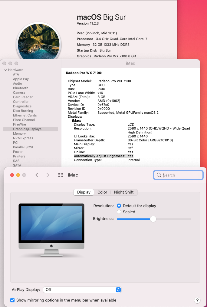

buonasera, dopo aver installato la scheda video k610m ho installato big sur ma non riesco a capire come funziona il controllo della luminosità. Ho provato più volte con la guida di Curtis Gross ma non ci riesco anche perché non riesco a scaricare catalina loader.dmg e non capisco dove siano installati i file di opencore 0.6.8.
Volevo anche ringraziare tutti per questo fantastico forum. Mi ha aiutato molto.
Ask Curtis Gross, he owns all the infos and did all the work you find on this thread. He must know where to find your files. He is the expert. We are just the copy cats.
Well, thank you once again Ausdauer, but some posts are not easy to understand...at least for me. Also Im doing this aside of all my other things. There is no real learning process as i have no capability to understand it properly...Im just goign by the posts and trial and error. Like it is written in the first post...no plug and play...still eventually somebody will step up and consolidate all the info once in a while, bringing it to a new level...
Ive choosen the wrong link. I was going by opencore legacy patcher and hang myself up onto disabling SIP wich i cannot disable without opencore. In the original post by nick no SIP deactivation is mentioned. So far so good....WIll try ecerything out once more when im off work....Thank you!
You would help us and yourself if you could add a signature to your account. This way everybody knows what hardware your have, what goal you want to achieve.
You can use OCLP to generate a recent OpenCore EFI. You can disable SIP using it, too. All depends on what you are planning to do?
But it is far more easy to use the old 0.5.9 EFI and the Catalina Loader to start with!
Start slow and check the card with High Sierra, then add OpenCore, later go ahead to install Big Sur or whatever.

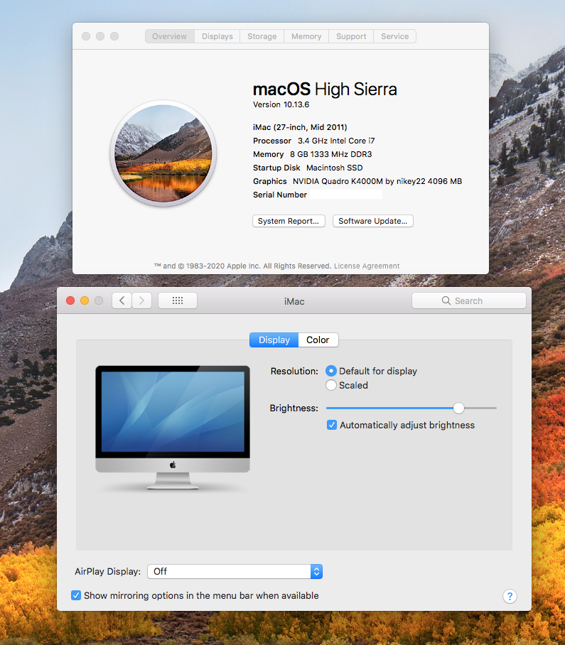

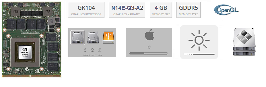

** NVIDIA Quadro K4000M Mac Edition ROM **
Genuine Native Boot Screen & Brightness Control
I've tested and put together the following ROM for the NVIDIA Quadro K4000M which will allow:
Genuine native brightness control
Genuine ‘gray’ early-boot screen
Pre-installation Requirements:
- iMac12,2 (27-inch Mid 2011) Mac-942B59F58194171B (Tested machine)
- BootROM: 87.0.0.0.0. Please use High Sierra to update your BootROM to latest version.
- GPU varient: N14E-Q3-A2
- GPU VRAM:
Я убедился, что на этот раз ПЗУ сообщит правильный размер vram: 4096 МБ. Samsung Samsung vram чипы, я не знаю, будут ли они работать или нет, вы должны будете сказать мне, если вы решили купить карту на базе SAMSUNG. Я буду обновлять этот пост с любыми успехами или неудачами. Глядя на таблицу задержек, я вижу там записи для SAMSUNG ram, так что я предполагаю, что это сработает.

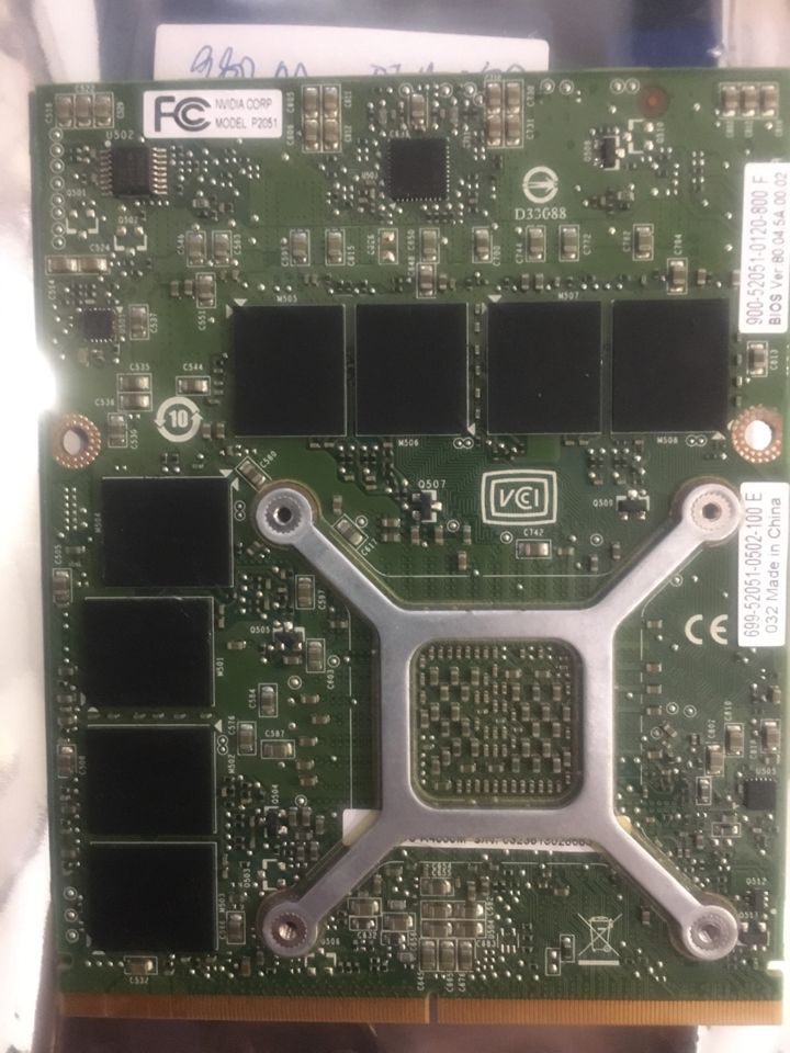

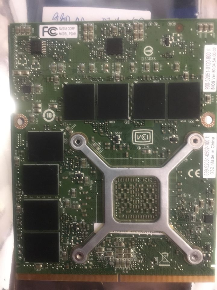

Hello, I bought a video card with Dell m6700, memory for Samsung, without the firmware the card was not detected, it was not possible to flash through Linux. I flashed the BIOS using the programmer, the video card is detected, it works well. It might be helpful.
Sorry for my English, I'm using a translator
Great! Please run UNIGINE Valley and post some benchmark results!

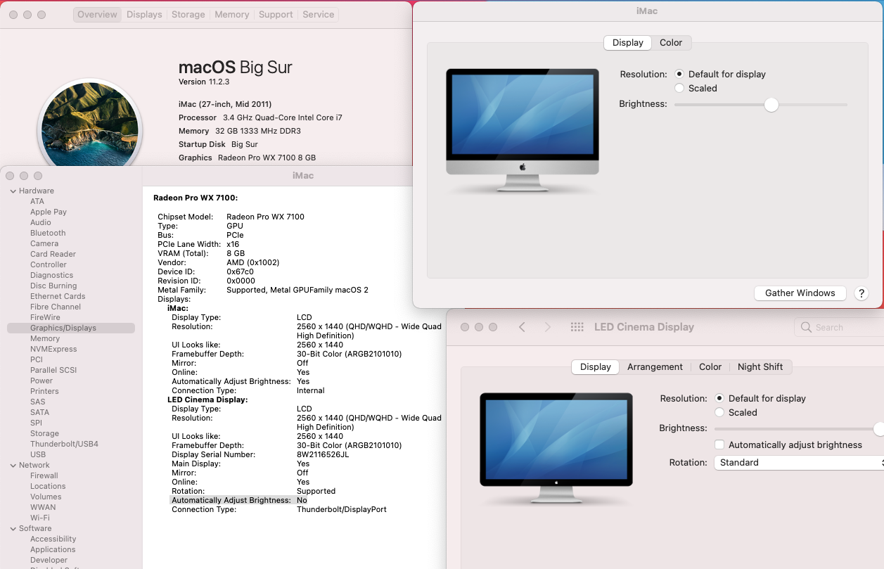

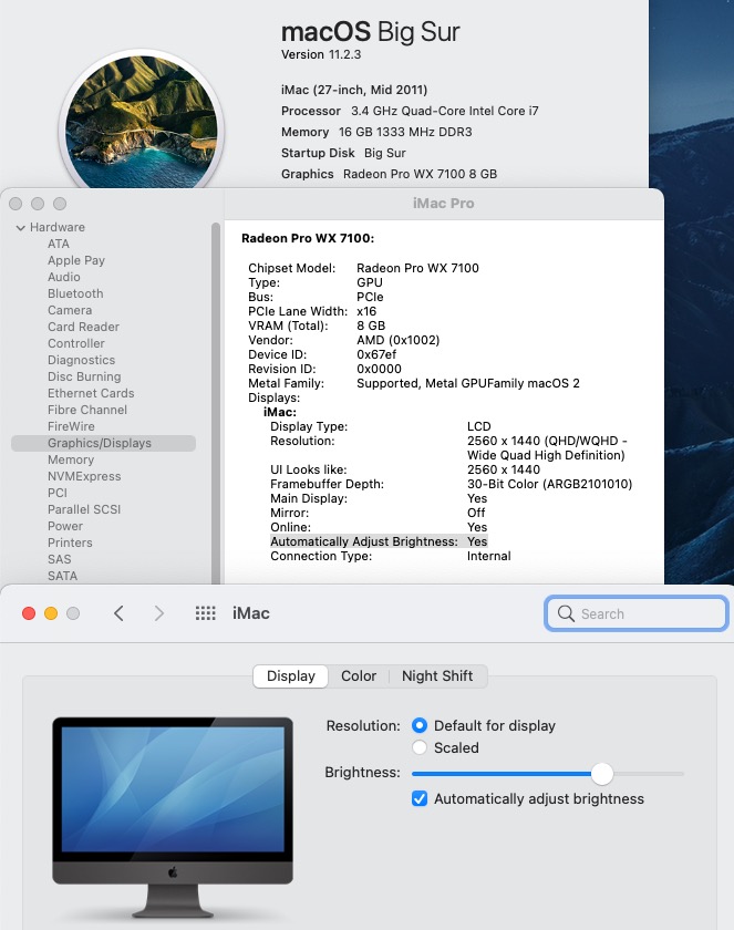

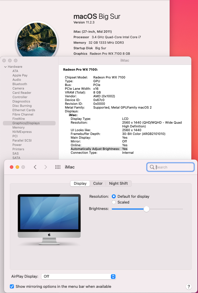

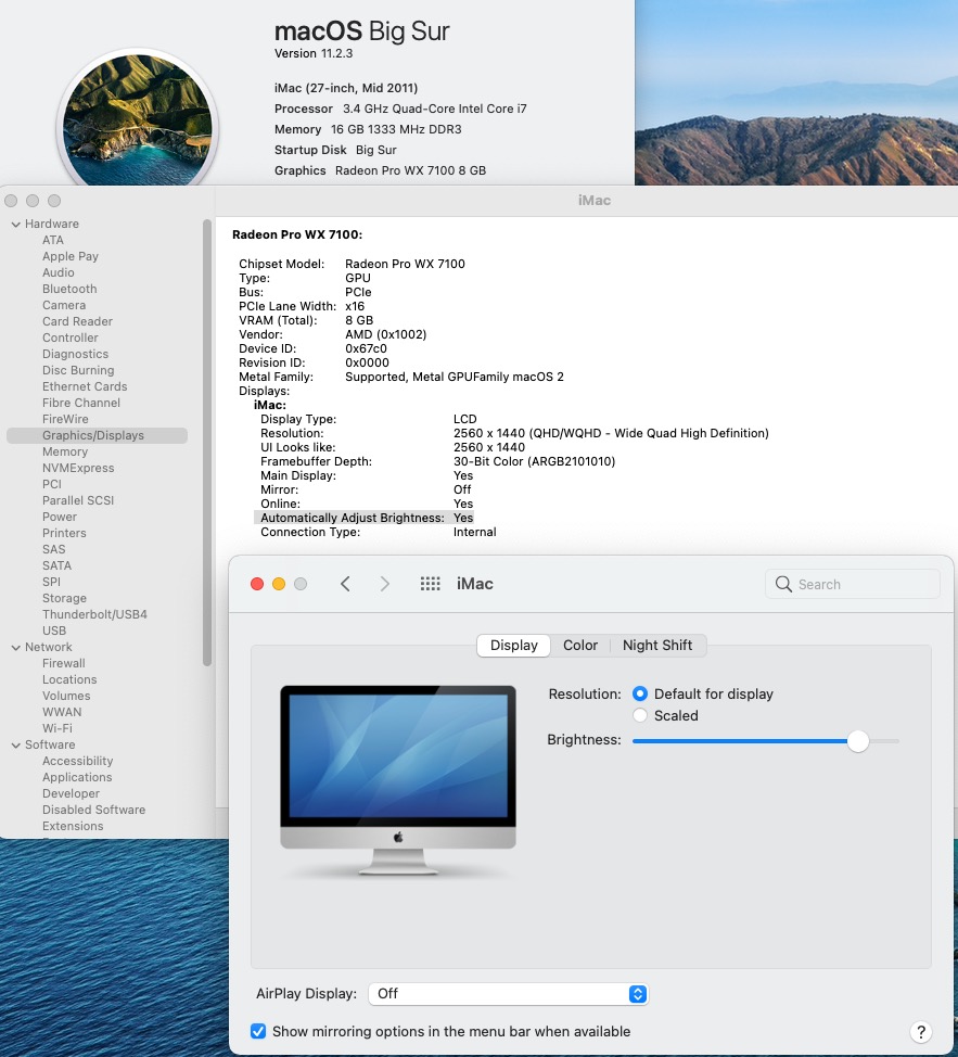

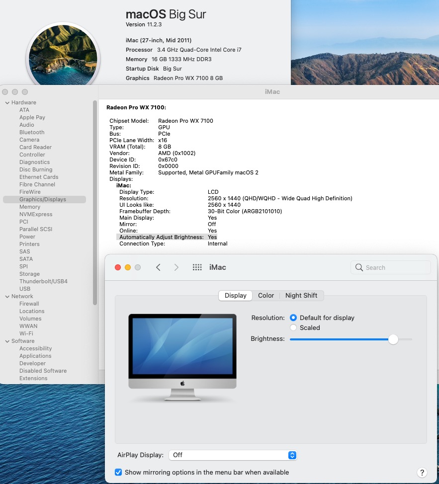

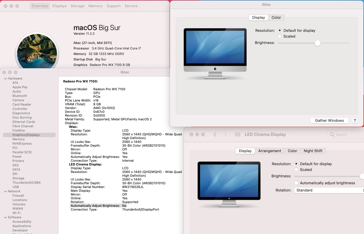

"Automatically adjust brightness" checkbox is missing even though the panel specs show it as supported.​
Covering the camera causes the brightness slider to move, so it appears to be enabled and I'd like to turn the feature off. I have two nearly identical systems (SCOOBY and SCOOBERT) and both have this behavior. Oddly when attaching an external display it shows the checkbox for that display (even though system report shows it as not supported). It would appear whatever controls the checkbox is working backwards. I've attached pictures from both system incase that helps. Manual adjustment of brightness works on both system's internal LCD, as well as the external LED Cinema Display.
My reason for wanting to disabling this feature on SCOOBERT, is that I'm not seeing consistent brightness between min and max settings on the slider. As a result when the system tries to auto adjust I see erratic results. I believe this to be a hardware issue, for it did this before the GPU was changed, and was not corrected after PRAM resets. I also don't have this issue with SCOOBY which is running identical software. I swapped in a different inverter board but that made no difference. My research online has not found anyone else with this issue. I'm left with either a bad PS, LCD panel, or logic board. None of these options are cheap, and would seem overkill just to resolve this small issue. In short, I think the best solution for me is to disable the feature instead of continuing to swap parts.

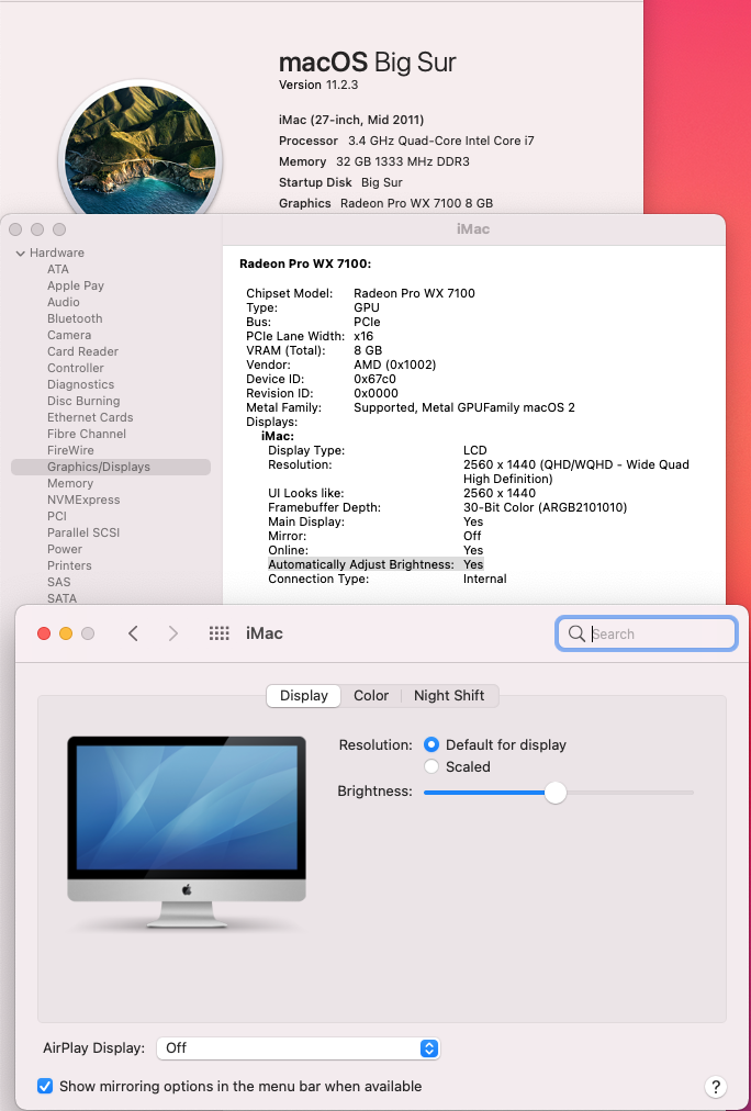

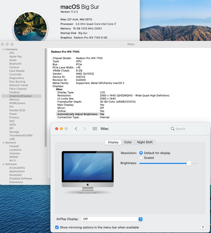

Just checked it with our latest OCLP adaption:
From High Sierra to Big Sur (all unpatched) this checkbox exists and even with my single patched Big Sur instance it is there. I guess you should simply change the OC version on your Catalina Loader. The latest 0.6.8 should do the job.
EDIT: I have pulled back all older OpenCore versions, only left the 0.5.9. Time to migrate!

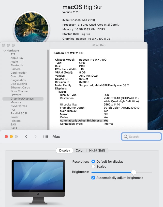

The OC 0.6.8 update took care of it ... and MORE! I used the config.122.plist file, and was expecting to loss internal sound, which I did. That is the main reason I had resisted upgrading, and may keep some of my systems on 0.6.6. Fortunately this change puts the checkbox for auto brightness back. On this system the lack of internal speakers is acceptable (bluetooth speakers are normally used). What I had not expected was for it to resolve the wonky brightness slider; that now changes smoothly from min to max. Not sure why my other identical OC 0.6.6 system was not experiencing this issue, but discovering this was not a hardware issue was a pleasant surprise.
Reactions: NOTNlCE and 0607557

buongiorno ragazzi sto davvero impazzendo. qualcuno può spiegarmi passo passo come posso usare opencore? ho un imac del 2011 con nvidia k610m. Vorrei il controllo della luminosità e visualizzare il display originale nelle impostazioni invece di uno schermo come allegato nell'immagine. ho installato big sur. I have seen many guides and I do not come to the head.
