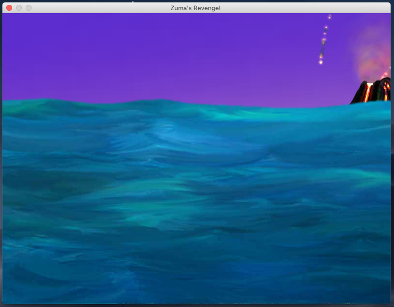

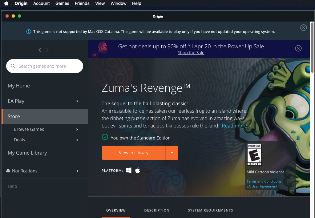

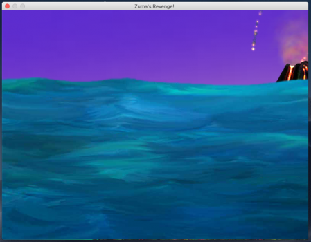

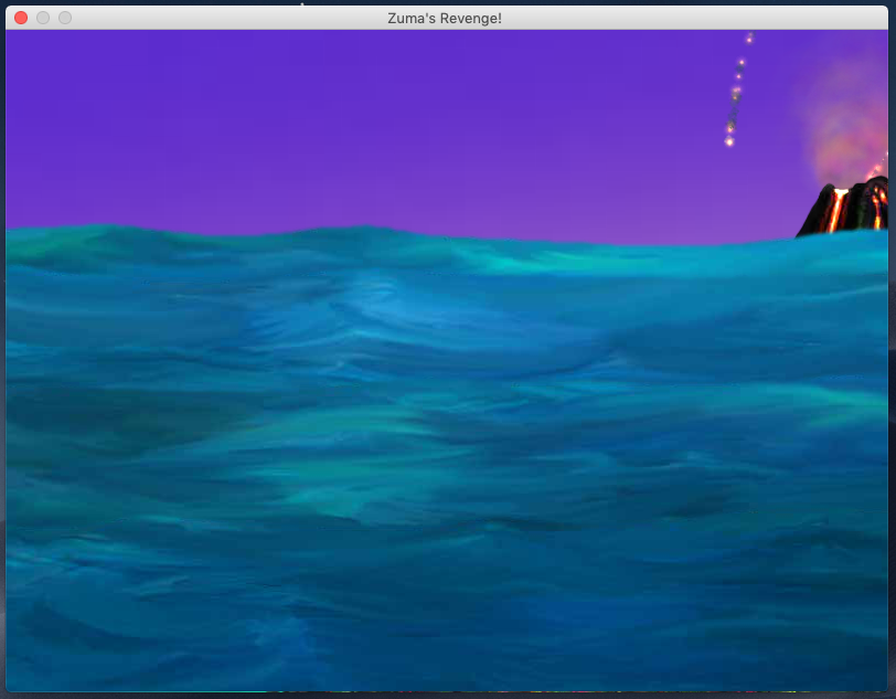

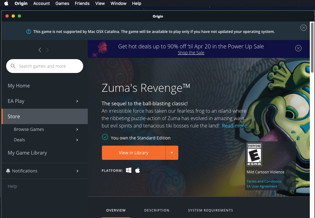

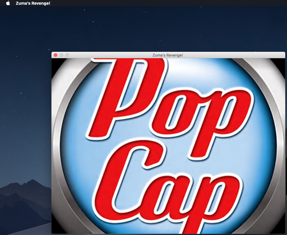

WARNING: Long Boring Story Follows:

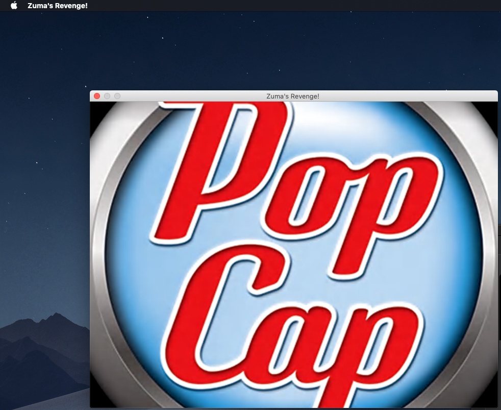

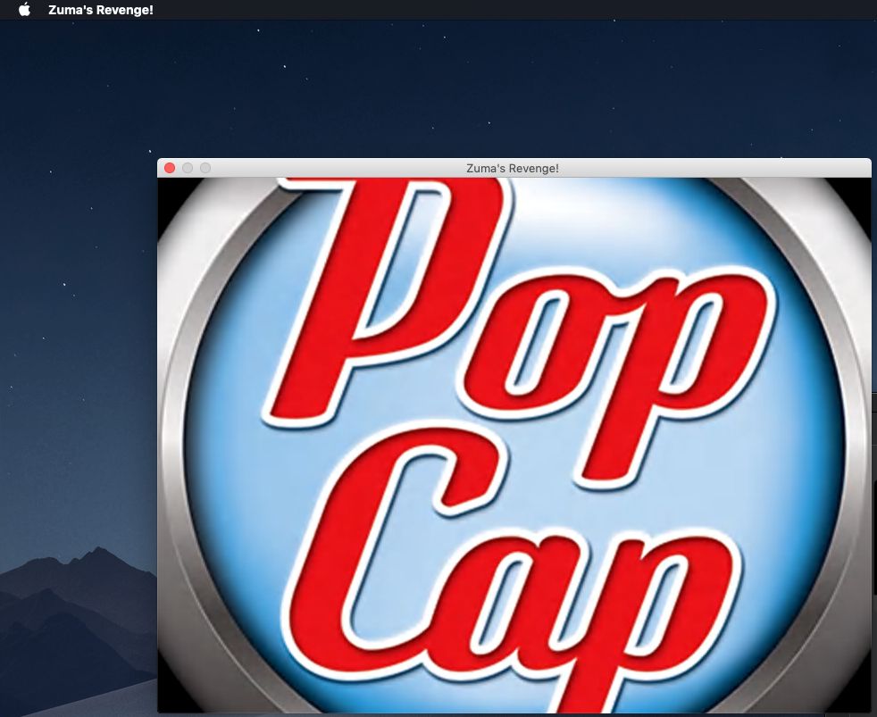

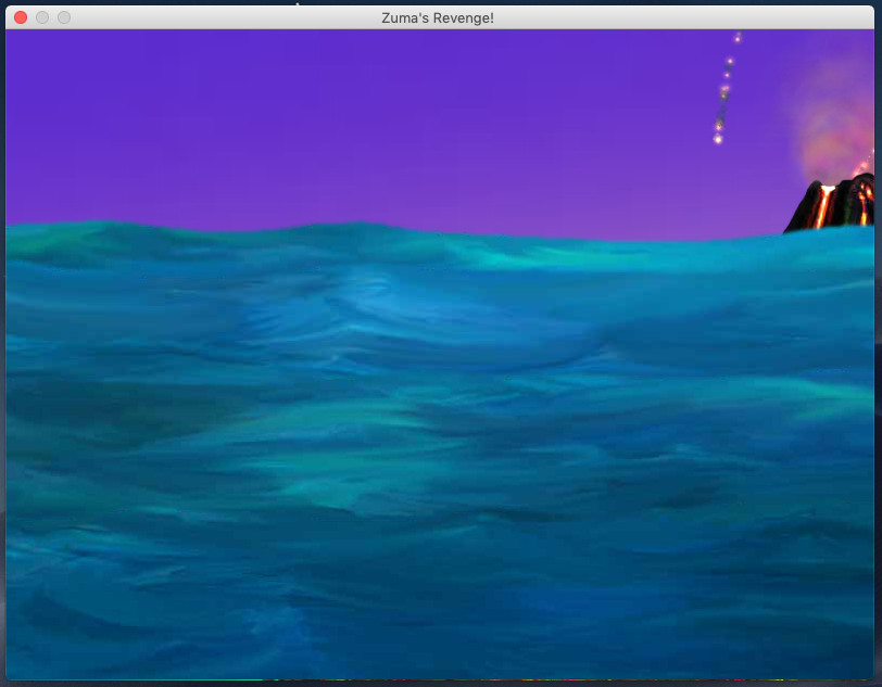

I keep Mojave on one of these systems (SCOOBY), so I can boot over and play legacy 32-bit games on occasion. One of those games (Zuma's Revenge) has never worked consistently ever since moving to the AMD card. I had hoped that with unpatched Mojave it might make a difference, but it did not. Oddly this game works consistently on my systems with nVidia cards (K3000M and K2100M), so my conclusion is there must be compatibility issue with AMD. That said, it will work occasionally on the AMD, leaving me with hope, yet also in frustration. Not sure why I still want to play this old $5 game, but I find it addicting. 🙂

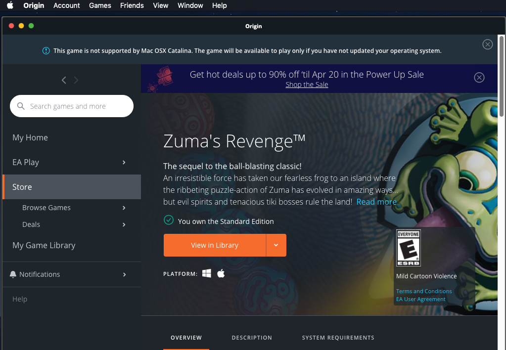

Let me clarify what I mean by "not working consistency". It does not crash, but the graphics are corrupt with the mouse position out of sync, and video zoomed in and showing tearing, so unplayable. I can tell immediately at start when it will fail, for the "Pop Cap" logo which should appear in the middle of the splash screen is way oversized. I've tried toggling from windowed to full screen and between resolutions without any consistent success. Any thoughts as to what might help correct this behavior, other than convincing EA (current owner) to update the game and/or support 64-bit? That would truly make me overjoyed, but holding breath for that is likely to end in death. I will gift the game on Origin to anyone that has a 2011 iMac with AMD card and running Mojave that cares to give it a try. DM me with your Origin username if you want to experience the issue; I'll send out at least 5 copies assuming the requesters have needed specs in their signature. Regardless @Ausdauersportler gets coffee/beer money for his fine work on OCLP EFI. Thanks for listening to me vent.

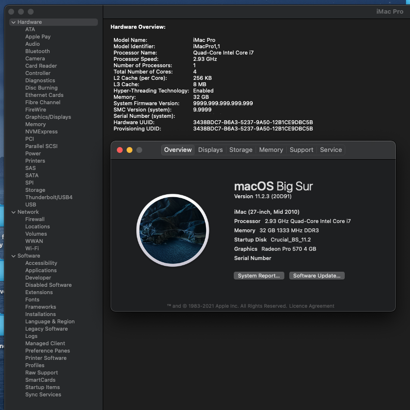

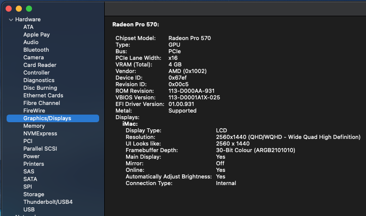

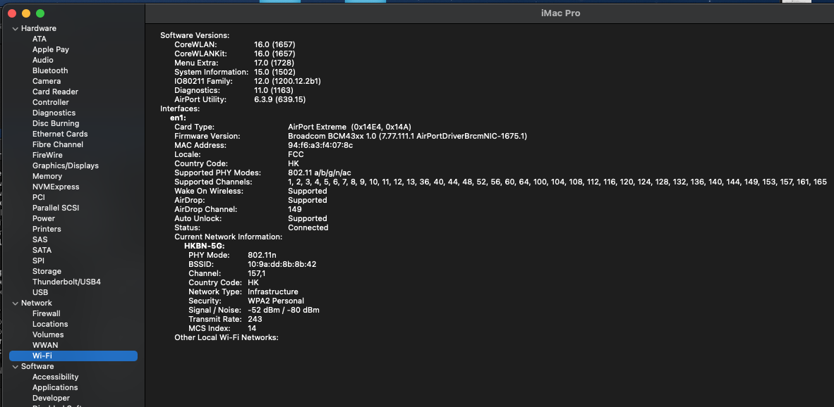

A marvellous achievement for iMac 2009-2011 users with metal GPU upgrade !

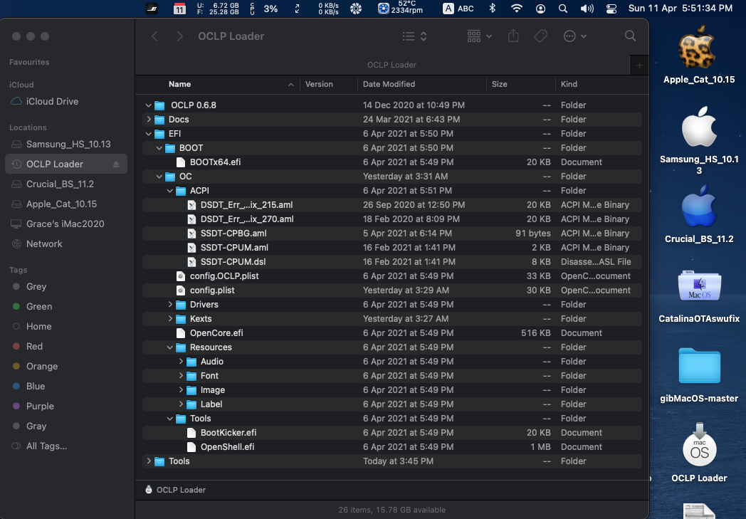

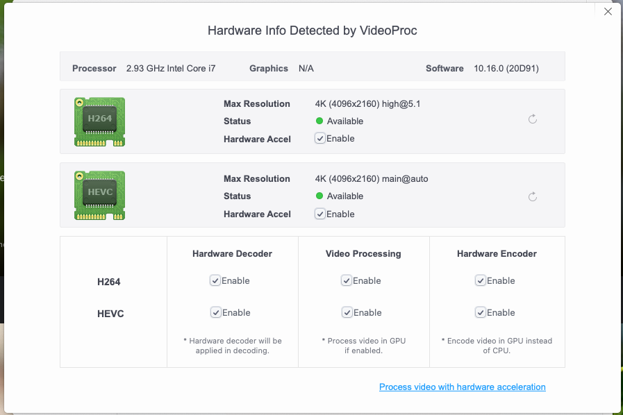

I tried the latest OC 0.6.8 EFI you posted on my iMac 2010 running BS 11.2.3 patched previously with iMac micropatcher.

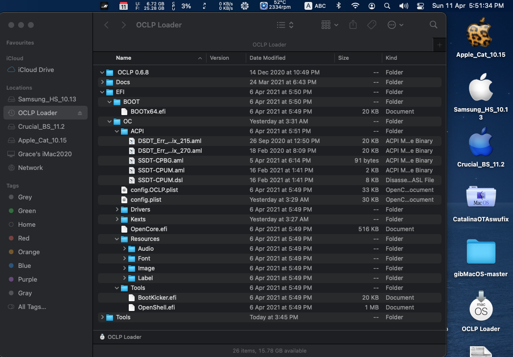

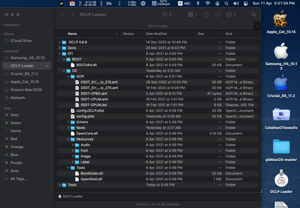

Firstly, I prepared the OCLP Loader SD card with OC 0.6.8.

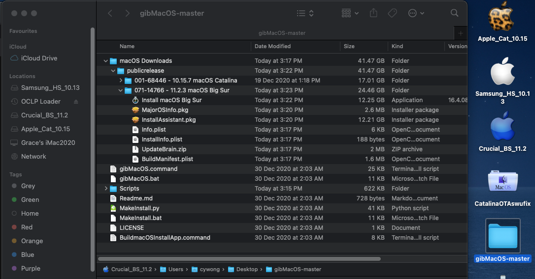

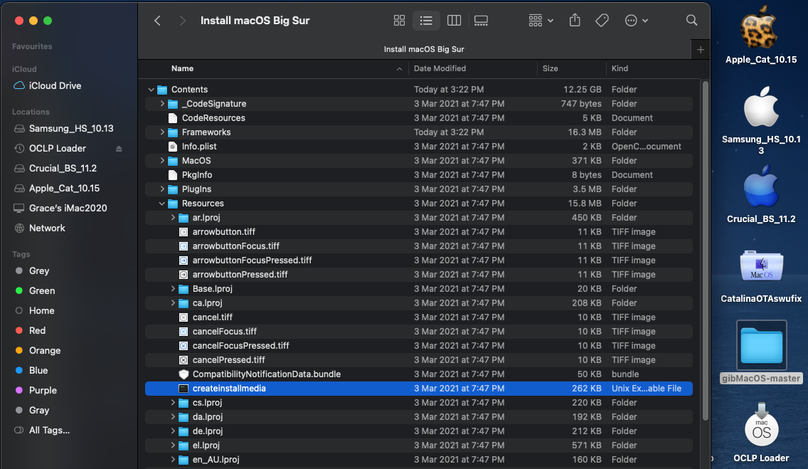

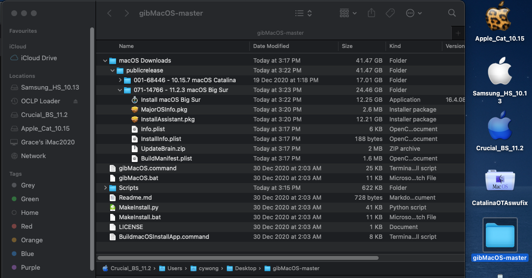

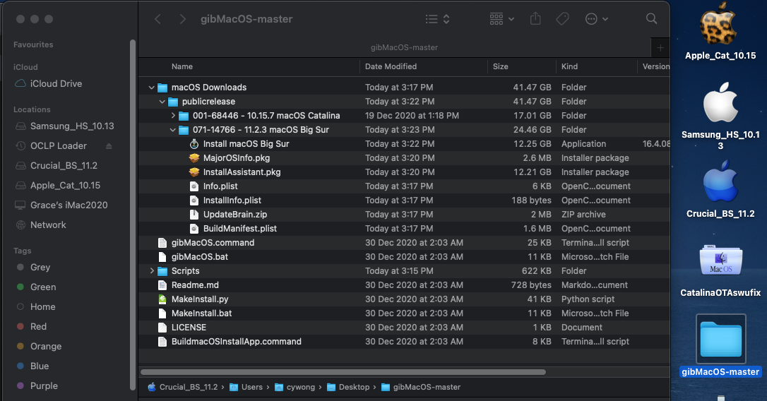

Secondly, with gibMacOS-master, I downloaded Big Sur 11.2.3 and ran the InstallAssistant.pkg to reconstitute the Install macOS Big Sur app in Applications folder.

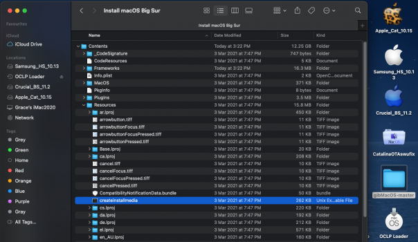

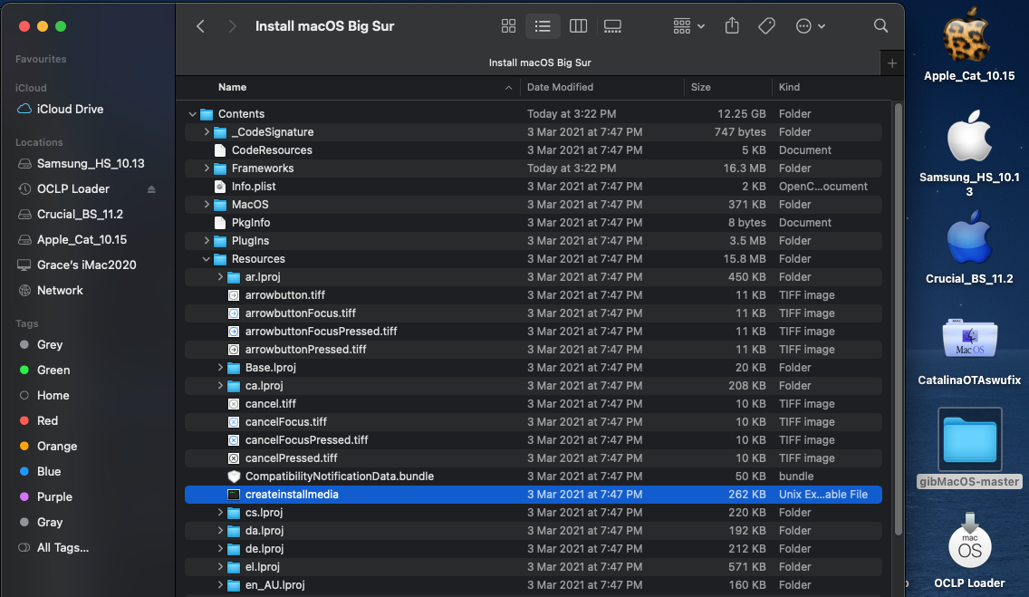

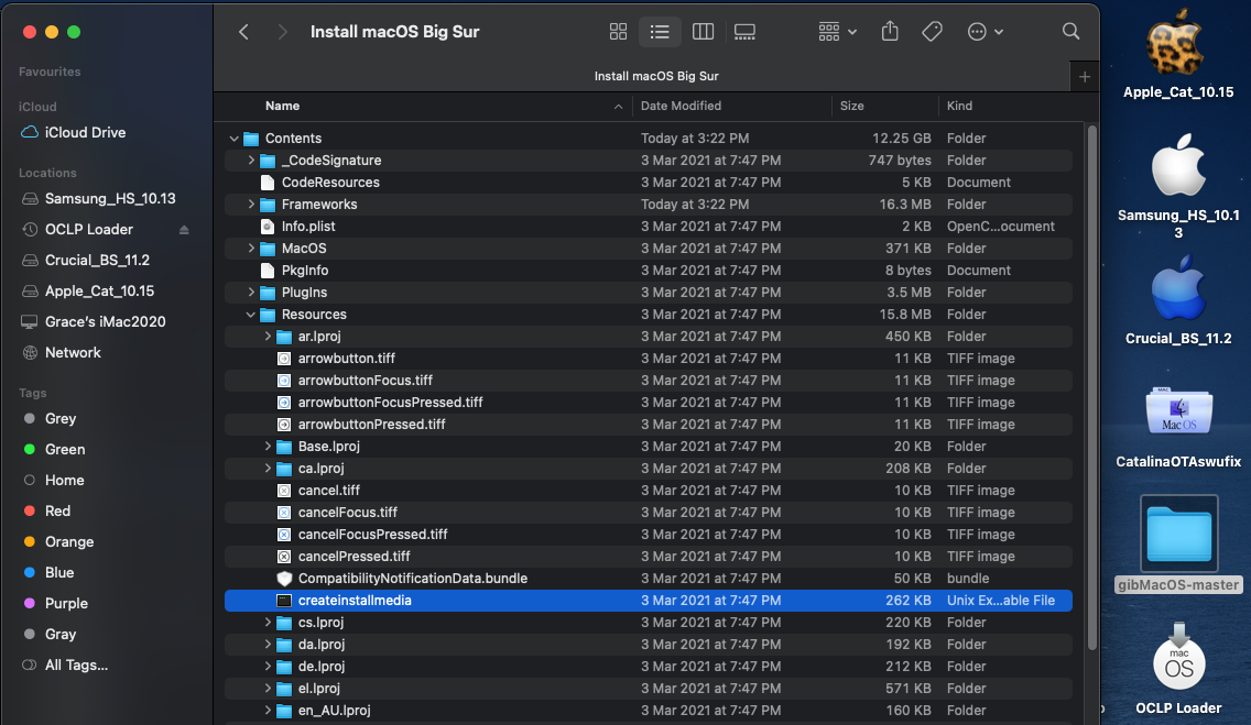

Thirdly, I ran the createinstallmedia in the Resources folder of the Install macOS Big Sur app to create a bootable Big Sur Install USB thumb drive in GUID partition and Mac OS Extended (Journaled) format.
Fourthly, while the Big Sur USB Installer is not directly bootable in our unsupported iMac without patching, by booting from the OCLP Loader (after PRAM resetting) I can select the Install macOS Big Sur USB thumb drive to secondarily boot and start the Big Sur installation. I had it directly install over my prior Big Sur 11.2.3 again. That took over 30 minutes with multiple reboots with no need of user intervention. At some stage it may seem it was hanging with no visual changes but it would go through finally. Just be patient.

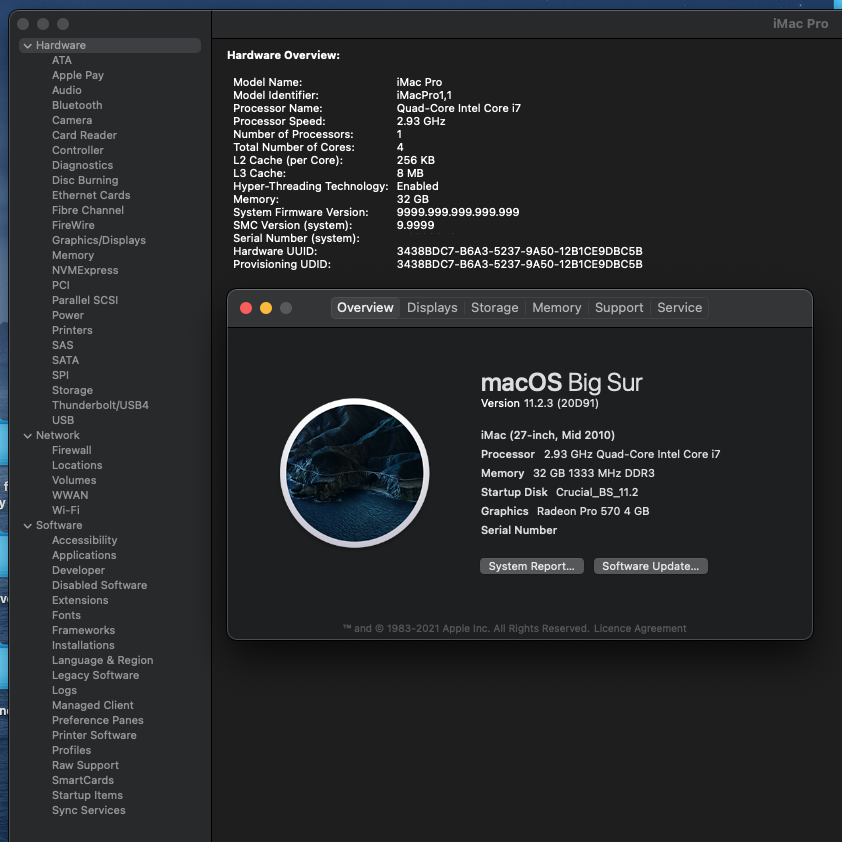

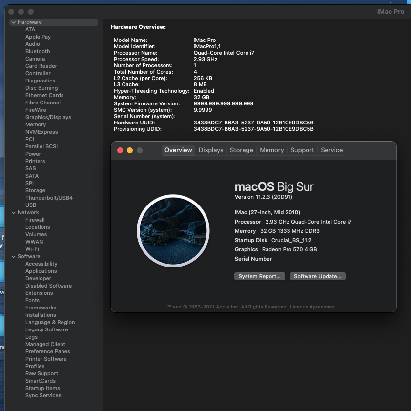

Finally I was greeted with the Big Sur login screen again. All my data and accounts are preserved. Everything works without any further patching. The only visual difference is the spoofed Mac identity of iMac Pro as compared to before.

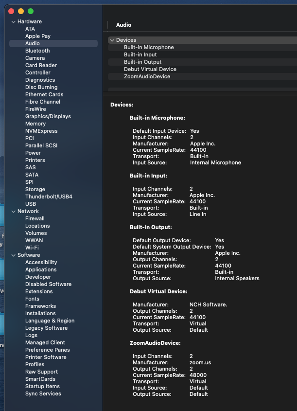

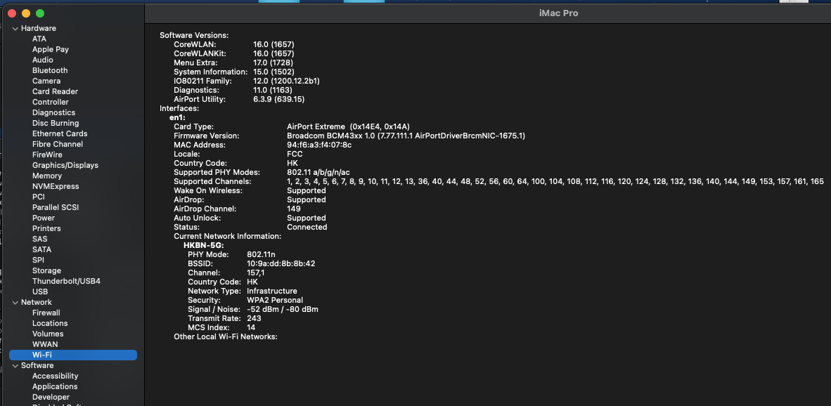

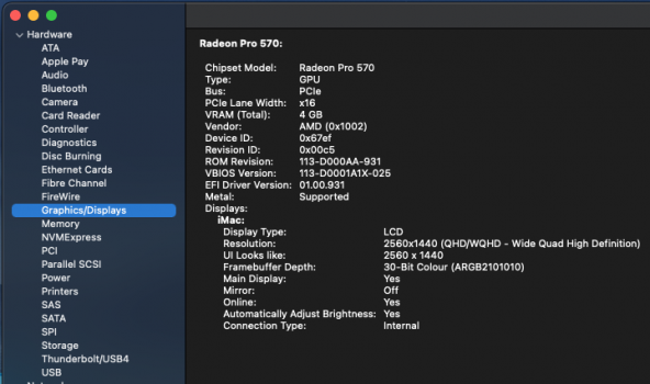

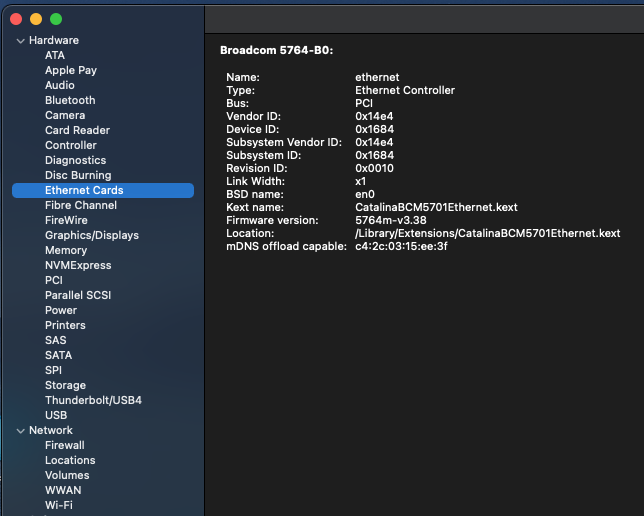

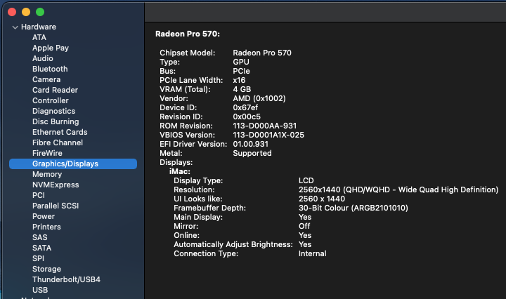

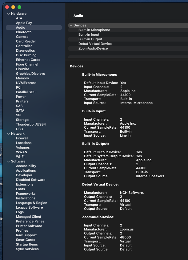

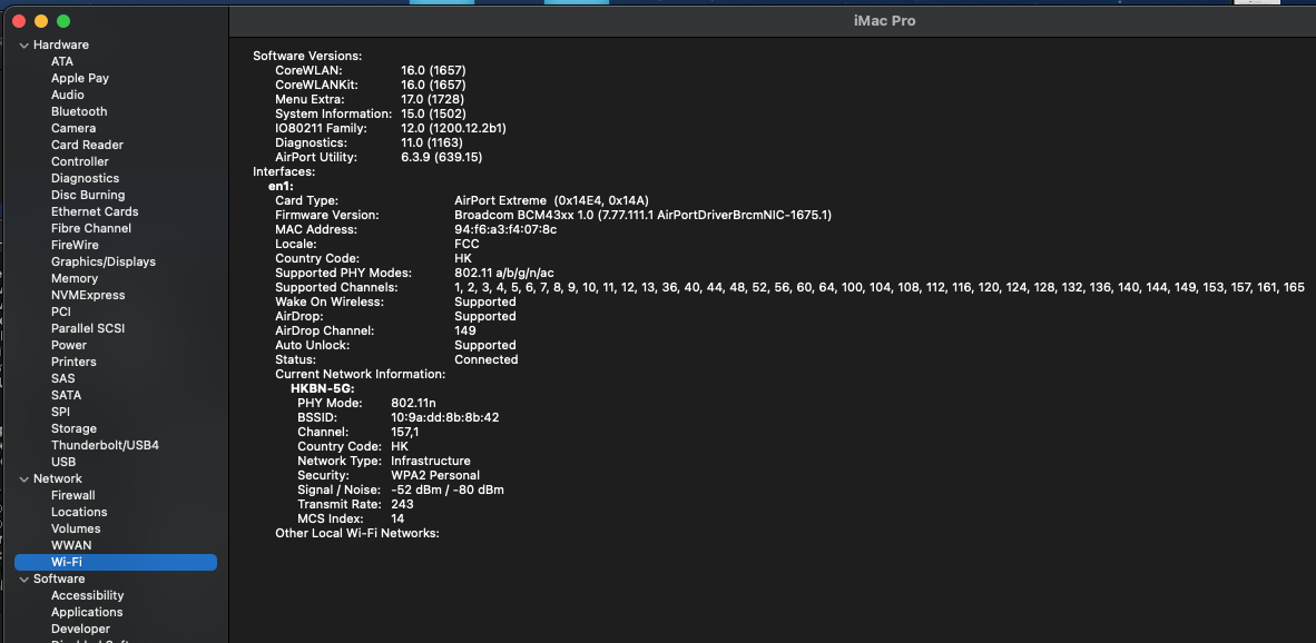

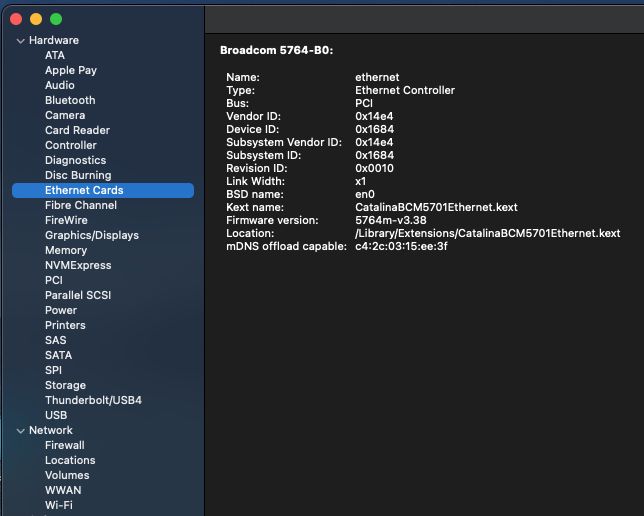

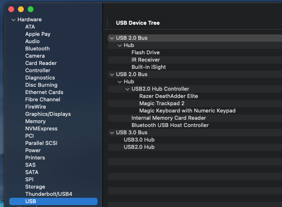

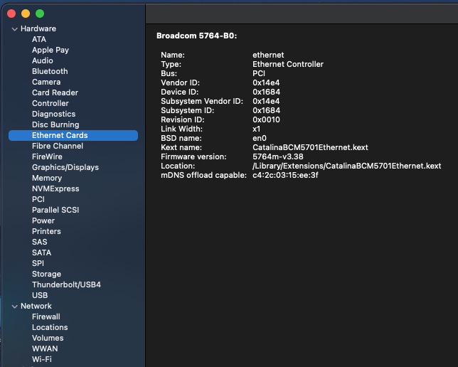

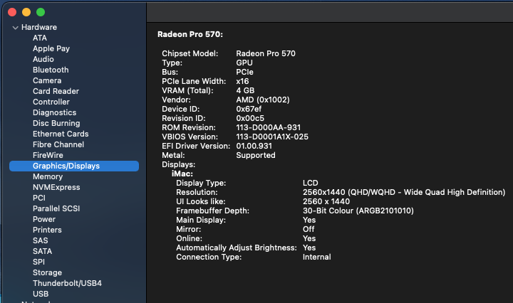

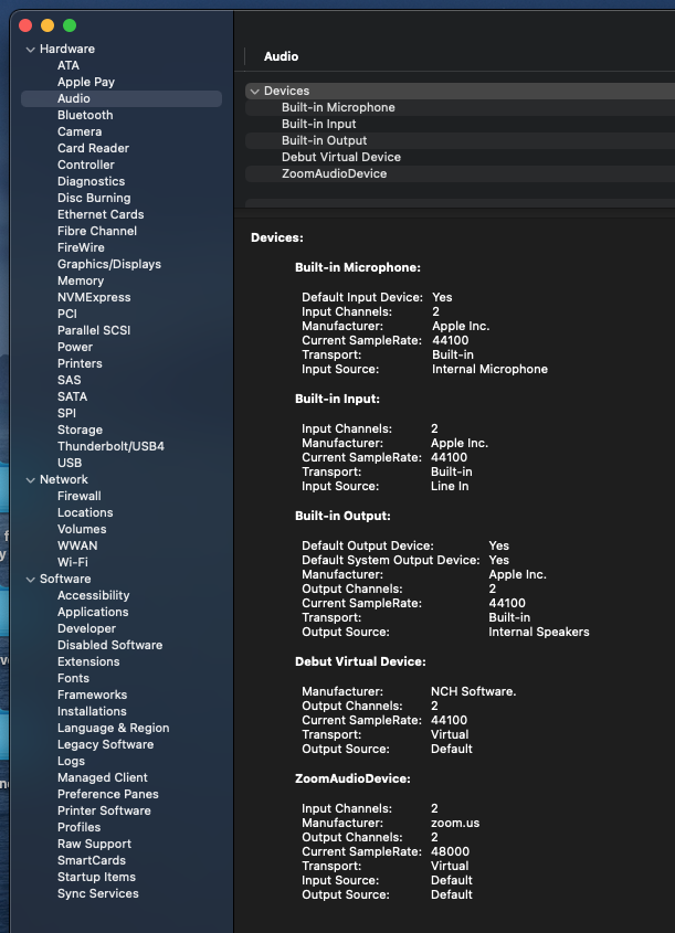

Audio (Internal speaker), Bluetooth (4.2), Ethernet (build-in), Graphics/Display (RX480), and WiFi all work.

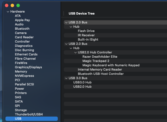

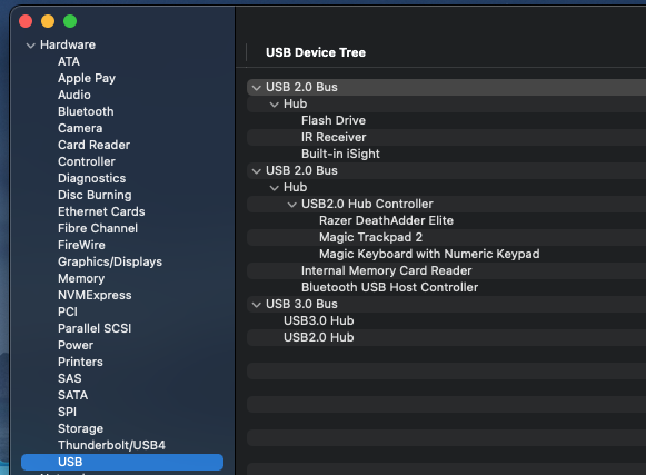

My internal USB3 modification still works.
Brightness control and Night Shift are enabled.

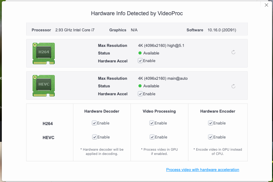

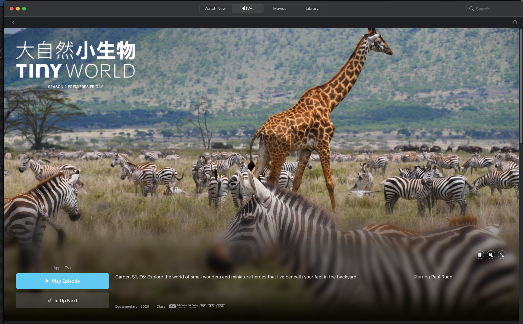

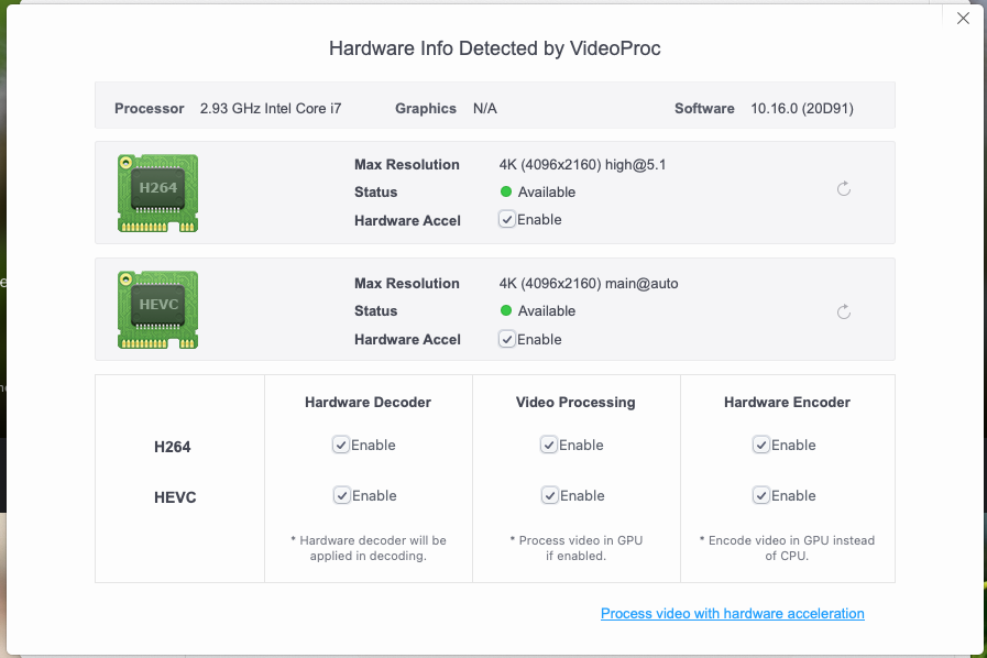

Hardware graphics and video acceleration are also fully enabled for my AMD GPU.

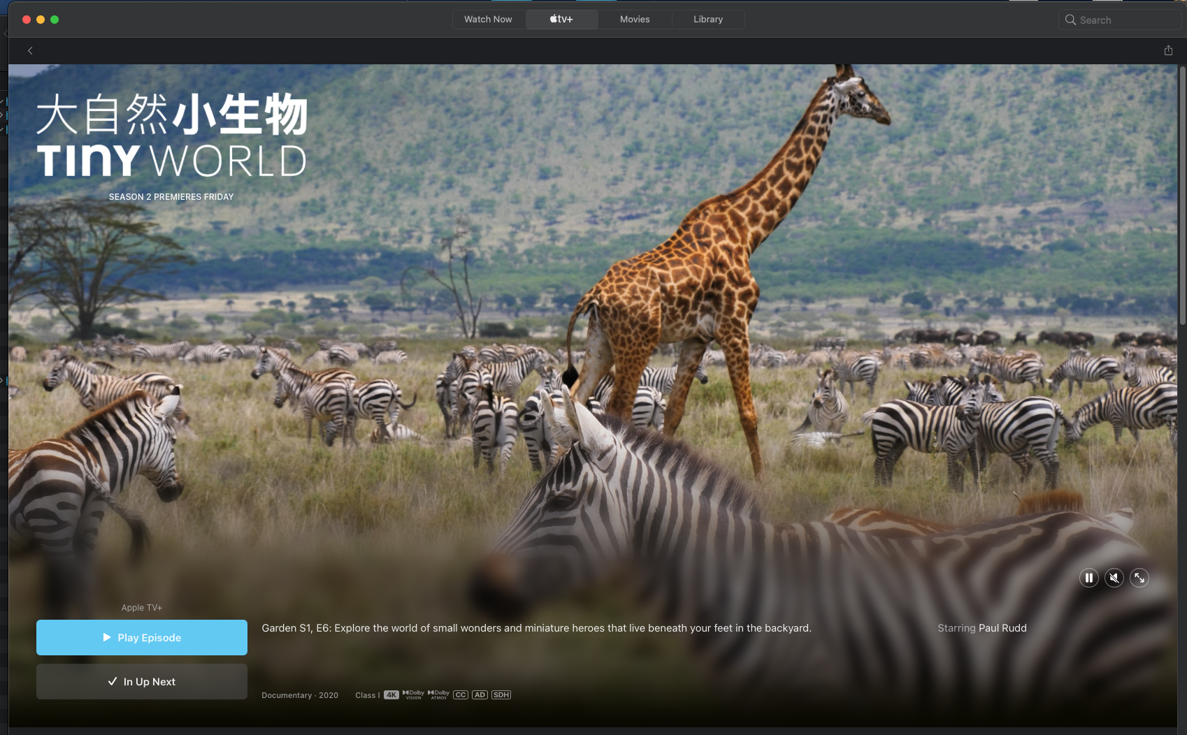

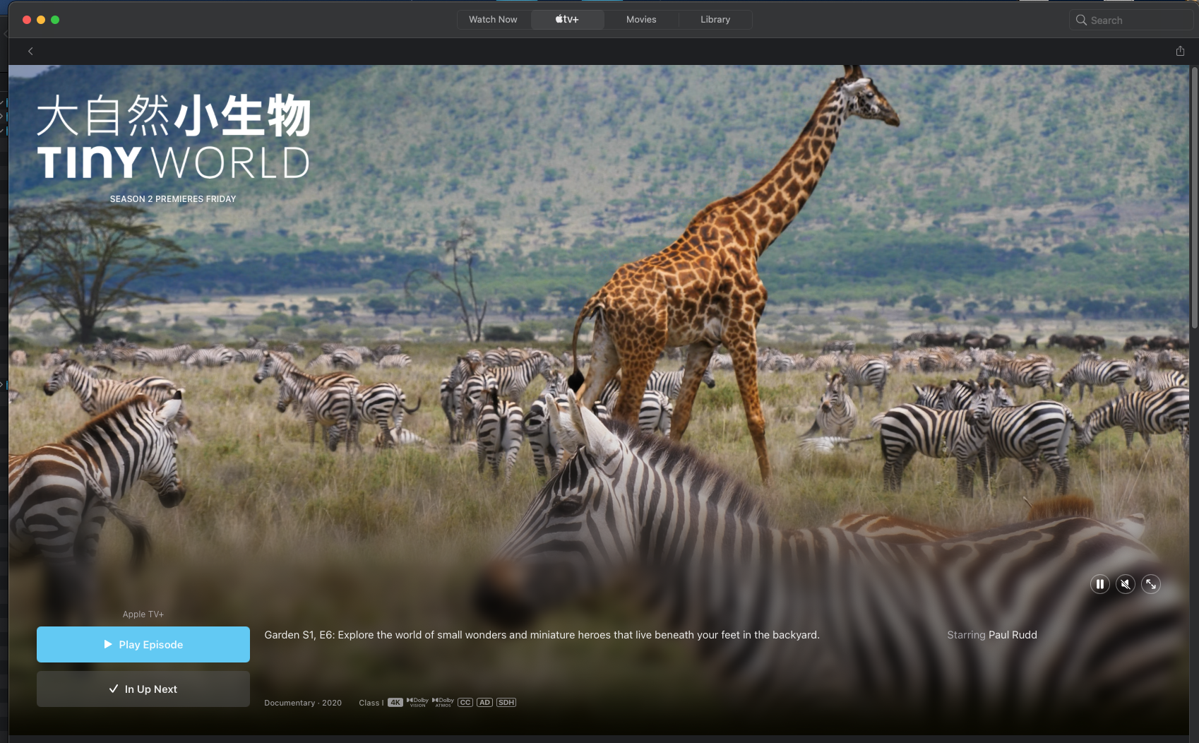

Even Apple TV+ works flawlessly.
Graphics:Display (Rx480).png

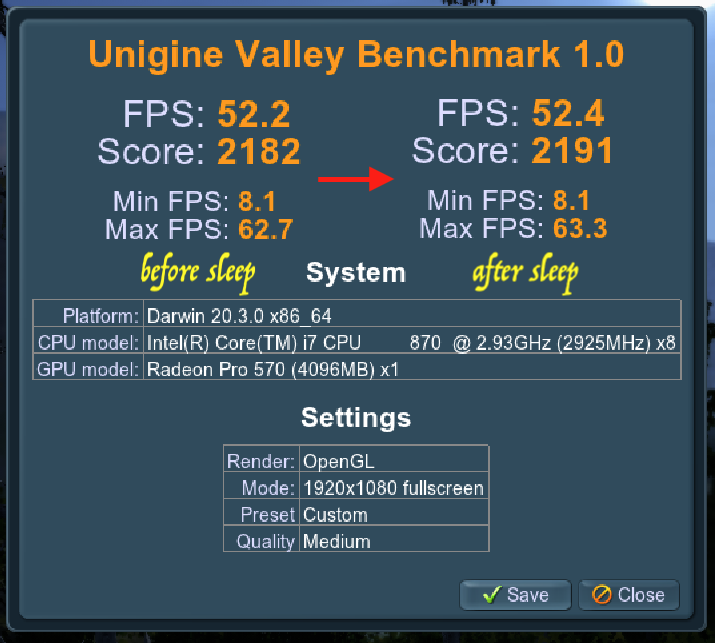

There is no problem with Sleep and Waking.

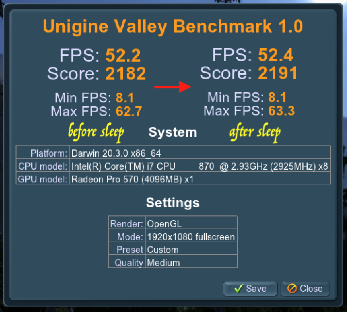

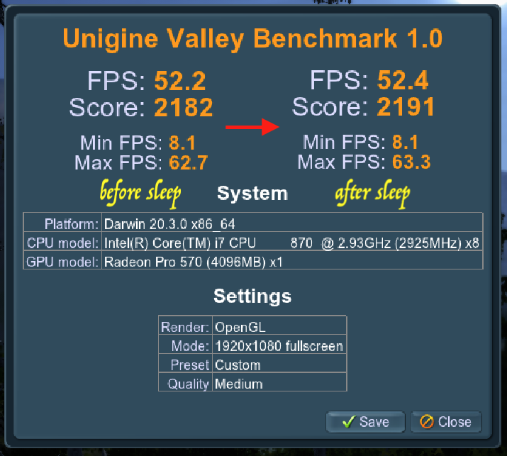

No OpenGL performance drop in first Start, that requires Sleeping once to amend.

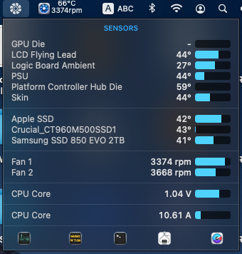

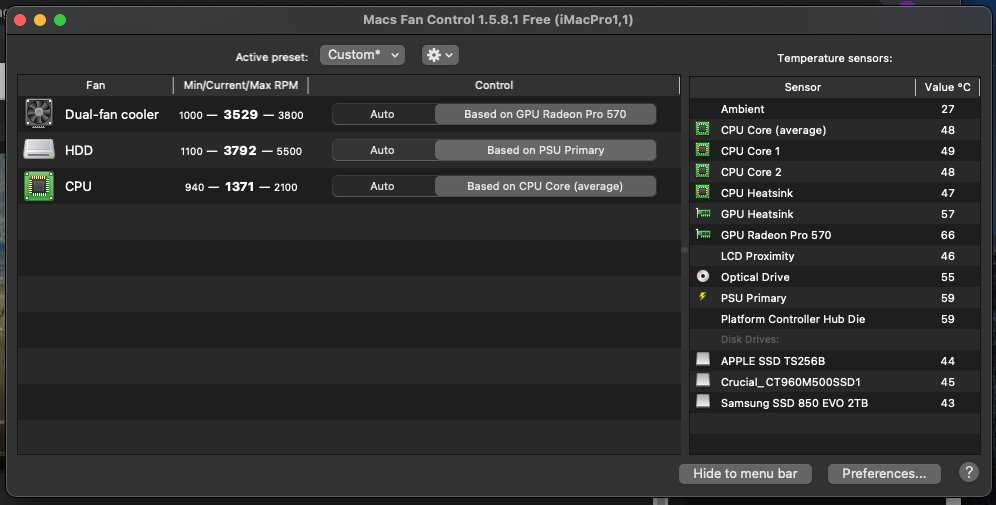

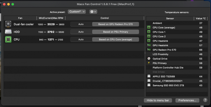

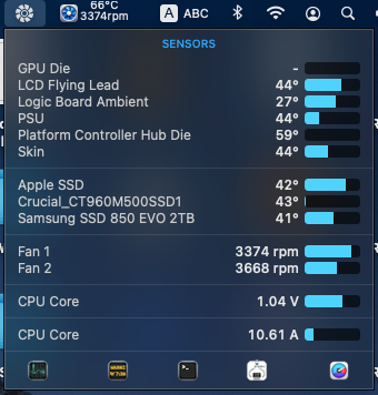

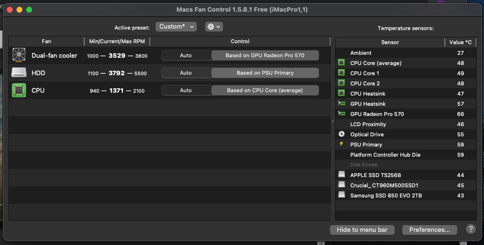

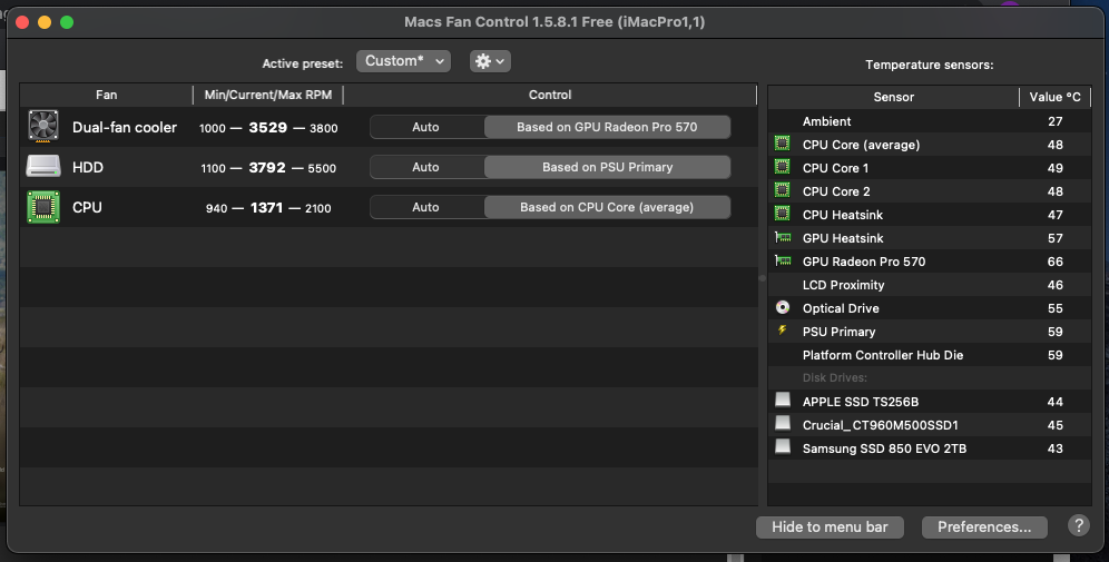

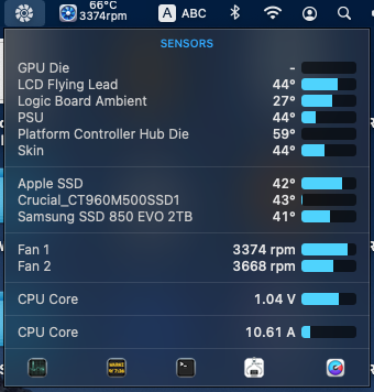

However, Macs Fan Control is confused by the spoofed Mac ID with changed fans labelling, and iStat Menu that I used to monitor the power consumption also gets a much reduced list of sensors reading.
Despite these minor glitches, Kudos to Ausdauersportler and other developers here 👍

I used wired Apple keyboard and wired Razor mouse. So, there is no problem.
But I also tested the Apple keyboard and another Apple Mouse in wireless manner. No problem at all in Big Sur.
