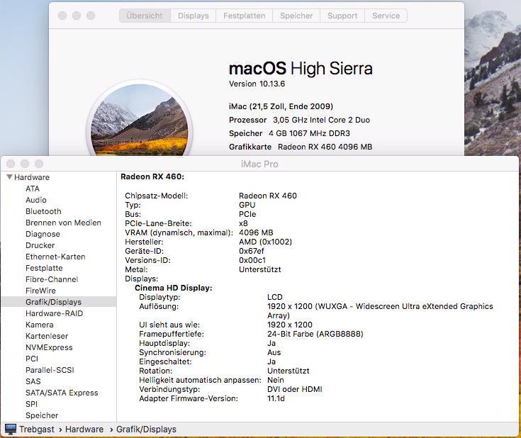

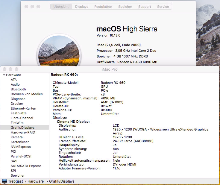

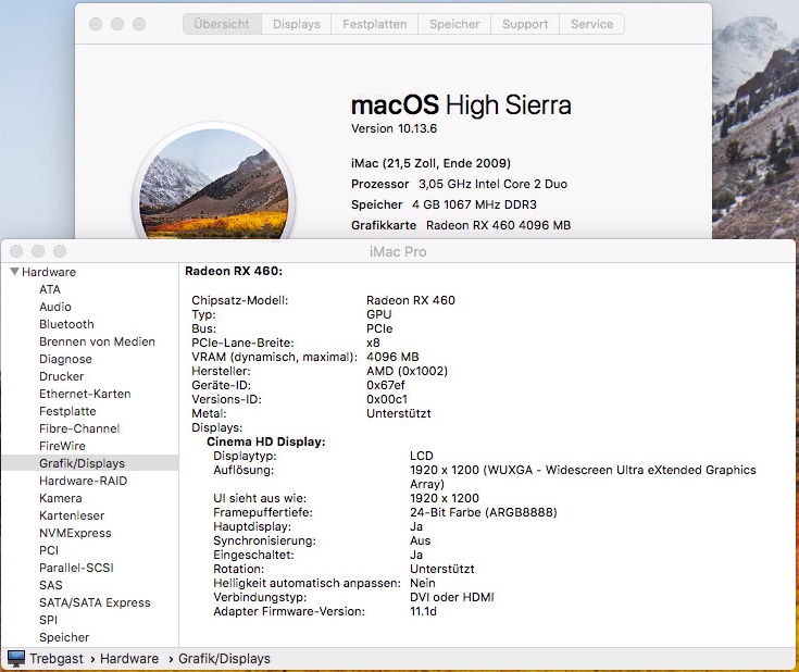

WX4150 with Late 2009 / Core2Duo iMac10,1
Lately I got a cheap 21.5 iMac10,1 and decided to put a WX4150 into it. Running with High Sierra I needed to install the AAAMouSSE.kext to enable the AMD HD4000 driver in High Sierra.
Plugging in an external display (Apple Cinema 23", miniDP to DVI) I got a picture. Unfortunately the internal LVDS style display connector was broken and I got the internal display sometimes recognized but never enabled (but this may be caused by a dead display, cannot check this, because I would need another similar working one to cross check and solder the connector back onto the board).
At least we know now that one can replace the old ATI 4670M with a newer AMD card and that we likely (with some help of OpenCore) can enable the internal ports to show a picture on the LCD, too.
For those willing to play around this this I have added a working OpenCore EFI folder (can be used with either Catalina Loader or directly on the internal EFI partition). The complex part will be to get such a card.
Have Fun!
