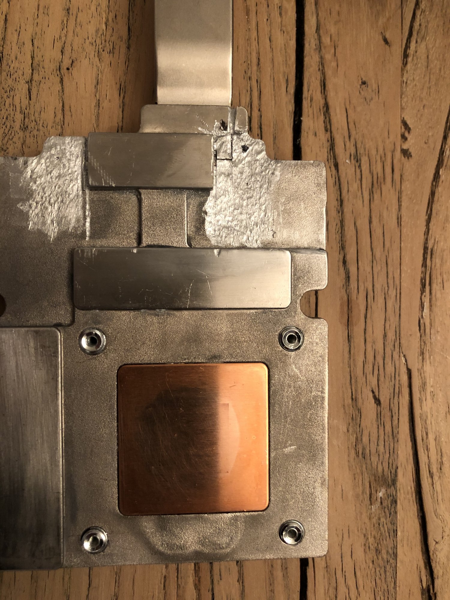

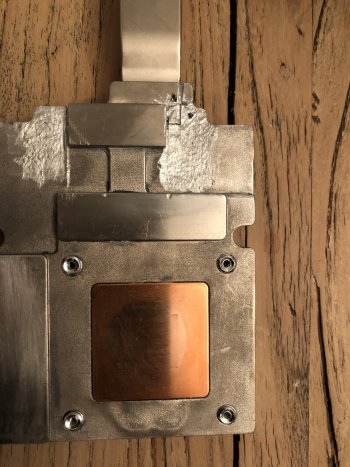

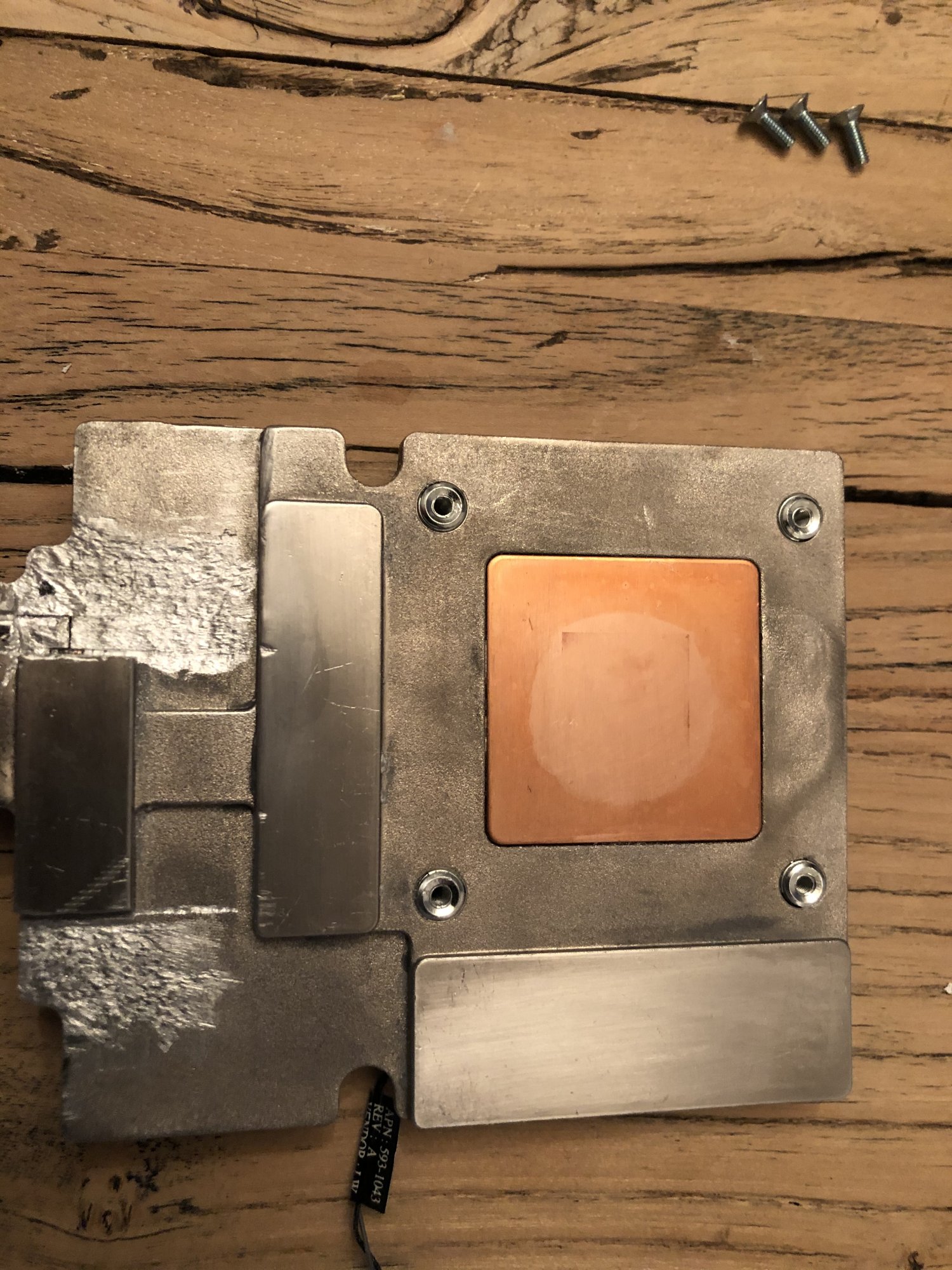

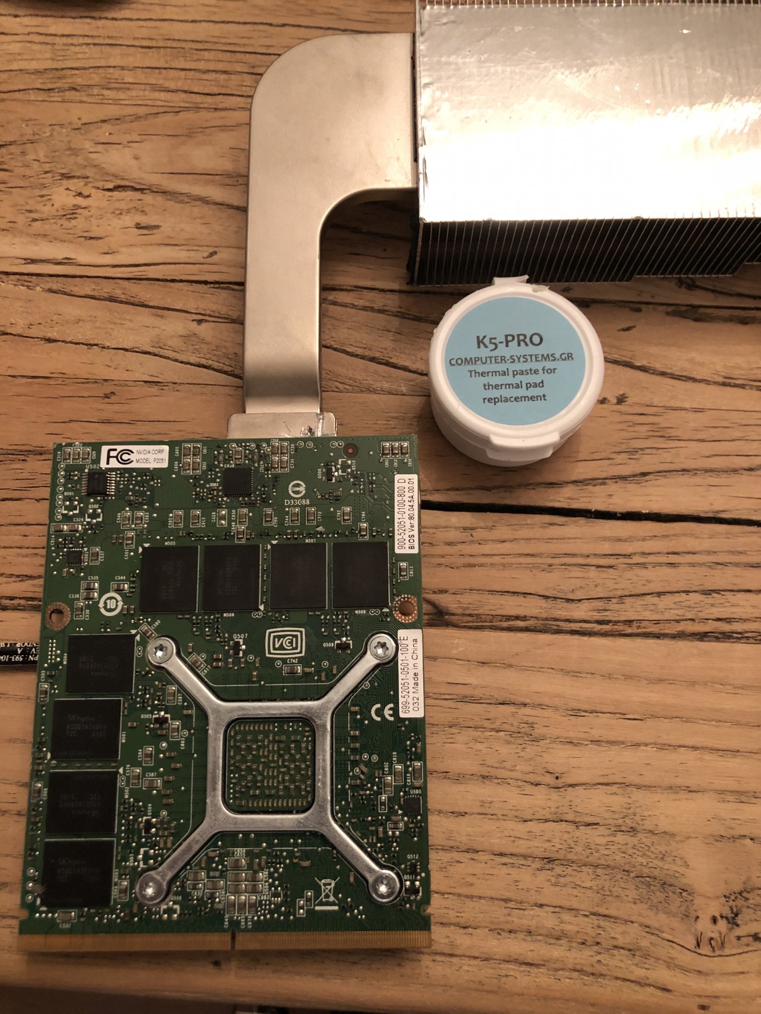

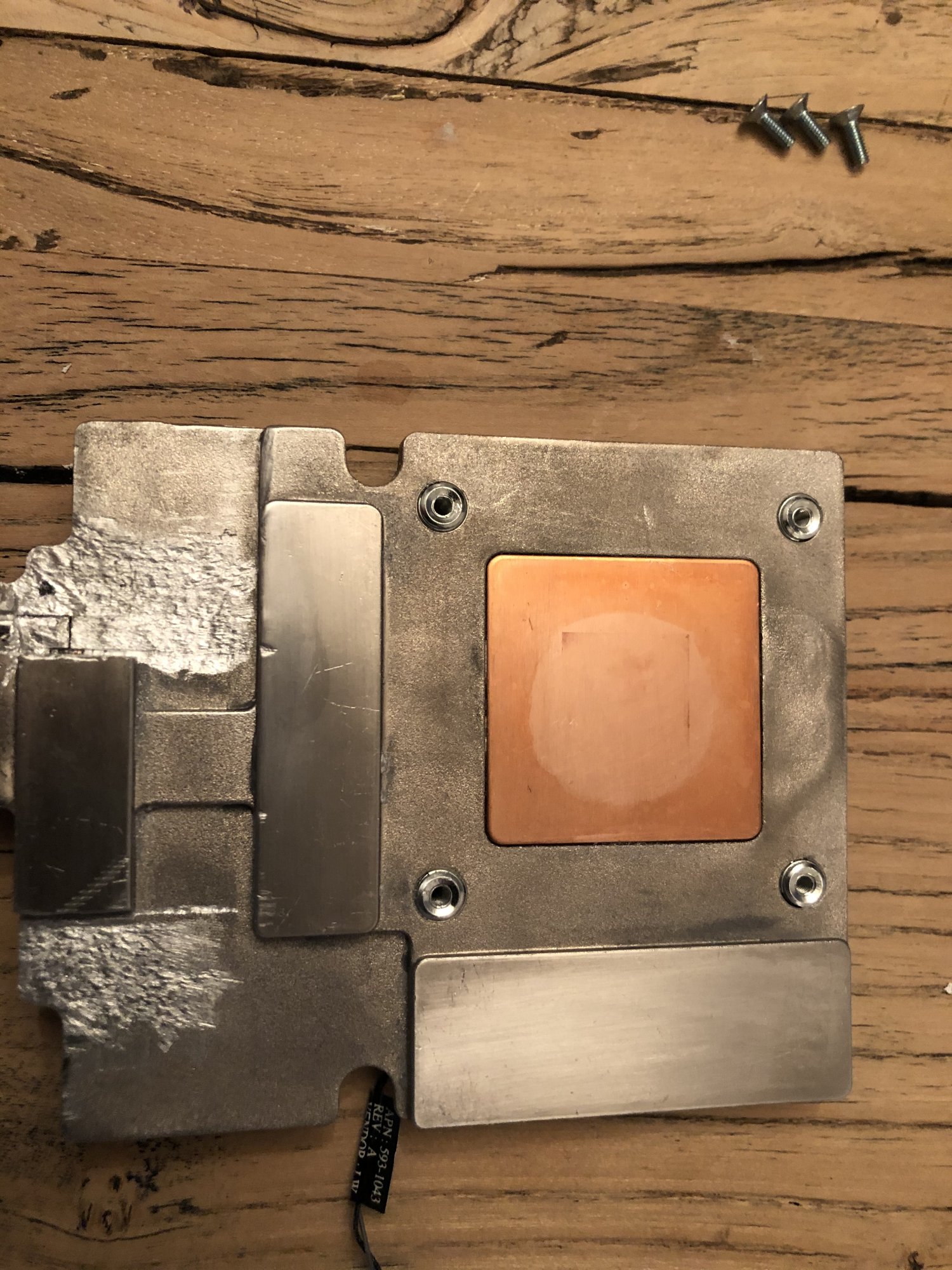

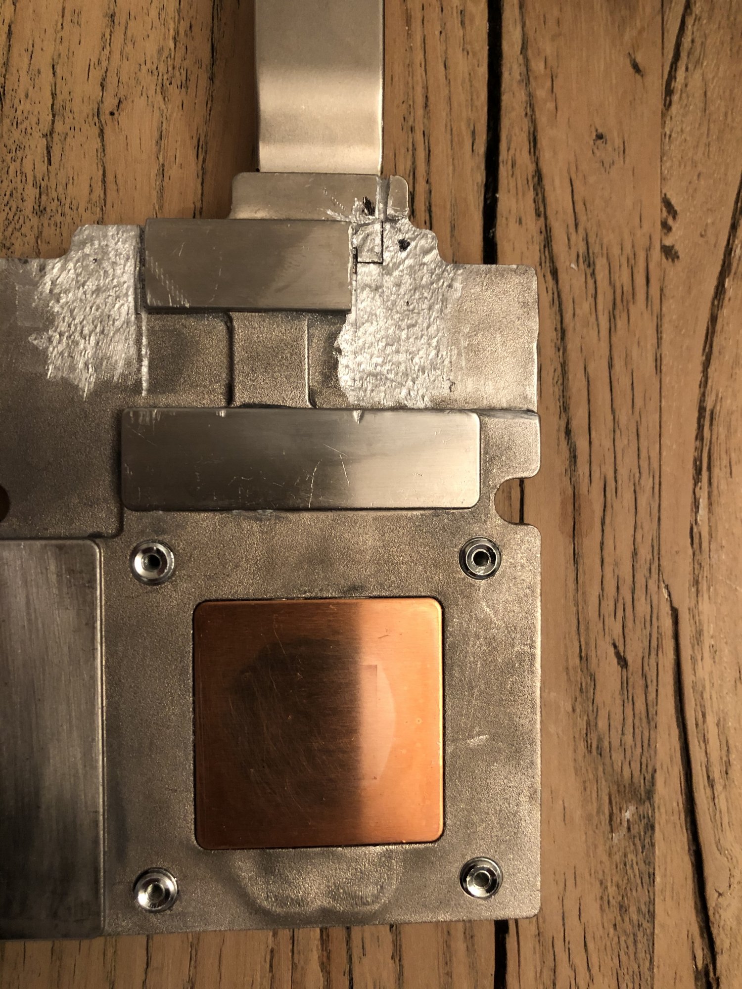

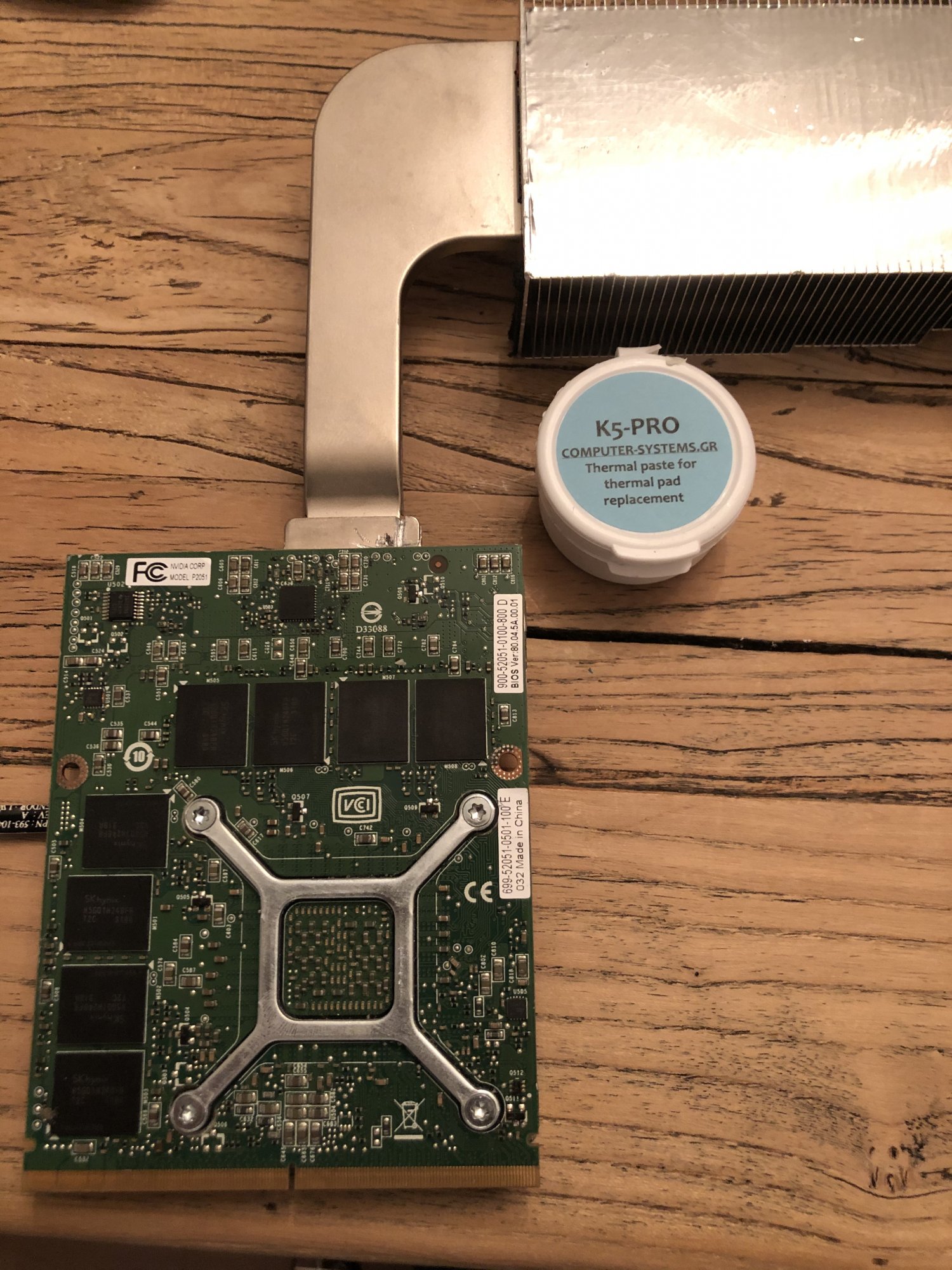

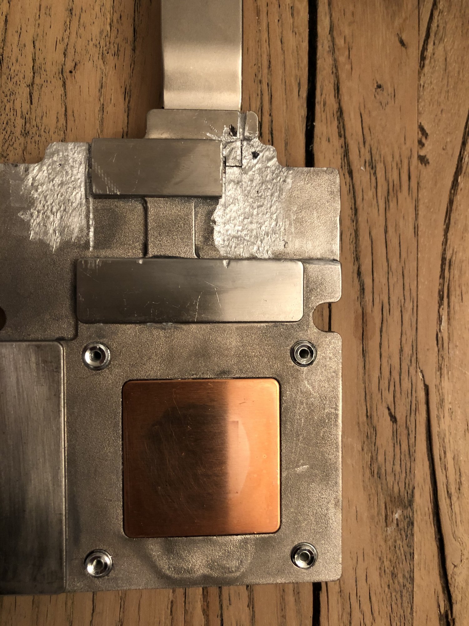

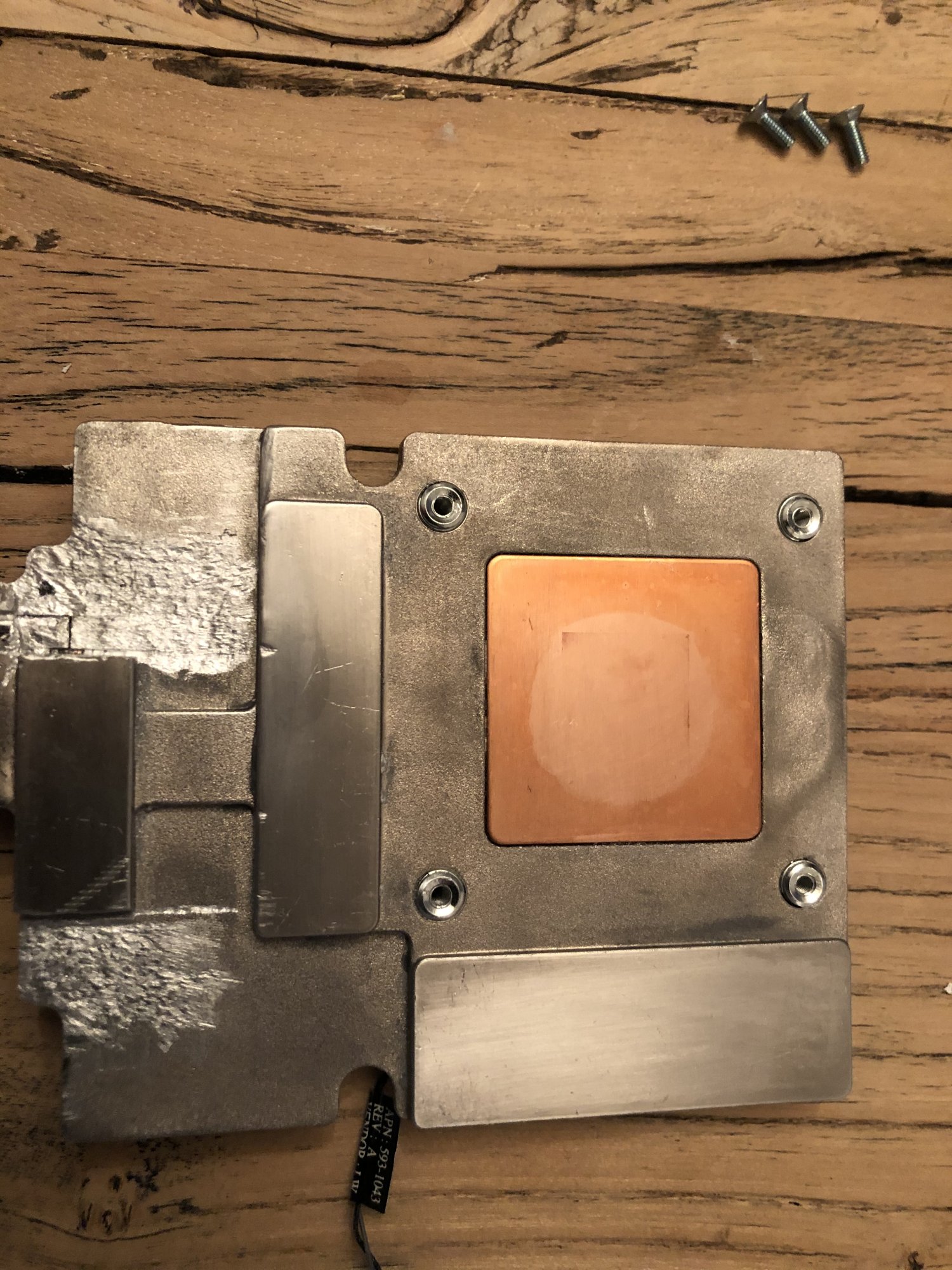

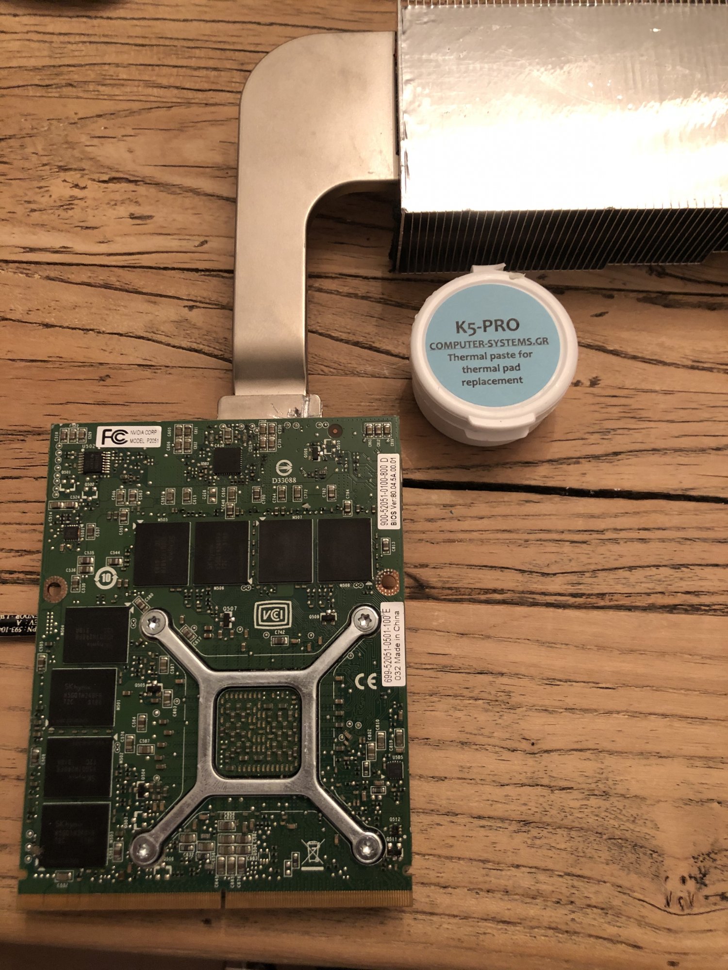

went on with my 3th experiment today. The k3000 videocard came in. Had to modify the 2-pipe cooler a bit to make place for the spools right on top. Tricky is the piece you have to cut out just besides the pipes......
Save the install for tomorrow. Good night all.

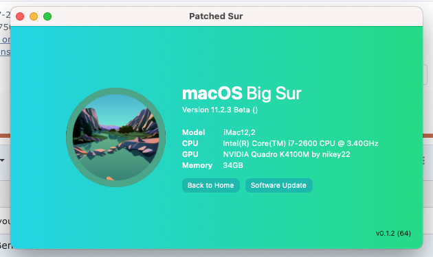

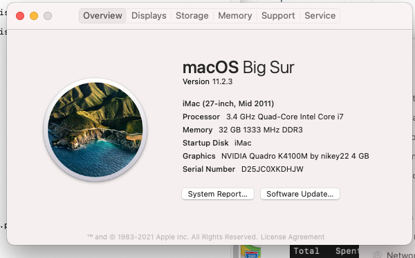

Hi, I installed Big Sur 11.2.3 using the latest OCLP (0.1.0) on my iMac12.2. It worked very well but the only problem is that it does not recognize the thunderbolt display (was working in HS and Catalina). I did a quick search but did not find anything useful. Might anyone know the reason? The GPU is K4100M using nikey22's vbios. For the OCLP GPU option, I used NVIDIA. Thank you for your help!
