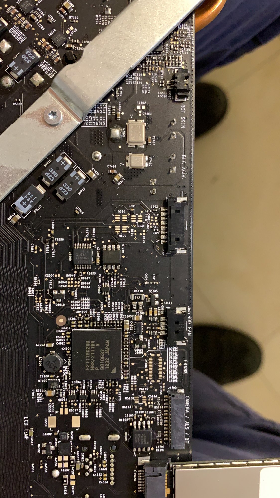

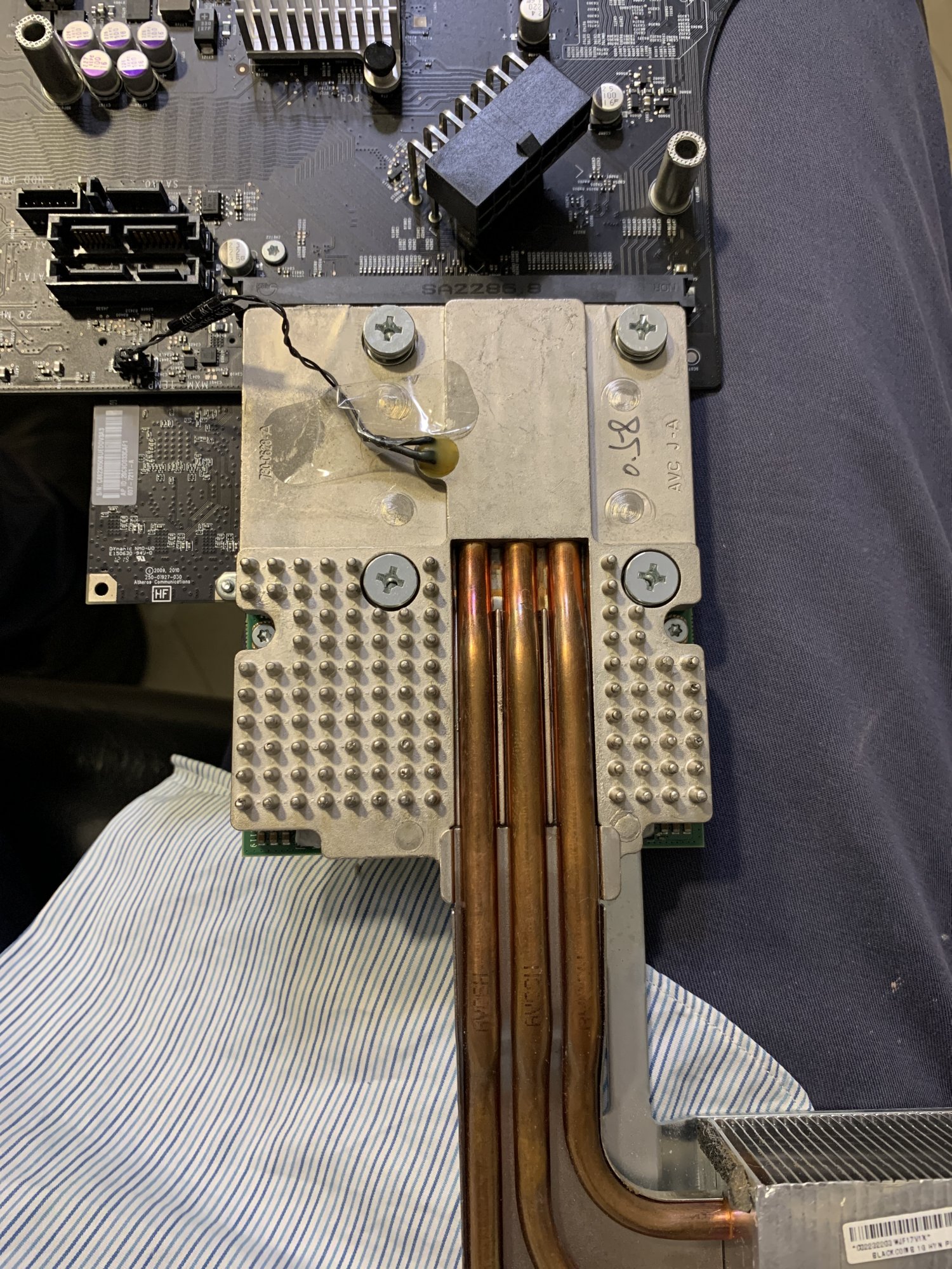

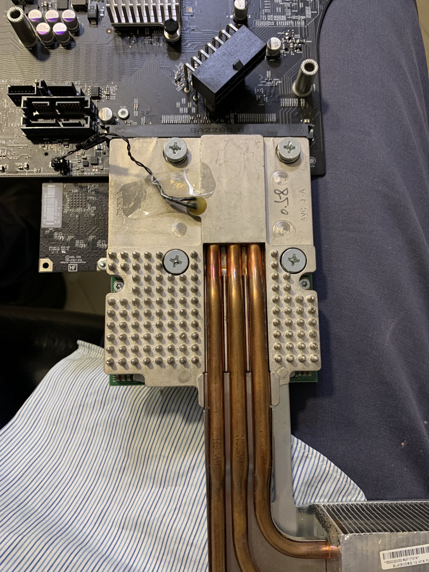

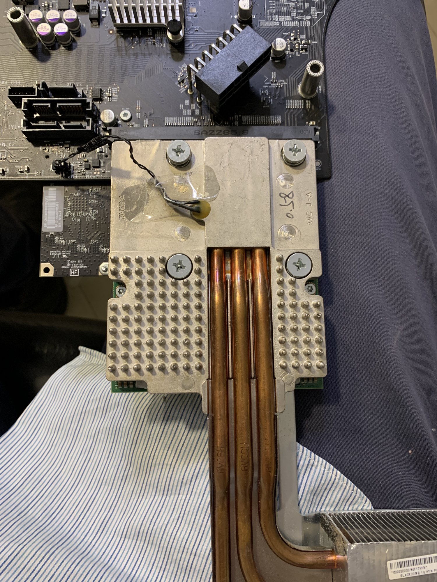

thanks for that. in the post @Ausdauersportler attaches a photo of the heatsink with 2 Sensors!!! Mine only has one where does the other one connect to and what is it???View attachment 1761700
@Ausdauersportler this is the only empty female connector on the board
And it’s empty for both of my machines

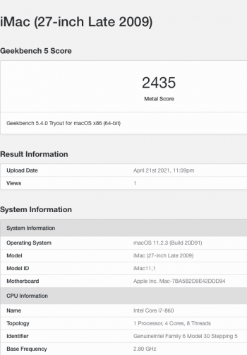

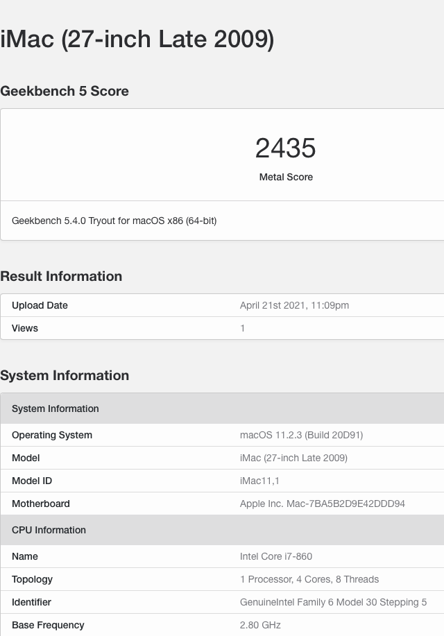

The 2009 with the K3000 als running on Big Sur.
Again a little bit hassle with the black screen, but keep calm and follow the route, no problem.
Tomorrow setting up the 2011 i7. Very curiuos for the benchmark of the GTX770M.

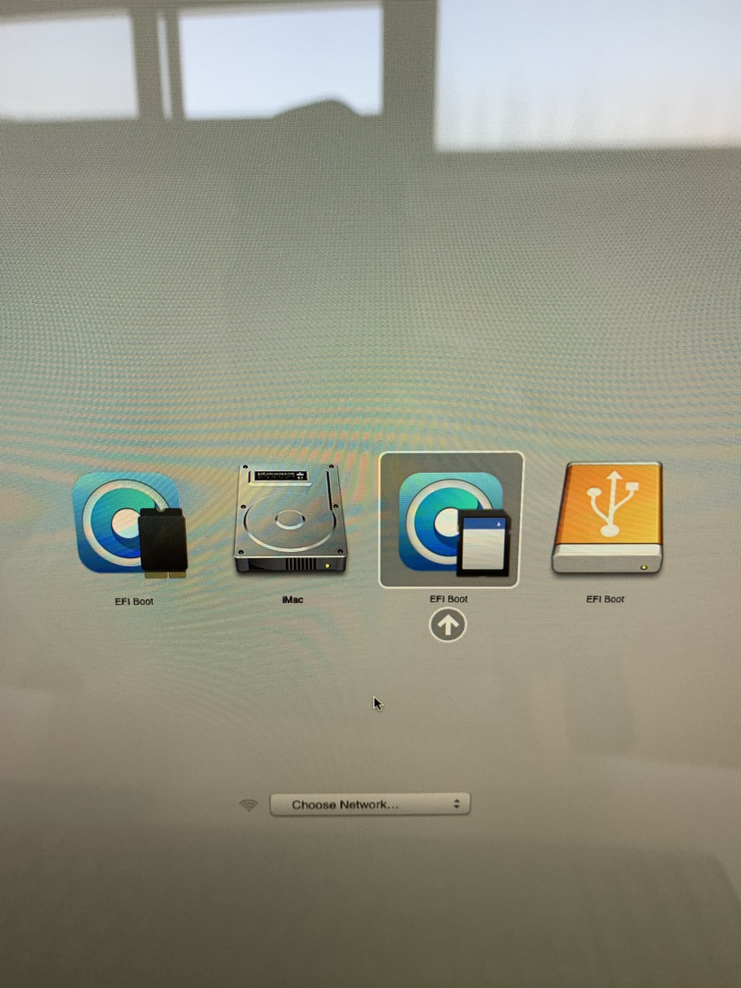

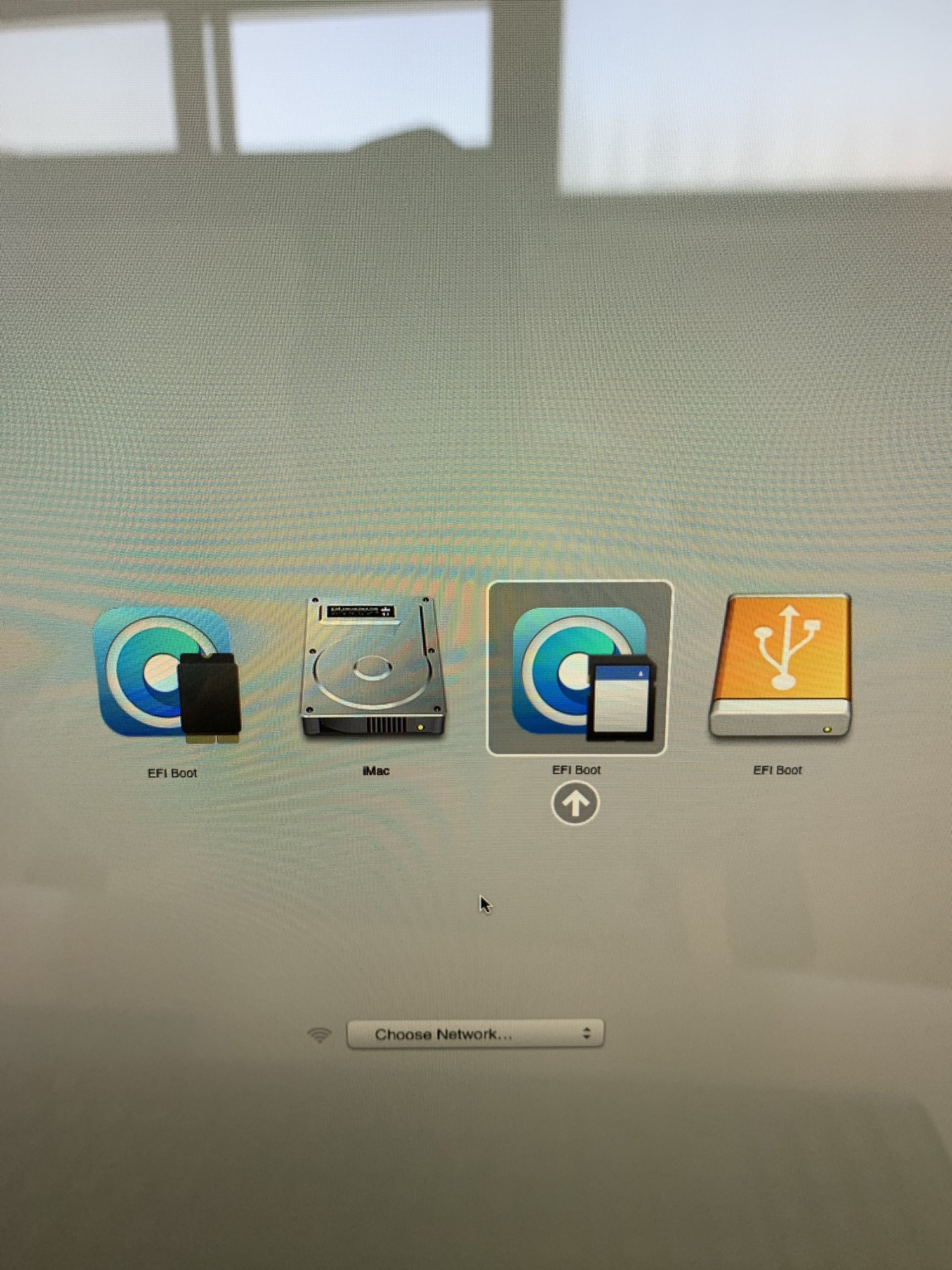

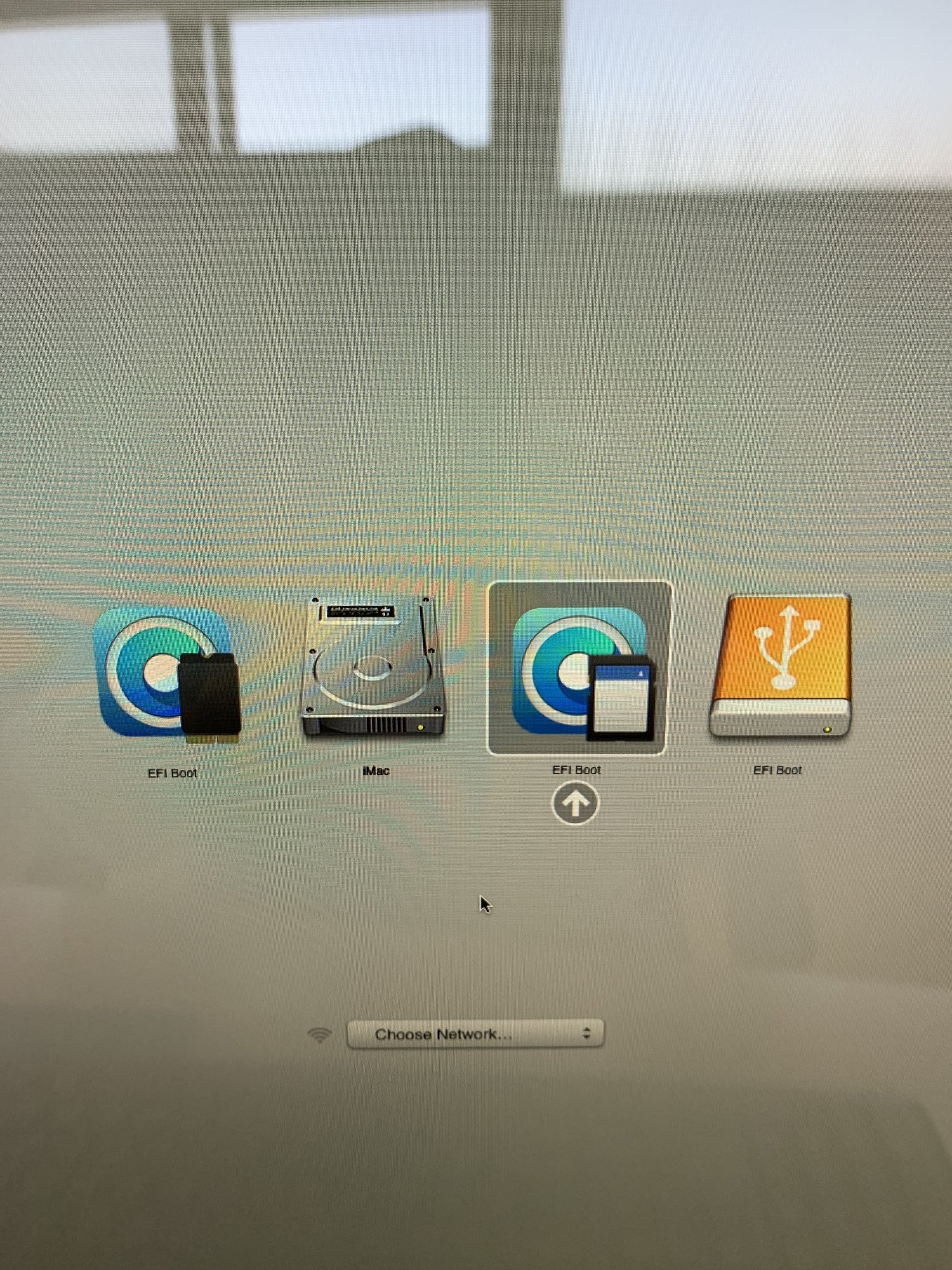

You have installed OCLP twice: once on the EFI partition of the hard-drive and once on the SD-Card. Since you have a Nvidia card, you can pull the SD-Card.
I flashed the card again with the BR.rom and its working again. Yes that was my intention to install on SSD EFI and remove the SD card, however when i do that i get a white screen with a crossed out circle... any ideas.@Ausdauersportler
Reset your PRAM. Choose ALT/Option in order to choose the SSD EFI. Then choose your OS hard-drive. If it is still white with the crossed out circle, then you haven't set up OCLP correctly. Did you reinstall the OS using the OCLP?
Nice pick up buddy, you're a champ. I started it on manual boot mode and selected the SSD EFI it booted fine. Took out the SD card and now it boots up like stock - Very cool.

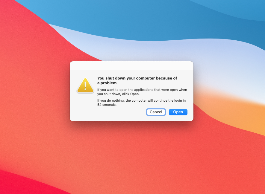

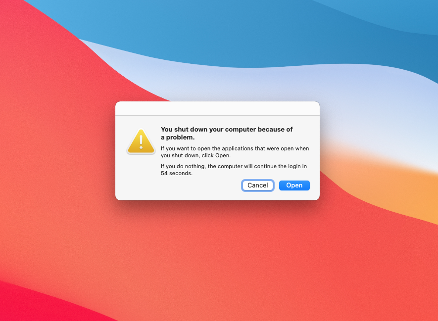

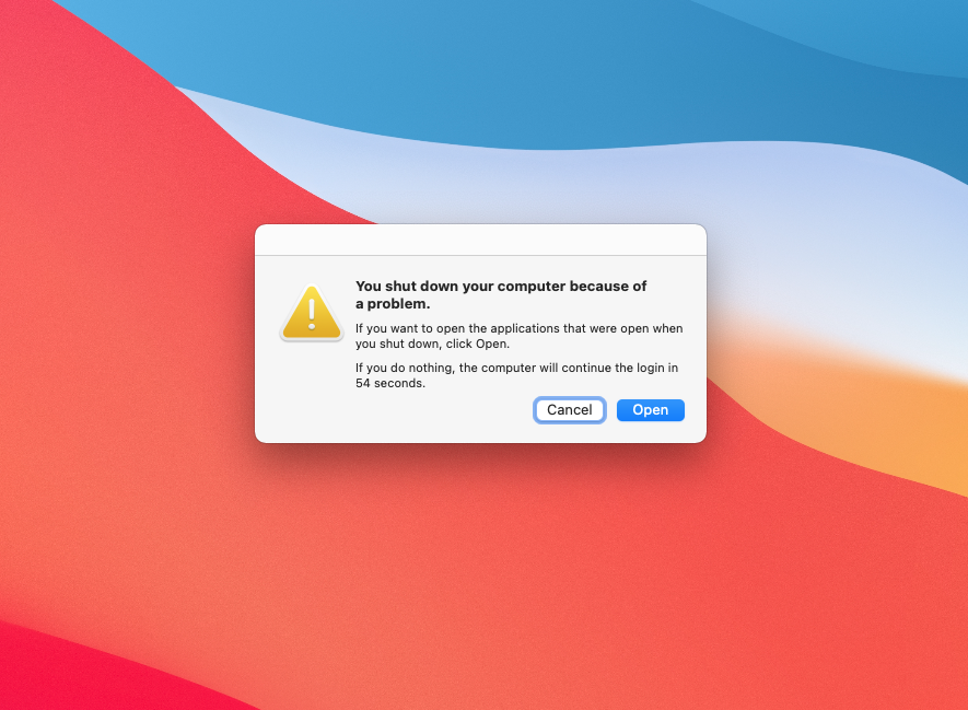

When it starts up I get this message even though it was a regular restart from the OS. With a shutdown and restart there is no message. any ideas?
That's normal because of the problems that you had before. I am sure if you reboot your iMac it won't be there anymore.
ive rebooted 4 times in a row and happened every time. The work around is to shutdown once then reboot doesn't bring up the message.
