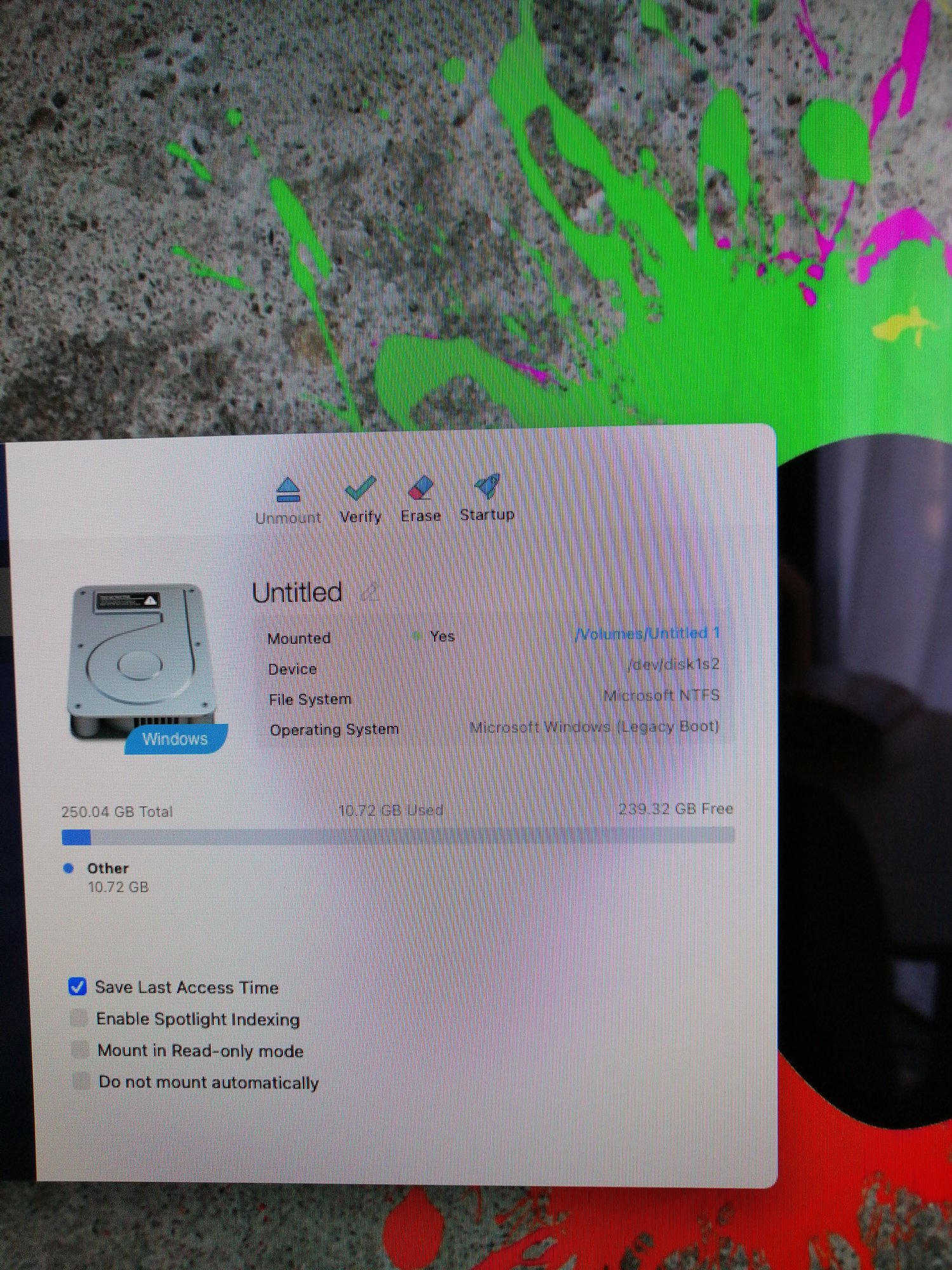

Should this be showing legacy boot i check in there and I can't find the file

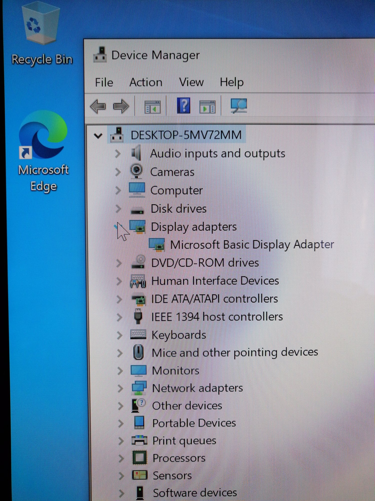

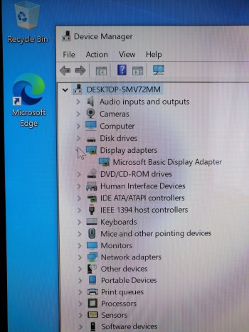

Ok so with no WiFi connected I installed windows but I don't have this 8n device manager. So how do I delete it and can I install my NVidia quadro k3100m drivers.

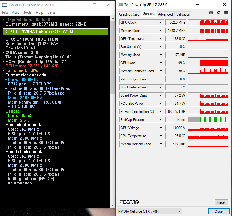

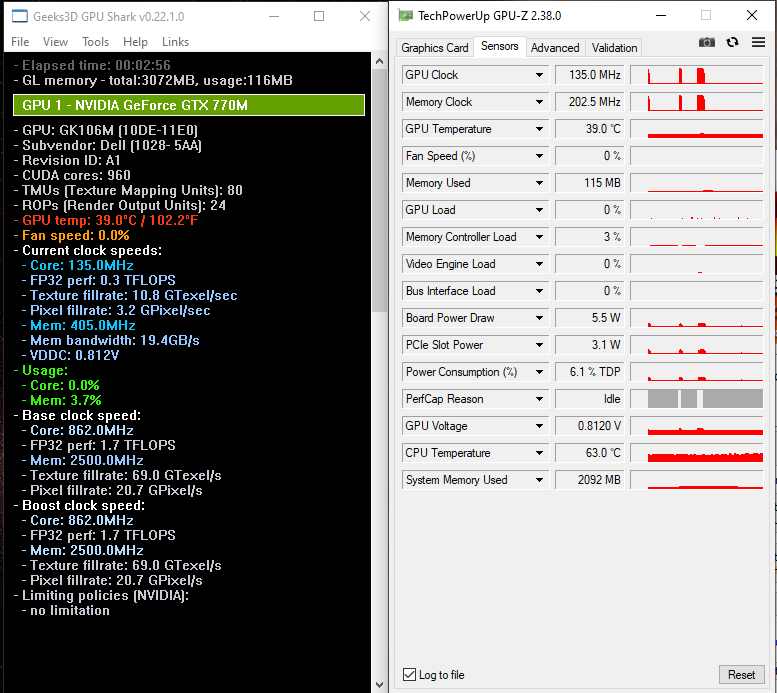

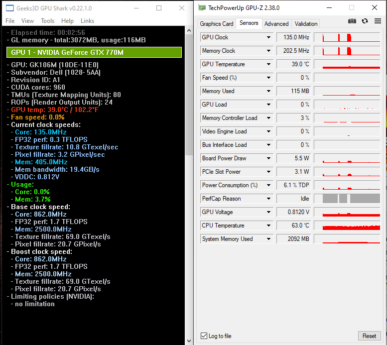

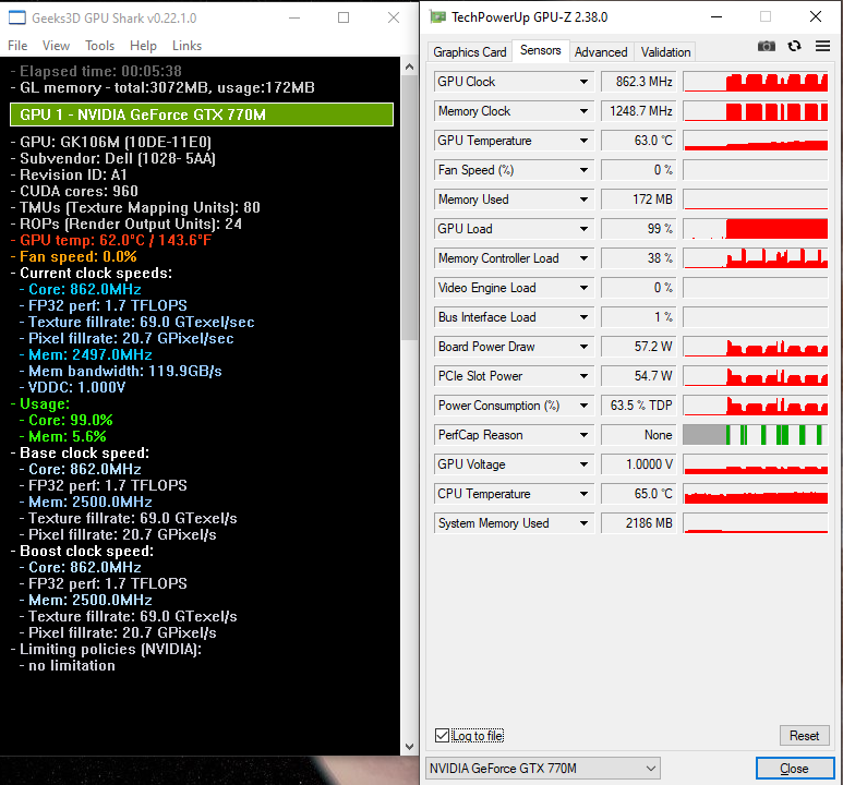

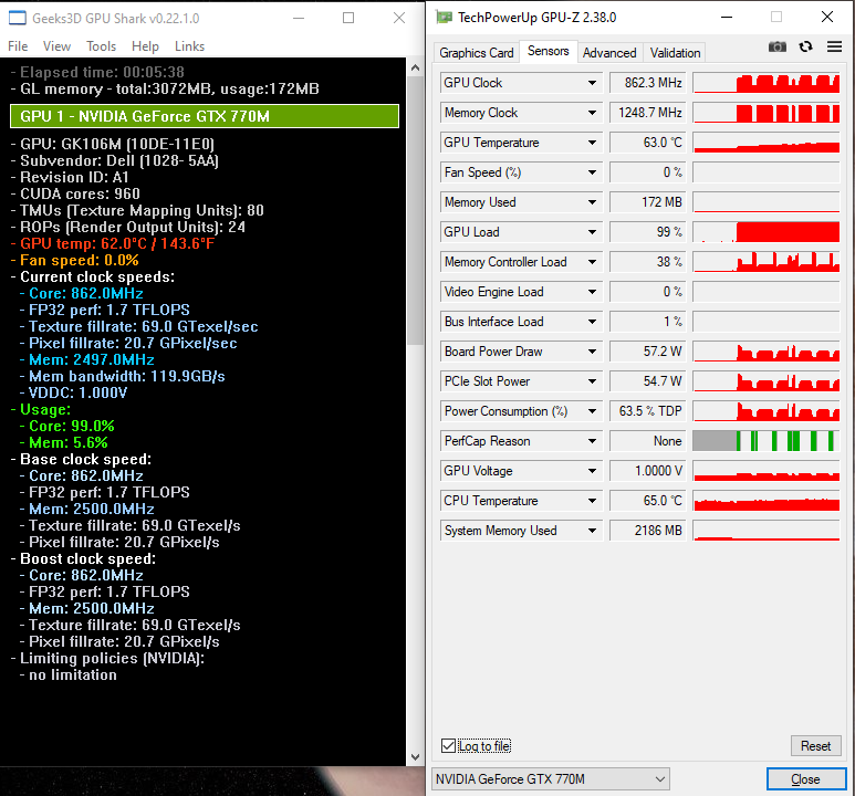

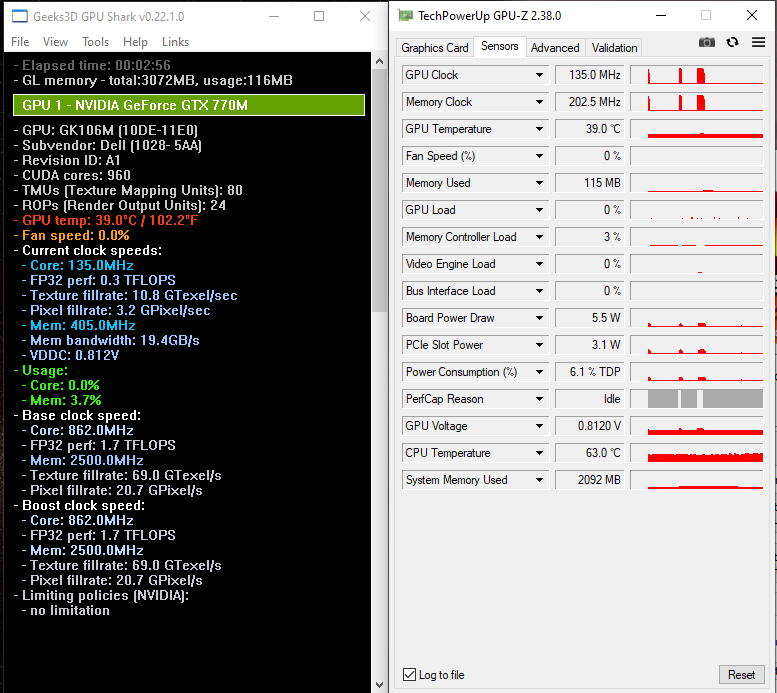

I did some further investigation regarding the power useage on my 770M through software. It's interesting to see that at an initial max GPU load of 862MHz @ ~58C it reports a power draw of ~57W prior to signature throttle cycle to at a min of 135MHz (23W) before the process repeats. Reducing the imac mem to 4GB causes this throttling behaviour to be somewhat reduced.
Now if the actual 205W PSU is tired and underperforming due to age then the ideal 10W headroom I assumed to be available may in fact be a lot less (evening running at 80% eff) leading to the present situation. Perhaps reverting to the i5-2400 (i.e. power reduction) and further K5 pro paste on the VRAM (i.e. heat reduction) may be the only option left for using the 770M in the present configuration.

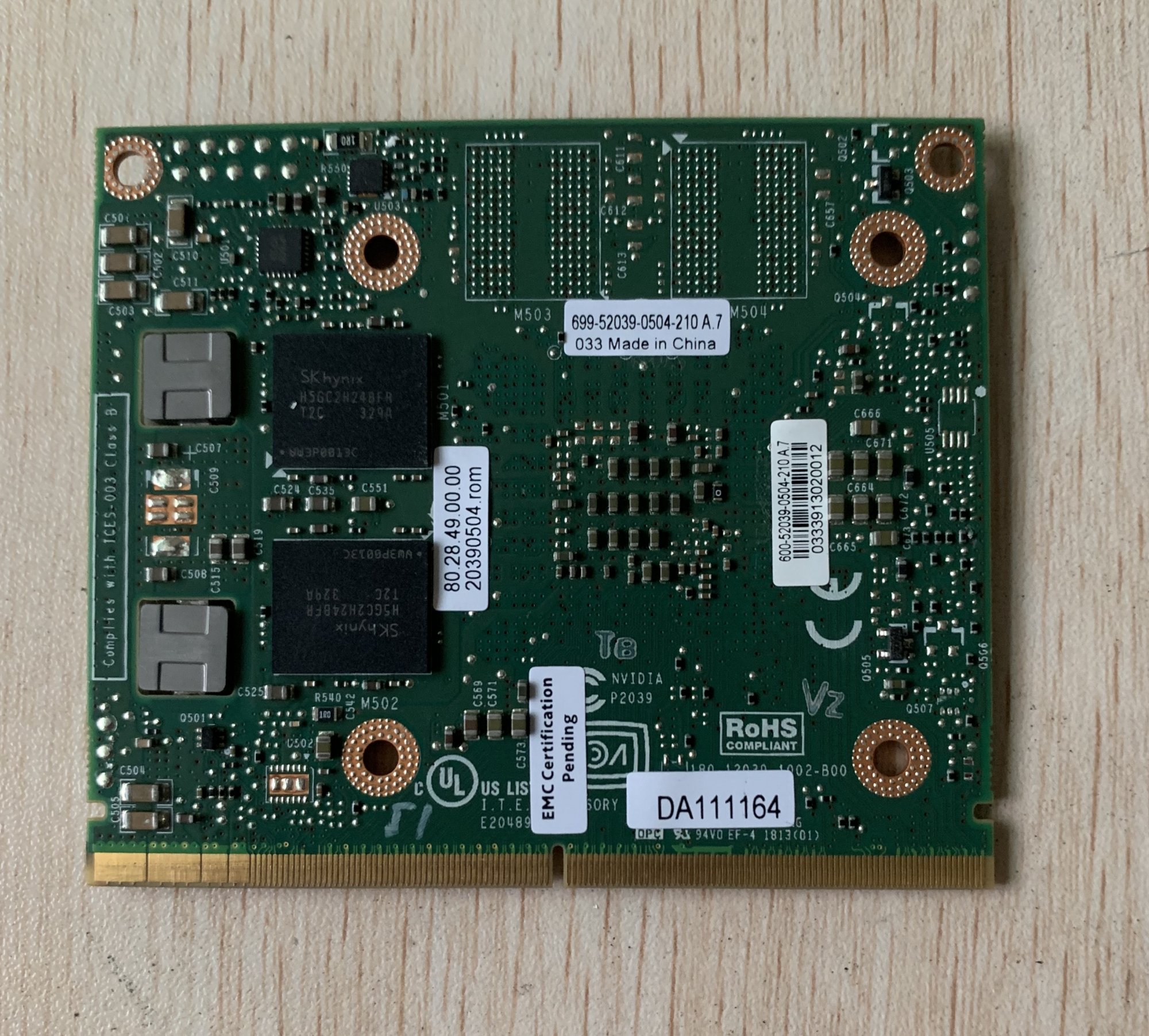

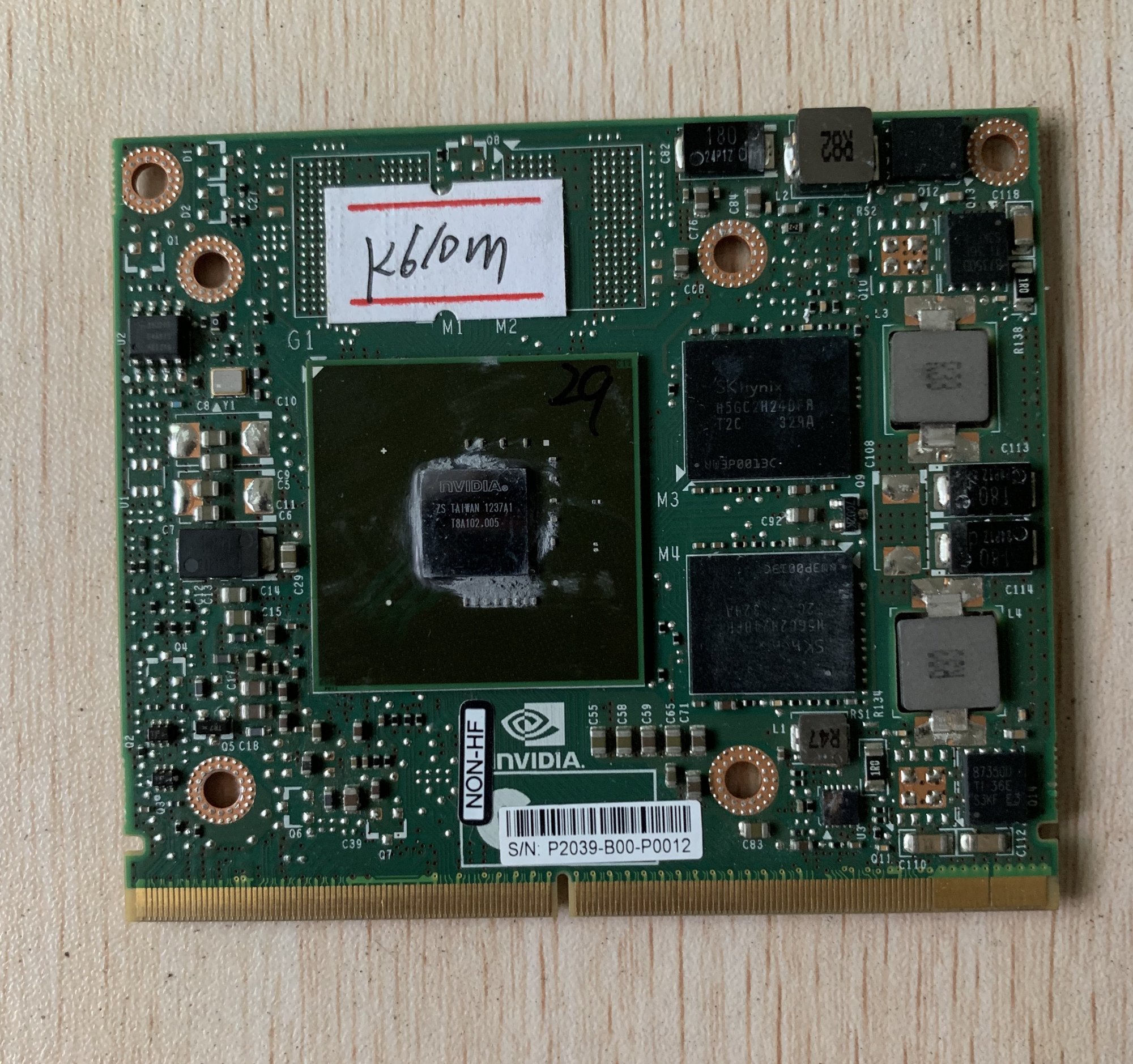

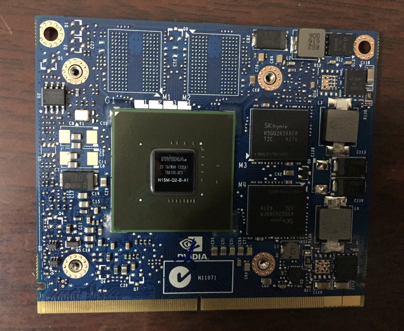

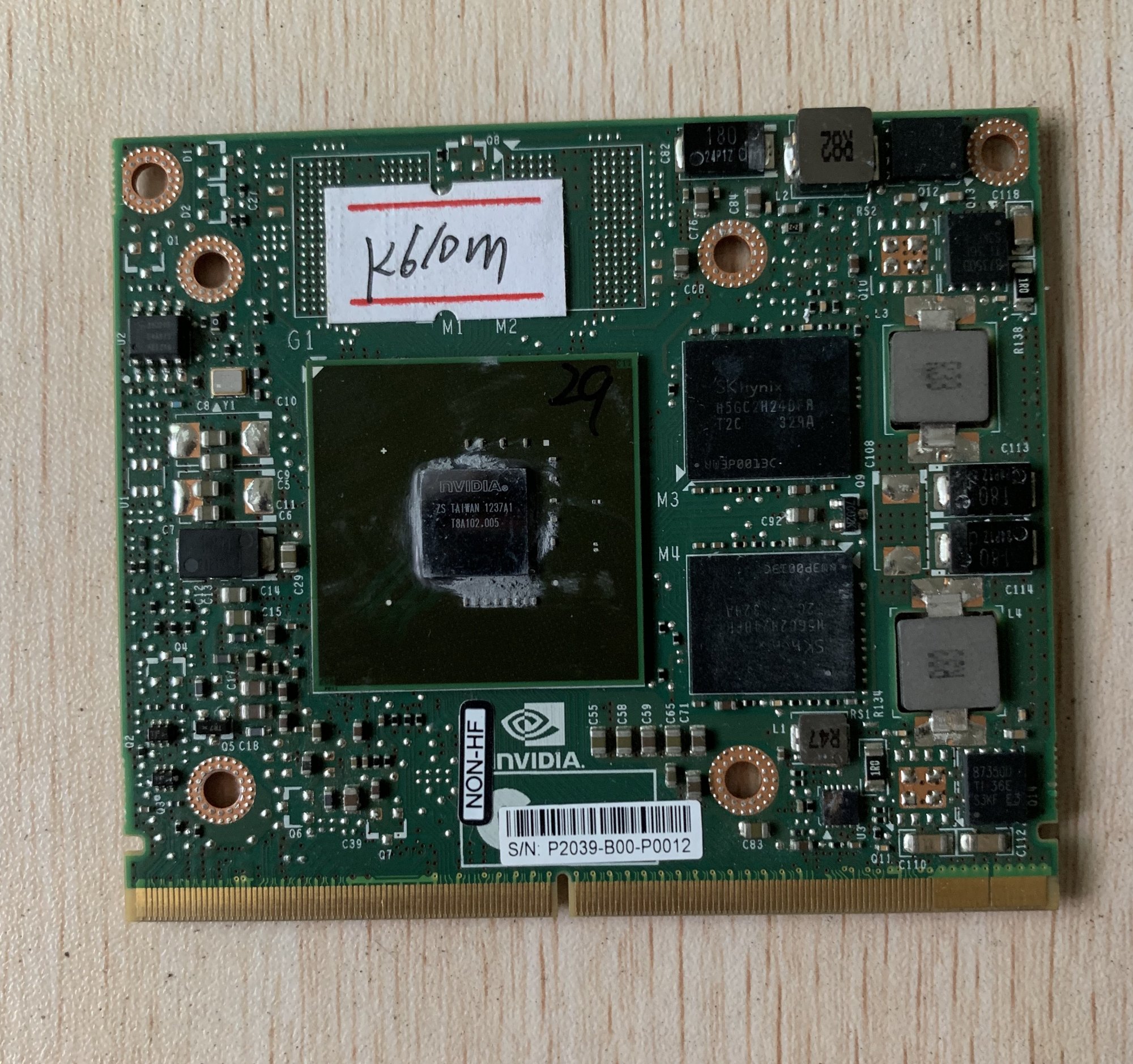

Hello I found k610 used on marketplace but usually all the k610 that I saw have only 2 chip of memory for each side of the card
I write to the seller to send me more near photo of the memory and gpu die to check if its really an k610 card
Somebody else saw this kind of gpu card?
I did some further investigation regarding the power useage on my 770M through software. It's interesting to see that at an initial max GPU load of 862MHz @ ~58C it reports a power draw of ~57W prior to signature throttle cycle to at a min of 135MHz (23W) before the process repeats. Reducing the imac mem to 4GB this throttling behaviour is issue is further reduced.

I say go for it, Mr Bourne. Maybe less intermediate updates, but if you come with a breakthrough regarding throttling, maybe it is some benefit to other users.
Also keep in mind this is a 2 pipe heatsink on a very powerful card ...
Could be a K1100M, too. But you would have to check the print on the GPU to be sure.

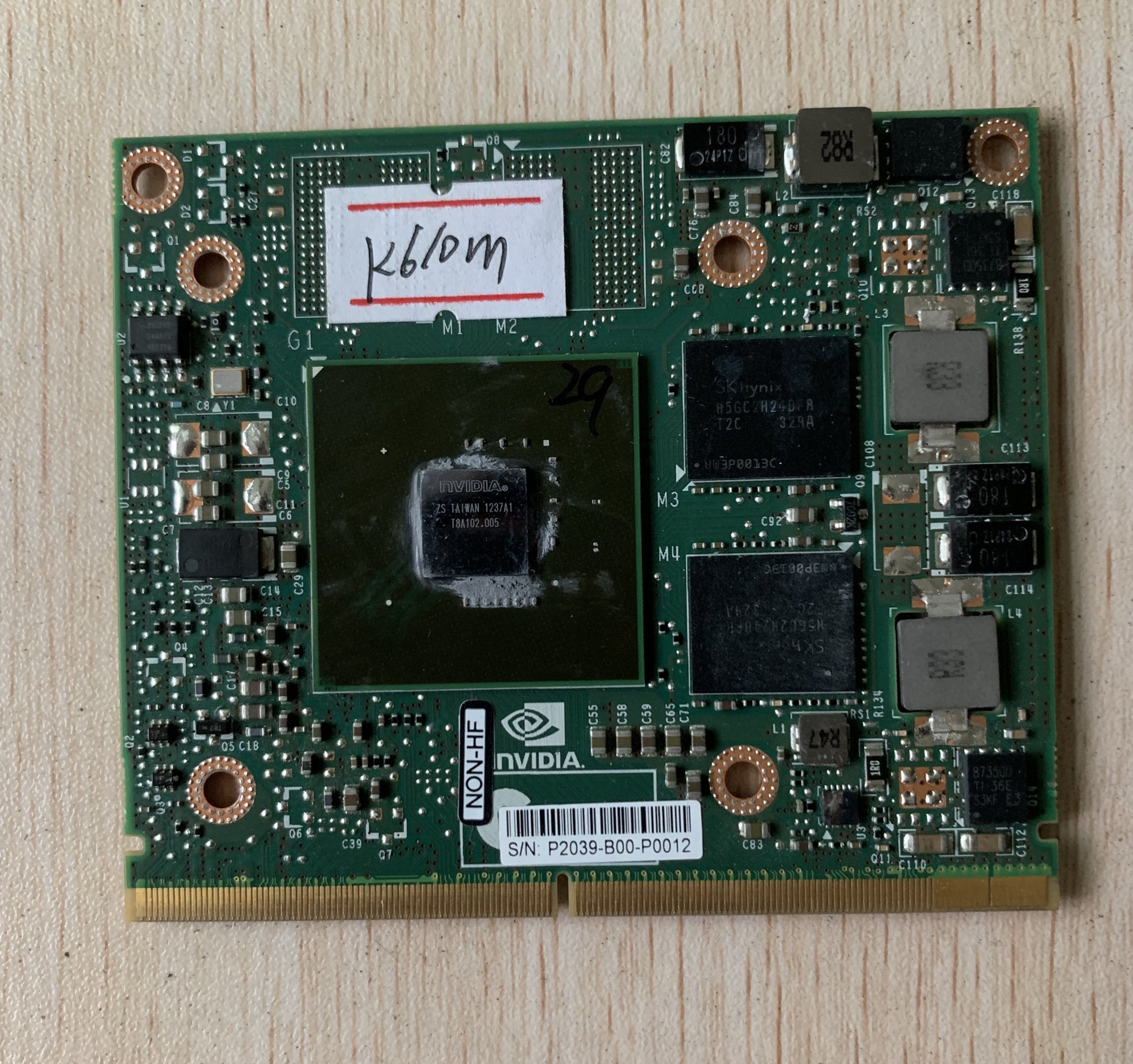

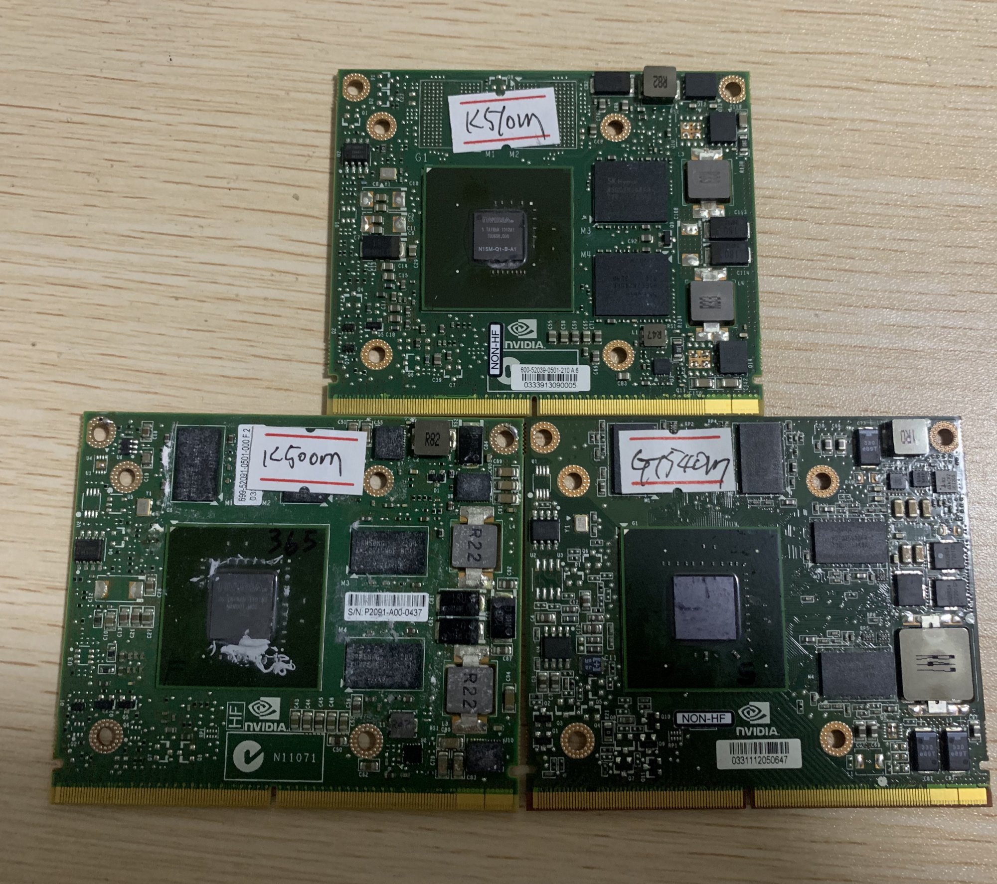

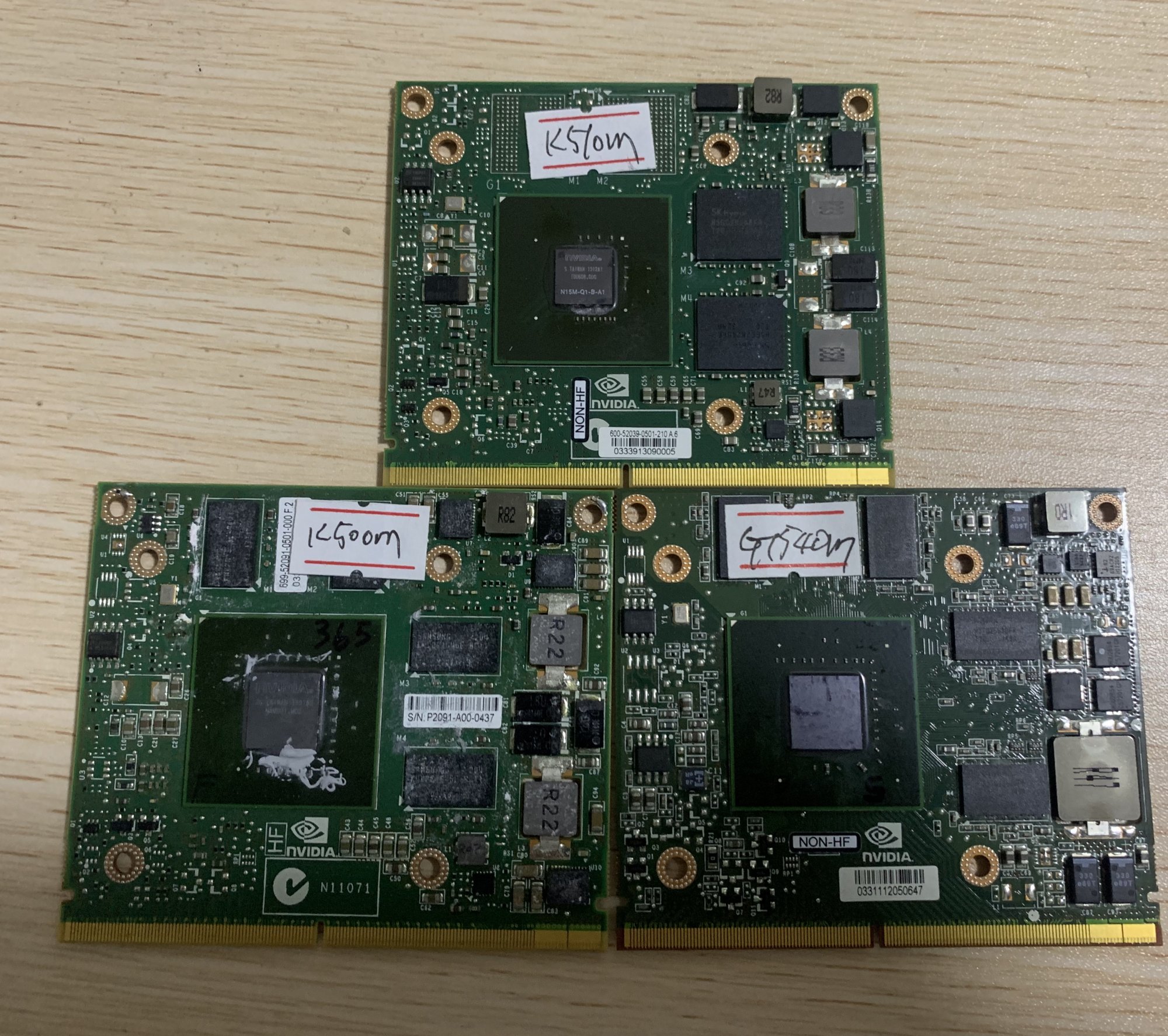

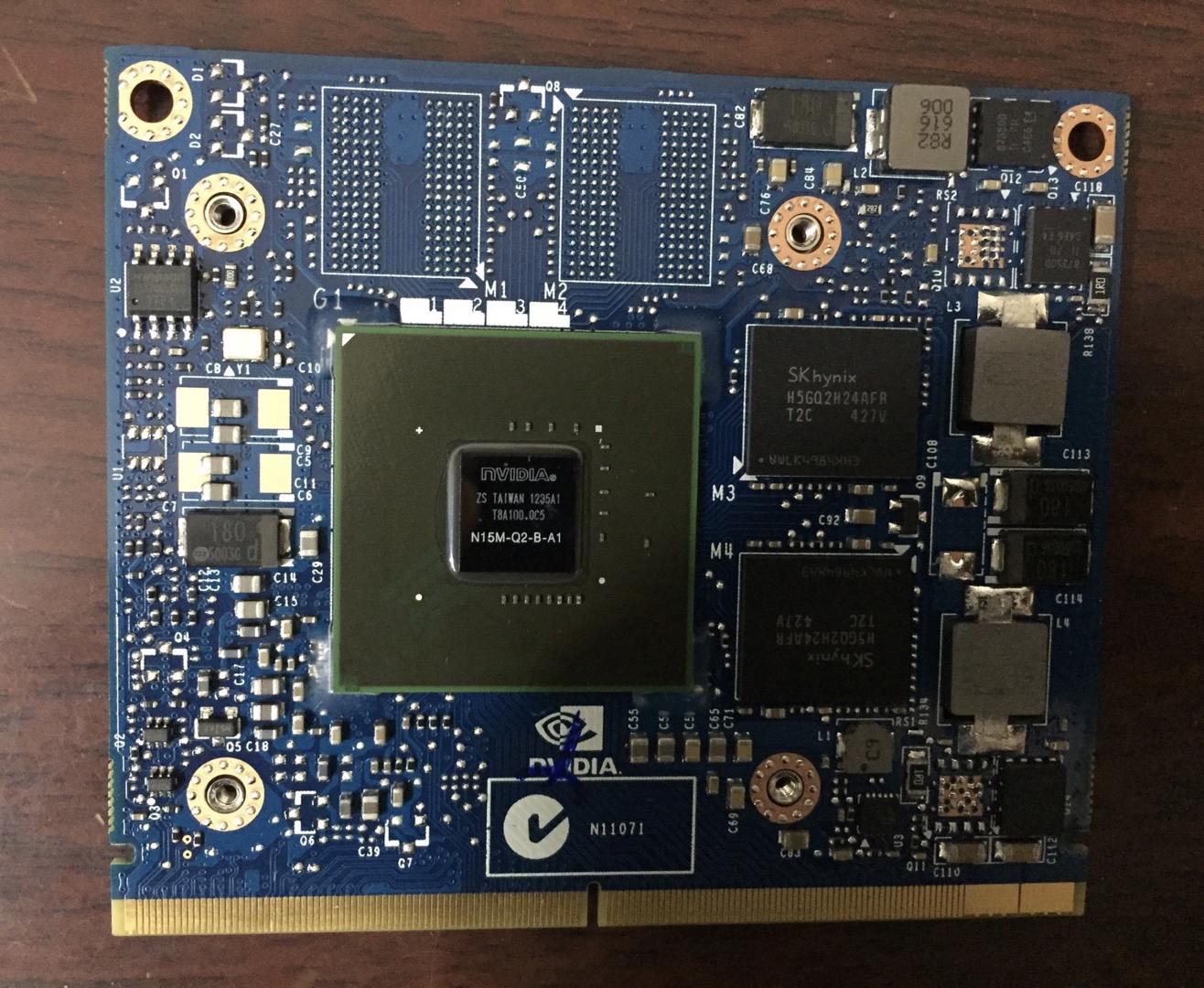

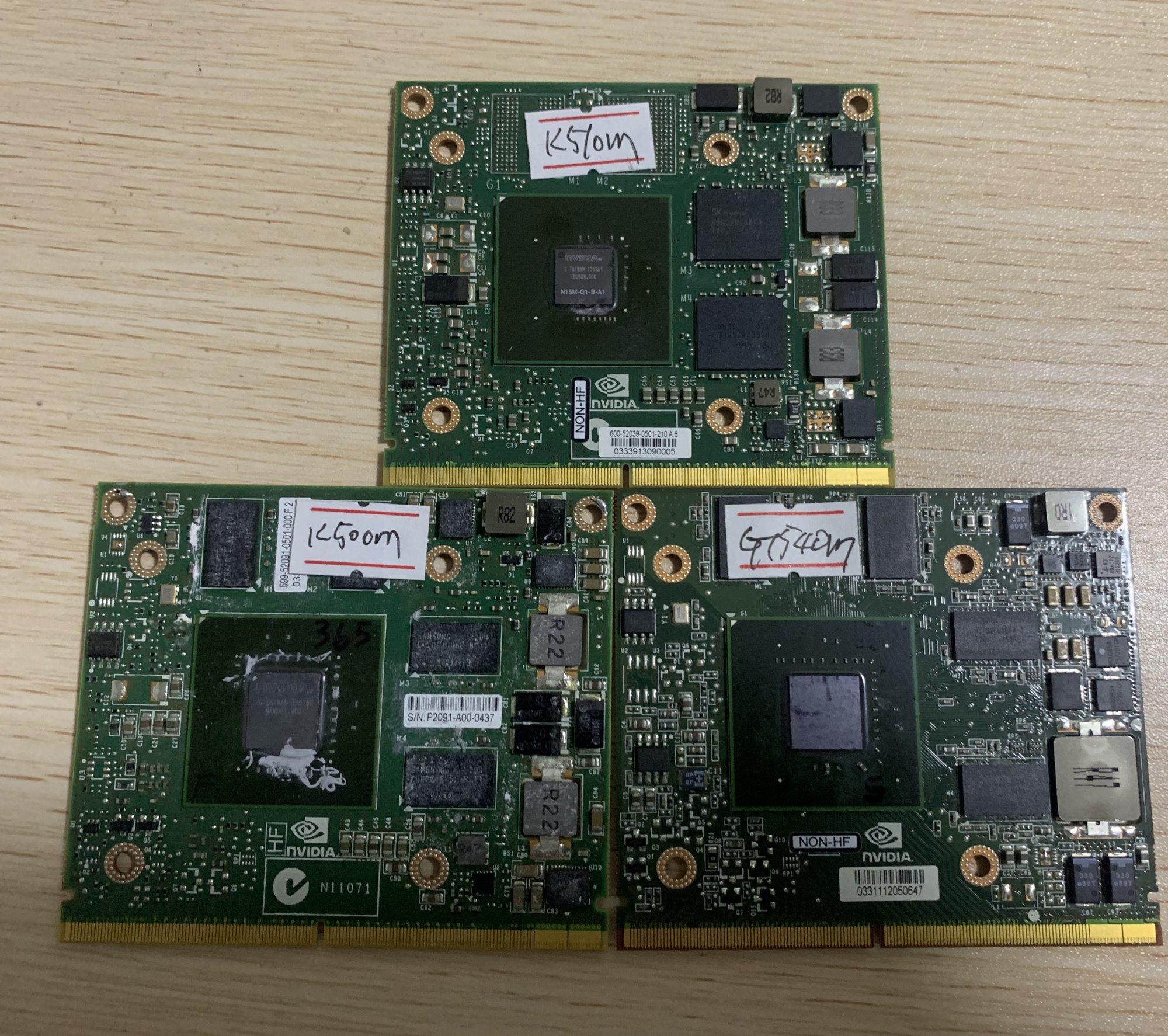

The photo you sent is hp K1100M
These three photos are OEM manufacturer HP K610m Nvidia public version k610m
There is no difference in use, but the color of the pcb board is different. The Nvidia public version has seen more than a dozen of Hynix video memory, and the HP version has Hynix Samsung Elpida video memory.
I have also seen some NVIDIA public version of K510m and K610m are very similar

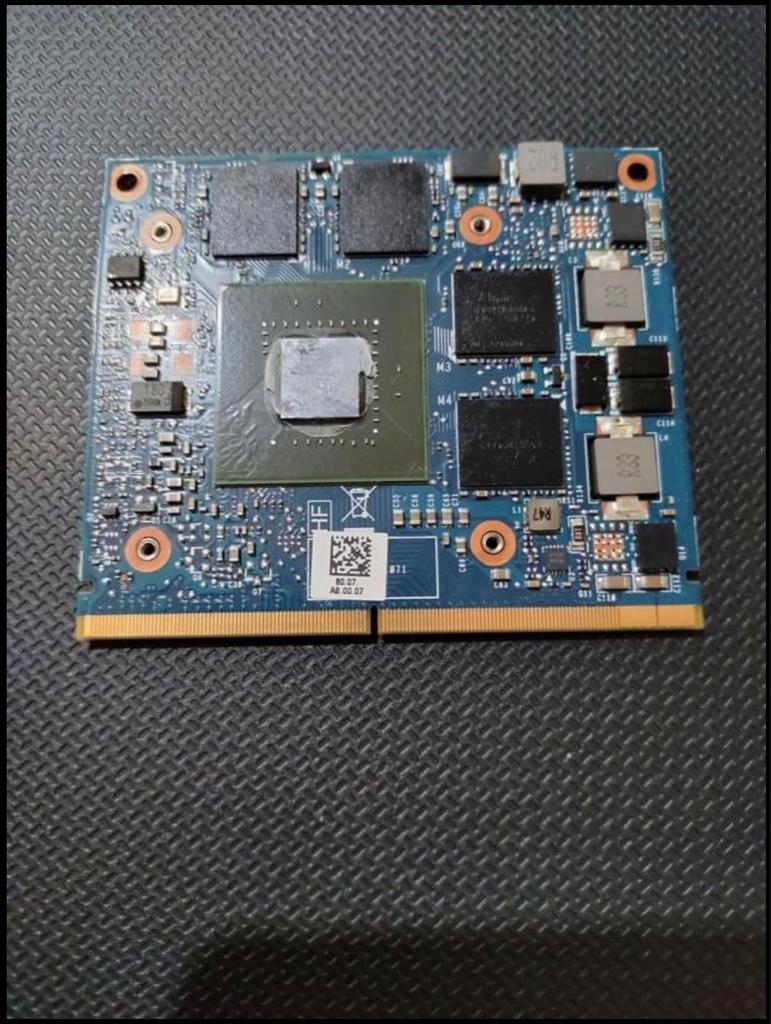

K610, K1100m, K2100m appearance are quite similar. Difficult to distinguish without looking closely to the GPU die.

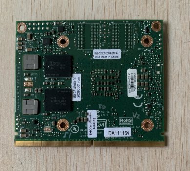

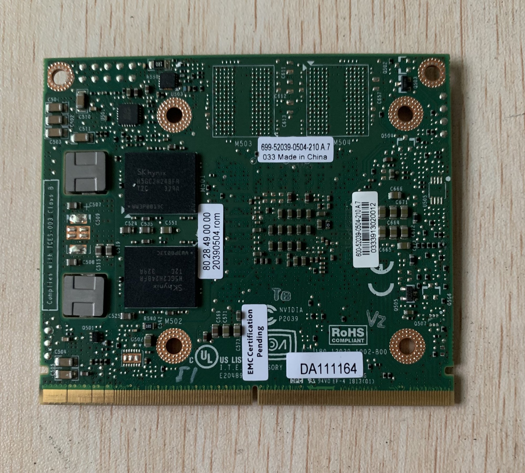

According to the code on the sticker with the QR-Code, 80.07.AB.00.07 should be a K1100M:
