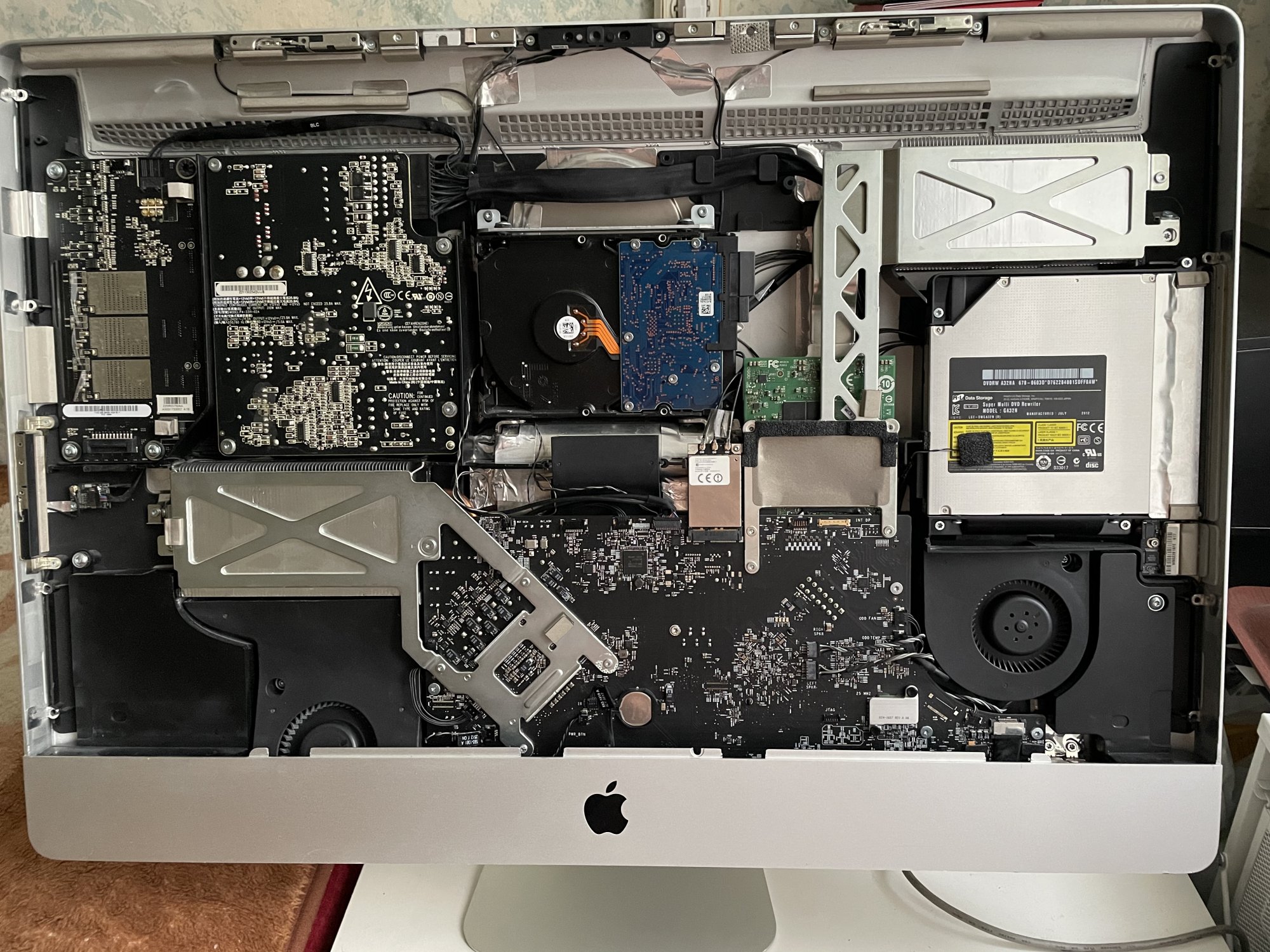

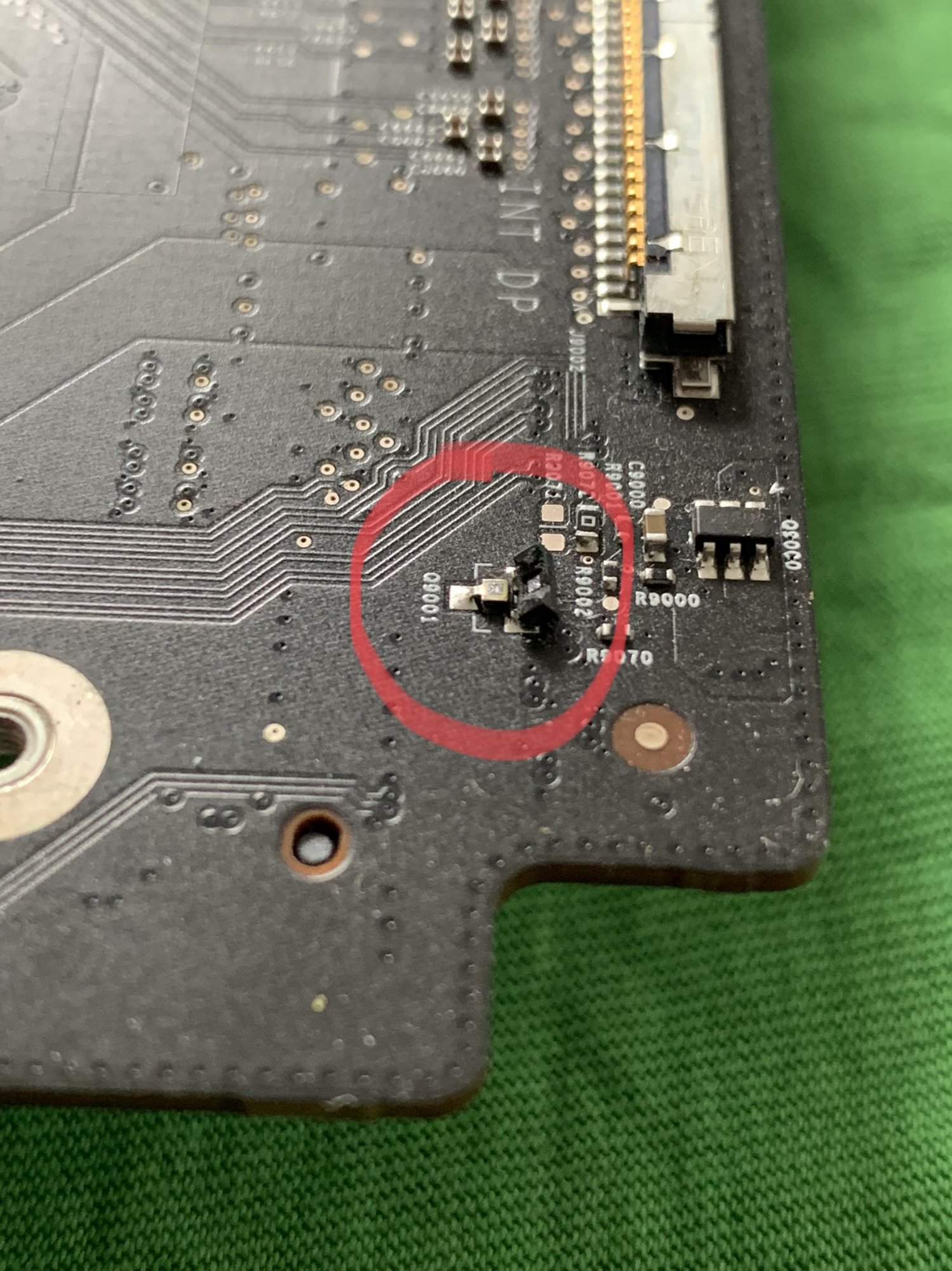

Black Internal LCD issues (while external monitor works)

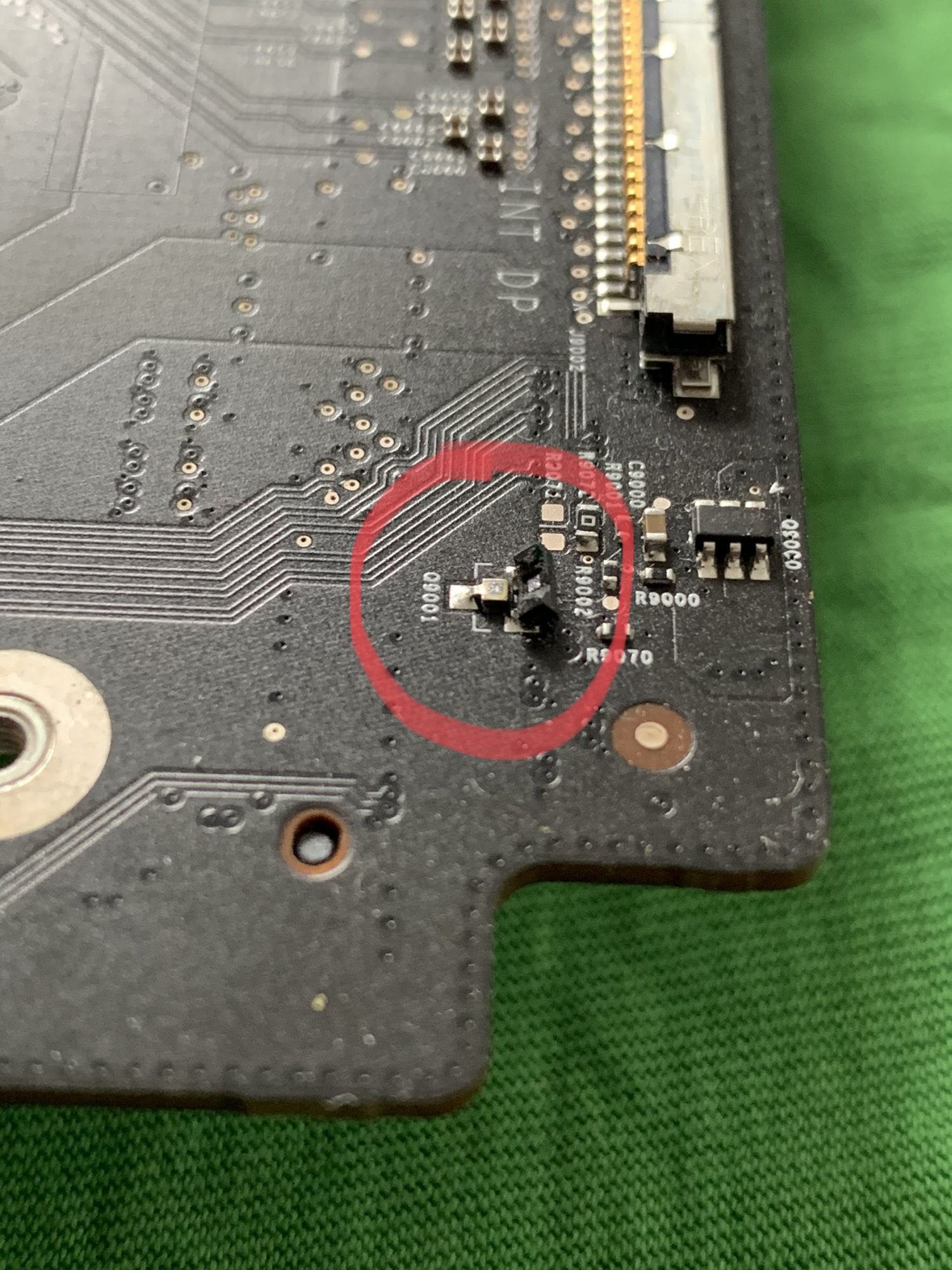

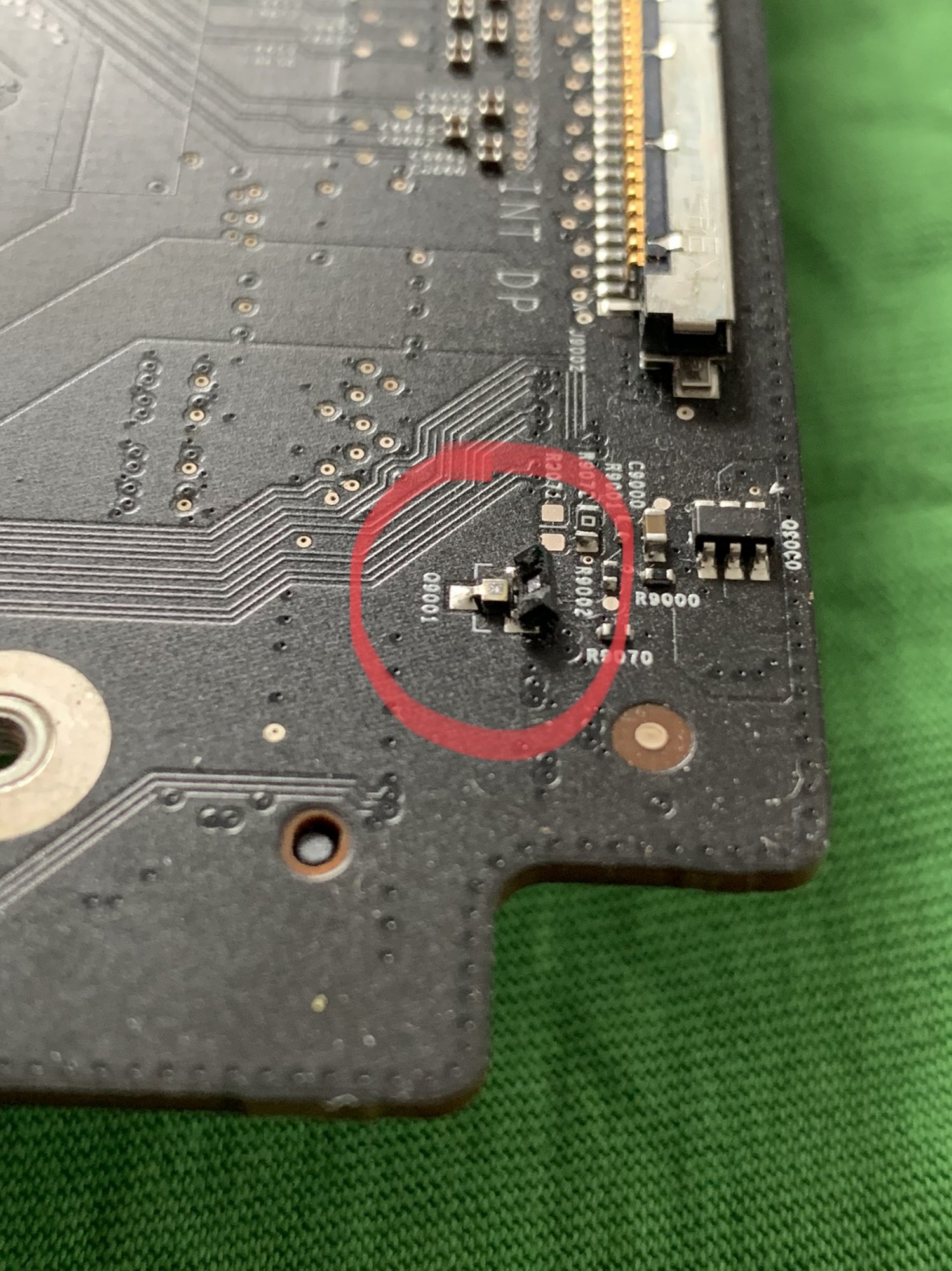

I write this post to summarize the issue I faced. This is a hardware issue.
iMac 27" late 2009
iMac 27" 2010

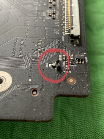

Issue: Black internal screen while external monitor displays image well. Backlight does work, confirming by the glow under the screen change when I tried changing the backlight level.
Cause: knocked off component on the logicboard. This occurred when I shaked the heatsink to remove the MXM card.
Location of the component: 3cm above the bottom right conner of the heatsink frame. (Mark Q9001)
(I will upload my photo later, or you can see details in this thread )
Component: 2N7002k (the mark on the component will be k72.., where the dots are replace with letter to indicate year and month of production). Some say it's a transistor, some say it's a mosfet. I think it's a transistor. It's sold on Aliexpress at 1$ for 100 units, plus shipping.
I bought 20 from a local shop for 3$ (faster delivery) and brought both of my IMacs to a cellular phone repair shop to get them soldered to the logicboard. He charged me 2.5$ for the fix.
Hope this info help those who were lazy and reckless like me.
How to prevent knocking off this component again: Insert a hard plastic card (bank card, etc.) under the metal frame before shaking the MXM card out of its position.
Or do it right by removing the whole logicboard from the case when changing the graphic card.
iMac 2011 doesn't got this issue because the MXM card cannot be removed without taking out the whole logic board out first.

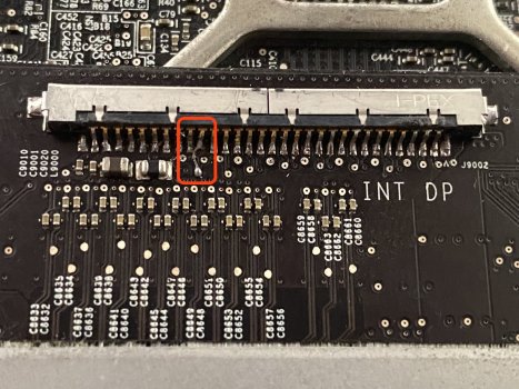

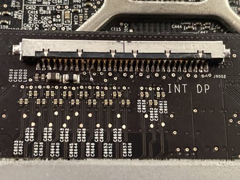

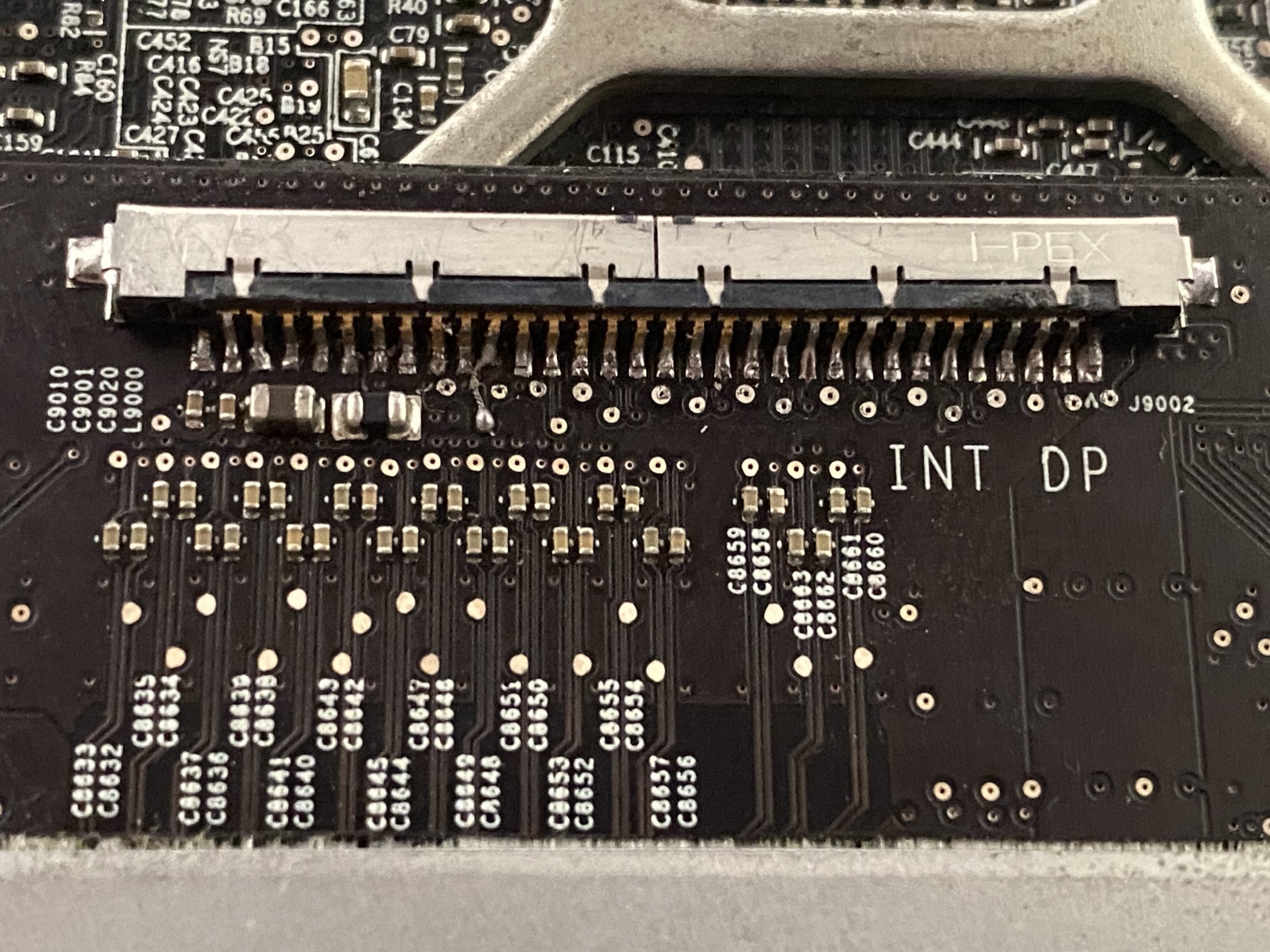

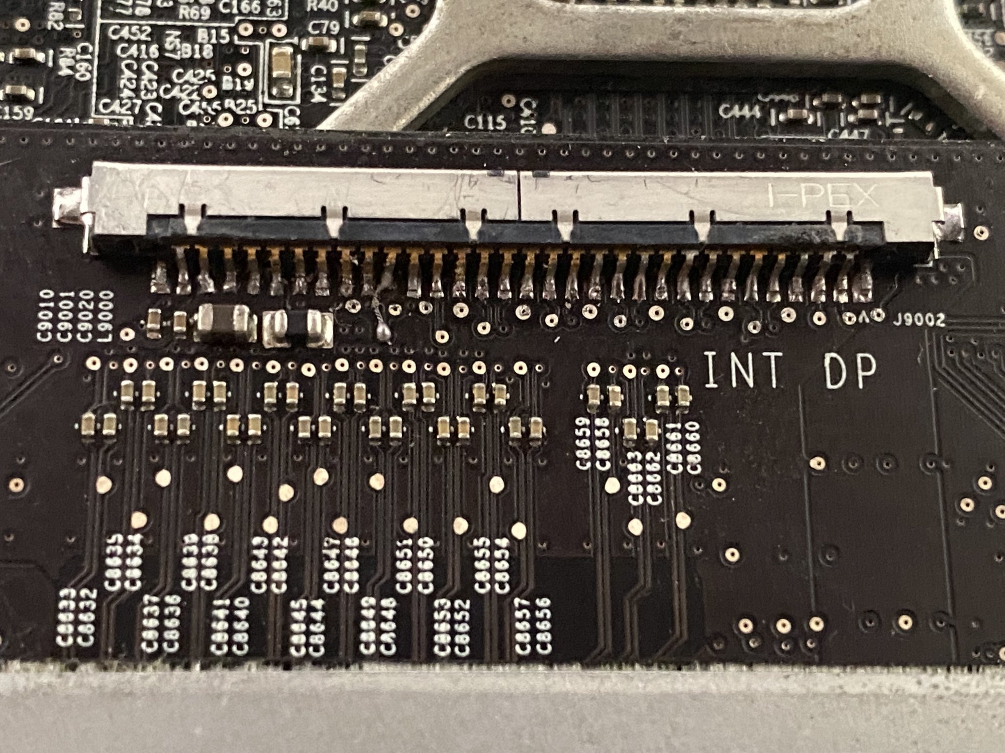

I’m having the same problem, black screen while trying to install the K3000m on my iMac Late 2009.
I’m also think that the LVDS connector is faulty. See photo attached.

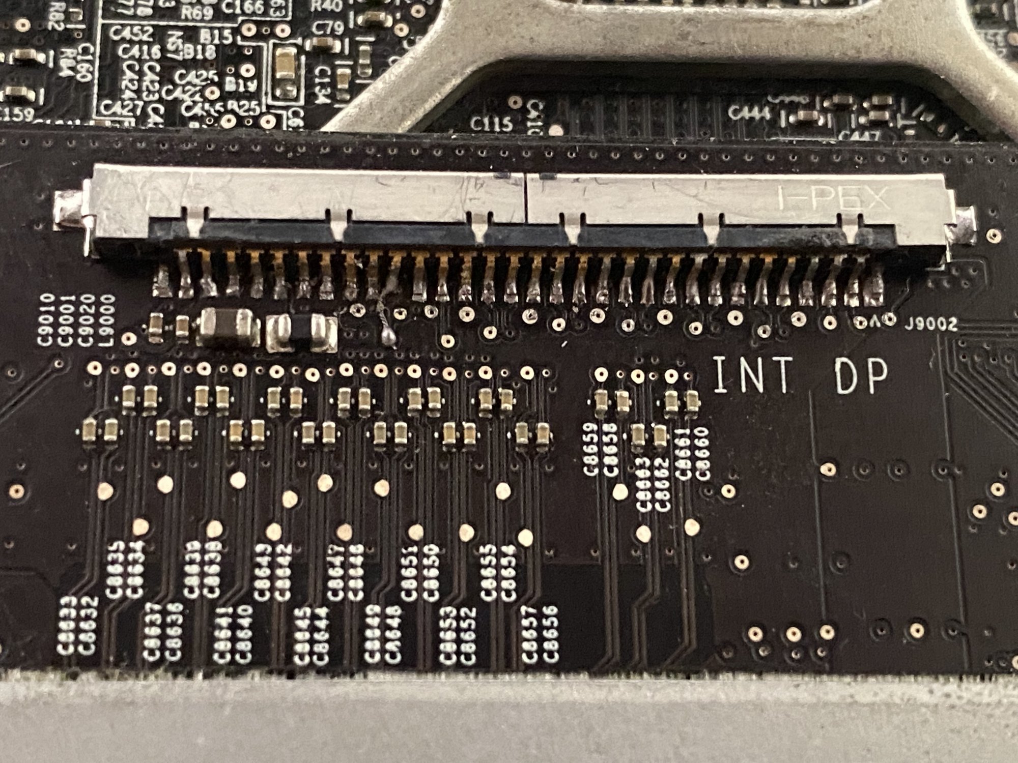

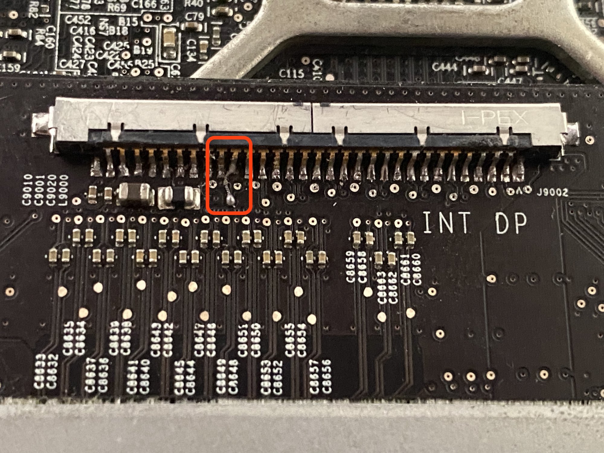

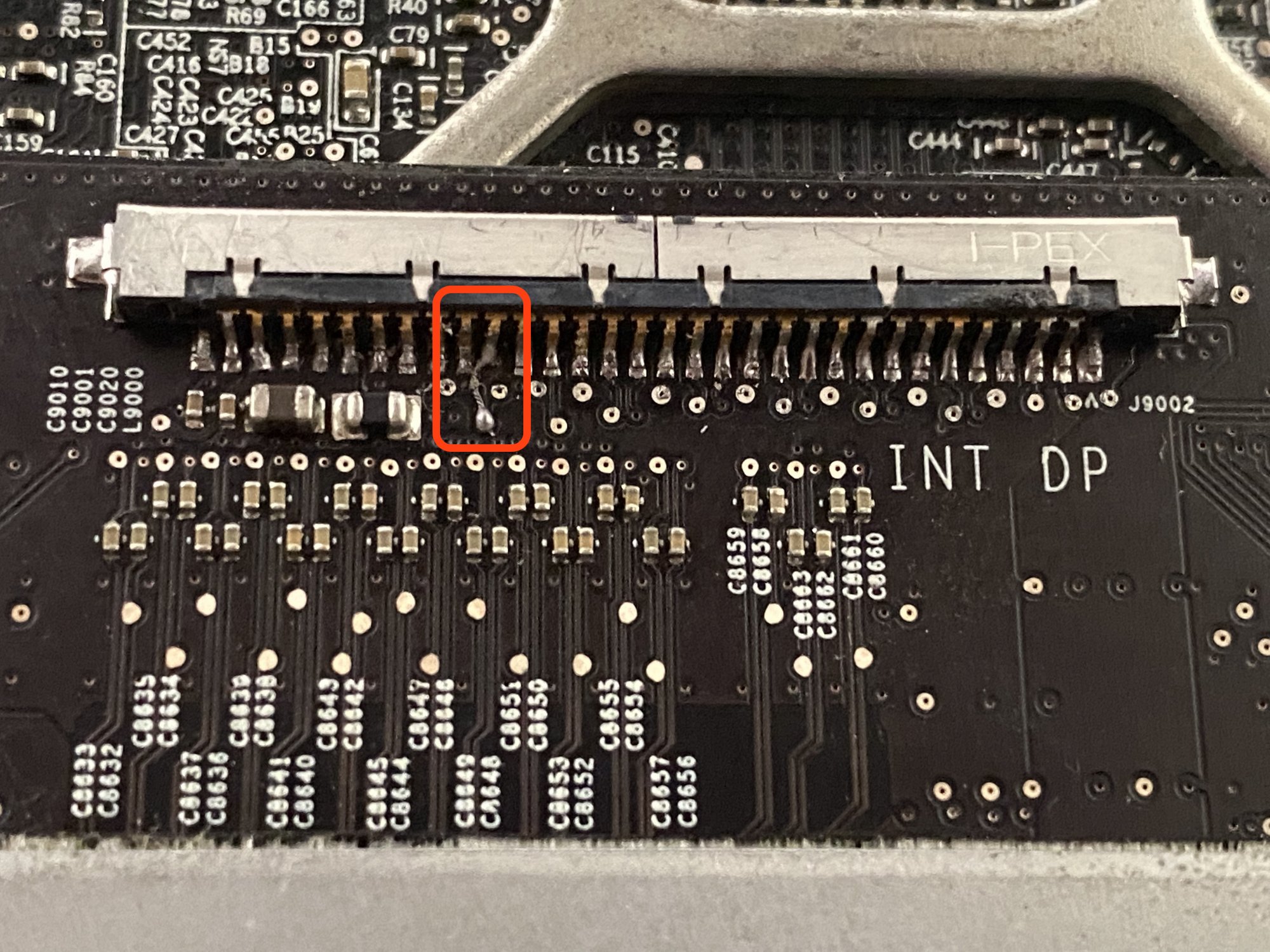

I’m also think that the LVCD connector is faulty. See photo attached.
I looks like this LVDS connector was replaced and one of the solder pads broke off, so a short jumper wire was soldered in place. Now it seems that either this jumper wire is broken or is shorted to the adjacent pin (to the left).
Do you have black screen only with the K3000M?
Thanks. I’ll fix it, just only that pad right?

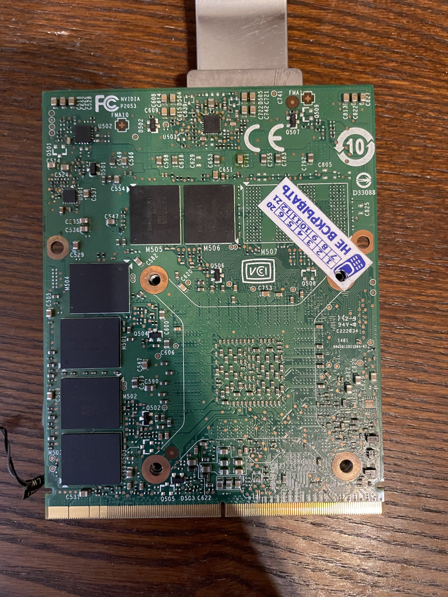

Hello, everybody.
Yesterday I installed GTX 870m in my iMac 27 2011 (12,2). Before I flashed vbios I have a black screen, but my iMac saw GPU in System Information.
Now iMac starts, work several minutes and then suddenly shutdown. After it fun starts working and there is no boot sound. Only one status LED green on motherboard. I tried to power off, disconnect from power supply for several minutes, turn it on again, and only fans working but no boot charm.
Have any ideas what’s happening and what’s wrong?

I had been struggling for quite some time with the idea to buy a stock GPU to confirm if there is something wrong with the WX4150/K1100m I installed. But Ausdauersportler assured me that it was the logic board defect. Then I found a thread which described the same issue. A careful check on my own logic board confirm that. The fix was easy after knowing the cause and buying the damaged component.
Having the same issue and looking at my board I could *now* detect that exactly the same components has been partly knocked off, in fact it has been shifted up a mm and a single solder connection broke. Now I can repair it, too. Found this thread about the issue long ago and lost track of it. The only thing I knew for sure: It was a logic board defect 🙂

Hello, everybody.
Go to the first post, hardware problems section, pull the GPU, do three PRAM resets and try to reboot without a GPU. Than fix your installation. GPU dead or completely messed up installation of the card on the sink. Send pictures of your sink before installation with and without the card.

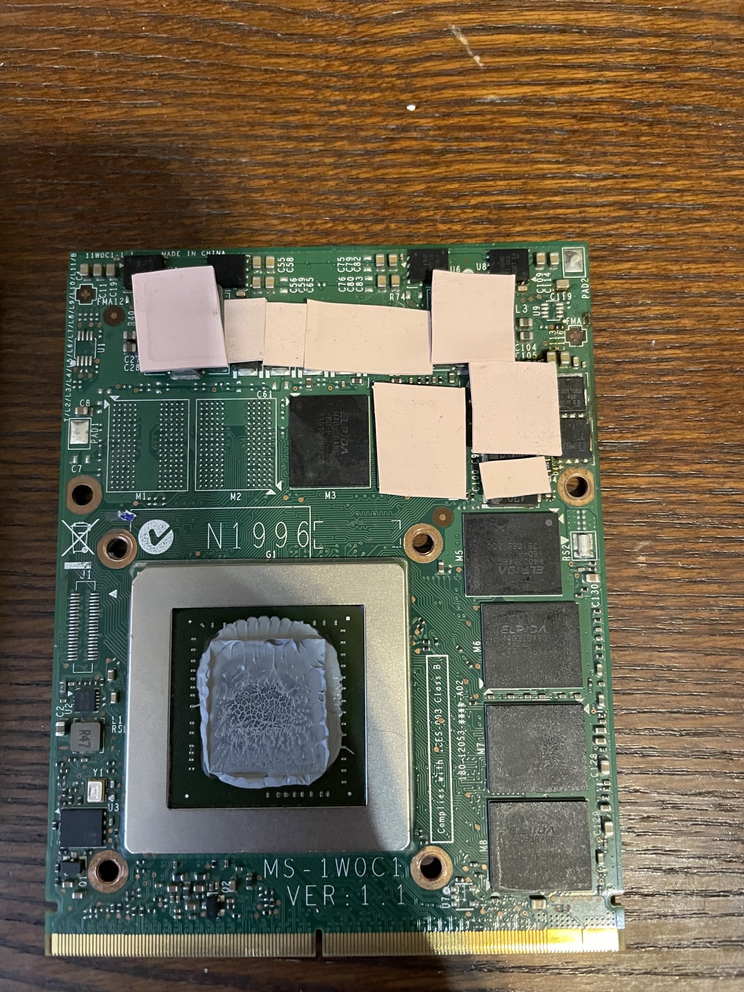

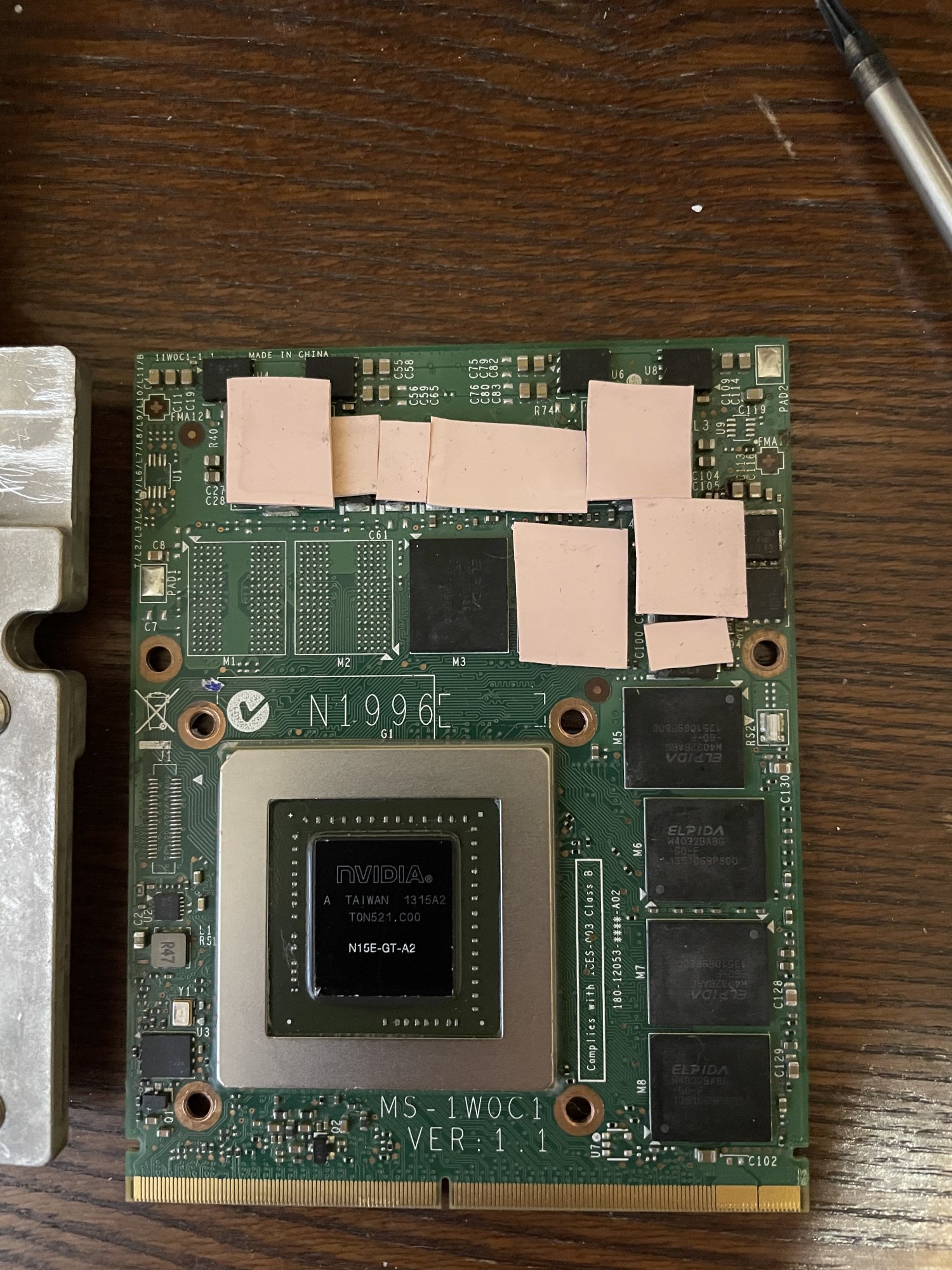

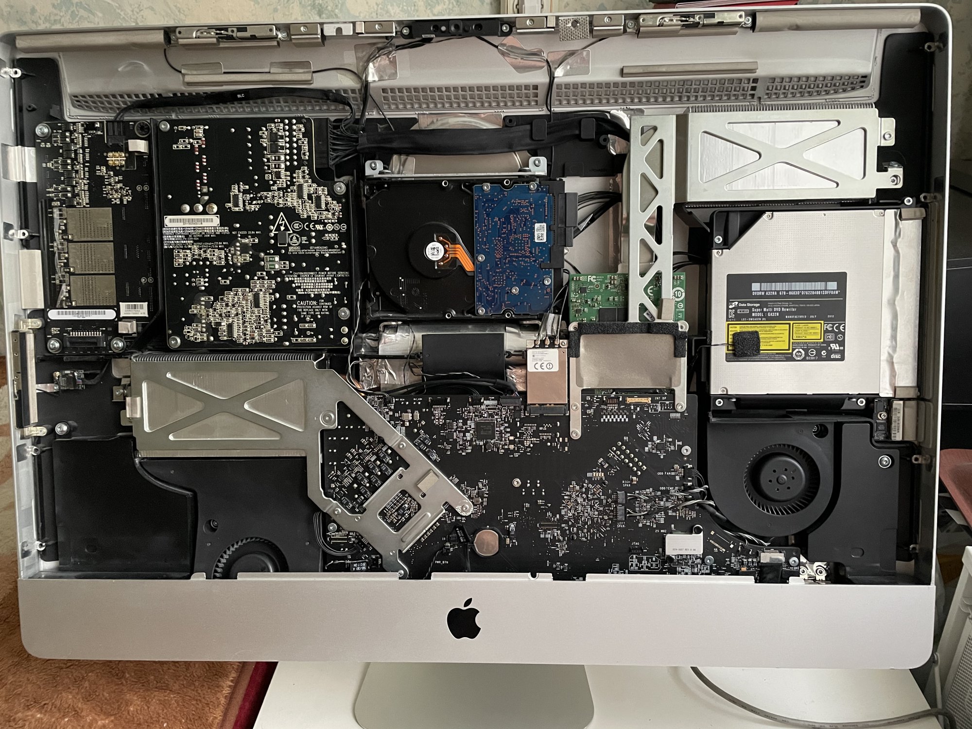

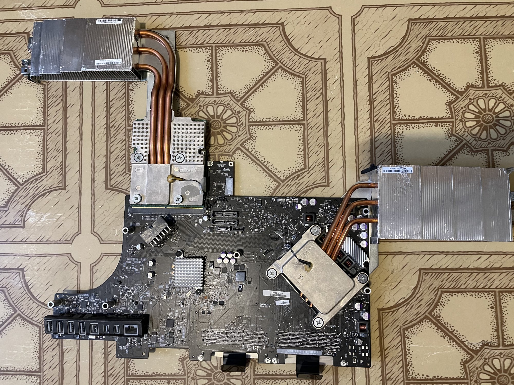

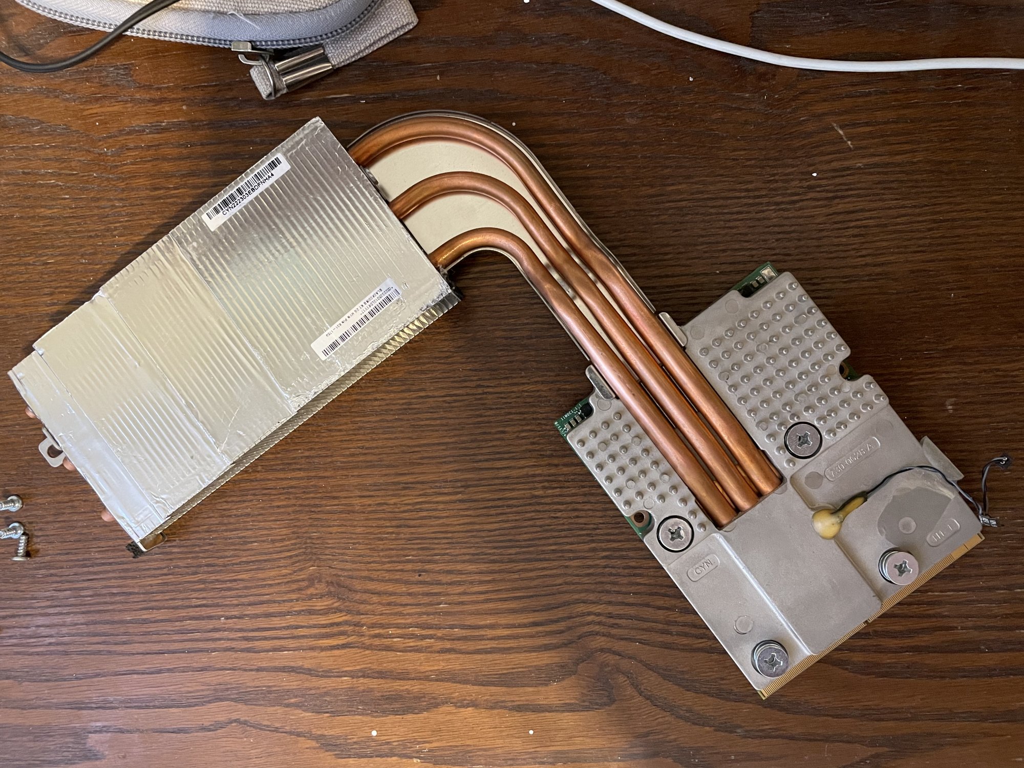

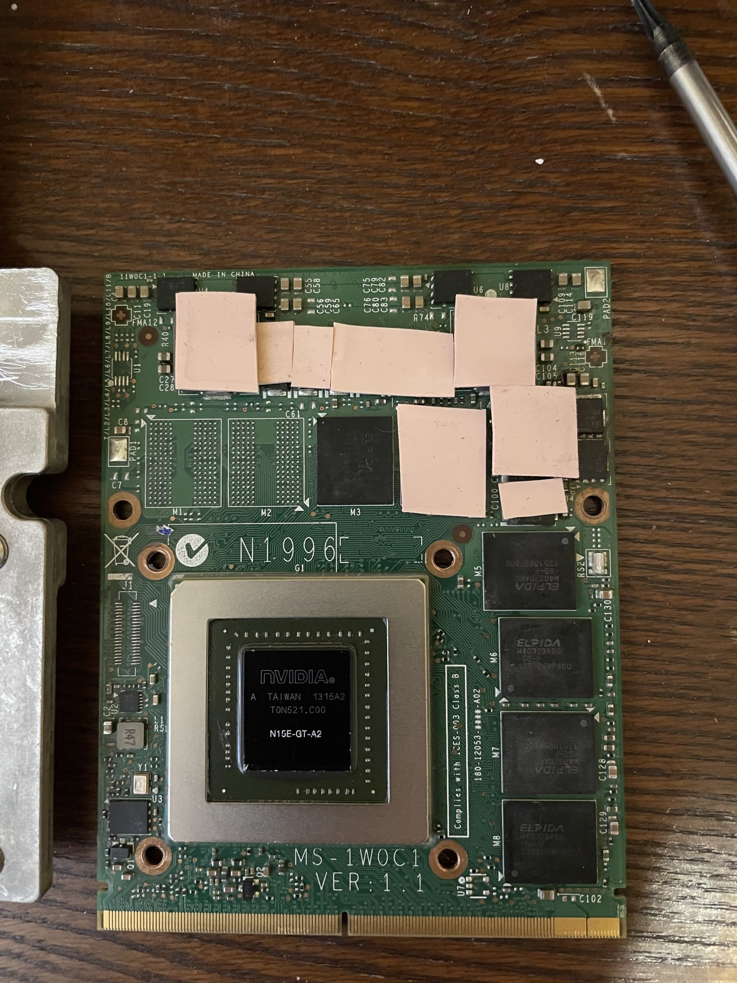

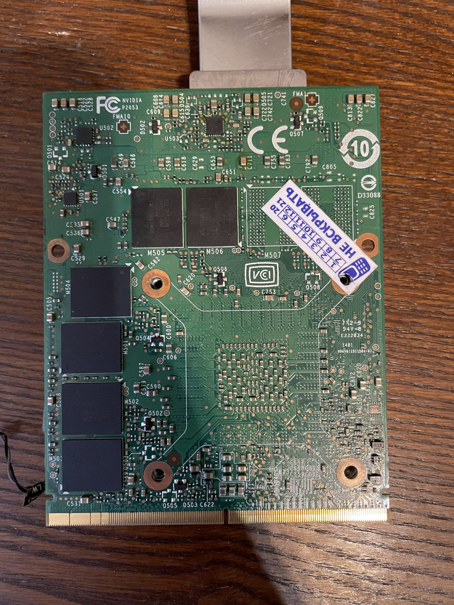

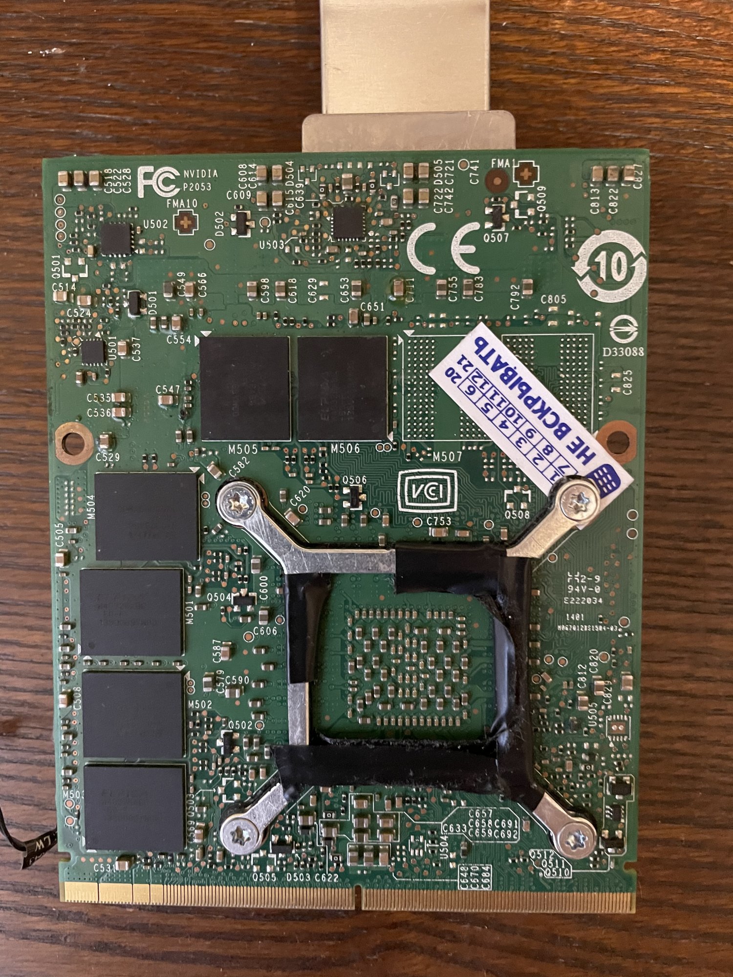

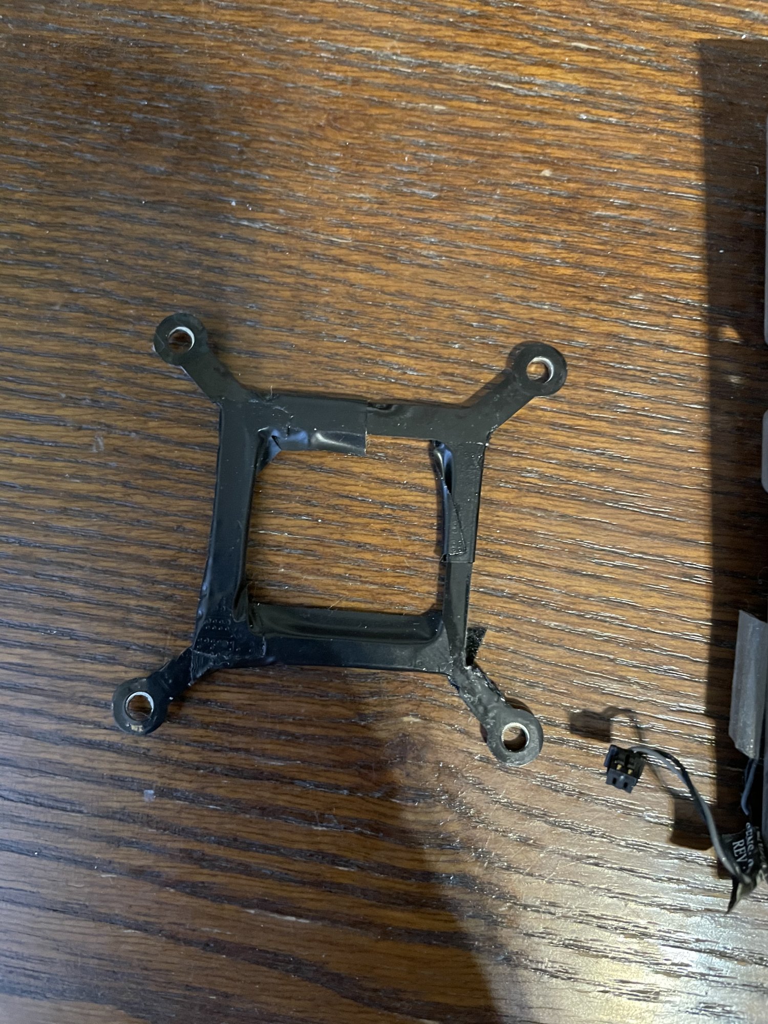

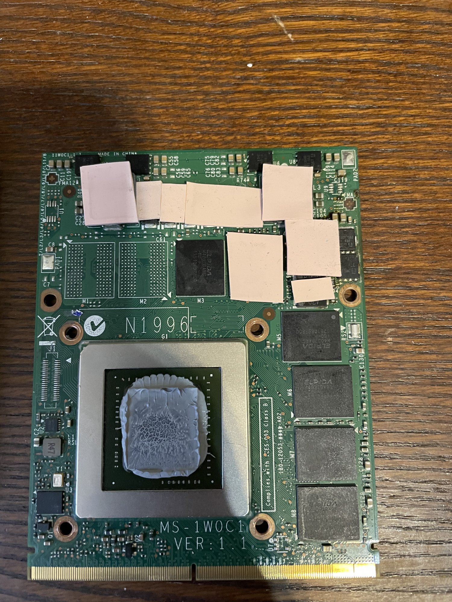

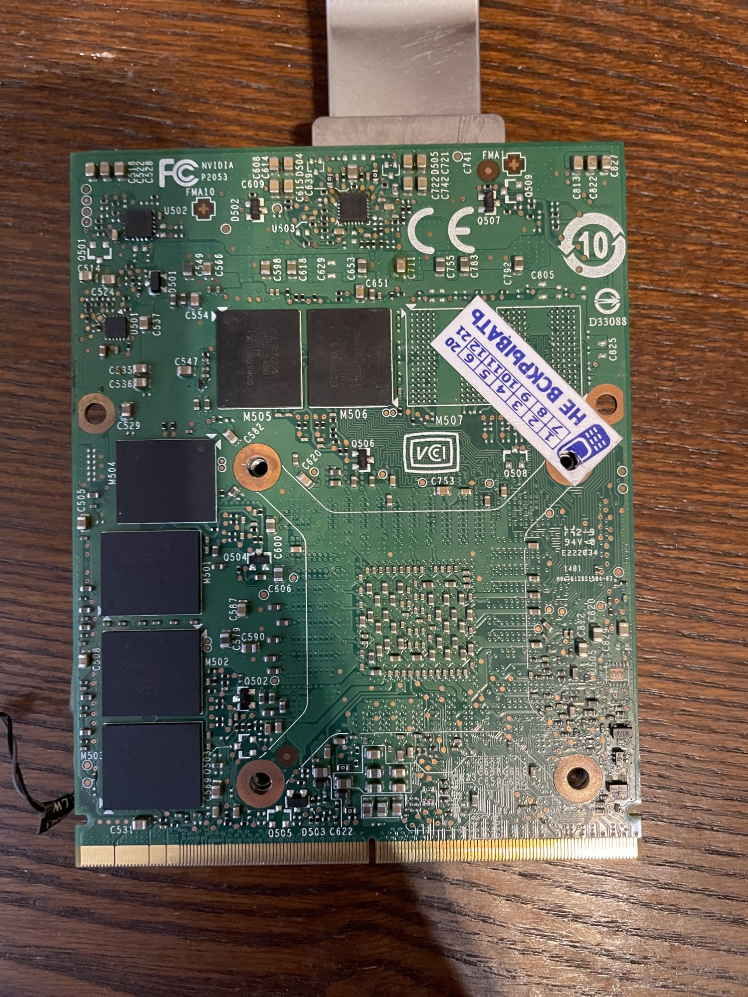

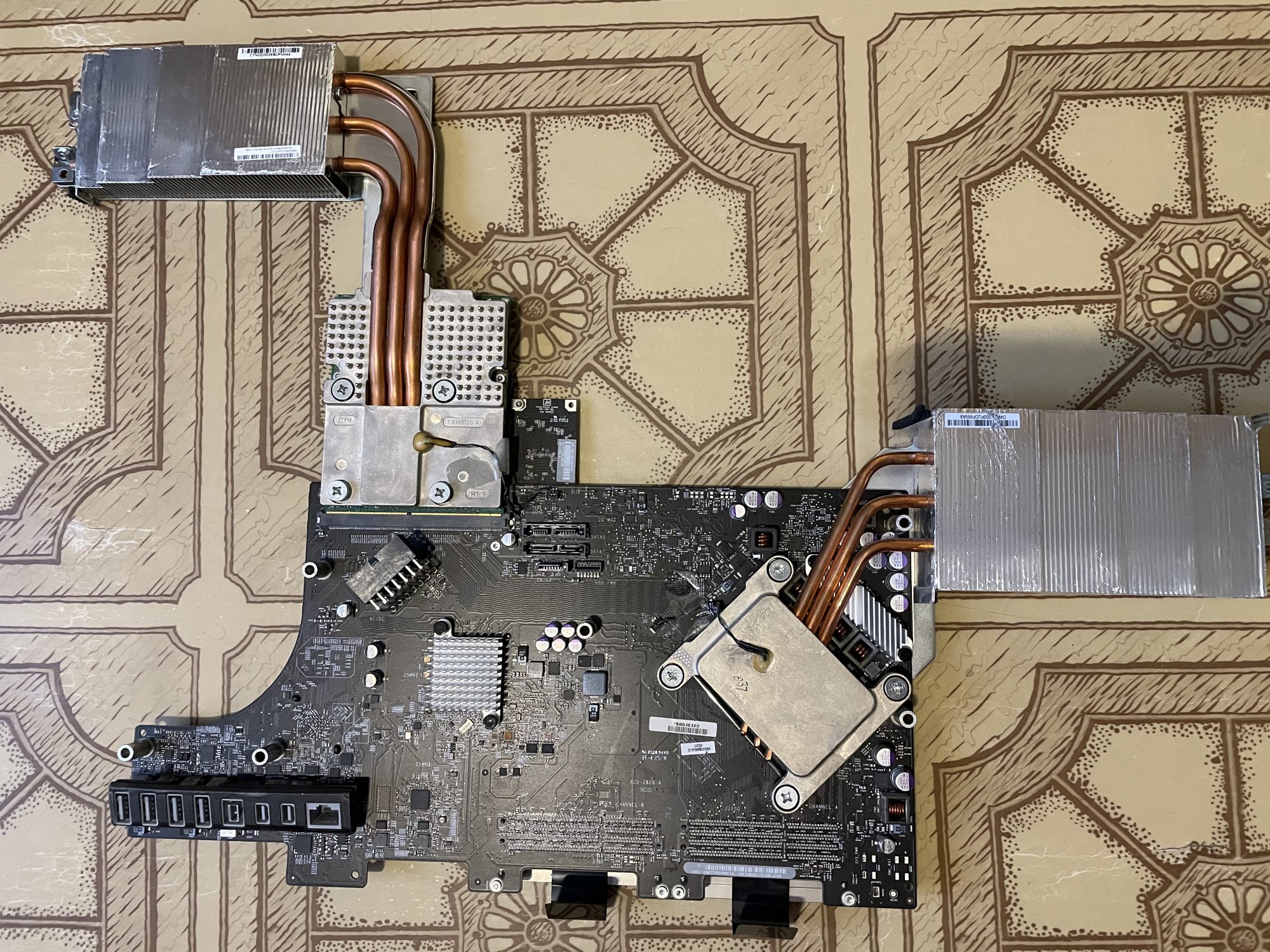

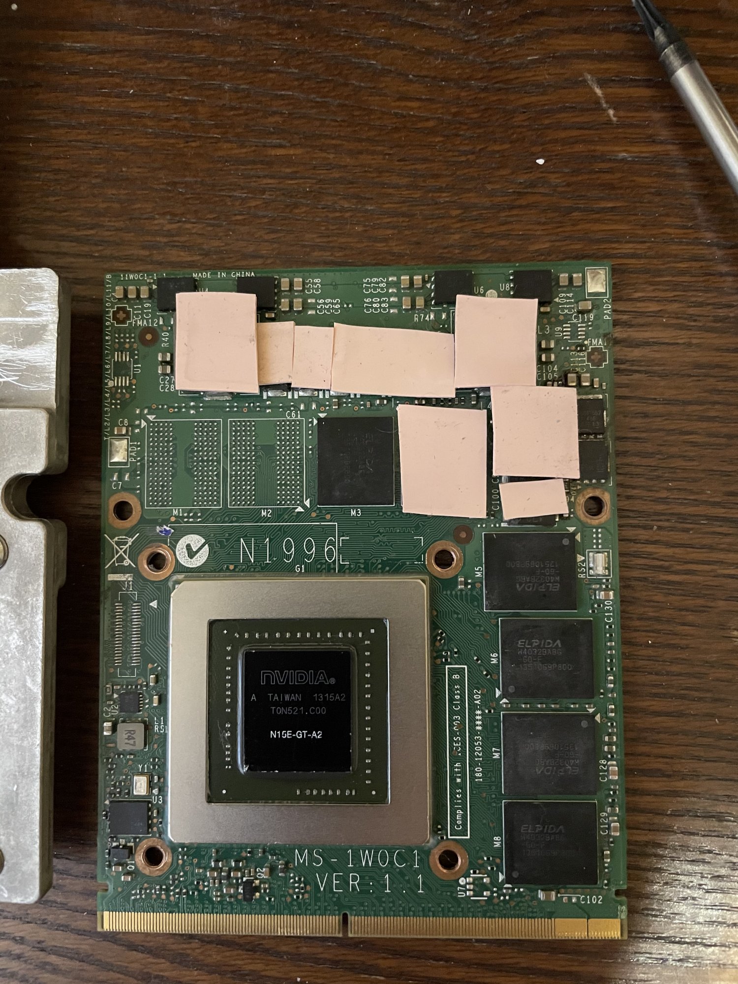

I pulled over GPU, did three PRAM resets and reboot without GPU. iMac boot correctly. Then i put GPU back, iMac starts and on 60% boot shutdown. Now it won’t boot. Same problem: fan working, no charm, no 2nd status LED.

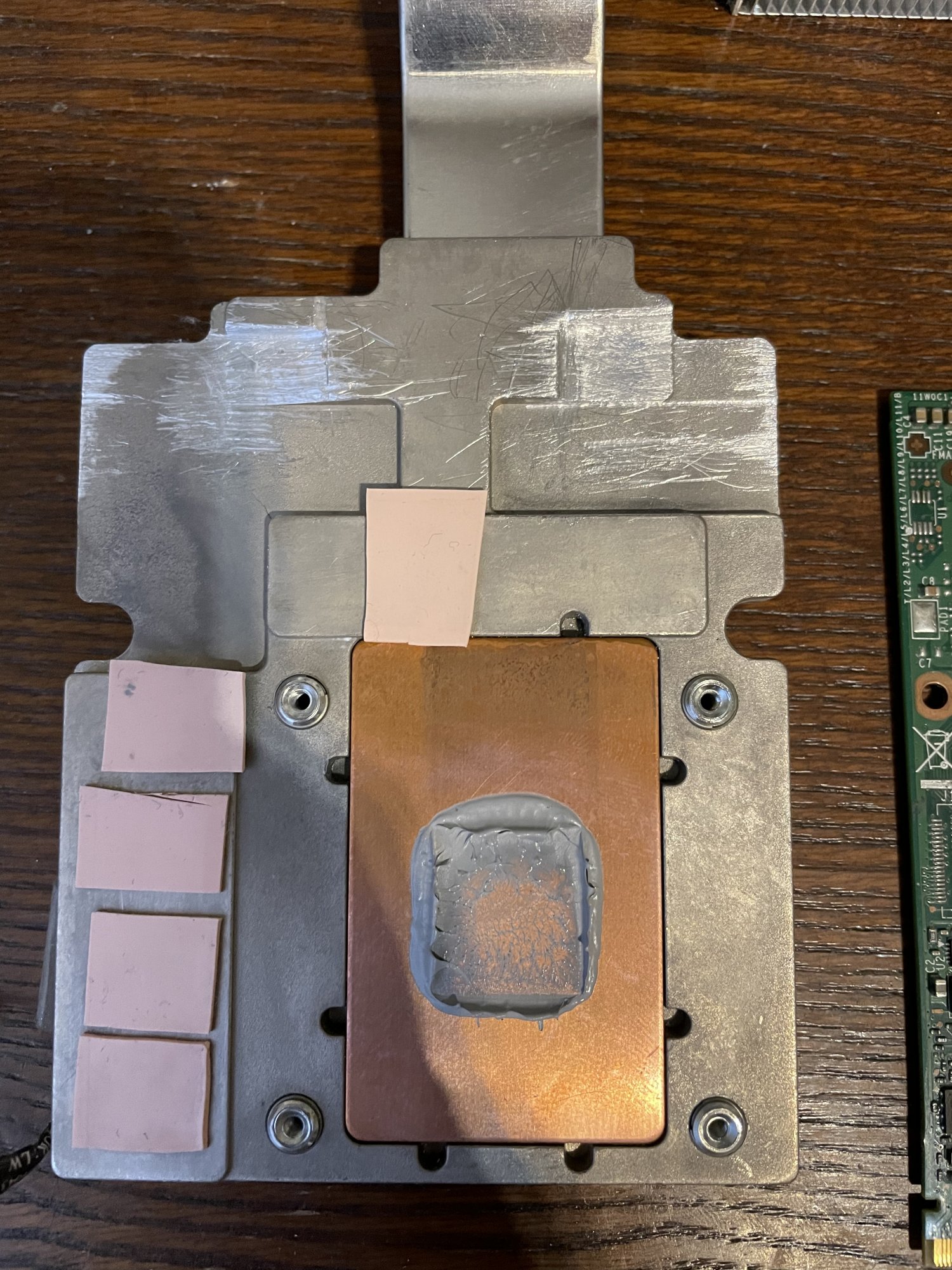

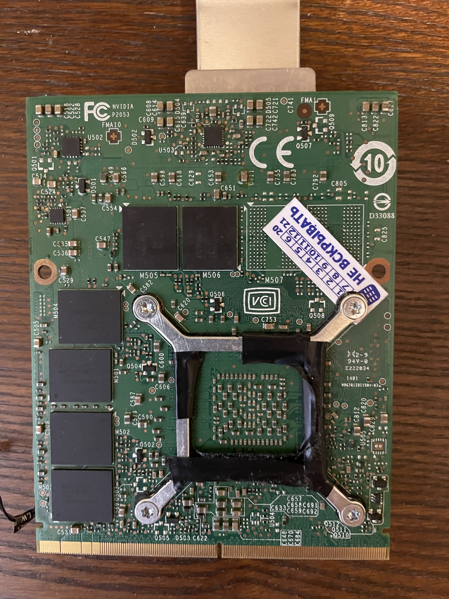

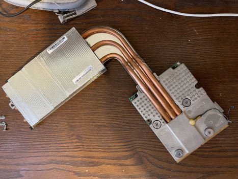

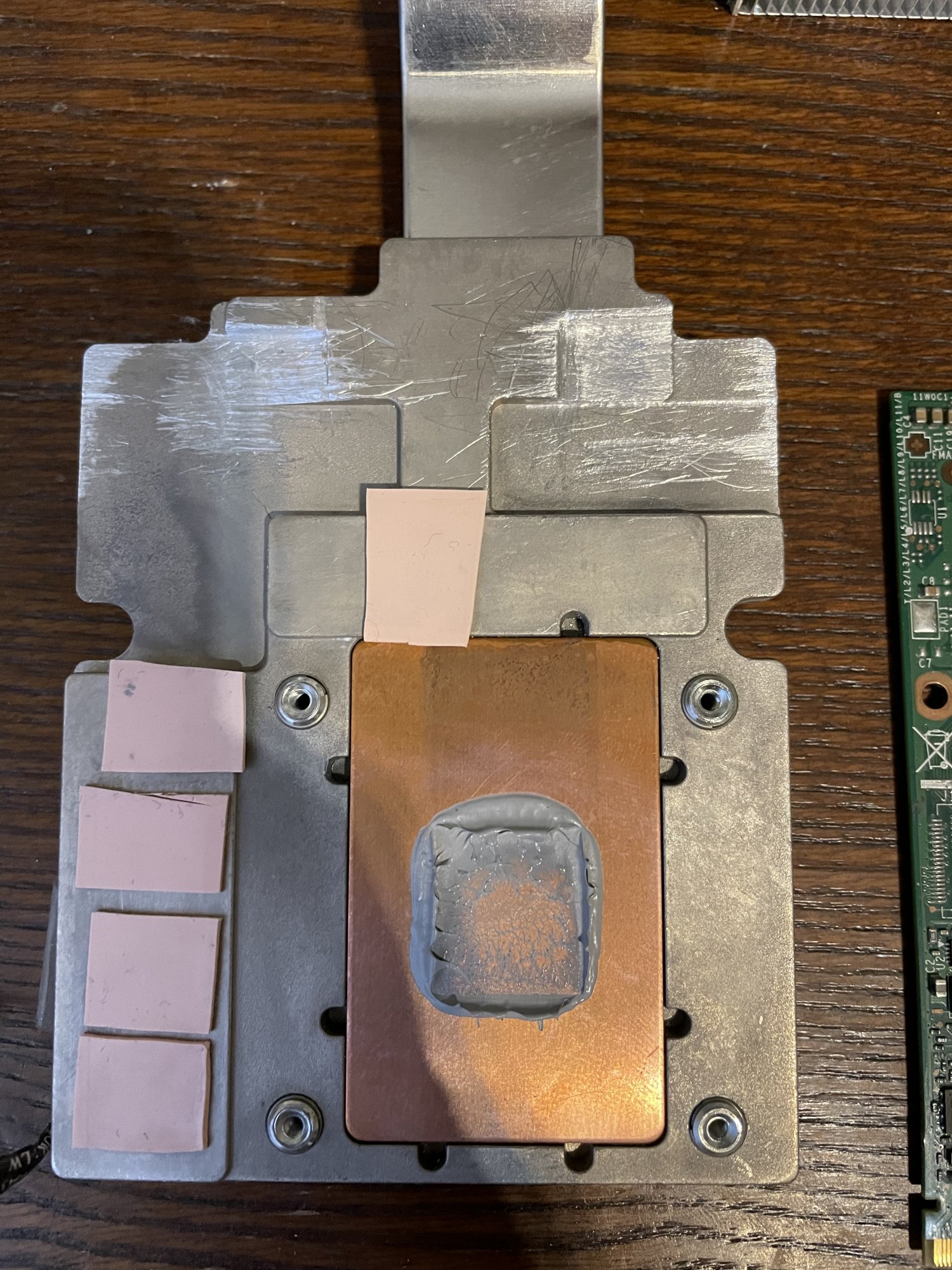

Here’s images of GPU and heat sink
This 60% progress bar is approximately the point were the macOS starts up the graphics drivers to enter the graphics mode. If your GPU is dead or your installation (for some reason) sucks than the symptom would fit a diagnosis.

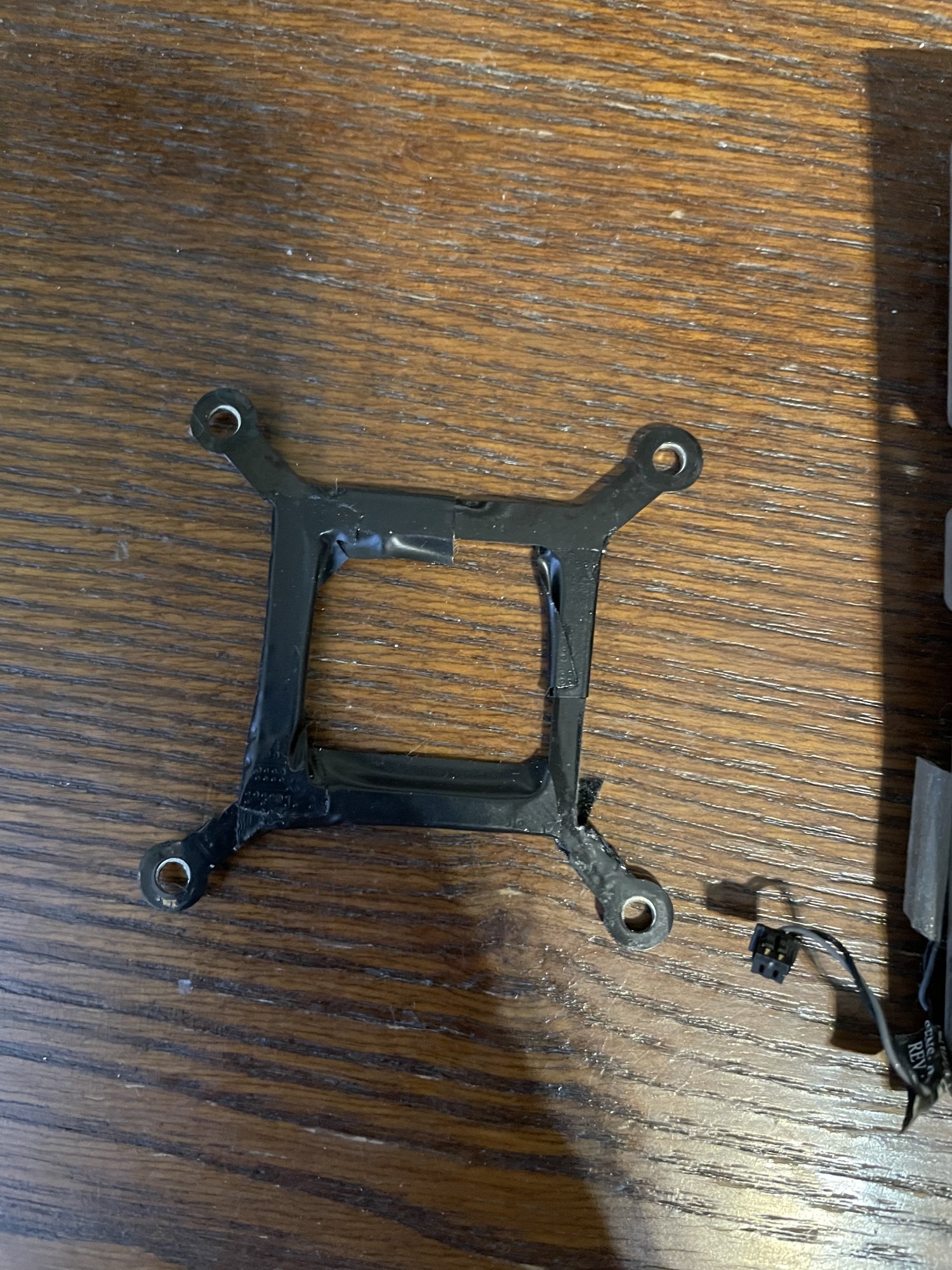

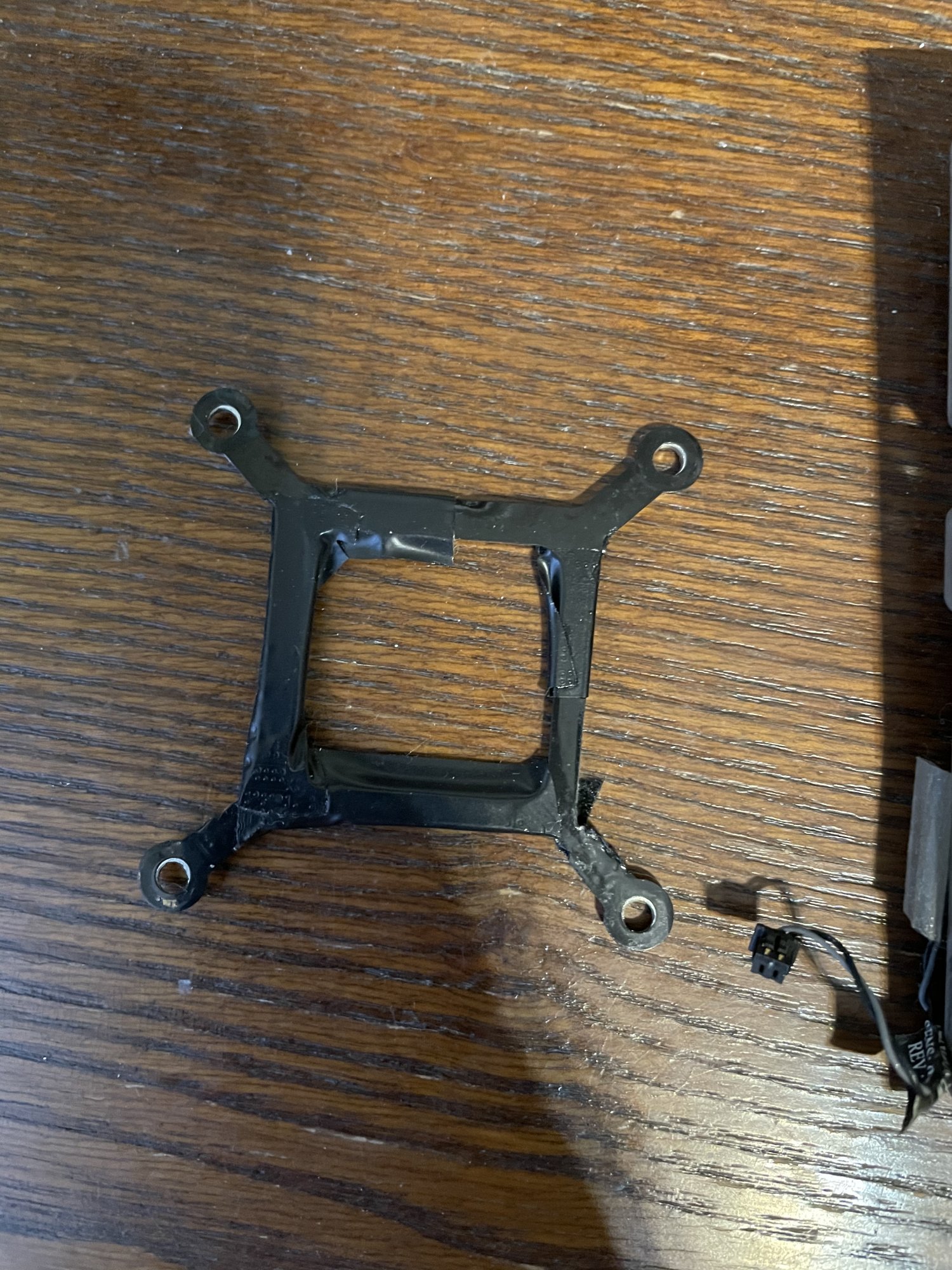

You could use a small Apple x-bracket instead of the big one belonging to the 6970M card. This way you avoid shorts better than with the big one.
In all cases I prefer to use K5 pro instead of thermo pads because the sink has not been designed for this particular card and your have different distances at different locations needing different thickness of the pads.
It's probably not the issue but the thermal paste on the heat sink looks old. I would replace it. Are you sure that the heat sink isn't touching the graphics card? Have you tried just booting with only the graphics card (just to see if it is shorting out on the heat sink). If you try, just do a boot and shutdown right away. You don't want to put the card under stress without the heatsink.
Hi,
I am struggling since I bought an K3000M from AliExpress. The card arrived with nick ROM on it.
But, I thought something is wrong with the card but I can’t differentiate if it is hardware or software.
First, the MacOS started to freeze when forced to show multi programs at the same time: when opened Spotify and YouTube, for example, if I open something more the sound keeps going but the Mac freezes, and need an force restart or waiting sometimes brings to the Lock Screen. Already tested new RAM and new SSD: nothing changed.
On windows, the system don’t ever freezes, and recognize the nvidia driver for windows normally, but most of the games get freeze, but don’t know if it’s related to the GPU either;
Sometimes, powering up the Mac got a black screen with an infinite boot chime, over and over until force power off. Needs to disconnect the card and reset PRAM to solve this, but it’s constantly happening;
2 times I turned on the Mac and seen colored vertical Bars. Removed and reinserted the card solve this;
When something black or dark is shown I can see random pixel-sized white dots on the screen, blinking randomly;
Nick is helping me with the bootrom.
anyone with some issue like this? I am almost returning the card to the seller but I really thinks this is a software issue that I don’t know, I already reinstalled macOS and windows several times.

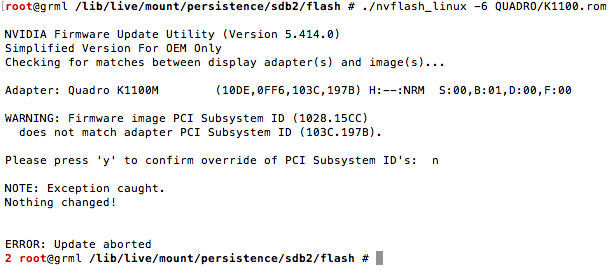

Thank you so much for all the work you put into this! Actually I tried to flash my "new" K1100M but in the QUADRO folder I found the K1100M_0E.bin only - so I tried to use the K1100.rom - got the message WARNING! Firmware image PCI Subsystem ID (....) does not match adapter PCI Subsystem ID (....) - I cancelled.
Could you please give me advice as I am not firm in these things!!
I have a 2010 27" iMac.
Thanks in advance!!
