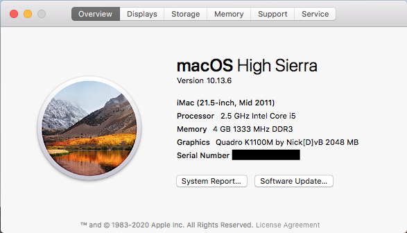

I bought a K3100M from a guy on ebay for a reasonable price that had been pre-flashed (albeit with the wrong version as he confirmed after I had issues. I suspect that he's fixed this issue) That'll fit a 27" but not a 21.5" 2011.
I installed it in my 27" 2011 A1312 and it came up but refused to finish booting (see earlier posts) and he did confirm that he had used the wrong flash file. He sent me the right one, I flashed it and I'm up and running (and typing this message to you) with my iMac.
It did require modification of the heat sink though, using a dremel in my garage to mill away spots to make the larger card fit properly.

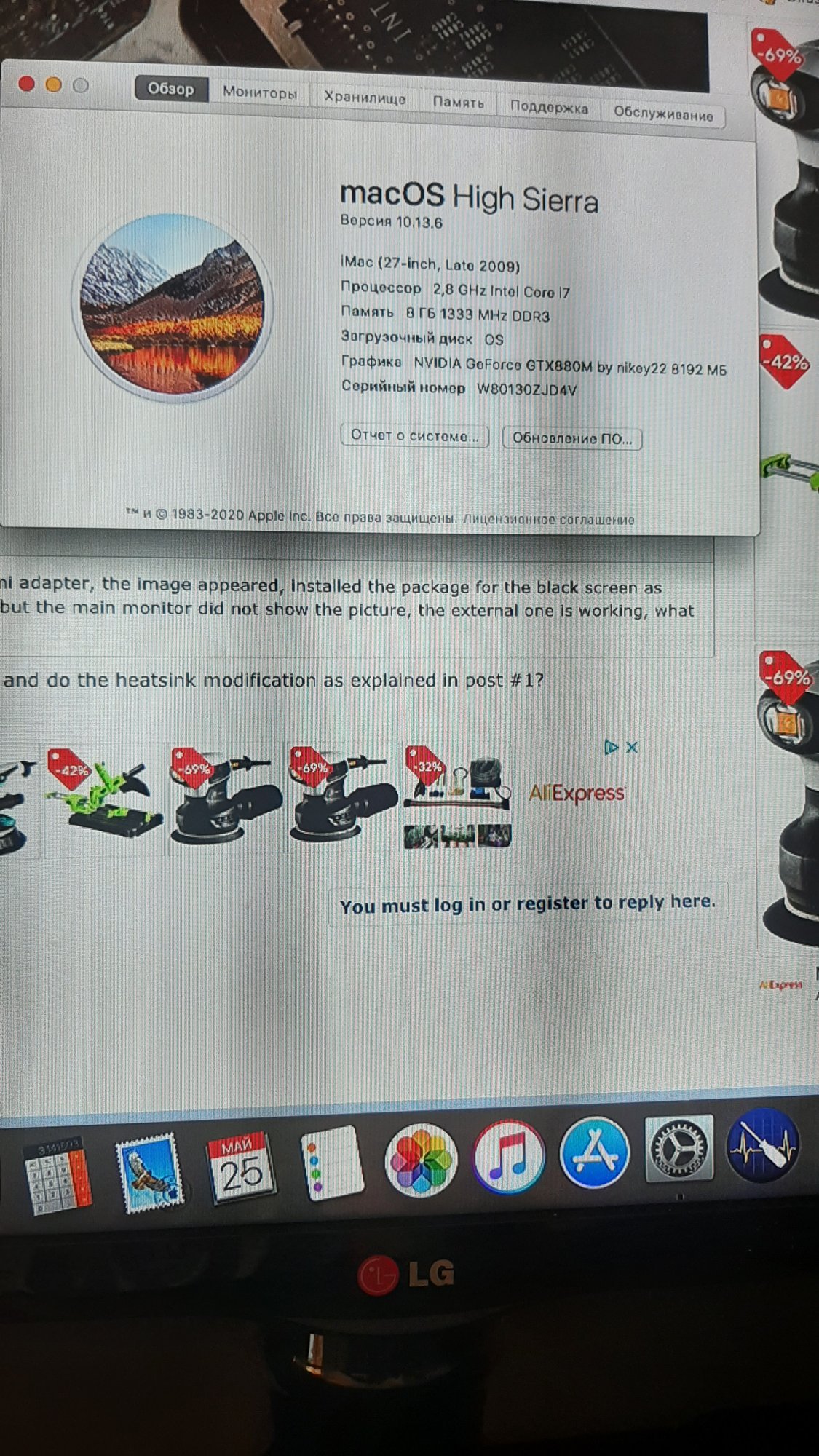

Good afternoon, my imac 2009 i7 is out of order, the video card has been ordered for Ali express gtx 880, the seller showed the photo that it works before sending it, I installed it, there is no black screen, there is a sound on the password and tell me if the seller did not modify the BIOS, the image should displayed? Or do you need a BIOS modification?
A photo of the card working in an iMac? Also, this sentence is not clear: "I installed it, there is no black screen, there is a sound on the password". That sounds like it's working properly.
Sorry for my English, the seller took a photo on the card before sending it to imac that the card works, but I cannot be sure that this is the same card. When I installed it, I have a black screen, when I have a password I hear how I can dial but there is no picture on the display, what next do?
There is a section in the first post that tells you how to fix the black screen problem.
thanks for all the guides and the ROM's
another successful upgrade, OCLP is next...😉

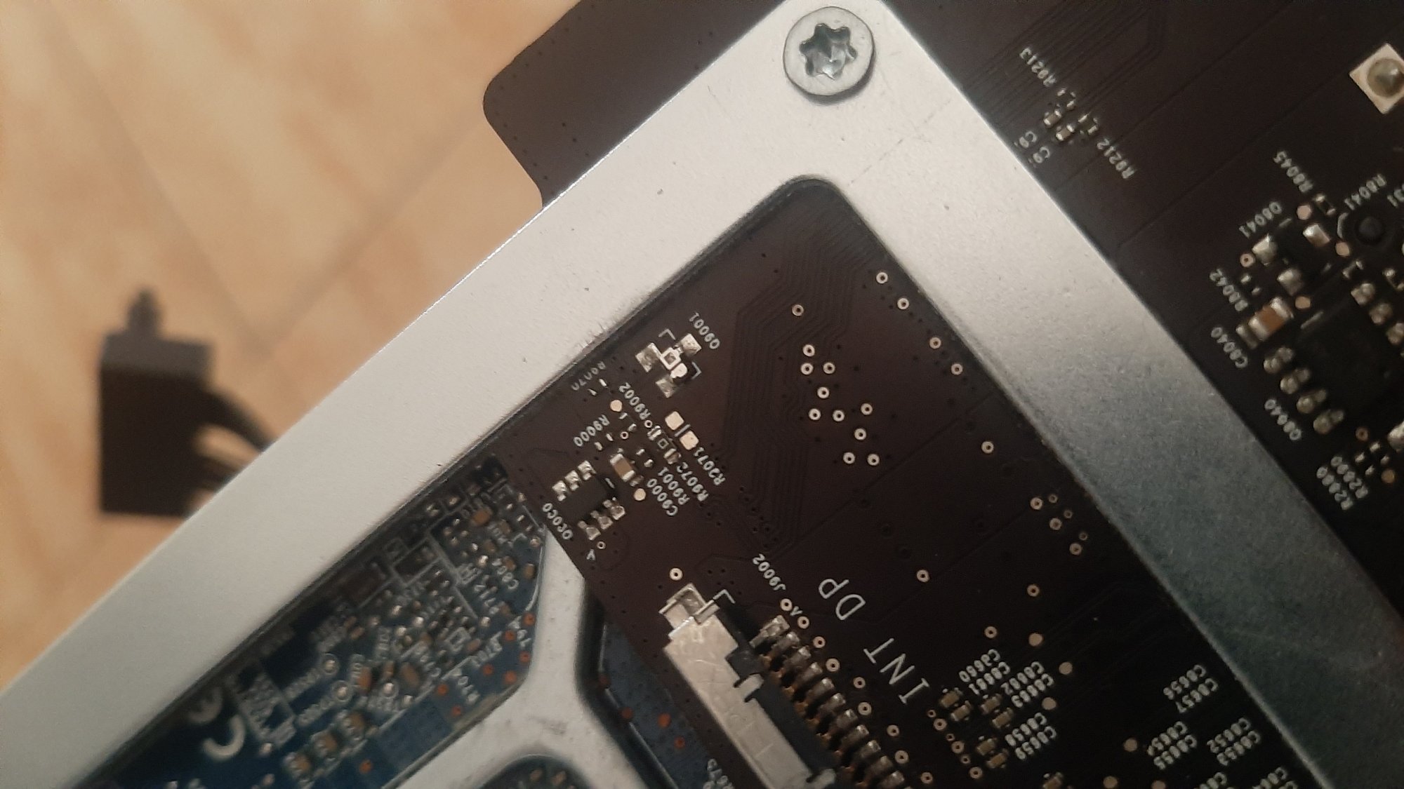

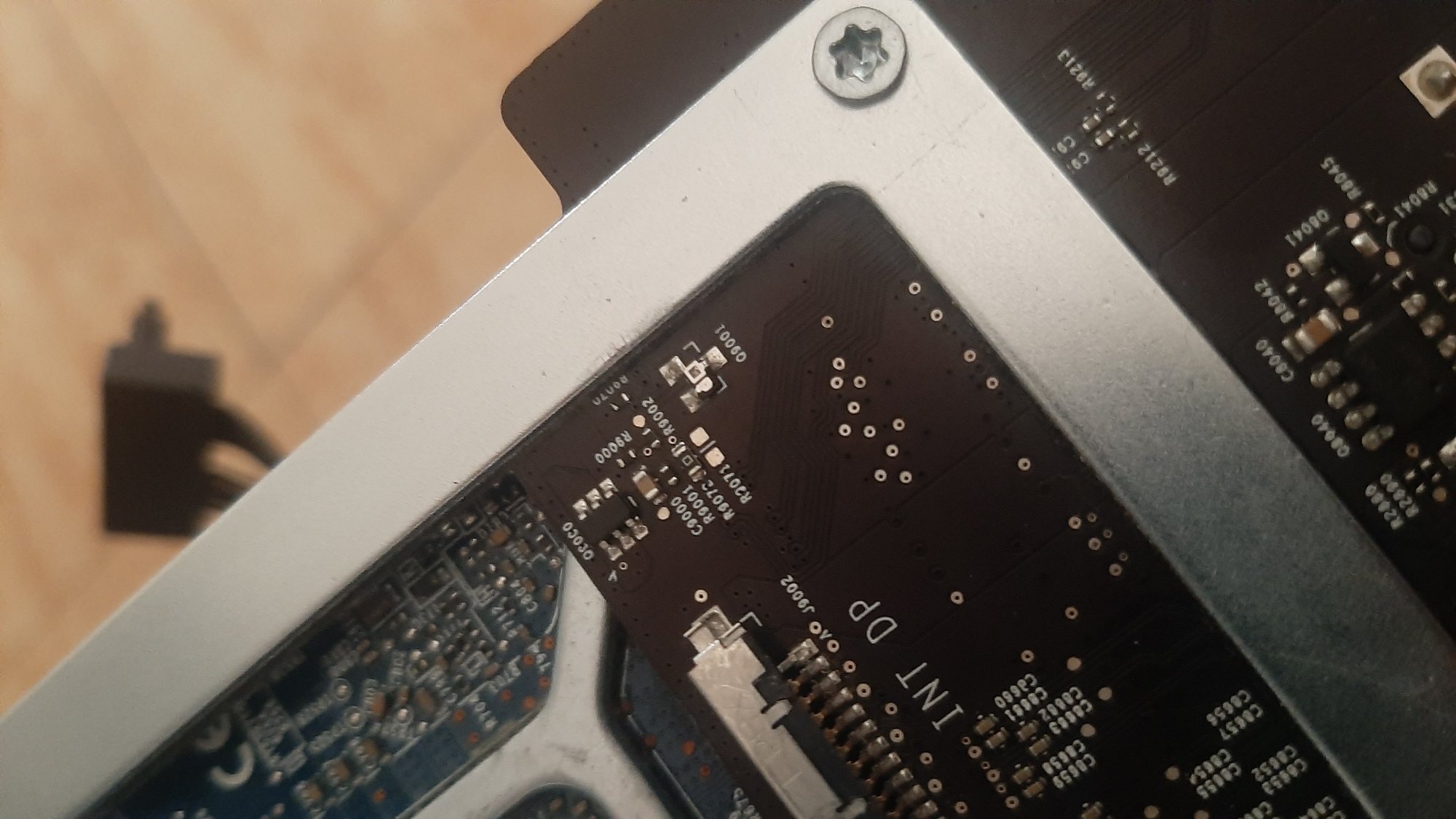

I bought a dsport hdmi adapter, the image appeared, installed the package for the black screen as described on page 1, but the main monitor did not show the picture, the external one is working, what else can I do?
How many LED you see? Take a small mirror an check through the air vent holes on the bottom side. It can be a damaged system board, contact problems with the LVDS connector and other hardware problems. There is a hardware section on the first post. Read it, download the Technician Guides and read them.
3 indicators are lit green, when I connect my native video card imac display the backlight turns on, I did not change the loop
installed the native video card, all 4 indicators are on, although it is faulty or half operational

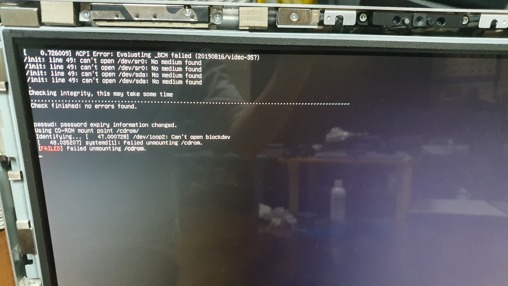

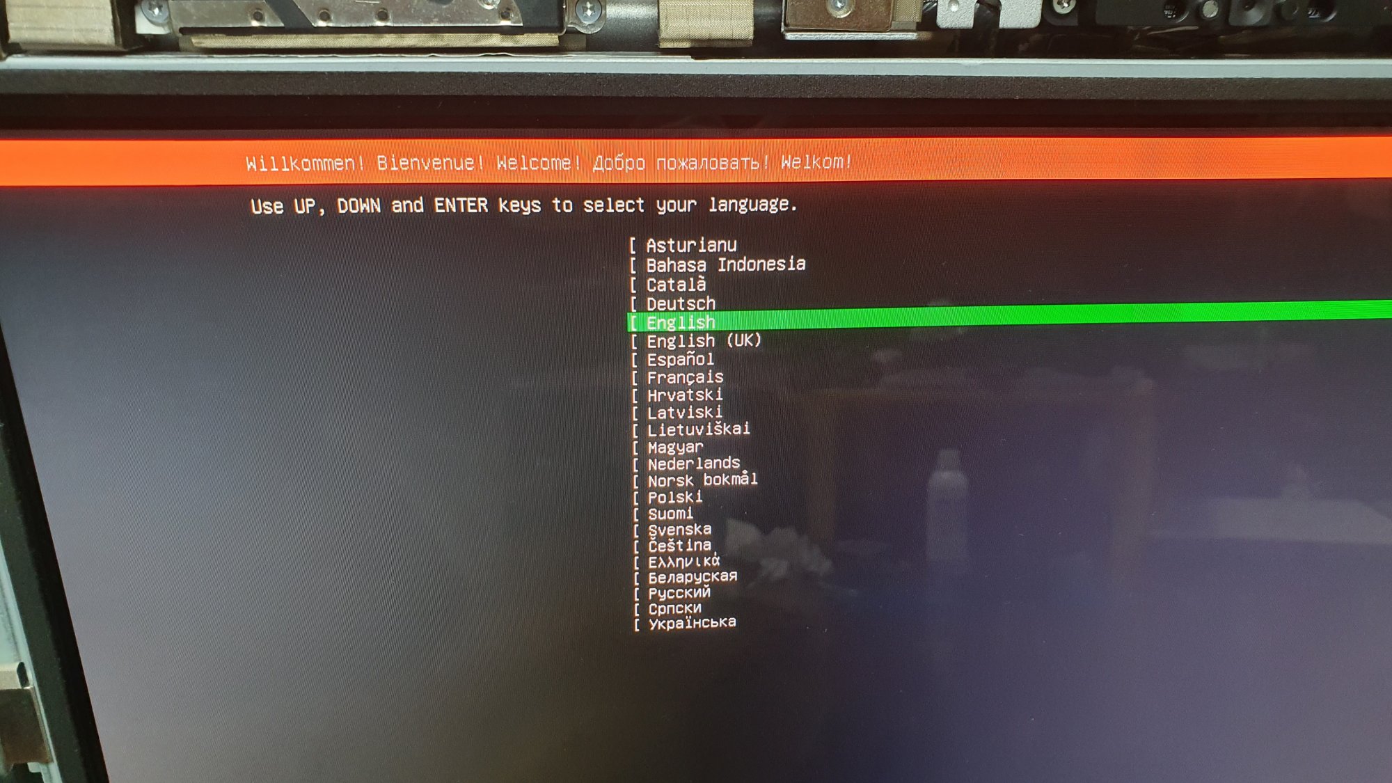

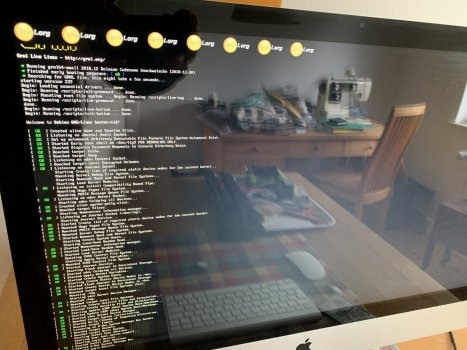

Hi, Folks!
This time I tried iMac 2011 21.7 with GTX 870M & USB stick running Ubuntu server image.
Can you see this boot up screen? We may not need GRML usb stick any more since Ubuntu can show the login screen and you can reimage your GPU from the iMac itself. (No need to press option or anything from the keyboard when sdd/hdd is disconnected. just wait a few mins and it boots up!)
Anyway, pls can someone contribute for the Vbios of 2G 870m?
Thanks!

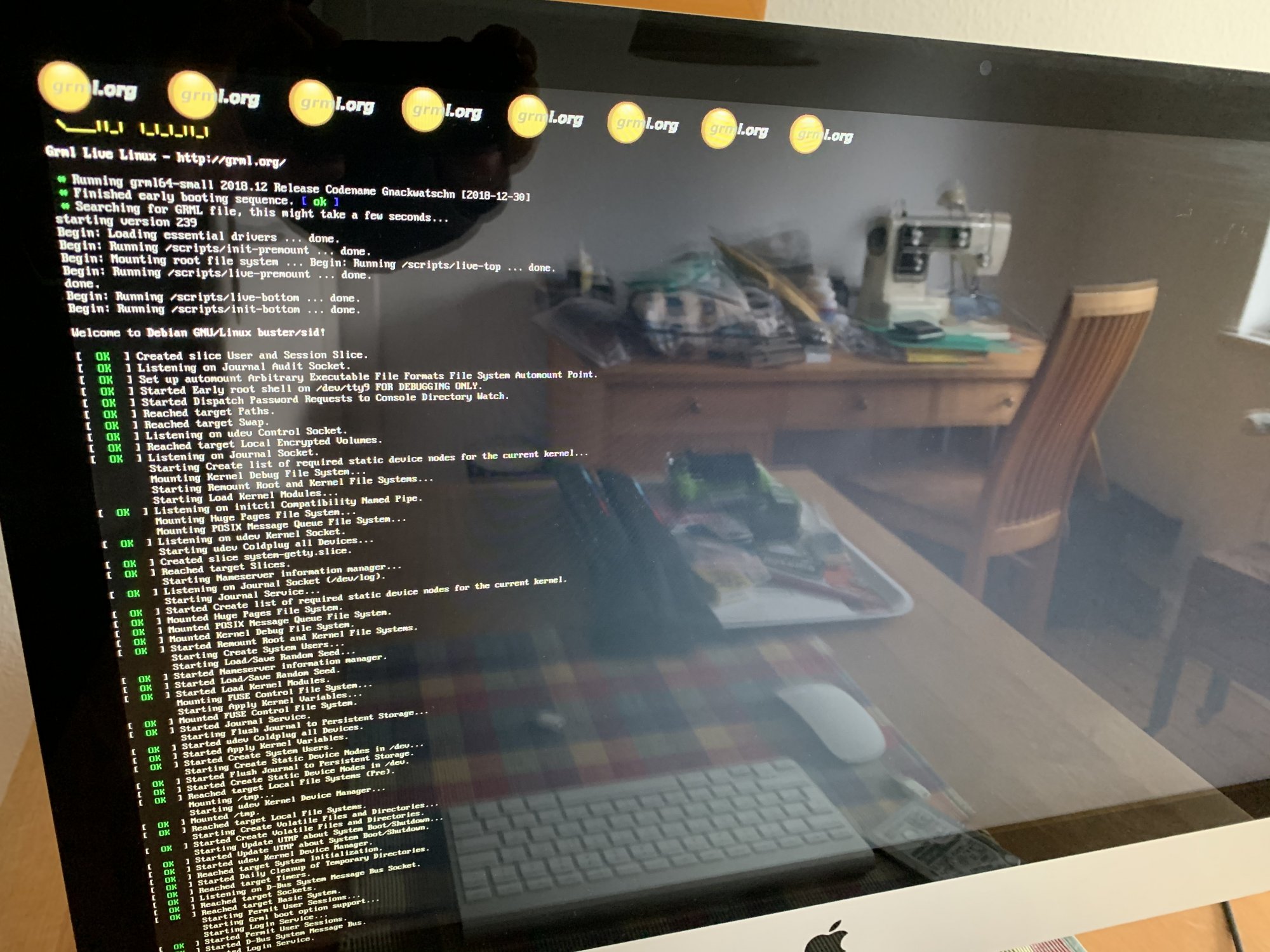

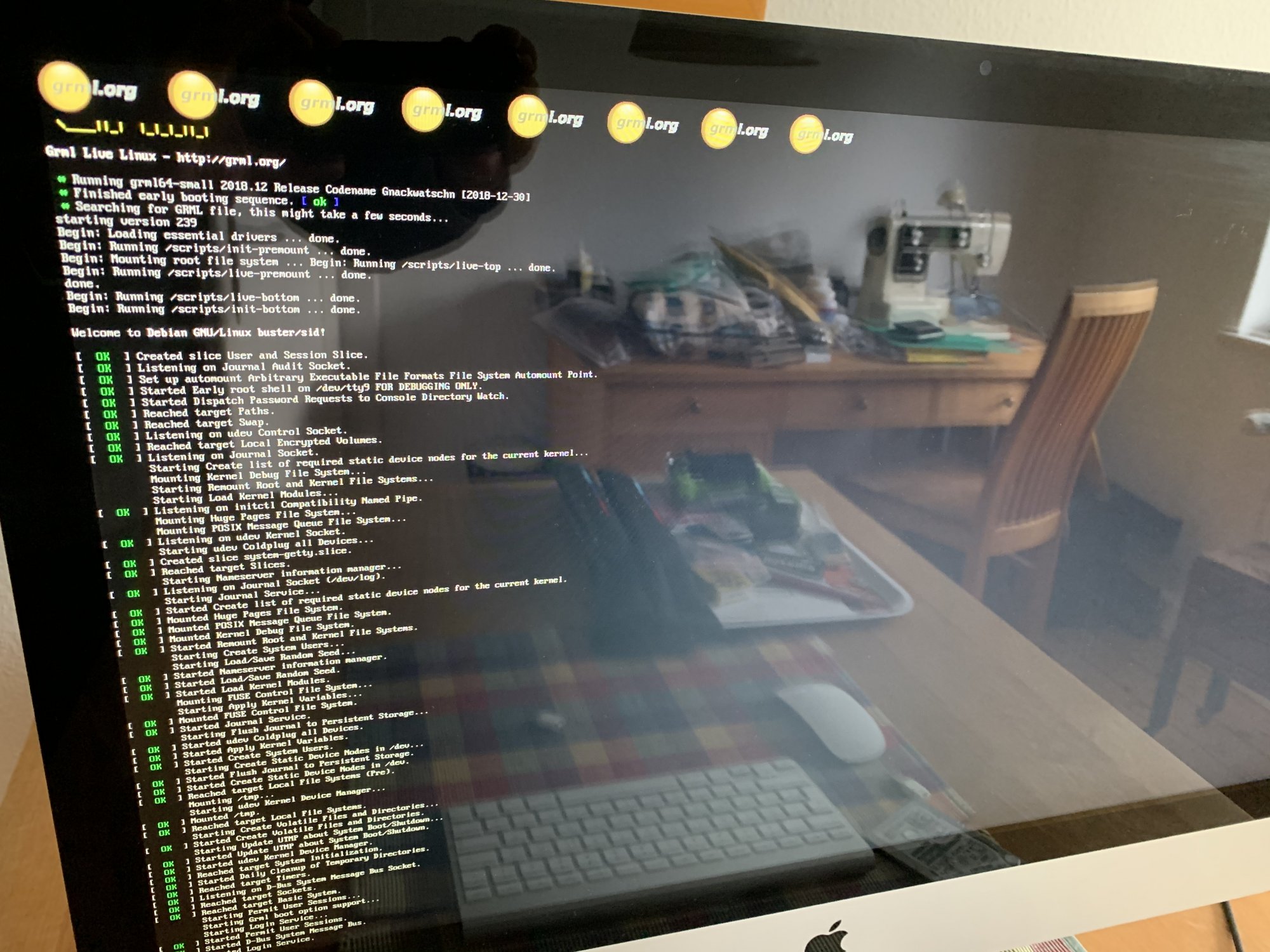

Hi, Folks!
Thanks!
Can you start some version macOS (High Sierra) using the very same setup without flashing the card or changing the current vBIOS? Just put an SSD/HDD with a known to work installation in and wait for a long time unless you believe the macOS must have started. The best will be to enable remote login, screen sharing and file sharing in the Sharing system preferences pane in advance. This way you can check remotely if the came system up, but not the internal LCD.
Can you provide a download link for the Ubuntu image you have used.
As I told you the GRML Linux enables the text mode in the same way on all my systems and cards (having a Dell Bios or the BIOS from the first post)!
The interesting part is when you get a card with no suitable BIOS loaded at all or a HP card (just a stub file). Then neither GRML not Ubuntu will show a screen on the main LCD, at least this is my status as long as you prove me wrong.
One can setup any Linux distribution to provide the same functionality as the GRML one provided here. This is no church.
