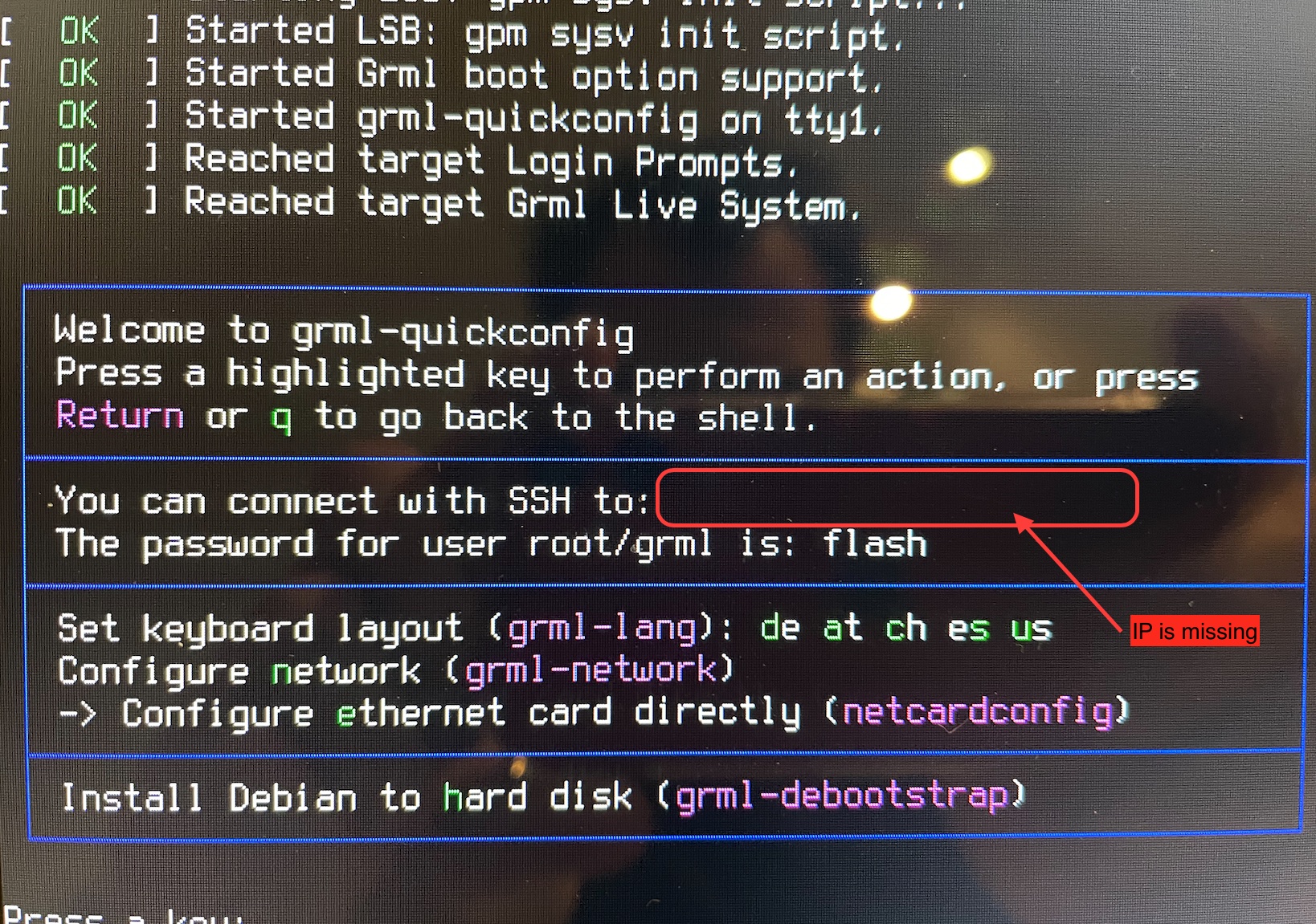

As I told you the GRML Linux enables the text mode in the same way on all my systems and cards (having a Dell Bios or the BIOS from the first post)!
The interesting part is when you get a card with no suitable BIOS loaded at all or a HP card (just a stub file). Then neither GRML not Ubuntu will show a screen on the main LCD, at least this is my status as long as you prove me wrong.
One can setup any Linux distribution to provide the same functionality as the GRML one provided here. This is no church.

My 2 cents is Ubuntu and Debian based GRML are different packages and can be based on the different Kernel since GRML is for mostly light systems so It may not support various H/W drivers like Apple computers compared to Ubuntu. Also no need to make a custom package from Ubuntu since all you need is to xfer or copy the bios updater and one bios file or two to your iMac.
And if GRML boots up like Ubuntu and shows a login prompt when a new GPU is installed, that's cool since no need to try DHCP and set up remote SSH at all unless the gpu does not have bios!
But, as I commented earlier, my experience was my USB sticks running many distros didn't show any boot-up screen at all except Ubuntu Server.

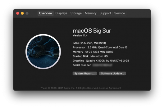

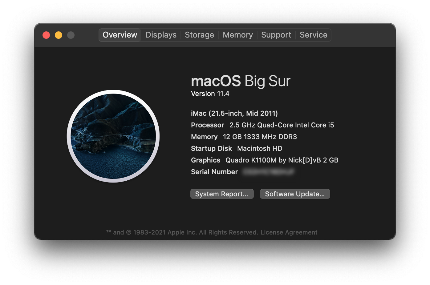

After days of waiting for my K1100M to arrive, I was finally able to install it on my iMac. I was already running Ubuntu anyway so I just downloaded the files needed to flash the K1100M. I installed the card and flashed it. Installed macOS Big Sur 11.3.1 with OCLP on the installer flash drive. After that, it was pretty much working right off the bat. I updated macOS via OTA to 11.4 and no hiccups so far. I've also installed Windows 10 alongside it too and it's been great!
I'll probably upgrade my Wi-Fi card next to get AirDrop working. Haha!
Thanks to everyone who made this possible!
I updated to 11.4 too and so far so good. I'm also interested in Wifi update but not good at soldering so dunno if I can do it good.

As I wrote, this is no church and unless these ideas get no traction I am fine with it. Otherwise we know who will have to explain the does and don't of half working method on a daily basis.
The main point is: Some one will have to do the user support. Having 20 half working methods only confuses the people.
I simply had to try a different method since GRML was half baked soution not getting DHCP IP address at all and I couldn't find the reason w/o screen. (I still don't know the reason yet) My laptop booting from the same USB stick worked perfectly getting IP address instantly.
my method could update vbios easily in the end.
Why ignoring when sharing my experience so the others can try? Nothing to lose.
Why would I want to download and run Ubuntu server @ 1.13gb when I can download and run a persistent version of GRML @ 360mb with most of the current vbios roms pre loaded by just copying and pasting some folders to a USB.
I understand you had some problems and I'm happy you overcame that with your solution I personally would have tried to figure out why the @xanderon USB wasn't working.
I'm actually hoping I or someone else will come up with a persistent tiny core usb boot disk with SSH over wifi at under 100mb.
GRML is NOT a half baked solution. Your situation is EXTREMELY rare. I have been following this thread since @xanderon gave us the GRML solution. There was ONE other case where the DHCP wasn't working. However, there are hundreds and hundreds of users that have used GRML flawlessly. Your "method" will only work in rare circumstances. As pointed out by @Ausdauersportler, your method WILL NOT WORK when there is no vBios present, which is more frequent than you would think.
So, it's great you found a solution to YOUR problem that coincidentally worked BUT, please, let's not clog this thread with a "shot in the dark" method.

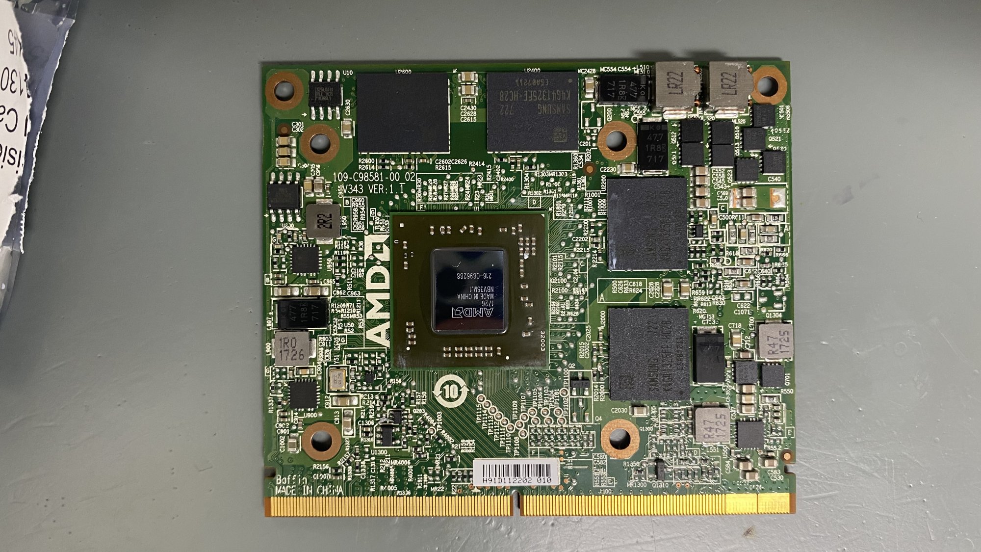

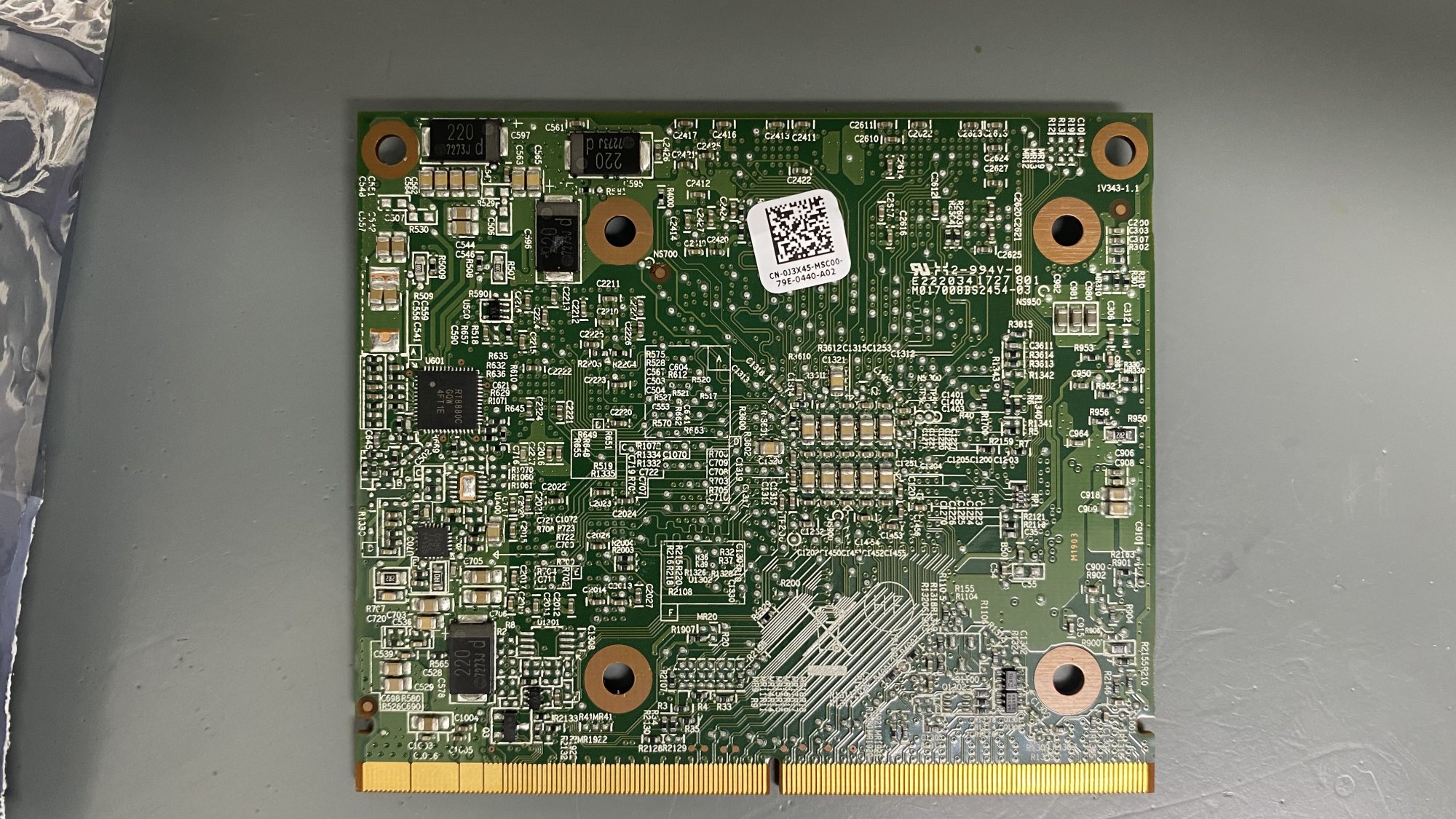

Just purchased this GPU WX4130 2GB, the seller stated it's Genuine pulled from a Dell laptop. Will be flashing using the USB Linux method. I will be running it on my iMac 11,1 27inch Late 2009 i7 2.8GHz 16GB Ram 1TB SSD with OpenCore and Big Sur. Hopefully it all goes to plan. Just waiting on the 1mm Copper shim and Kapton tape. Will let everyone know how it goes.

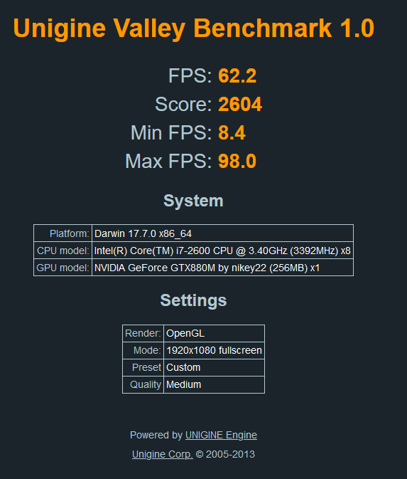

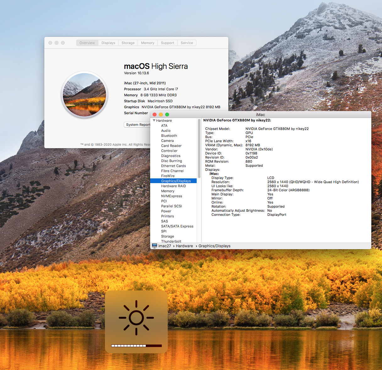

The GTX880M is the first 8GB VRAM card to work in our machines! I now have as much vram as system ram. I'm happy to report that macOS sees all the ram. It is boosting fully even at base clock speeds. When I purchased this card, the rivets were very long and kept too much of the GPU away from the heatsink surface. It was thermal throttling early as it sensed an overheat situation. When I removed the rivets, and used screws to secure it, I was able to get a much tighter seal and the card boosted properly.
Tested on a 2011 iMac using High Sierra 10.13.6. Please feel free to test on other MacOS versions, I will update this post as necessary with success/failures.

⦁ Genuine native brightness control
⦁ Genuine ‘gray’ early-boot screen (stage 1 & 2 progress bar)
⦁ Genuine macOS bootloader compliance

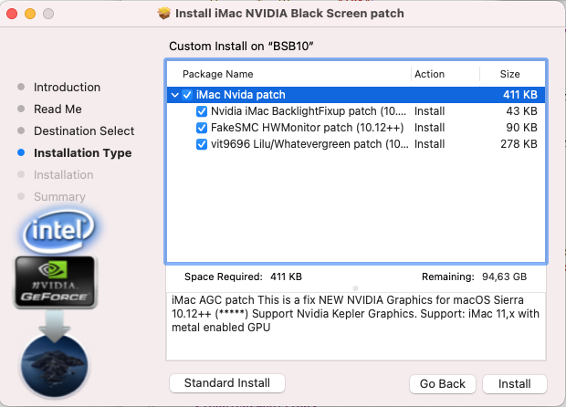

Sierra and High Sierra Package Installer
( iMac 2009-2011 AGC, FakeSCM, Lilu, WhateverGreen, AppleBacklightFixup installer)
Attached you will find the a kernel extension package installer currently working on Sierra 10.12 and later. SIP needs to be disabled. Boot into recovery, start Terminal app, enter csrutil disable and reboot directly into your macOS and install the package.
It will patch the current installed AppleGraphicsControl (AGC) as described in this post addressing the black screen issue and install the AppleBacklightFixup needed for ++ type Nvidia cards side by side with the @vit9696 Lilu and Whatevergreen. As an option you can have the FakeSMC extensions get installed.
The NVIDIA ++ cards are this running with a BIOS from @nikey22 and marked in the table on post #1 as type ++.
After starting the Apple package installer (double click) you can choose the destination and select the packages to be installed according to your wishes. For this reason I separated the complete sets in several subsets. You can use the installer to patch AGC (this will be done in any case), and install addionally BacklightFixup, FakeSMC, and WhateverGreen/Lilu. You have to select at least one kernel extension to be installed. Only the FakeSMC is really optional.
FakesSMC will be needed b the HW Monitor app to provide full details on all sensors available on your system.
What will this package installer do:
  1. Patching AppleGraphicsControl AGC (all iMacs, Nvidia card users, only)
  2. Nvidia BacklightFixup (all iMacs, NVIDIA ++ cards users, only!
  3. FakeSMC Package (all iMacs, all graphics cards)
  4. vit9696 WhateverGreen and Lilu (all iMacs, all graphics cards)
Supported hardware:
iMac 11,x (Late 2009 and Mid 2010) with NVIDIA Kepler GPU
iMac 12,x (Mid 2011) with NVIDIA Kepler GPU
Supported MacOS:
macOS Sierra 10.12.1 up to macOS Catalina 10.15.7
do not use with macOS Big Sur!
Recipe:
Disable SIP (Mojave and Catalina will have this done), download package, double click, enter password if asked for, select disk and your extensions to be installed, finish installation and reboot.
You may select only a single of the packages below! The AGC patch will be applied in any case.
Attached you will find some selections screen shots. You can use the installer to select a single package only.
Have fun and please report back!

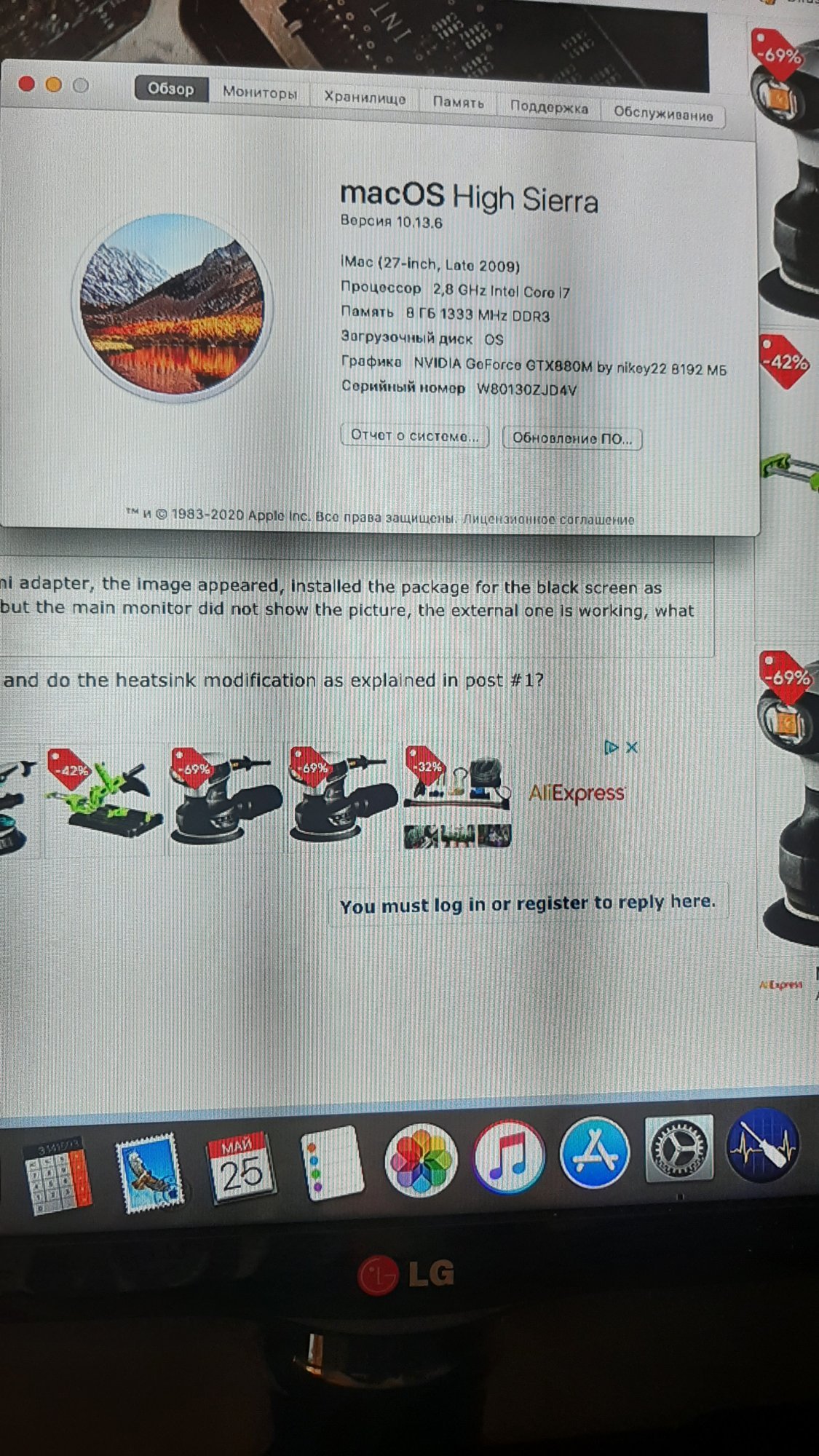

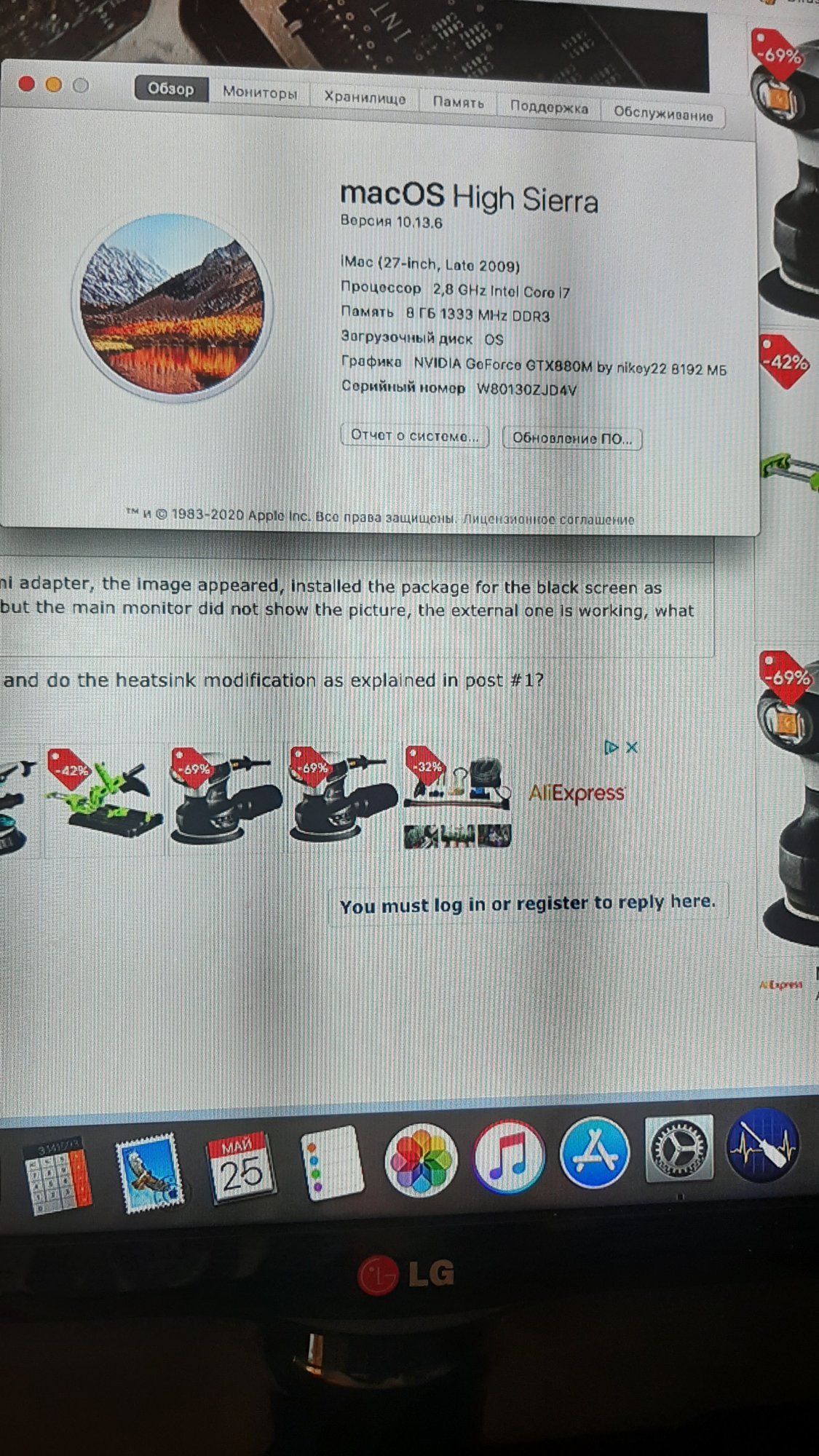

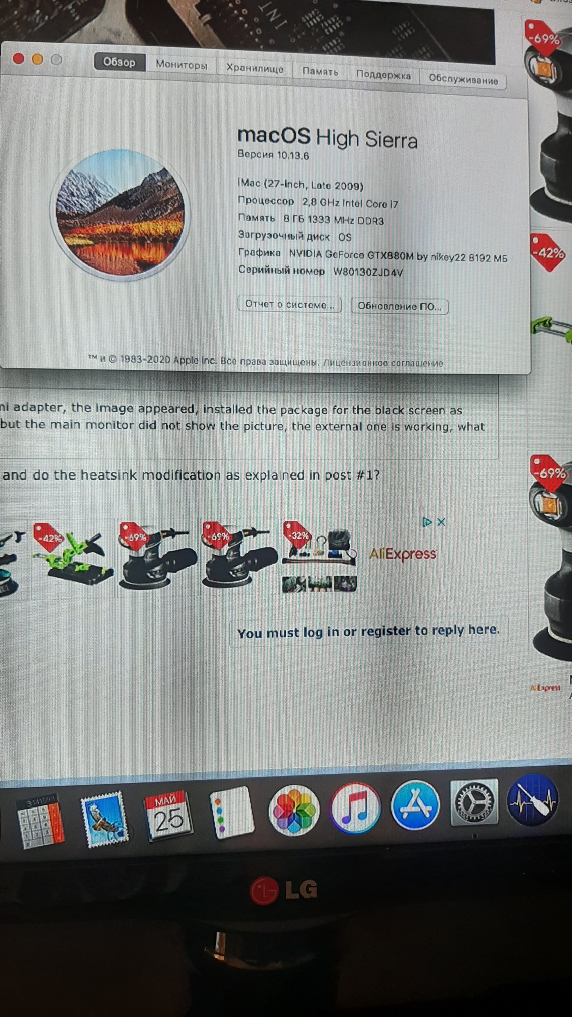

Hi,
I had a black screen and have connected an external display via TB/HDMI, works fine. But I wanted my old screen back to live. Installing the patch delievers me two black screens. Tested all the stuff noted but no success anymore iMac 2011, i5 3,4 , K4100M flashed version.
Any idea how to reactivate the external connection. Thanks, Greetings
Hi,
