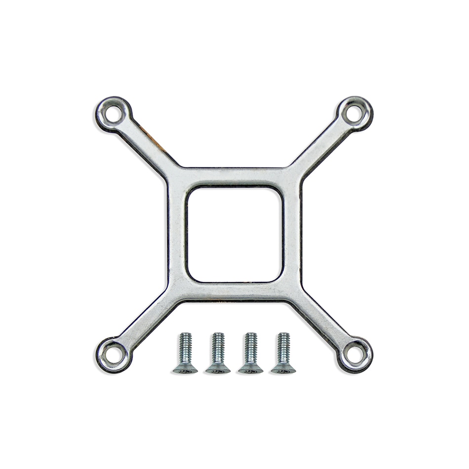

Does anyone know the size of the screws for the x bracket for the Radeon HD 4850?
Thanks.

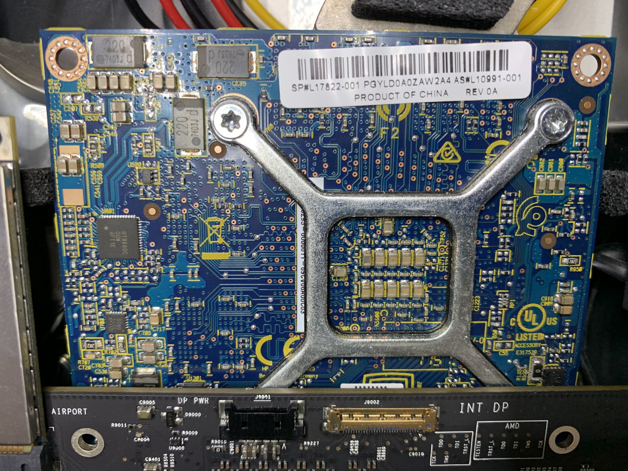

I'd like to report another successful POST of a modded HP WX4150 card in an iMac12,2 (27' 2011 iMac). I now have two modded HP WX4150 cards happily running in two 27' 2011 machines, reported temperatures are sensible (ie. they are no different from those reported by a machine with a Dell WX4150 built in). I also ran some GPU benchmarks - I did not notice any anomalies after 30 minutes of benchmarking.
On the other hand, while the card did POST without a problem in an iMac11,2 (21.5' 2010 iMac), some sensors reported abnormal values, CPU and ODD fans ran at full speed, and I believe that CPU was throttled. (That's still better than iMac11,2 with an unmodded HP WX4150 card - sometimes it POSTs, sometimes it doesn't, definitely does not POST with a HDD connected.) I replaced it with a Dell WX4150 (from my 27' 2011 machine), which works perfectly. I'm not sure (when) I'll investigate this (iMac11,2 + modded HP WX4150) further.
If your soldering skills are above basic and you have the tools required, please do try this. Here's how I did it:
  • a (at least) 50W soldering iron with precision tip and temperature control (80W+ is better, 50W should be enough for leaded solder)
  • flux (pen)
  • solder wick (to remove excess solder)
  • tweezers
  • magnifying glass (I did not use it, but I should.)
  • a (non-POSTing) HP WX4150 card
  • two 0R 1206 resistors (Buy more. They are really cheap and you will probably destroy one...)
  • 0.5mm (or thinner) solder wire
Two jumpers (the 0R 1206 resistors) are needed between the pads in the orange rectangles under the red arrows (see attached pictures). Those pads had some excess solder on my cards. I removed it with a solder wick to facilitate soldering later. Note that those pads are a part of a (relatively) large copper area, which means that a fair amount of heat will be required to melt the solder. Be very careful not to remove tiny capacitors and other components which are in close proximity. Cover cleared pads with a generous amount of flux. Place the resistor and align it with tweezers. Take your time. Use tweezers (in your left hand) to press down on the middle of the resistor (if it moves, align it again), then pick a small amount of solder with the soldering iron (in your right hand) and solder one pad of the resistor. Remember the 'large copper area'? A certain amount of heat will be required again. (This is really important to avoid cold joints. Believe me...) Again: Be careful not to short the nearby components. If you do, remove the shorts with the solder wick. Repeat for the second pad and second resistor. (Add flux as needed, you can remove excess flux when finished with a toothbrush and isopropyl alcohol.)
I attached some photos of my card before and after the mod.
Success!!
Although I am a lousy solder artist I managed with paste, heat gun, patience to solder the two 0K resistors somehow onto the board and can boot the iMac12,2 27 with this card and can use it with Big Sur.
THIS IS INSANLY GREAT!
(to cite the contributor of this thread)
Thanks for this development and post!
Note: bottom right corner of the picture in can see one of the resistors...
