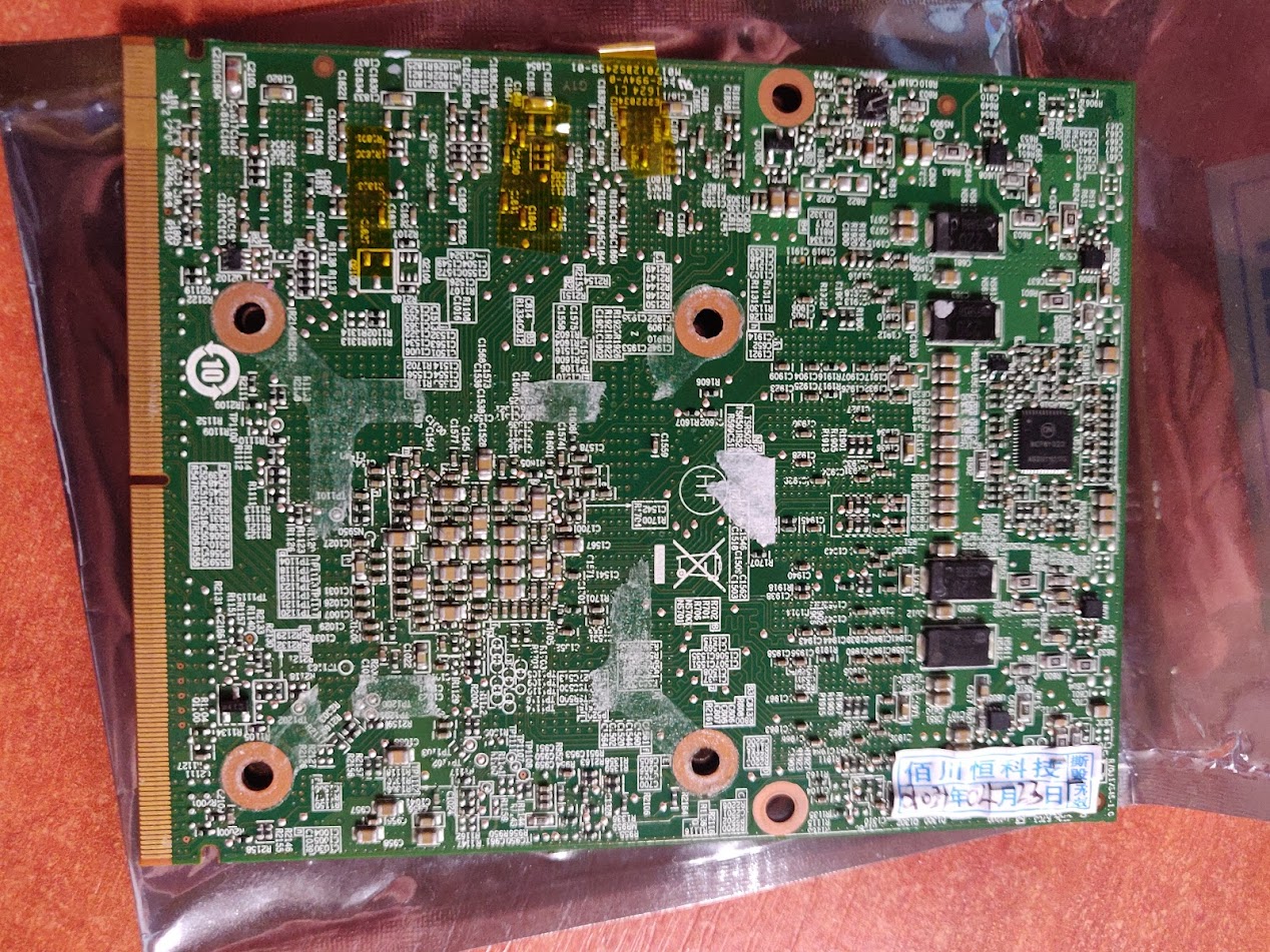

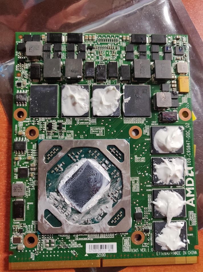

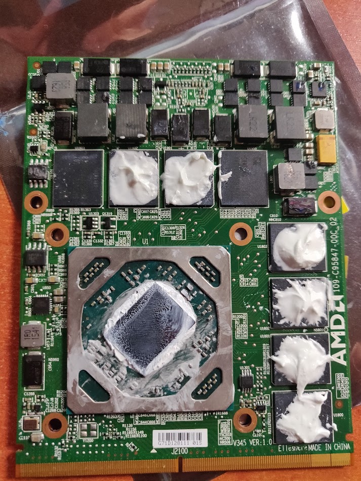

I bought a second iMac 2011 and a WX 7100 (I already have a similar setup up and running). I tried to flash the card this time with a programmer, but I think I managed to destroy the eeprom because I saw some lightning at the chip when using the programmer. When the card is in the iMac the fans just spinning for one second when turning on the iMac and nothing happens, with the old card everything works.
Would it be possible to replace the chip on the card or do you think some more components are dead?

Can you give us the version of the card? (Under the GPU IC, after V345…)

This symptoms are most likely caused by an incompatibility of some WX7100 cards with iMac12,2 models. Surely you have checked the first post about these problems - and no, this is still not an MXM card repair thread.

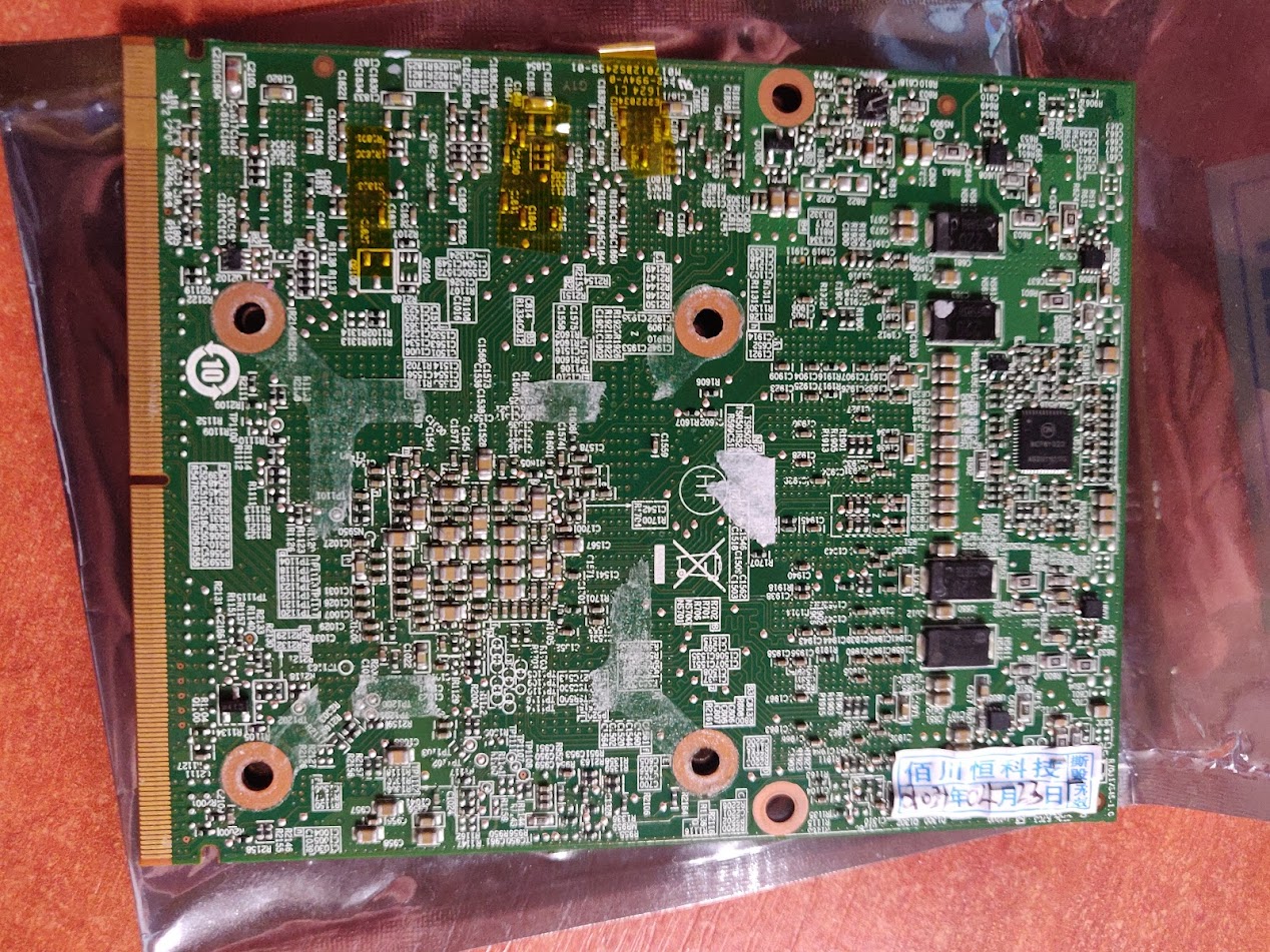

Post pictures of the card, you surely took one of each side before placing it onto the head sink.
Thanks for the fast reply. Please find attached a photo of the card. The version is 1.0.
Unfortunately, you (presumably) have an example of a non-POSTing WX7100 in iMac12,2 machines. I’m sorry to be the bearer of bad news.

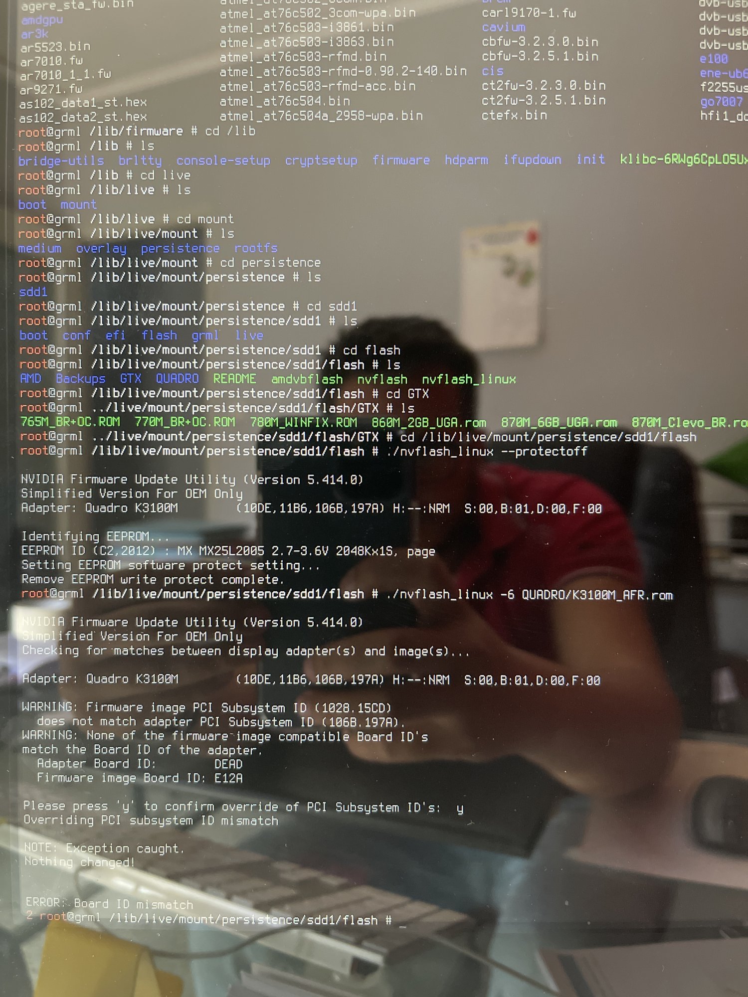

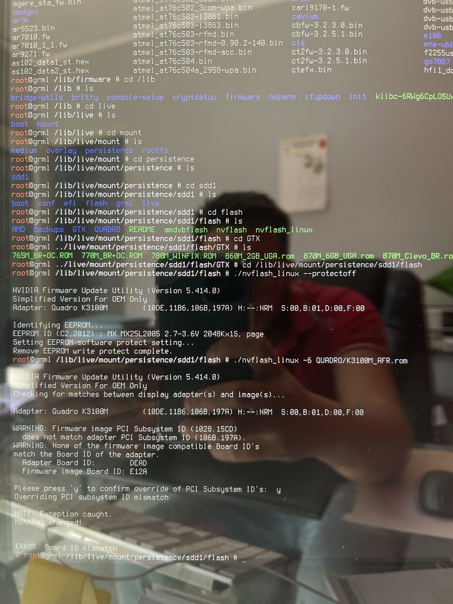

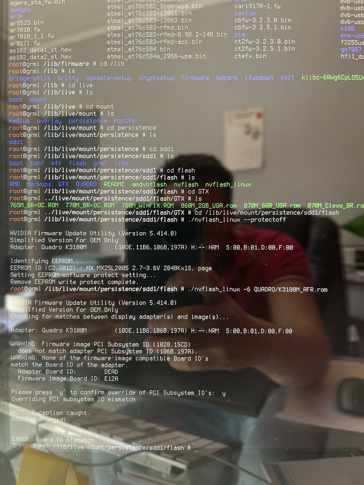

Here I am! I installed the video card, reassembled everything, inserted the usb linux to update the bios. I managed to backup the original bios. When I enter the command to update the bios I get this error:
ERROR: Board ID mismatch

./nvflash_linux --protectoff
I had already given that command. the strange thing is that the video card should be a k3100m framework instead now that I have also started the system it is recognized as a gtx 675mx. how come? is it possible that then it should flash with the rom for gtx 675mx? Now that I have everything mounted, can I flash bios directly from iMac avoiding SSh?

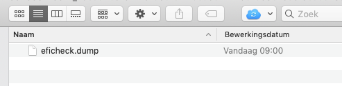

I dont know why but one of our 2011 27" iMac's with an flashed GTX765M running Mojave dosdude1 patched.
Is getting random sometimes efi.dump errors and macos errors/warnings.
the GTX765M was flashed a long time ago with the latest beta vbios, and as far as I can remember I have flashed the bootrom back to original.
Why do we still get these efi.dump and macos error messages, is not clear to me.
Is this perhaps due to running a patched dosdude1 based Mojave.. ?
Yes I will be running OCLP in the future on this machine, but still not possible atm since it is in heavy production use here..
Perhaps I have missed out on this info somewhere in this thread, than I am sorry for that.
But as far as I can remember this error with eficheck.dump would only occour when running a patched bootrom ?
I hope somebody can help me out on this one, thanks in advance.

1. On the Catalina Loader post there is this an extension provided with the OC distribution which disables the eficheck, likely you can to this yourself changing some macOS config files. It is not part of the OCLP - there are rarely users out using a modified vBIOS. eficheck is a normal system tool.
2. There has been a new vBIOS version posted by @Santa's Little Helper - check out the first post. It needs OC to get brightness working and you may just use the OC version including the EFIcheck disables kext just mentioned.
3. You may check the dumped file and the system messages about more details. You may have corrupted firmware?

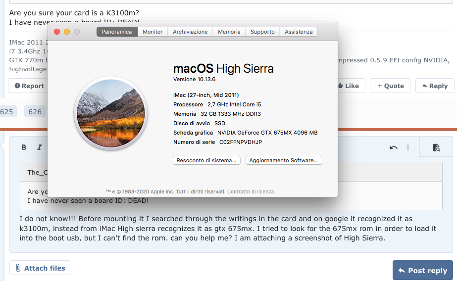

Are you sure your card is a K3100m?
I have never seen a board ID: DEAD!
I do not know!!! Before mounting it I searched through the writings in the card and on google it recognized it as k3100m, instead from iMac High sierra recognizes it as gtx 675mx. I tried to look for the 675mx rom in order to load it into the boot usb, but I can't find the rom. can you help me? I am attaching a screenshot of High Sierra.
Post photos of your GPU.
There is no modified ROM for a GTX 675 as I’m aware.
Feeling adventurous try flashing the 680 rom.
