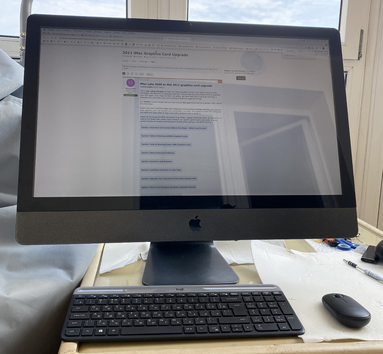

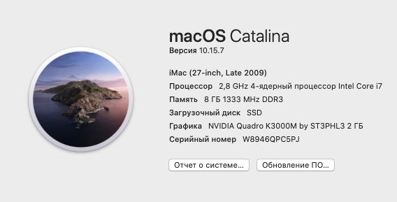

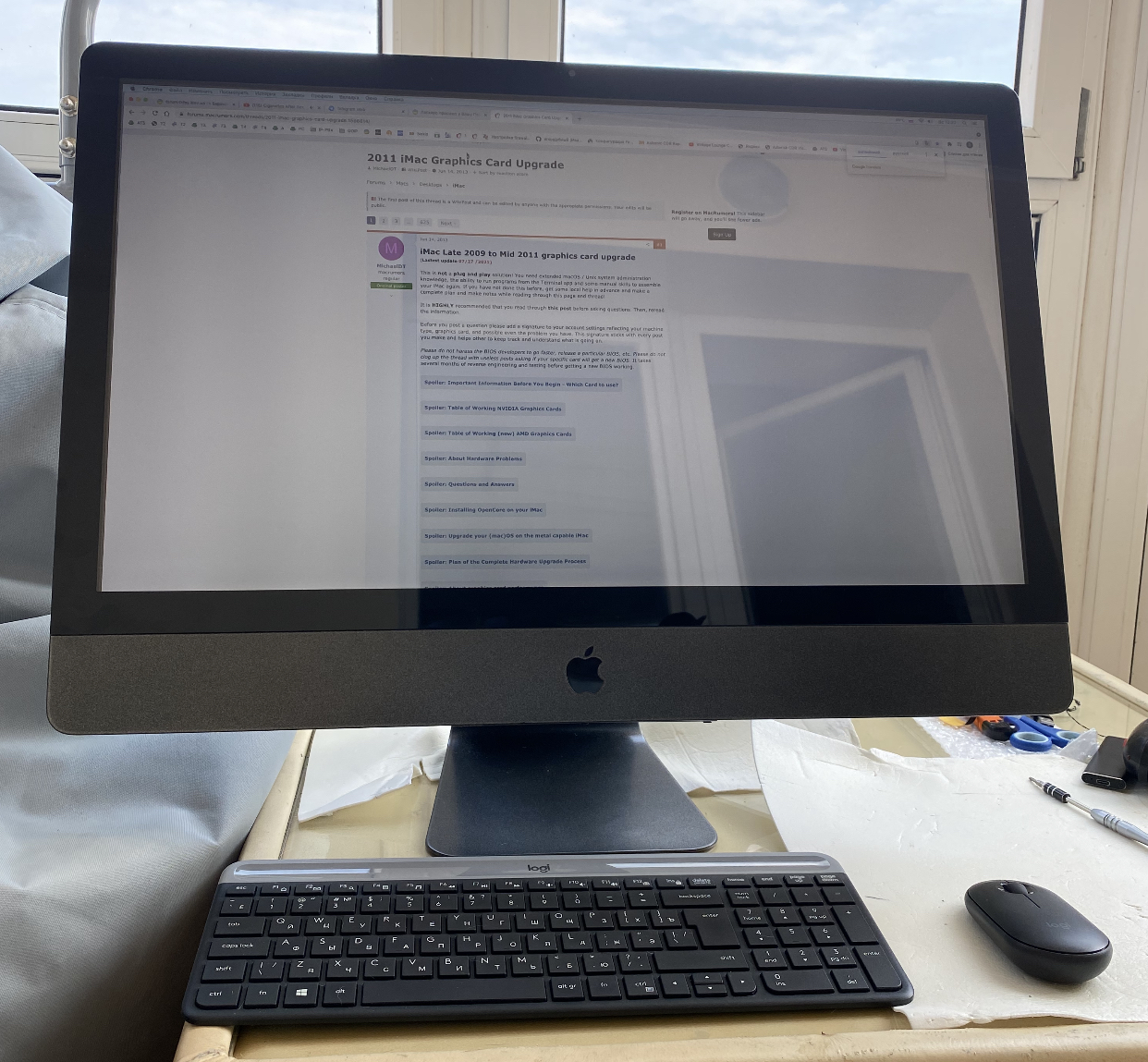

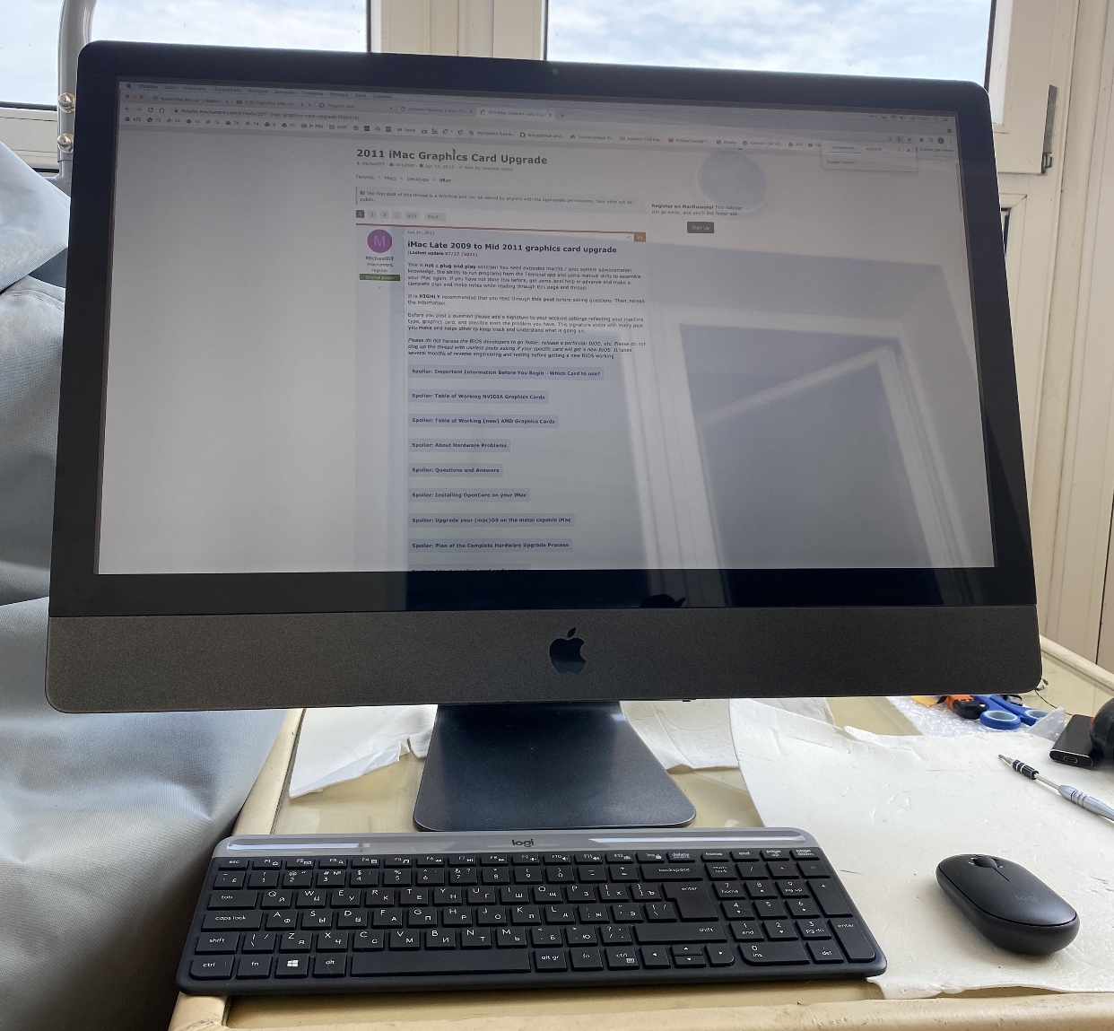

Another installation. Imac 27 2009, NVIDIA K3000 video card, body painting in space gray color! Many thanks to the developers and everyone else!
Reactions: ikir

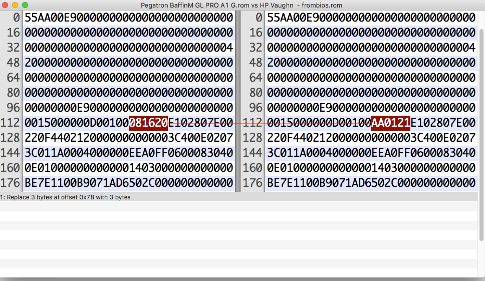

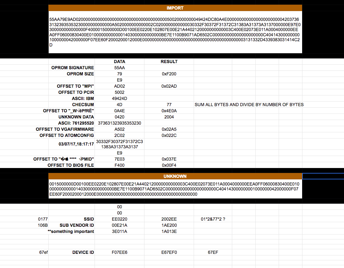

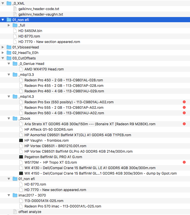

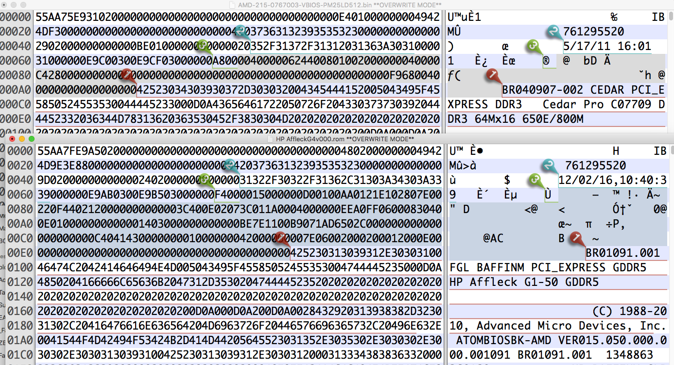

Vbios data for research of unknown data in the header:
The 6770 the last GPU vbios with that short data which located starting from offset to BIOS boot up message to BIOS boot up message itself, the next 7770 gpu has extended data. Maybe because the most systems became the uEFI, so efi driver was need more information to work with gpu.
i think that this data is for PCI host, that contain Pci dev id, ssid, vendorid, addresses, pci expansion revision, etc. Maybe that is something related to execution of firmware.
The another unknown fragment is located between ATOM CONFIG AND PCIR
included files:
That`s possibly SSID coded (3Bytes)
040B (0B04) vs D580 (80D5)
I think that its almost enough data to rebuild header of vbios for new, hope the most stable and final build
