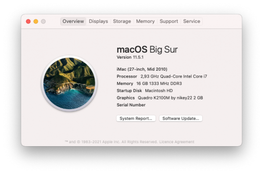

Hi,
I have a Fusion Drive in my 2011 iMac and I'm in the process of putting a K2100M in it. Now I am thinking, if the HDD fails, which means total data loss on SSD too, and have to replace it, how will it be possible if I have to boot the GPU with OpenCore? Basically it'll be a Hackintosh, so to set up a new storage config, in other words replace HDD, I'd have to put the standard 6770M back in again to do that.
Or will it boot vanilla, just without the backlight and maybe boot menu?
The other way that comes to mind is to set up now, before changing GPUs, to a High Sierra boot partition on the SSD and make a Fusion Drive with the rest of the SSD + HDD. (I like Fusion Drives, so please don't come speaking bad about them 🙂 )
Anyone can confirm or reject any of this speculation? 🙄

Hi,
If you do it correctly, OpenCore would be stored in 200MB hidden EFI volume of the SSD, which will not be lost when the HDD fails, unless the SSD itself is dead and not accessible.
In that worst case scenario, an Opencore USB can be created from any Mac to boot your iMac 2011.
Without Opencore, a normal iMac 2011 with flashed K2100m is expected to display the bootscreen if you press and hold "Option" when powering it on.
