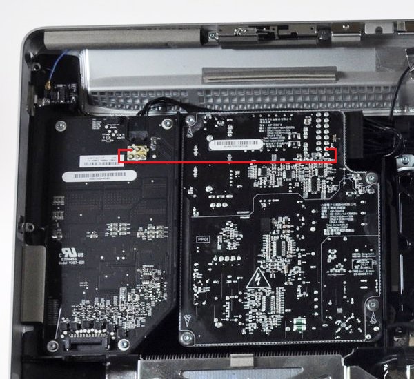

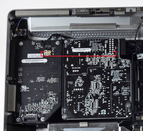

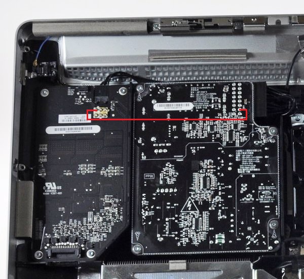

A DyingLight would fix your back-light problem, and give you adjustable brightness, but you could just hot-wire the back-light PWM from the 3.3v out on the PSU. I had the same problem with my Radeon Pro WX7100 (Polaris) card. Your 980 is getting stuck at P5 because of a power-limit in the BIOS, the easiest way to fix it is just to overclock the P5 state using Nvidia Inspector. Your welcome.
