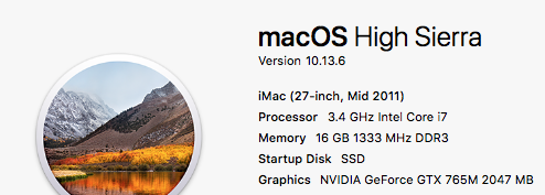

Hi everyone!
I've been following this thread for awhile now, and successfully install a 765m in my 2011 27 imac last night 😀
I'd like to install mojave on it now, and have a patched installer on a usb waiting to go, but of course without the boot screen, i haven't had any luck getting it to boot. I've seen a few people on here have pulled it off, how did you manage?

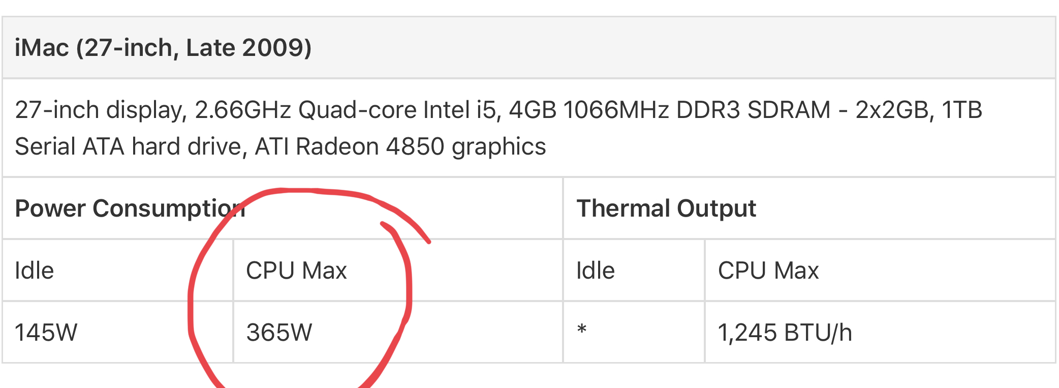

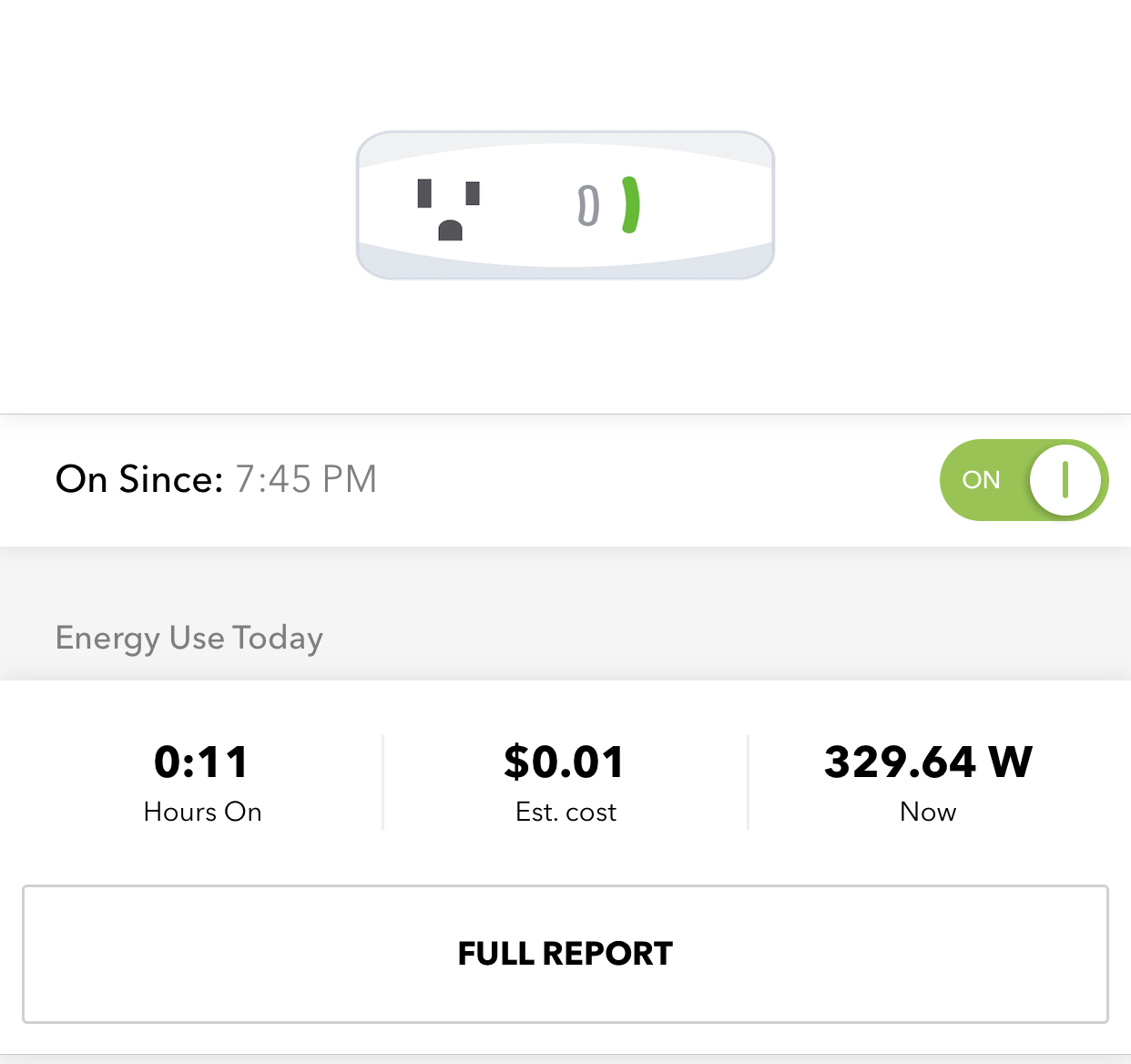

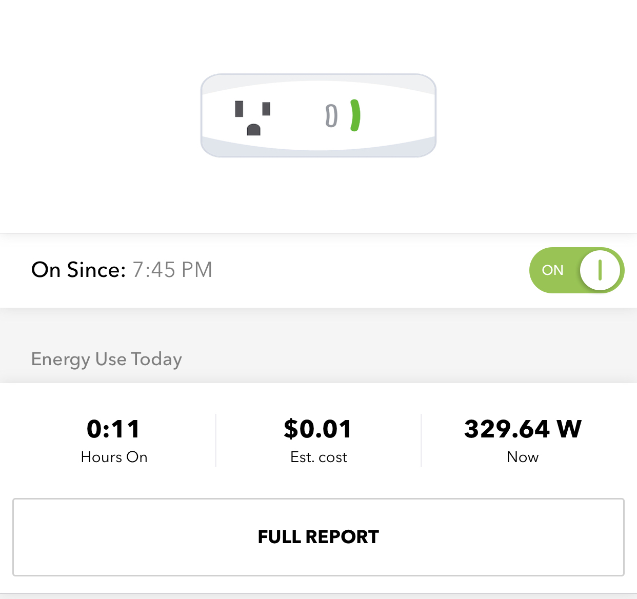

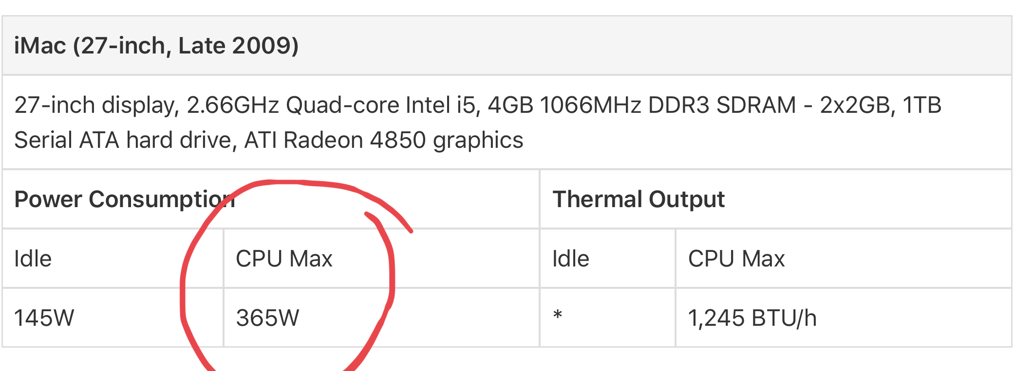

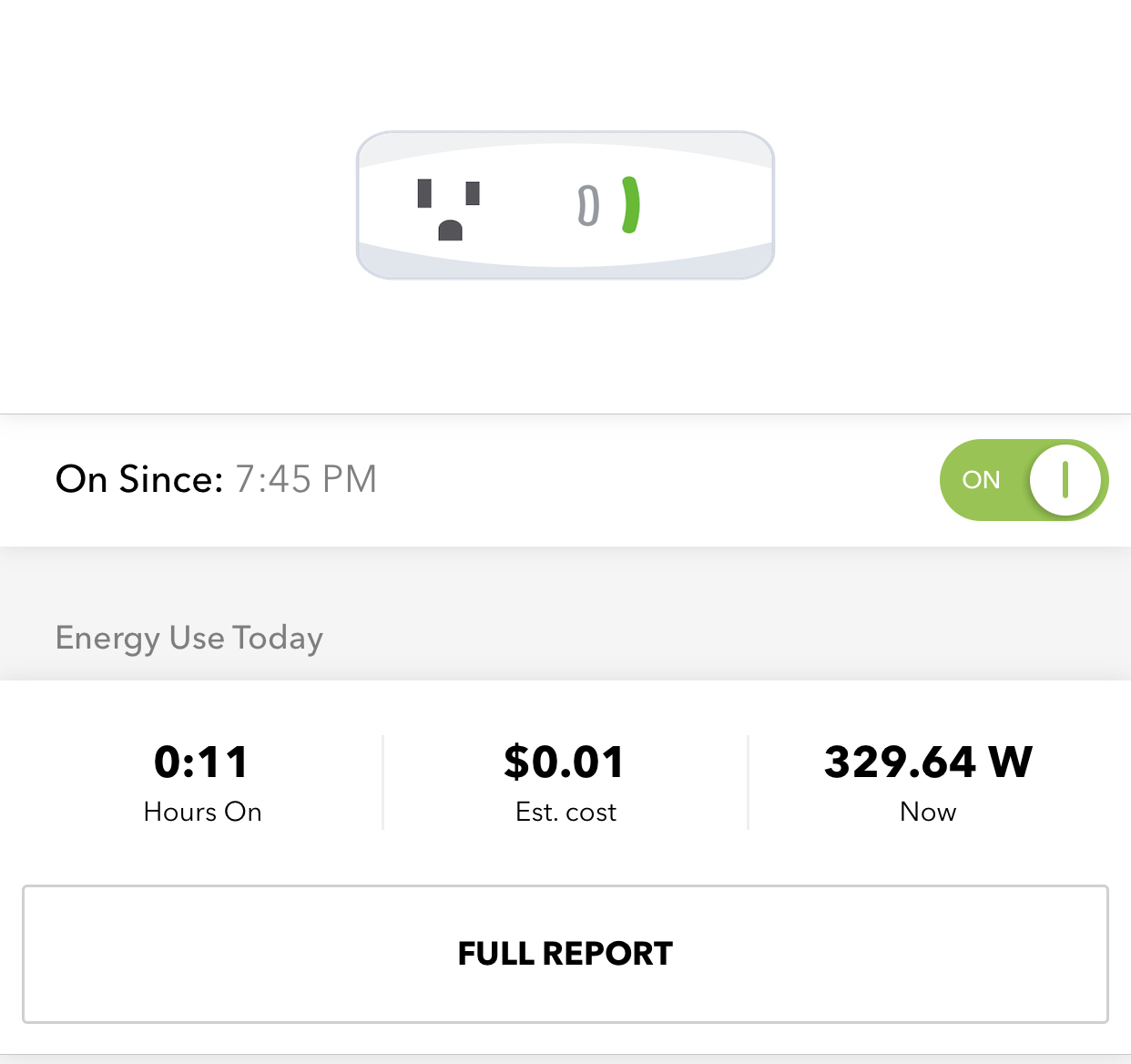

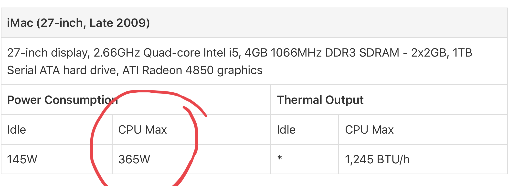

So... how close to the limit do you guys think that you can push the PSU? It’s a 310w PSU and I’m drawing 330 from the wall under heavy gaming load. With a 90% efficient power supply, that would put output around 297.
Update: So looking at Apple’s website shows that the 2009 and 2010 iMacs have a draw of 365w under CPU max... on a 310w power supply. What???
I'm not sure how Apple is drawing 365w from a 310w PSU. It's like they were wanting those iMac PSU's to fail. As long as you stay in the 300w range you should be good. When you were talking temps earlier did you have the fans ramped up to full speed? Also would you consider your new modded bios safe for others to use, would you upload it?
Edit: I wanted to also add the 2009-2011 iMac all use the same Delta PSU. Still don't know where Apple is getting 365w on the 2010 model.

Update on Apple PSU: So my calculation of efficiency were probably off. An 80 PLUS PSU is only 80% efficient at 100% load, so the iMac could be even lower due to no 80 PLUS rating. But assuming an 80% efficiency, that means I was only actually using around 264 watts. And, Apple's ratings were also from the wall, so they would be using 292 watts at 80% of 365 watts. Interesting... I may crank my GPU back to 1228 after all.
