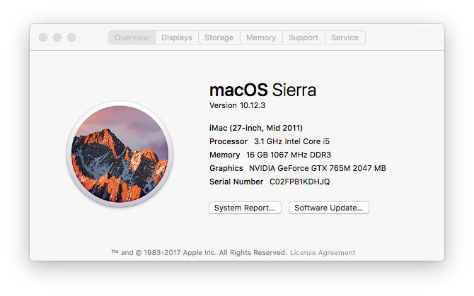

Yes. I installed a 765m in my 2011 27-inch a couple of days ago. Works fine; no boot screen, no brightness control and no second monitor. I've enquired over at Netkas to see if anyone had an EFI ROM that I could flash it with. Still waiting so if anyone has any ideas, I'm all ears.

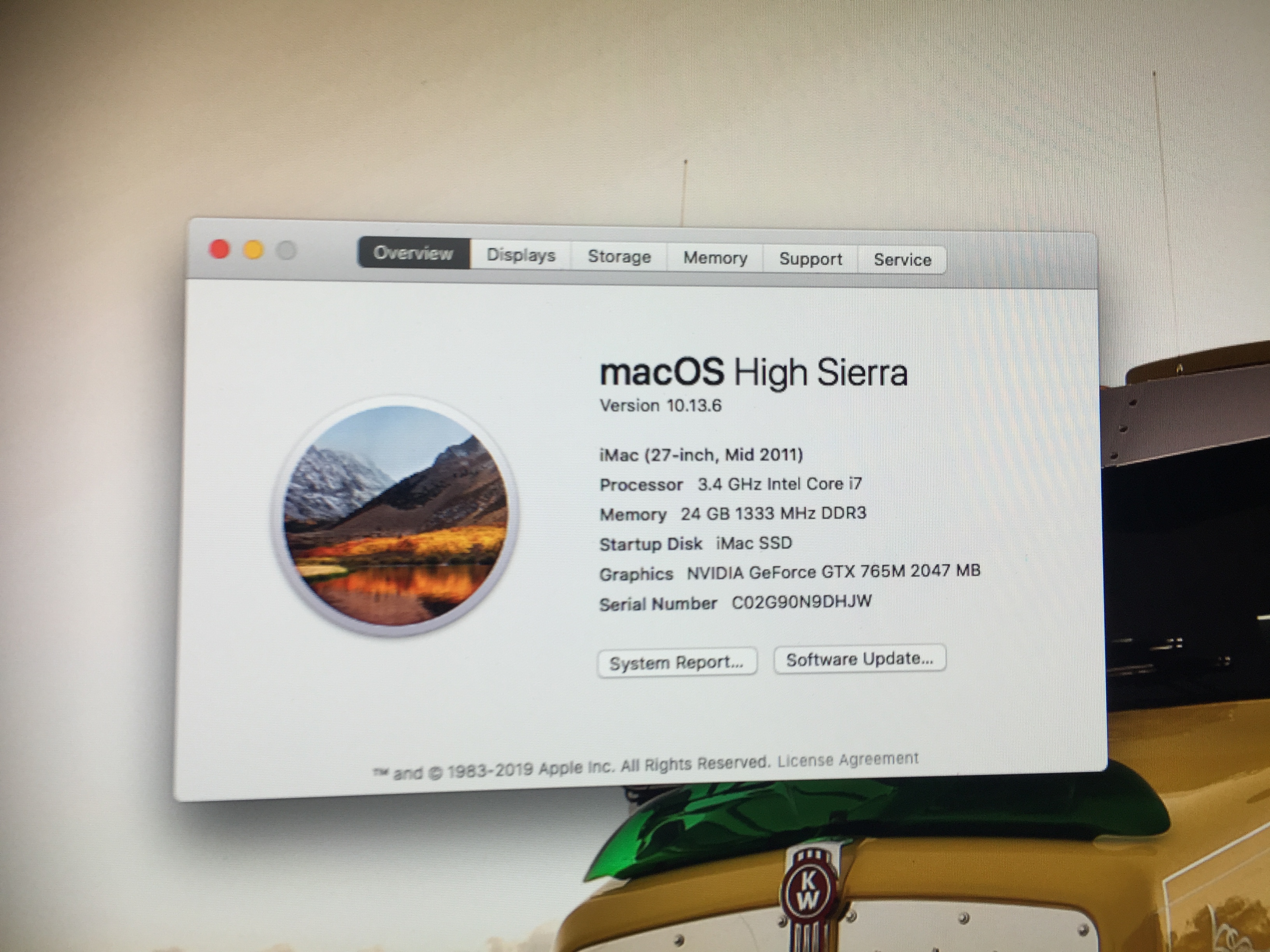

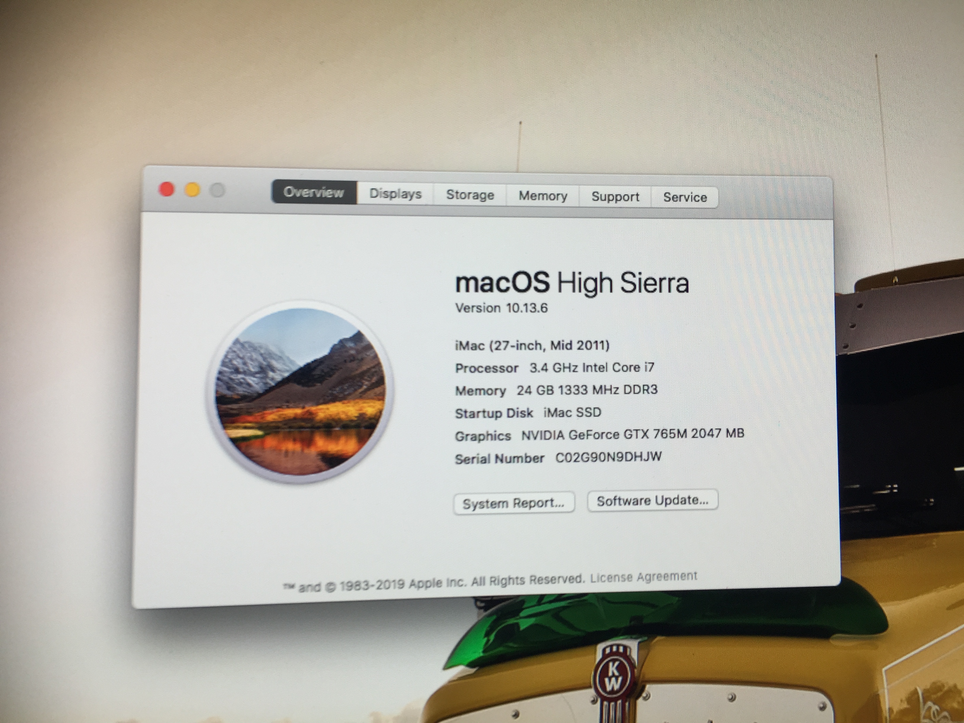

Another successful upgrade.
Alienware GTX 765m, booted up straight away, no boot screen and internal brightness control, but other than that working perfect.
Also only have 3 diagnostics led’s on the logic board, the 3rd one isn’t lit which was the same with the dead AMD card.
Very happy
Very happy
good, i hope you also used K4/K5 pro ?
and did the vram heatsink mod on the backside.. ?
