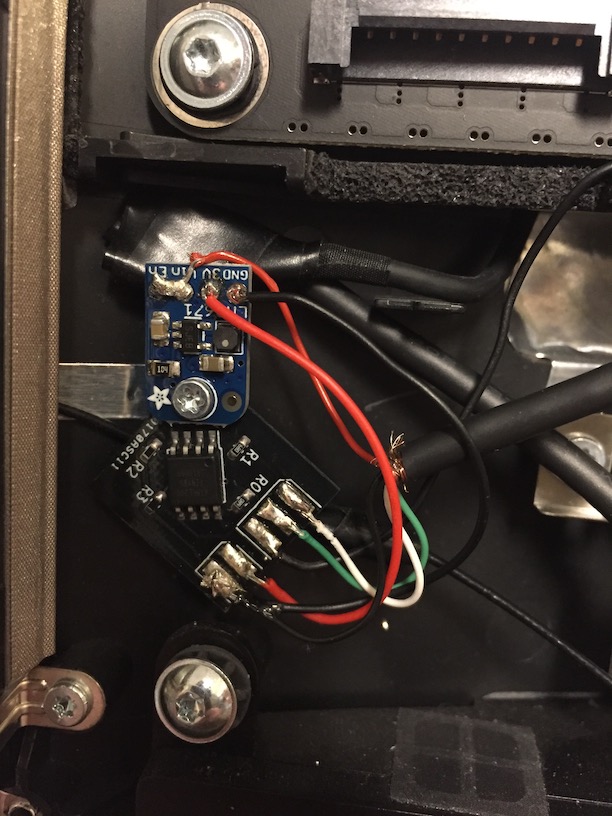

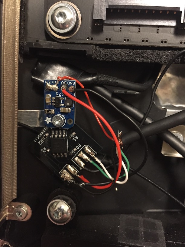

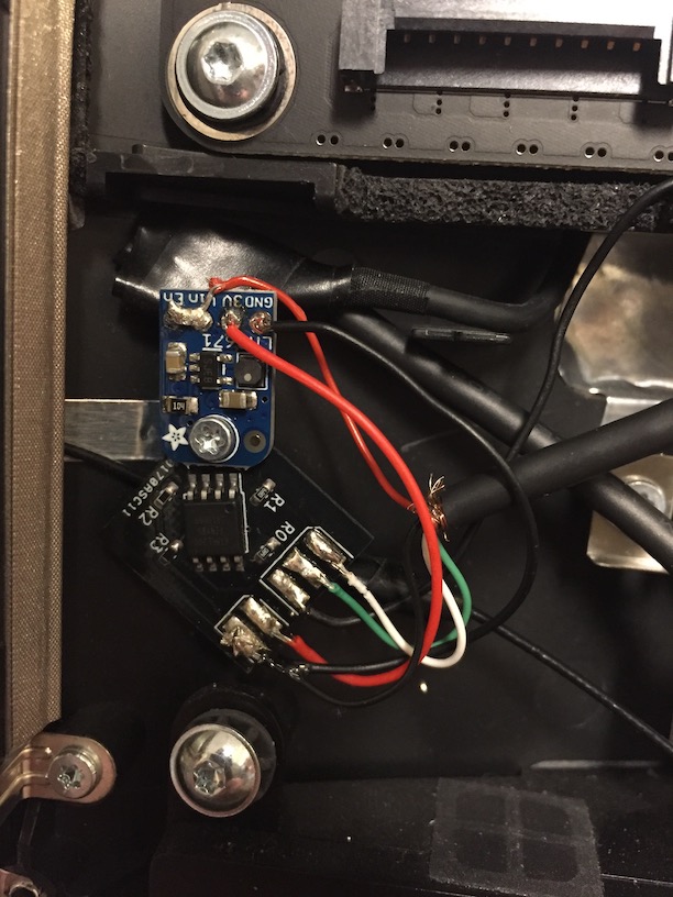

Sorry, I should have been more specific. I had a 3.3v buck converter laying around, unused from a different project. I used that to get the 5v to 3.3v.
Cool, it sounded like you might have been feeding 5v into the backlight board. As you also did the Bluetooth mod at the same time it might have been easier to tap the 3.3v from that join with the tape around it?
Yeah, I thought about that. I wasn't sure how much power i'd be pulling between both the bluetooth adapter and DyingLight off the 3.3v . While i didn't think it would exceed 500mA, I didn't want to risk it.

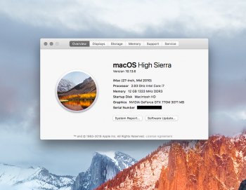

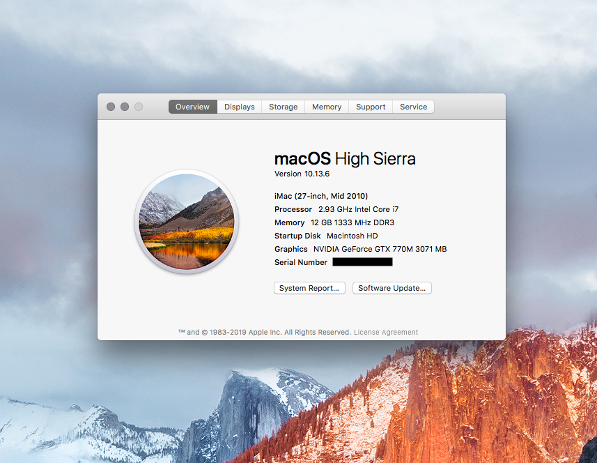

Just popped a 770M into my 2010 iMac after two years straight of lurking this forum thread. Still not in the sweet spot for a balanced machine but it's better than nothing, would try a 980M but I think the power consumption is too high. Anyone know what the maximum limit is for GPU power consumption on these iMacs? Anyone got any references I can go and look at?

980Ms don't work, only kepler based cards do. An 880m will work but require nvidia's flaky drivers. At this stage the 780m is the best card to get.
