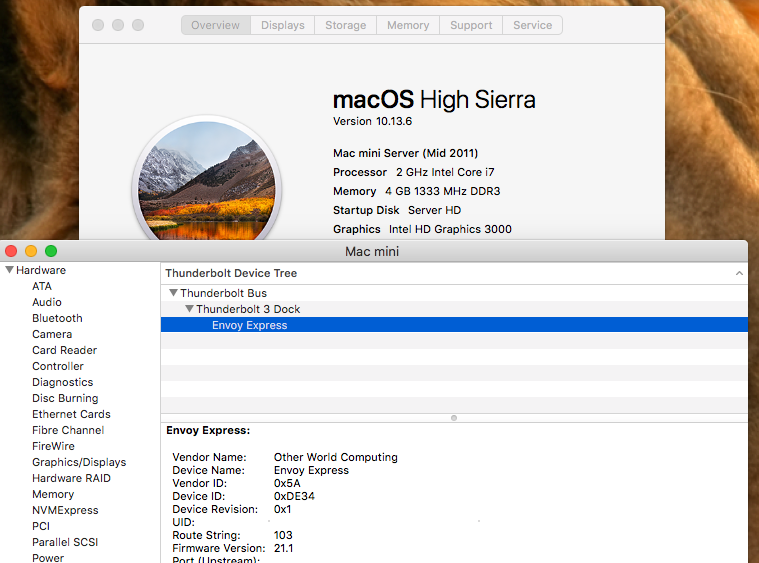

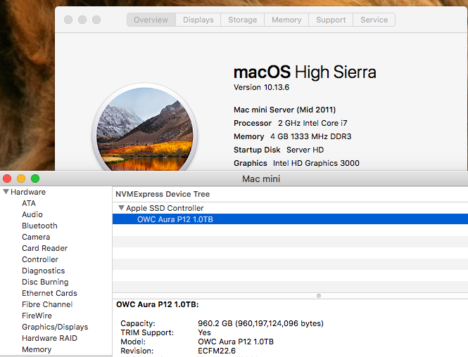

Here's a screenshot from Device Manager in Windows on the 2011 iMac (still booted off the ST3500418AS HDD).
Even if you can't boot Windows off it, it would still make for very fast external storage.

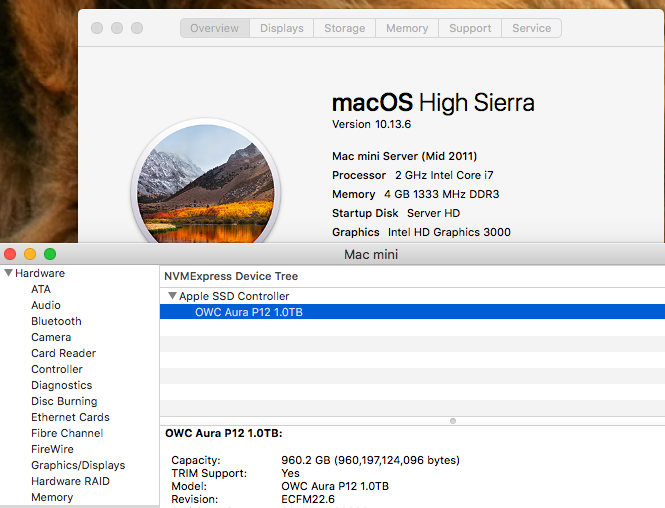

The enclosure I'm using doesn't go close to saturating TB3. It's possible some of the faster TB3 enclosures might give slightly better speeds. Still I'm getting pretty close to saturating the 800MB/s that TB1 can do for writes.
Reactions: USB3foriMac

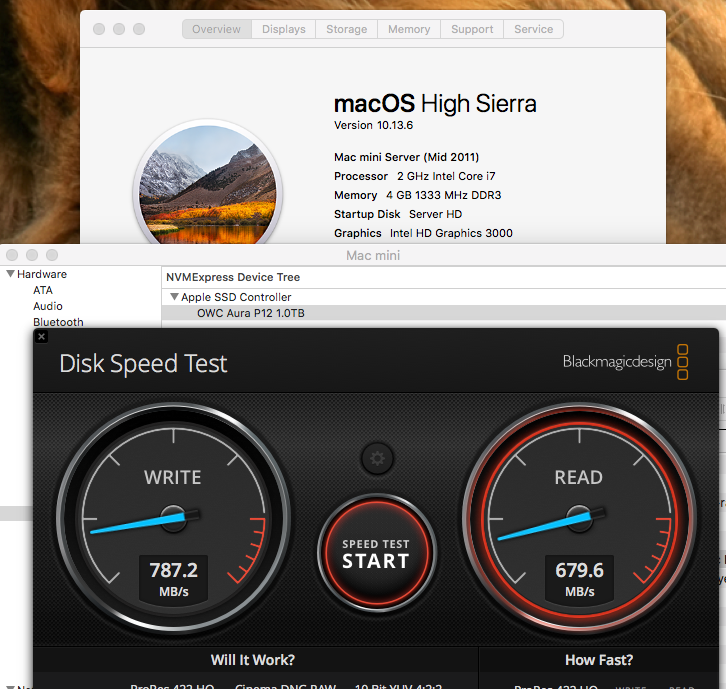

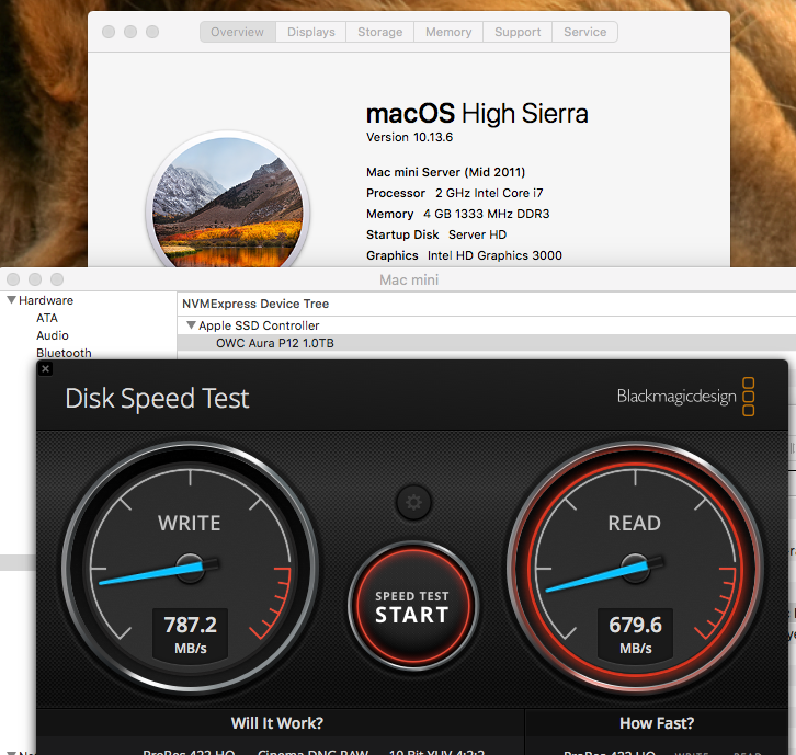

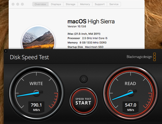

Here's a speed test from a 2011 iMac. As you can see the write speed with a TB3 NVMe SSD exceeds what would be possible with a single SATA III SSD.
I have connected OWC TB3 Envoy Express NVMe drives via OWC TB3 14-port docks to both the 2011 iMac and the 2011 Mac Mini. It works. I have booted High Sierra off the TB3 drive for both Mac models.
The dock has its own power supply so it can supply power to the drive. It’s not cheap but it does work. You are also limited to using High Sierra for compatibility with the drive.
It does mean that the bus powered drive that is meant to be portable isn't nearly so portable with these older Macs as you need to have a dock connected to power. I presume they don't promote this setup as they don't see a big market for it.

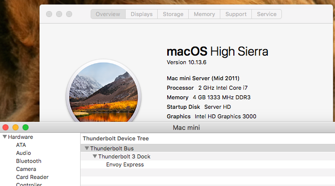

You get a 2011 iMac
Connect a TB(1/2) cable to the iMac
Connect the other end to an Apple TB3 to TB2 adapter (this is the only bi-directional adapter)
Connect the TB3 end of the Apple TB3 to TB2 adapter to a TB3 dock with its own external power supply such as the OWC TB3 14-port Dock (check system requirements to make sure it works with 10.13 before purchasing). The dock is needed to supply power to the drive.
Connect a TB3 drive (check that it works with 10.13 before purchasing).
I'm using the OWC Envoy Express TB3 enclosure with an Aura P12 NVMe drive inside.
This should work with all Macs with a TB1/2 port, I think, though I've only tested on the 2011 Mac Mini Server and 2011 iMac.
I updated to the latest High Sierra 10.13.6 with all security updates and cloned the hdd onto the external SSD using Super Duper. The Macs feel a lot quicker booted off an SSD.
The TB3 dock does have USB3 ports. Unfortunately it specifically states in the manual that the USB3 ports are only bootable on 2017 and newer Macs so I haven't tried booting off USB3. I haven't connected any USB3 drives yet to test file transfer speeds.
Currently I only have the Mac Mini booted off a TB3 SSD (trying to figure out if I can boot Windows off a TB3 SSD with the iMac - I almost exclusively boot Windows on the iMac, the SSD is still connected and is seen in Windows - though I think booting Windows off NVMe requires UEFI not sure if trying that would be safe on the 2011 iMac). I haven't done speed tests with the iMac yet but I presume the results would probably be similar with numbers a little better than an internal SATA III SSD but not by a huge amount.
View attachment 1698389View attachment 1698390

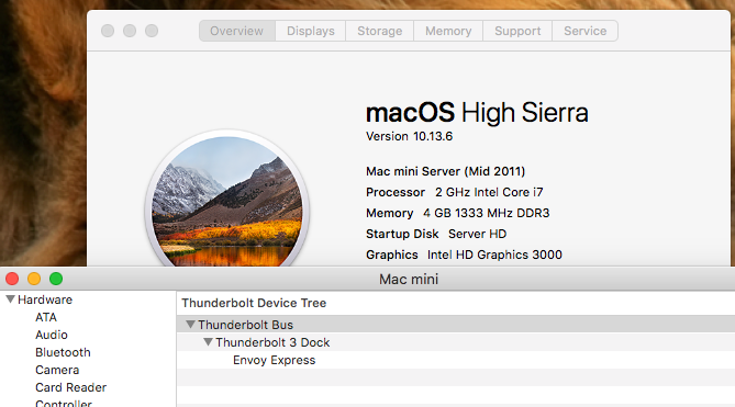

Did you not see my last post? It has a screenshot from the iMac and it is definitely the TB3 drive.
There
Is a very new product the TB3 Envoy Express. See https://eshop.macsales.com/shop/envoy-express/thunderbolt-3
It works. I can get more screenshots if you want but not till tomorrow as when I try to reboot remotely into UEFI Windows the Mac tries to boot legacy mode which won’t work. Making final preparations to clone the BootCamp partition onto the external SSD.

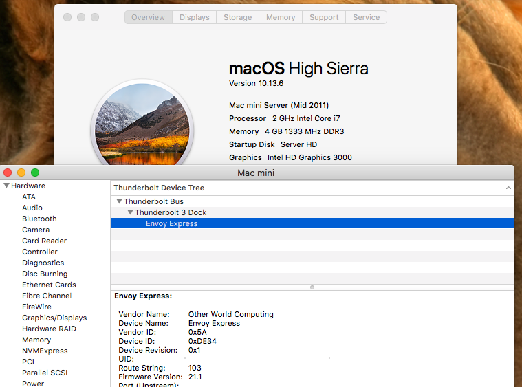

There

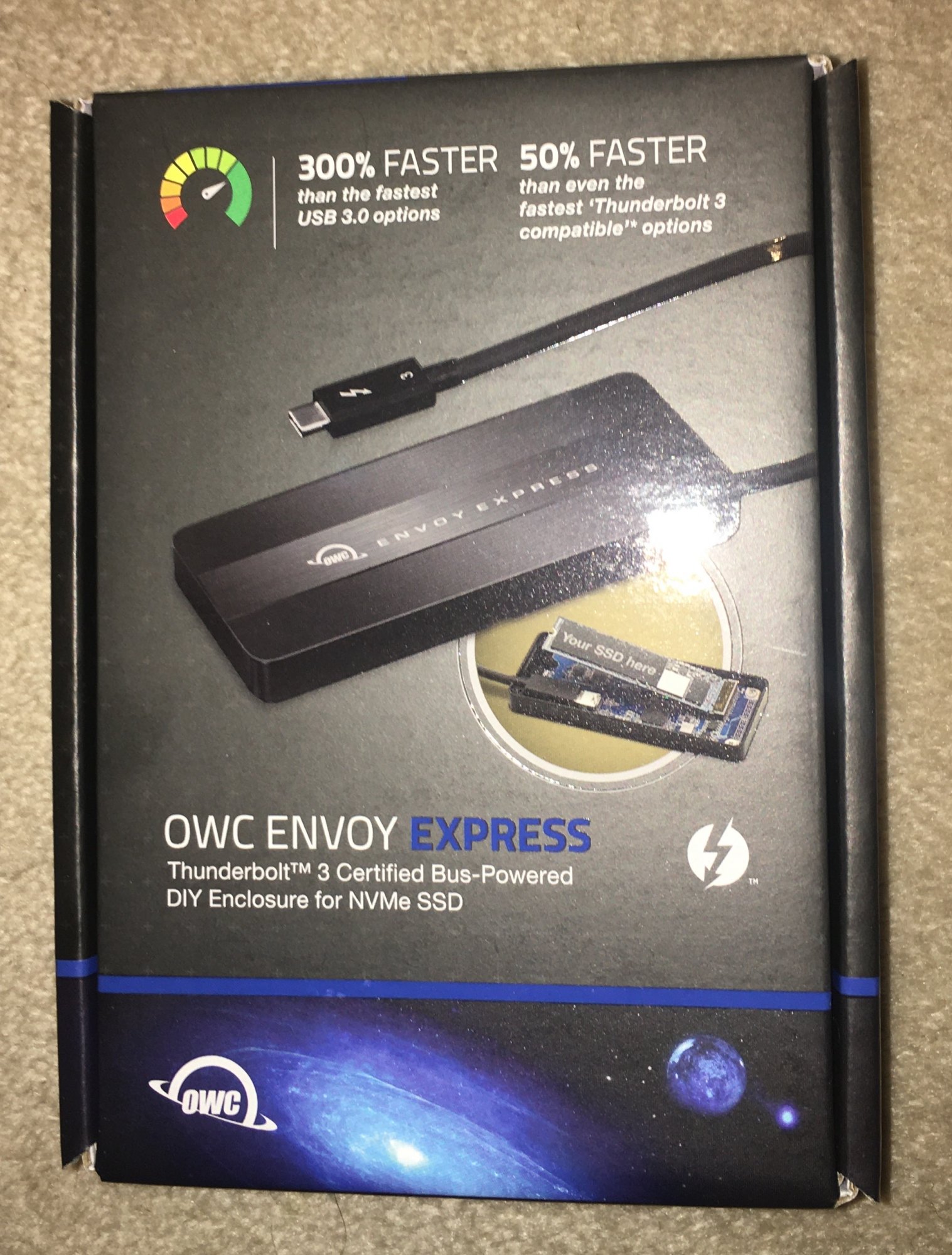

Please show a picture of the actual unit you are using.
Here's the box the drive came in. It's faster than a USB-C drive but because my Mac only has TB1 ports it can only achieve about half of what the drive can connected to an iMac Pro which is why the speeds are slower than what you'd get from USB-C on a new Mac.

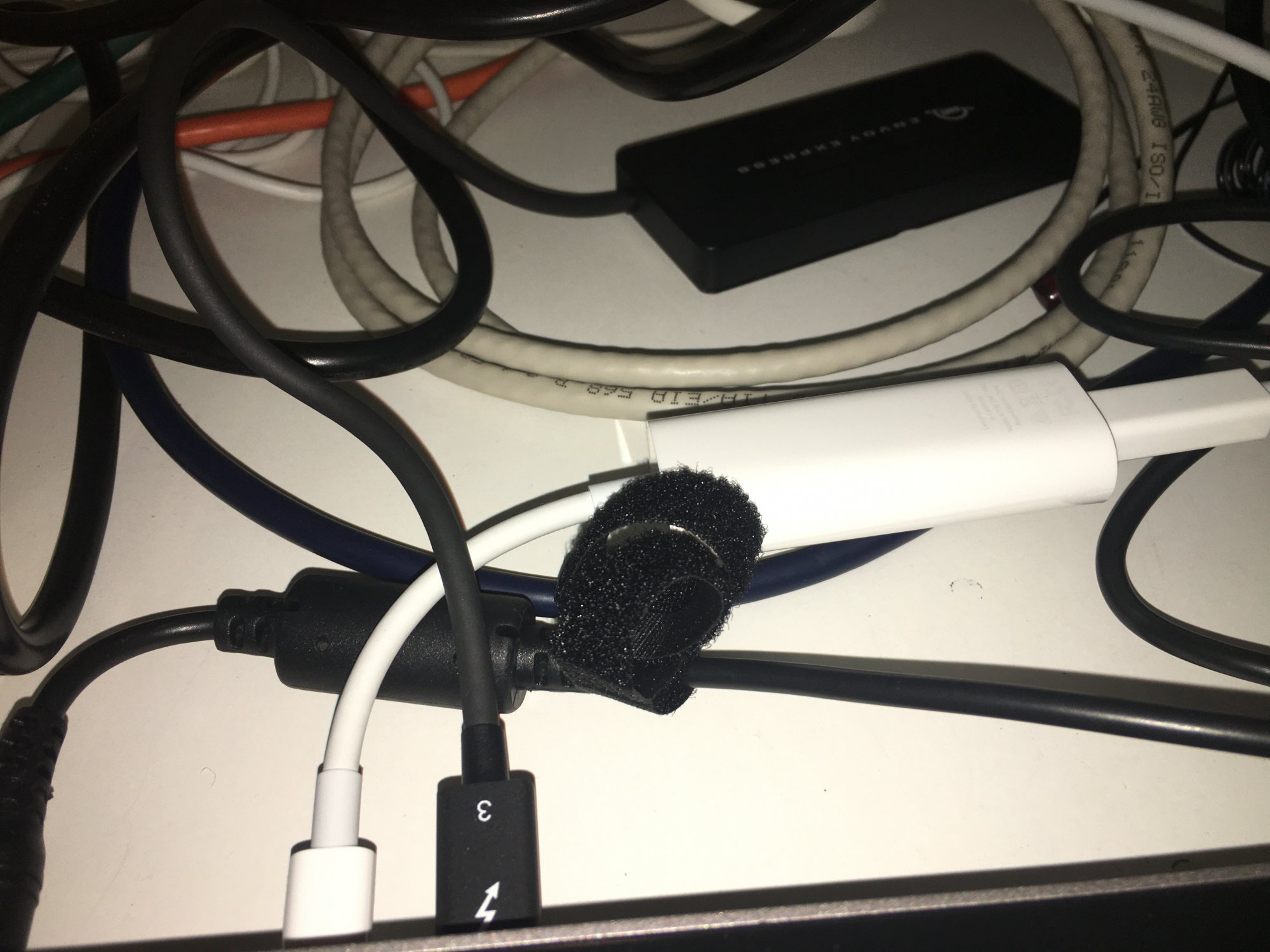

Apologies for the mess. You can see the TB3 drive connected to the dock using the TB3 cable and the TB3 to TB2 adapter connected to the dock and a TB2 cable to go back to the Mac and the power cable connected to the dock.

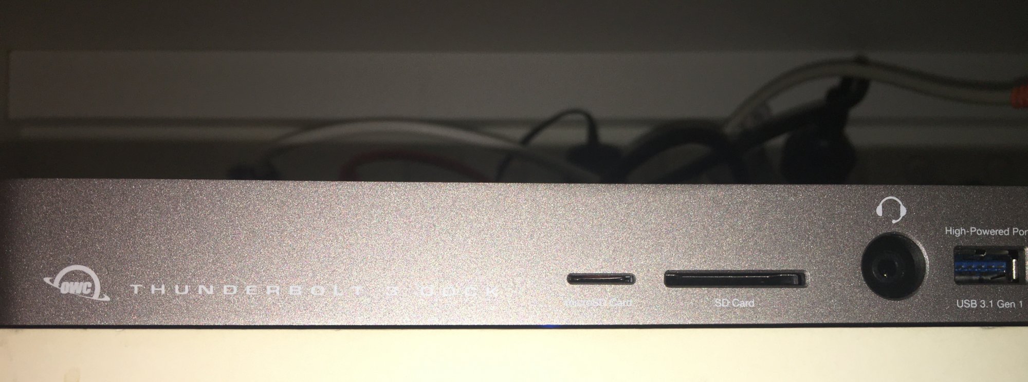

And here is a picture of the dock

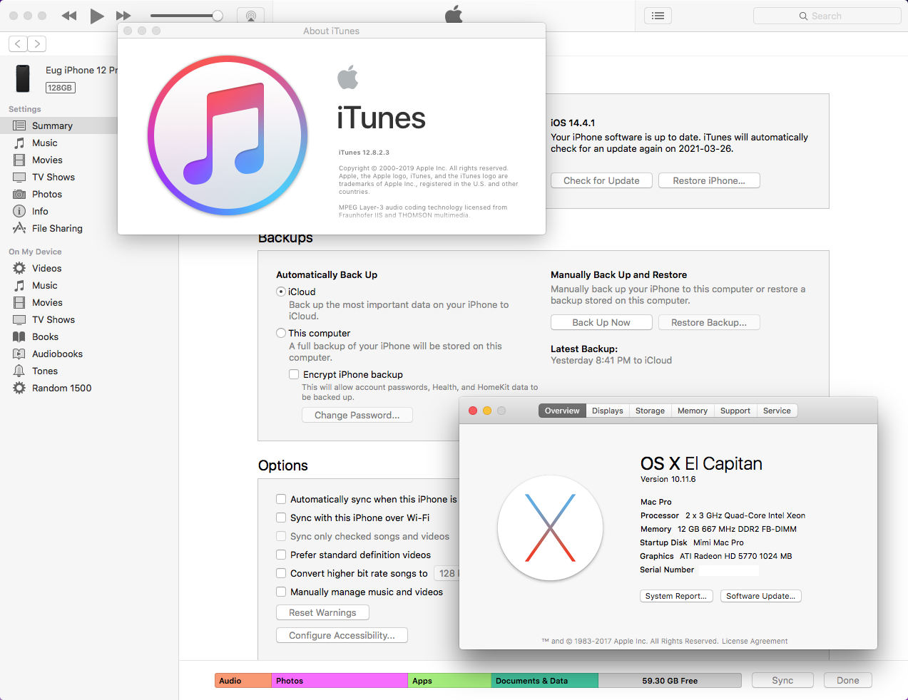

Confirmed. My main machine is on Big Sur, but I just tried this on my old octo-core Mac Pro 2,1 which is from 2007. Officially this machine is only supposed to support up to 10.7.5 Lion, but if you get the right video card, it can support up to 10.11 El Capitan without major hacks.
For added drama, I didn't even plug in the phone directly into my Mac Pro. I plugged it into my 30" Cinema Display, which is plugged into the Mac Pro.

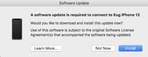

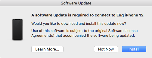

My iTunes version was already on 12.8.2.3 but required an update for my iPhone 12 Pro Max on iOS 14.4.1.
After the update, iTunes recognized my 2020 iPhone just fine.
Furthermore, I could see my iPhone's photos just fine in Image Capture. The Photos application sees them fine too, although I wouldn't really recommend that version of Photos (1.5) anymore as it is so old.
Thank you. I thought I was also on the most updated iTunes, but did just what you said: I downloaded and reinstalled. I got the same popup message when I opened, so I bit the bullet and allowed the install it wanted.
Everything works just fine again. Phew.

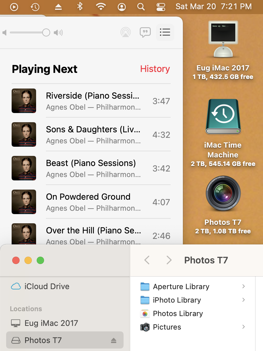

If you haven't already done so, I would suggest setting up multiple backup methods so that you can always go back to your old libraries as needed. I still have the last version of my iPhoto Library. I also have old Macs so that I can load up iPhoto if I wish, but I've already moved over the photos I wanted.
If you don't have enough space on your machine, you can purchase an external SSD like the Samsung T5. That what I did. (Well, a T7 in my case.)
(Note: The above is Big Sur, not High Sierra, just in case you're wondering.)
