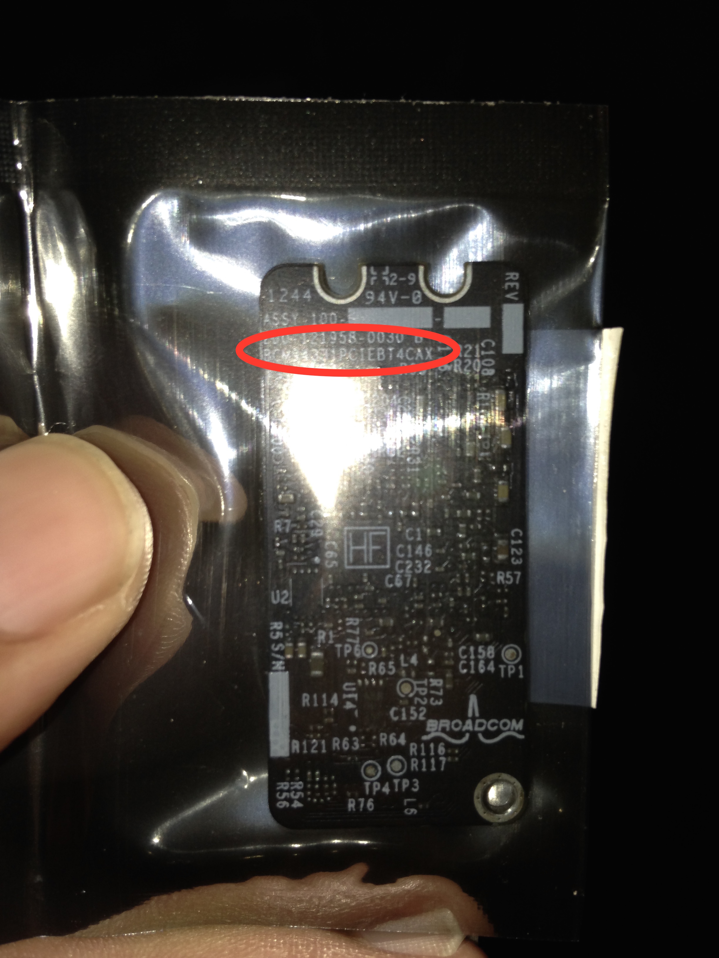

I Finally got my Airport card, just to be sure, this IS the model correct? (Does this also have ac Wi-Fi??)
