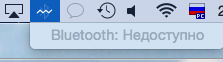

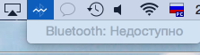

After replace card on BCM94331PCIEBT4CAX:
Wi-Fi working, Bluetooth - not avaible
What ideas to fix it?
