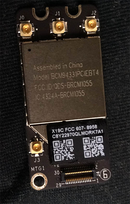

I can't get it work too. Today I just get the BCM94331PCIEBT4CAX from my supplier. Before the upgrade I can't use Knock app to unlock my MBP 15" late 2011 to work but now .. it works flawlessly.
I've follow above mentioned steps but it doesn't change anything. Do you have any other option or any special instruction or steps need to be done?

On your new card, what was the number on the front? (it should be something like 661-5867)?

Does the number on the front of your os-store purchase say "607-7292"?
Does the number on the back say "BCM94331PCIEBT4AX"
If so:
I think you have the wrong card.
If so:
The card i bought not from os-store, but written as BCM94331PCIEBT4CAX on the back. The front should be 607-8958
Any idea?

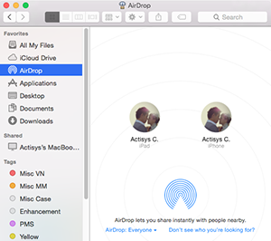

Replaced the AirPort card with the Mid 2012 model (purchased at Os-store), replaced the .kext according to the instructions in this thread (with multiple reboots e.g. after setting the boot-arg parameter to nvram).
After that, I got the option in System Preferences -> General back, AirDrop is enabled not only for older Macs and Handoff works with an iPhone (both configured with the same iCloud account).

Thanks guys, finally I know how to do it right. Below is my steps:-
1) open Terminal type sudo nvram boot-args="kext-dev-mode=1"
2) reboot your MBP
3) your wifi will not be working at this moment, replace the file IO80211Family.kext in Go>Computer>System>Library>Extension
4) open Terminal type as below:-
sudo chown -R root:wheel /System/Library/Extensions/IO80211Family.kext
sudo chmod -R 644 /System/Library/Extensions/IO80211Family.kext
sudo kextcache -system-prelinked-kernel
sudo kextcache -system-caches
5) now reboot your MBP again.
6) now you will see System Preferences>General> will have handoff enable option
7) open Terminal type kextstat | grep AirPort
Now you will see
130 0 0xffffff7f82c62000 0x5df000 0x5df000 com.apple.driver.AirPort.Brcm4360 (900.14.2) <129 47 46 12 7 6 5 4 3 1>
133 0 0xffffff7f83241000 0x1f3000 0x1f3000 com.apple.driver.AirPort.Brcm4331 (800.20.24) <129 46 12 7 5 4 3 1>
You're DONE :) Cheers.

booom works now! Thanks dudes
Yep working now... can't seem to get airdrop to work tho ! but continuity is working great
Any idea?
This is the one that I just bought and I THINK it's correct. I literally just bought it so I don't have it yet. Will probably be a couple weeks until it's delivered.
The front says 607-8959. Wonder how different it is from 607-8958?
The back says BCM94331PCIEBT4CAX.
Here's the link to the ebay store.
http://www.ebay.com/itm/13-MacBook-...US_Internal_Network_Cards&hash=item2ec72ba156
