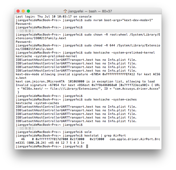

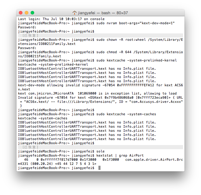

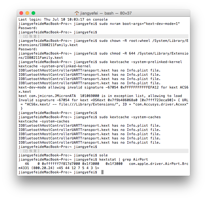

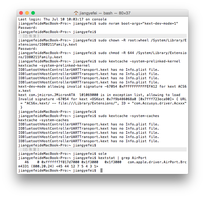

11 late mbp 15inch
I have replaced the Airport card with BT4CAX type. And run as u said in Terminal
but the Handoff was still disappeared.
and the Terminal was show below
What's wrong with it?
11 late mbp 15inch
gunightess,
Follow those steps again, make sure you restart each time as indicated within the steps. I had better luck powering down instead of restarting then using the physical button to reboot.
My mac had a grey screen for several minutes so don't panic. but as always it is a beta and make sure you backup before trying anything.

gunightess,
I have tried it for serval times, but still no response. And the Terminal reports some issues with bluetooth(see front).
