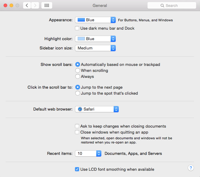

Even i can't see the handoff switch in General

it still not...
attachment.php
