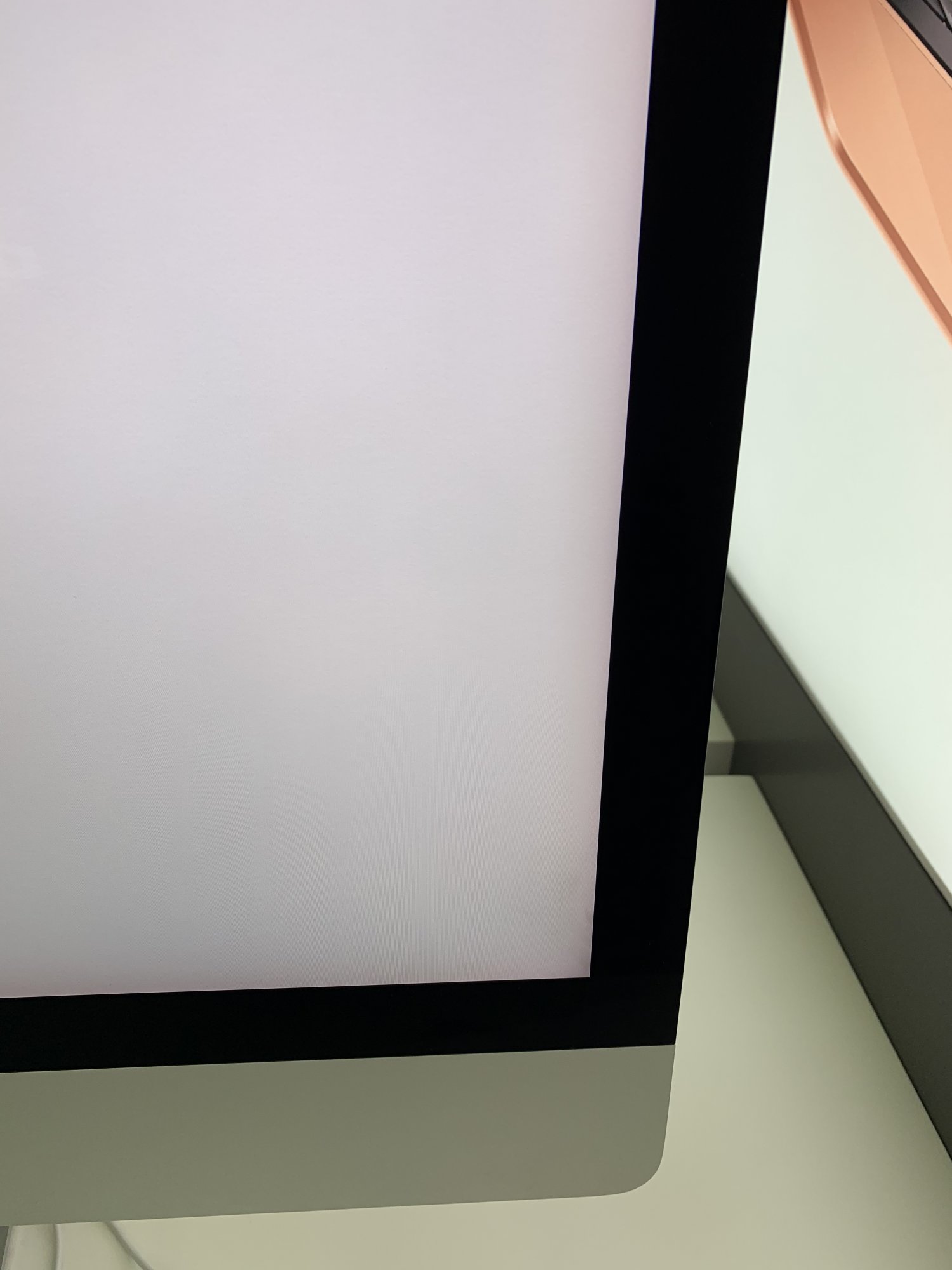

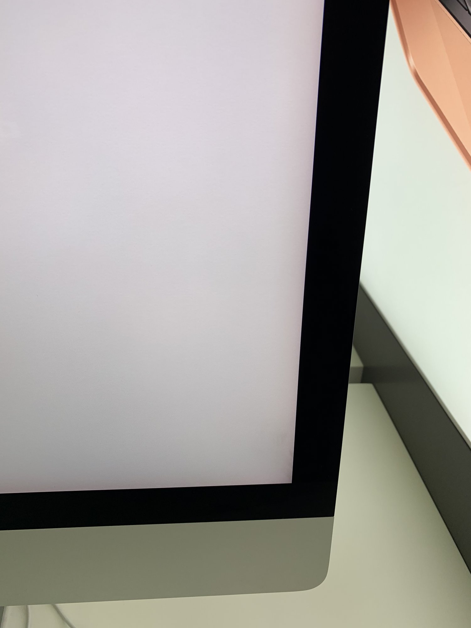

Come to local electronic shop and found this pink edge on new 2019 iMac.

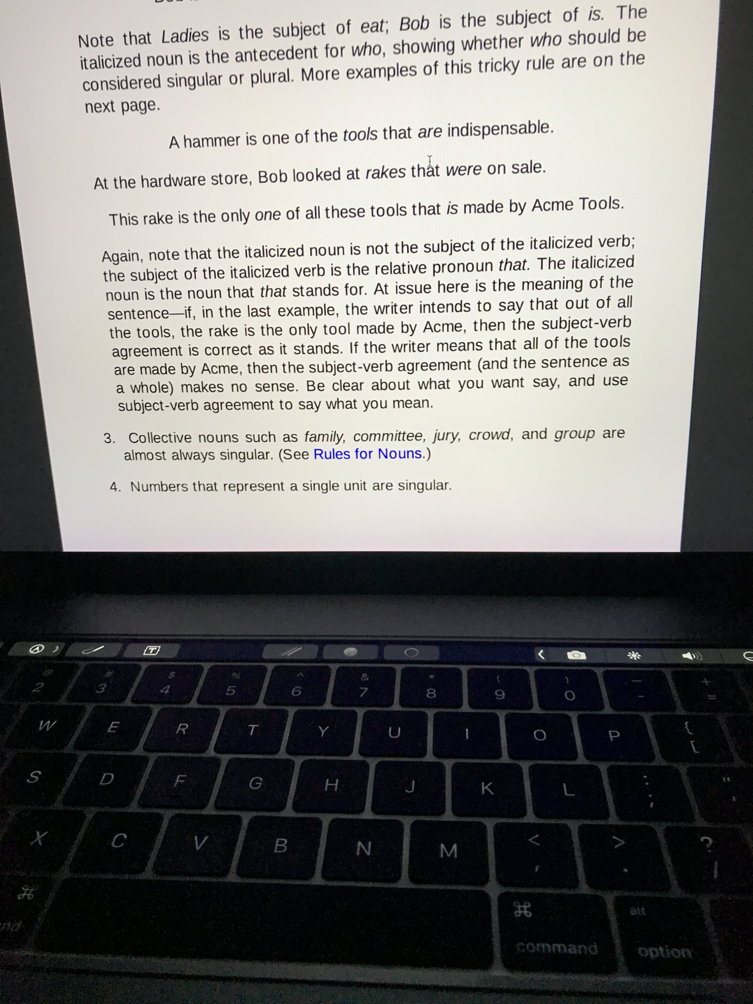

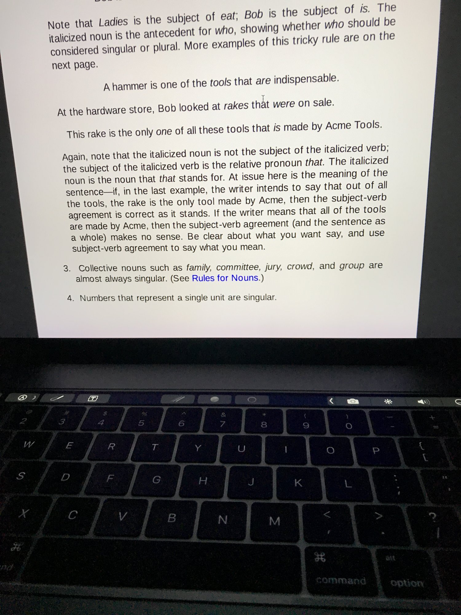

My Macbook Pro 2016 15 inch has this problem as well. How should I fix this???

This looks like maybe backlight bleed with the color affected by wallpaper.
[doublepost=1566757831][/doublepost]
Yep. I think it’s bleed also
It has nothing to do with the wallpaper. You can clearly see the pink color at the edges of a Word document or other white window that's at the edge of the screen.

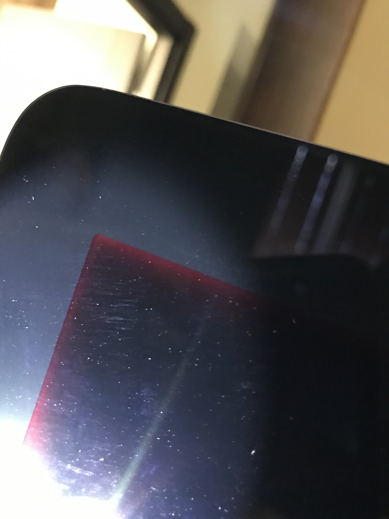

I have 2015 iMac. I realized the same purple line along the edges and shutdown the machine, then looked through the edges with a strong light. As you see in the photo Apple had used a red glue to bring screen and the alu body together. This may be the reason why we see a purple light around the edges, it doesn't bother me though. If they had used black resin then on a white screen a black bar could appear, with a white resin then white bar could appear around the edges on a black screen. So red choice may be on purpose. Moreover I 'm not sure if its a glue, it may be something else. If its a glue then they could use it away from the edges and color would not be reflected to the screen that much.
Reactions: Polochamps
It's true, I checked it too. So this is not a monitor lighting problem. Of course they could use a transparent material, not red!
