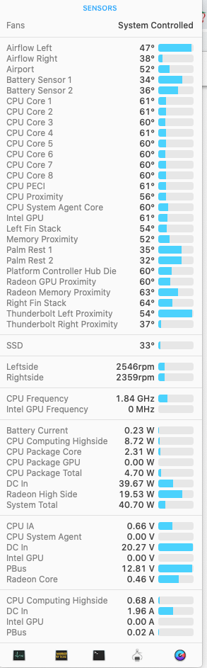

Using 2012 imac as monitor via thunderbolt 2-3 adapter. Both imac and macbook screen resolutions/scaling set to 'Default'. Fans always around 2600rpm on idle. Very annoying. Also tried 4k LG monitor with usb-c hdmi adapter, also usb-c mini dp adapter, same result. On small load, fans go crazy and after the load, it takes 10 mins to fans to go back to 2600rpm. They never return to 1800rpm, which is normal idle fan speed.I suspect it's not about cpu temperatures, but it's about thunderbolt or Platform controller hub die temperatures. Also looks like Windowserver process is always using some cpu.
When not connected to external monitor, everything seems normal. Fans around 1800rpm on idle.

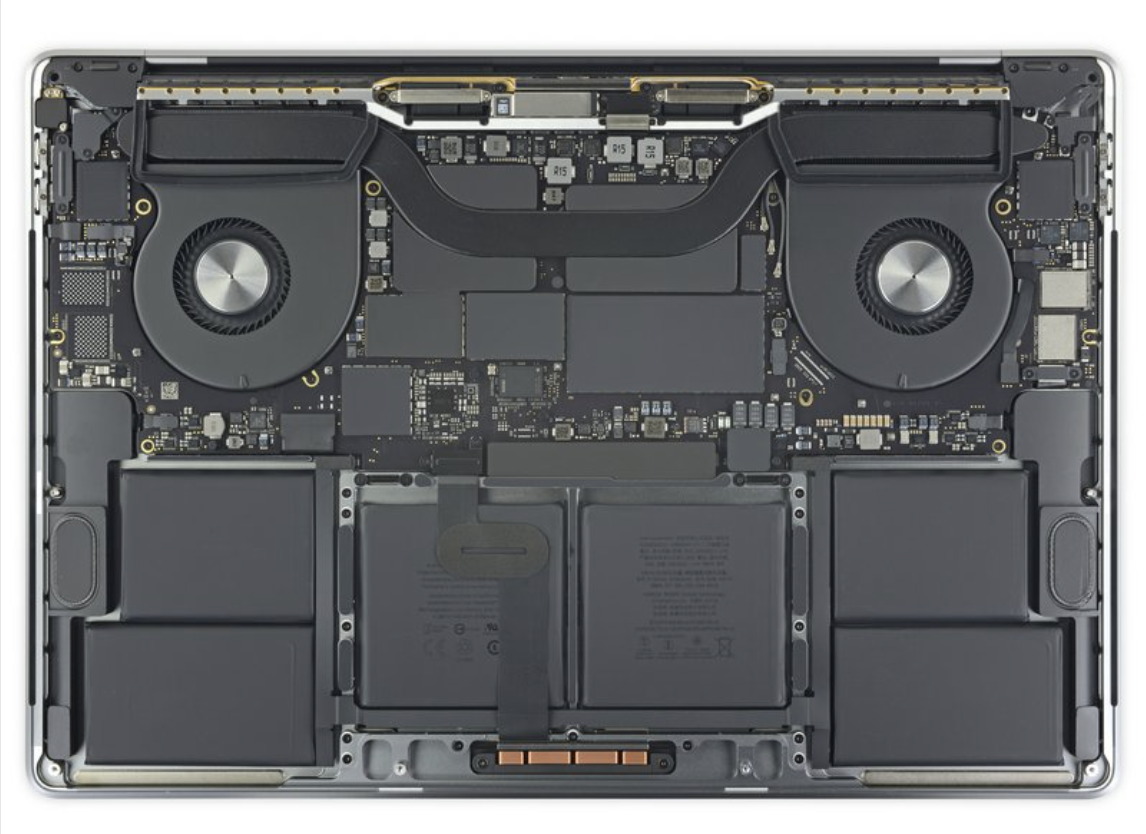

Mind that the same heat pipe goes trough GPU and CPU. When connecting an external Display, the GPU start to work harder, it's pretty obvious that it will become hot.
Please look at this picture. There's only one heat pipe!
The are multiple heat pipes the same as on previous mac but they look bigger bigger and run to 35% bigger heat sinks.
See the iFixit tear down for details.
https://www.ifixit.com/Teardown/MacBook+Pro+16-Inch+2019+Teardown/128106 Steps 7 and later have the details.

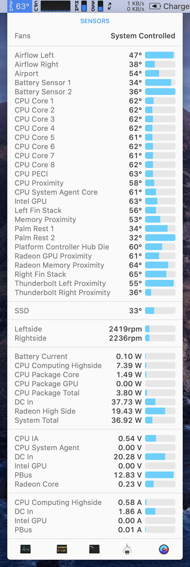

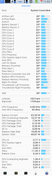

Do you mind sharing sensors readout screenshot from " istat menus " app?
As You can see from my screenshot, my monitor is connected to left Thunderbolt and it is 55 C on idle. Fans are running 2400rpm, which is audible on a silent room.
I did already - see here:
idle: https://forums.macrumors.com/threads/16-is-hot-noisy-with-an-external-monitor.2211747/post-28028111
lite web browsing, YouTube (1080p) on 4k scaled to 1080p:
https://forums.macrumors.com/threads/16-is-hot-noisy-with-an-external-monitor.2211747/post-28030938

Did you notice that there's no heat pipe on GDDR?
I did notice the memory is not heat pipped, but this does not surprise me. But the dGPU module is definitely heat piped as shown Step 7's 3rd image.
FWIW, the Dell XPS 15 I have does not have a heat pipe to it's GDDR

I seem to be getting similar numbers from my machine, but I literally had to check iStatMenus to see if my fans were on they are so quiet. I do hear the fans when they come on full blast, but this is a far cry from that. How does the noise level change if you use iStatMenus to manually adjust the fans to medium or high?
I couldn't change the speed of the fans with istat menus. I used 'mac fan control' app, At minimum, around 1800rpm, fans are very quiet. Around 2400rpm, I can hear them well and they disturb me. When connected to the monitor, it likes to keep the fans around 2400rpm. If I force them to stay around 1800rpm, laptop overheats and throttles itself until it is unusable.

You get 35 C on CPU when not connected to the monitor. I get 50 C.
Two factors in my opinions - ambient temperature (relatively fresh in my case ~18deg C) and initial indexing/syncing (Photos took nearly two weeks to finish - I have big >1,3T photos library). If you withdrew those then something is wrong with your machine.

You are running at a true retina resolution there, i.e. 2x exactly. It would be interesting to see if one of the scaled resolutions gives you the same result. Like 4K at “looks like 2560x1440“ (not the low resolution one) where it then renders at a much higher resolutionand scaled down.
I'll do the test and report back later
ok - see below.

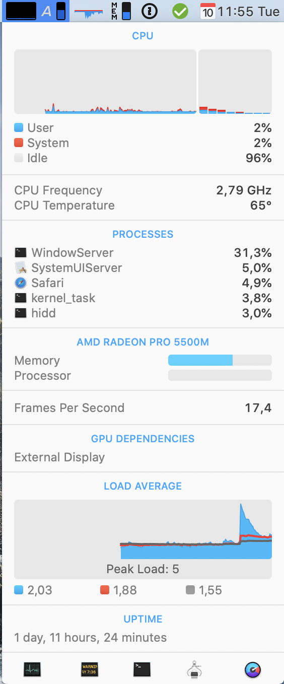

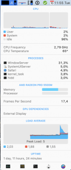

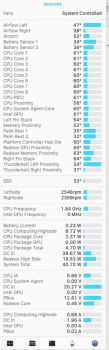

I'm running external 4K with scaled (2560x1440) resolution. Playing YouTube 1080p videos in safari.
Running on battery.
I will let it play - connect the charger as well to see if it impacts my readings - will post update after a while.
