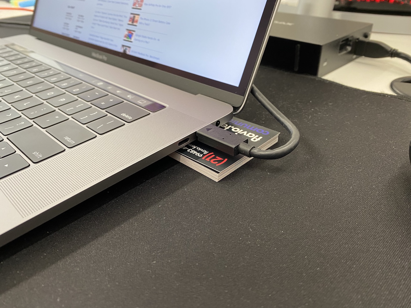

My MBP sits on a stand so air is not a problem. I just think that the closed lid gets really warm, and the part above the touchbar is hot. I’m not sure how much hotter it is when not in clamshell mode, but it can’t be that much.
that’s why I’m concerned about the screens health.

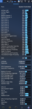

Going back to this thread title - it is neither noisy nor hot - at least for me.
Attached two istat temps on idle - one without and one with external monitor (Benq 4K)
i9 2.4, 5500 with 8GB, 32GB RAM, SSD 2T connected with Apple USB-C Digital AV Multiport dongle.
Environment relatively fresh - around 19st C

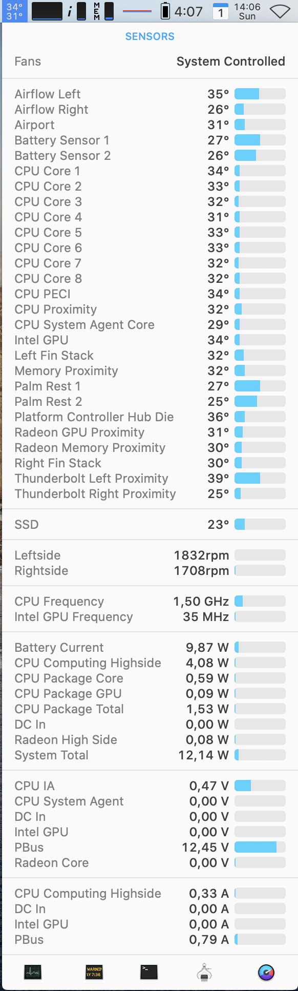

1. MBP without external monitor working on iGPU: ~35st C, fans minimum - not audible

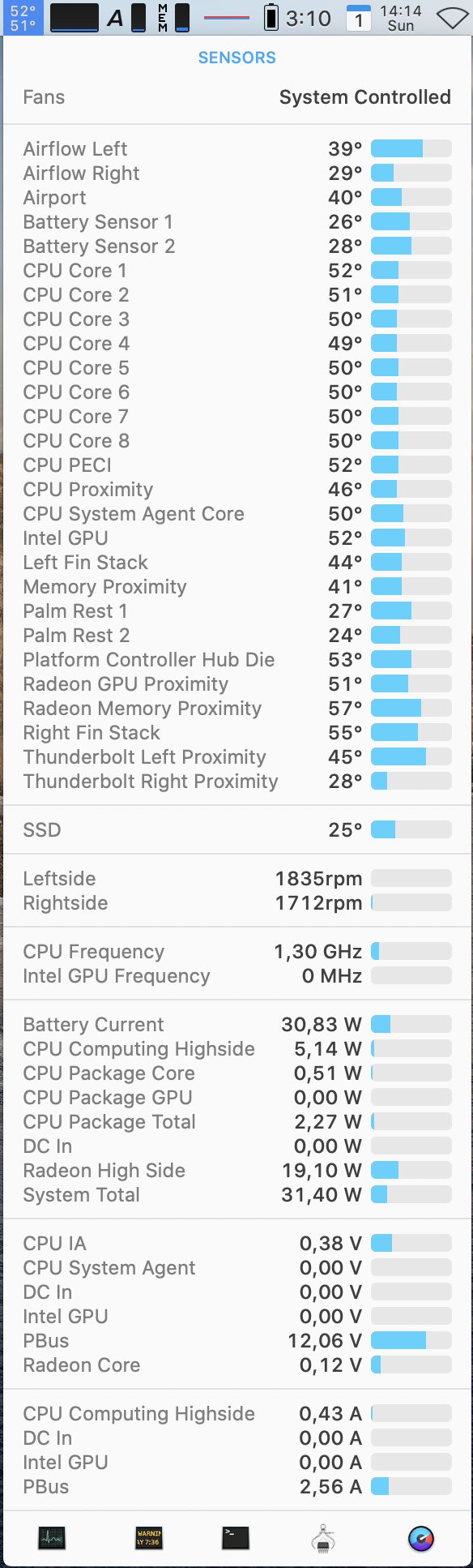

2. MBP with external monitor (4K, 60hz, standard scaling) working on 5500M GPU: ~50st C, fans minimum - not audible.
Yes - there is temperature difference but not noticeable.

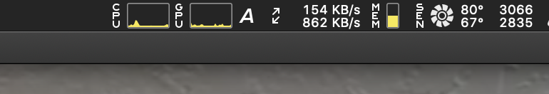

This is my 8 core 15" with a single youtube video running fullscreen at 1080p in Safari.
It's silent to me most of the time. But it's on the edge, and minor load will definitely trigger the fans.

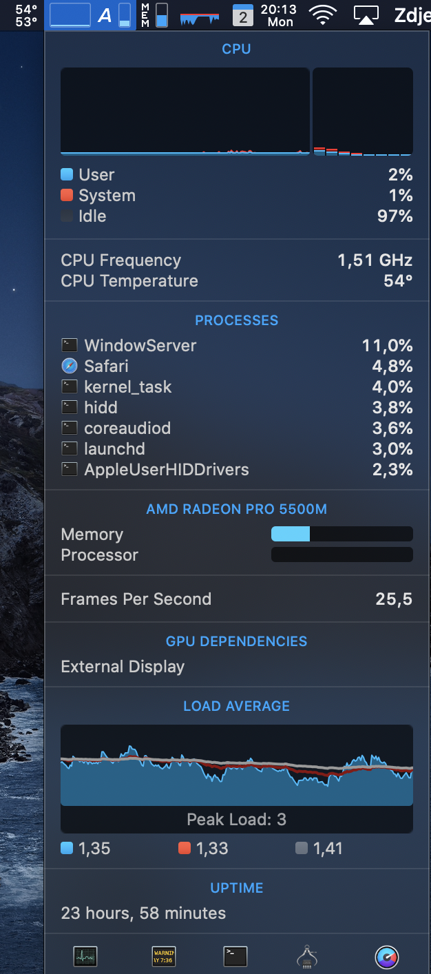

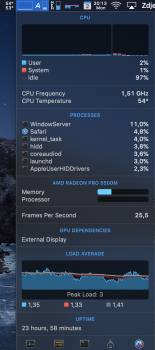

I've run 1080p in Safari for approx 5 mins on 4k (scaled by apple to 1080 as usual), running on battery (not sure if its a factor). Screenshot taken during playback of the last minute. Fans inaudible as before.
