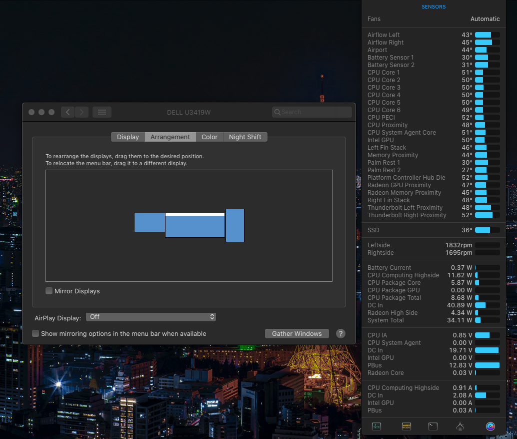

To echo @petterihiisila I got my Core X with Vega 56 Today.
Screenshot below is 16" lid open, + Ultrawide 2K + 1080P both connected to the eGPU. Ultrawide is set as main screen.
About 44-46 Idle.
Basically 3 screen setup running the way I wanted from the start.
I guess it will do for me.
Reactions: petterihiisila
About 44-46 Idle.
So once you plug in the eGPU, and once you set it as the main gpu, do all the programs go towards that for the main consumption? Like if i were to run a 4k video on youtube, would my macbook fans blast? or would it go straight to the eGPU. I'm sorry for the dumb question haha I'm just really desperate here lol
Watching 4K video full screen on chrome to make it fun (YT set at 4K though my max res is ultra 2K) and I am around 55-60 Celsius which with my settings leaves fans at circa 1800 - 2000 rpm. It's silent.
eGPU is under the desk and I can't hear it either and it's a Vega blower so they are not the most subtle cards.
I have a feeling somebody would say that they can hear the eGPU but seriously in comparison to what it was before this is like polar opposites and I am very happy.
