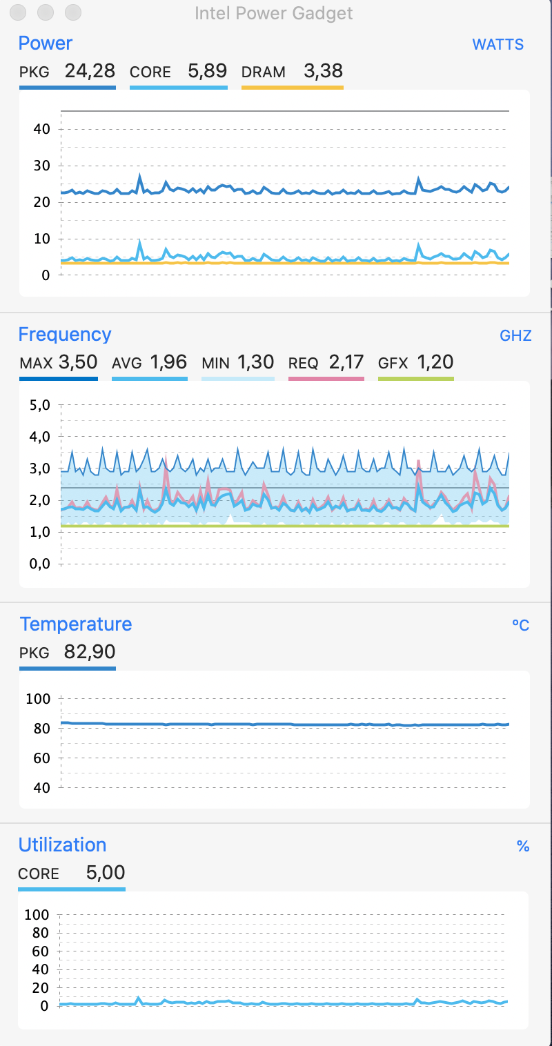

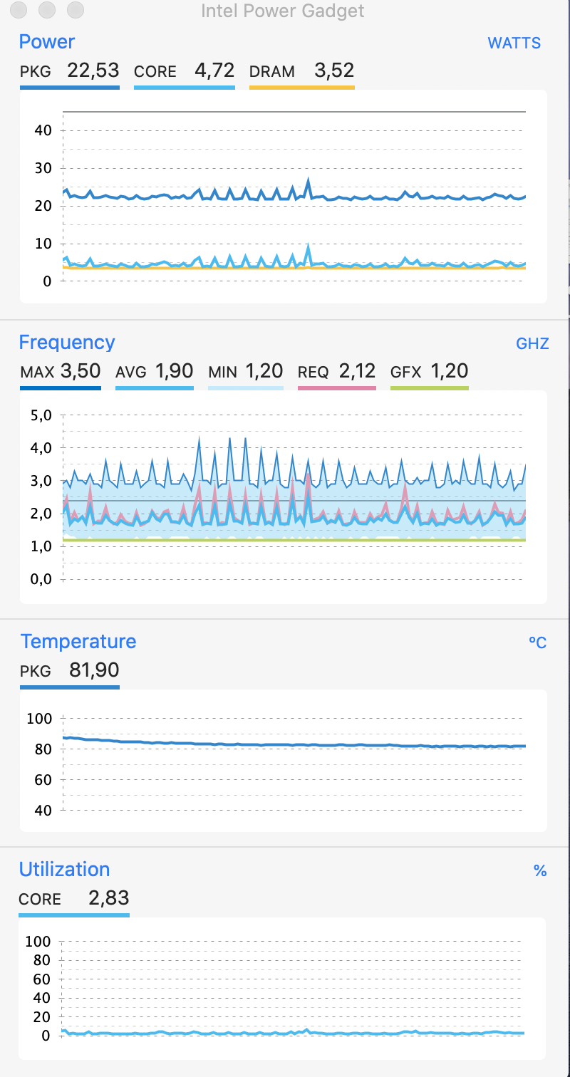

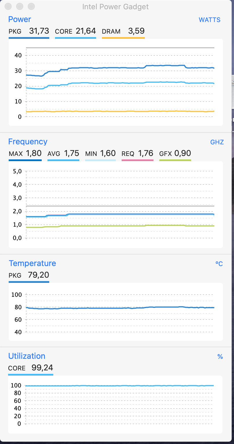

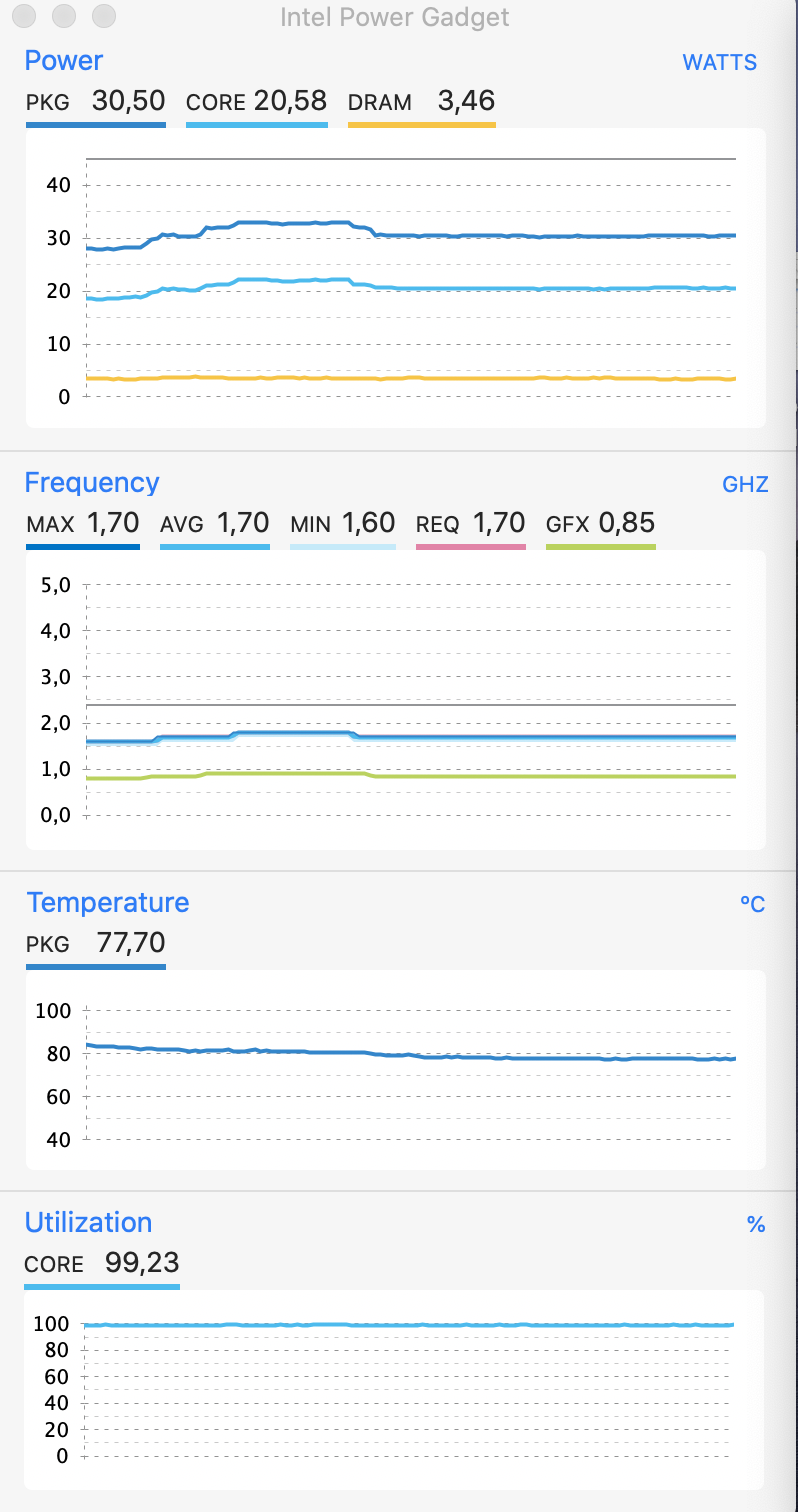

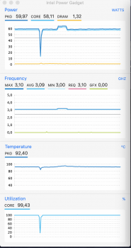

Can you please try running cinebench on loop via min test duration AND luxmark GPUs stress test (loops) at the same time for 10 minutes?
Do this with just the internal display and then with the external display and lid open which triggers 18W Radeon at idle.
While the tests are running, watch Intel power gadget to see if both frequency and power/PKG are able to sustain a stable level (and not what the levels are). If possible, a screen recording showing Intel power gadget for a minute, after running the stress tests for a few minutes would be great.
This should test and confirm (or disprove) that even though hot and noisy, performance is not lost (I don't believe this will be true).
Sorry - not a big fan of benchmarks, not using them normally so not sure if I run them correctly (first time I use Luxmark). I did not run the test 10mins. it was closer to 5 mins in every scenario.
Every time I started with Luxmark - selected stress test and verified that GPU power is jumping to approx 60W+, then I started Cinebench 20 and started intel power gadget.
In both scenarios both fans reached the maximum and stays like this till the end of the test for few mins.
Below you see the screenshots nearly at the end of each test (first screenshot:MBP16 internal monitor only, second screenshot: internal + external benq 4k)
Not an expert so unable to interpret the results, but non-scientific experience was very much similar in both cases.
