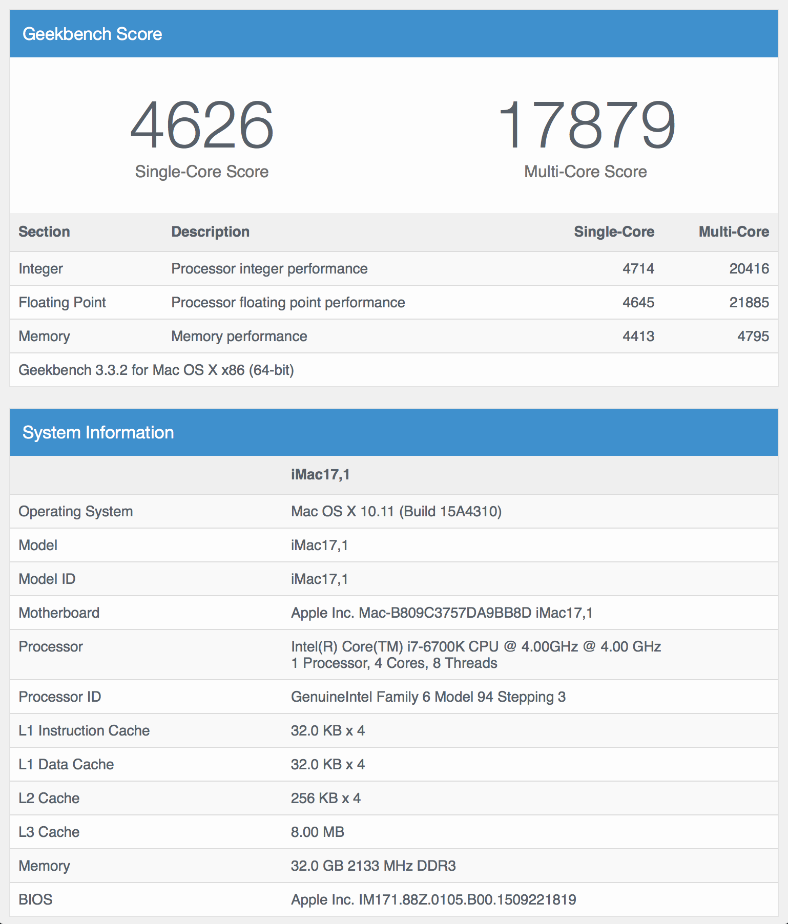

Ok, my iMac is setup. Here are the results...
4 x Kingston Technology HyperX Impact Black 8GB 2133MHz DDR3L 1.35V Laptop Memory (HX321LS11IB2/8)
http://www.amazon.com/gp/product/B00UVOVV12?psc=1&redirect=true&ref_=oh_aui_detailpage_o00_s00
Well, here are GeekBench 4.1.0 64-bit scores from my late 2015 5K iMac with Apple branded 32GB RAM running at the stock 1867MHz speed:
https://browser.geekbench.com/v4/cpu/2654309
I tested with no other apps (except menubar apps) running, and no other users open.
And here is the GeekBench 3 64-bit scores on the same 5K iMac, taken when I first got the machine:
https://browser.geekbench.com/geekbench3/4237728

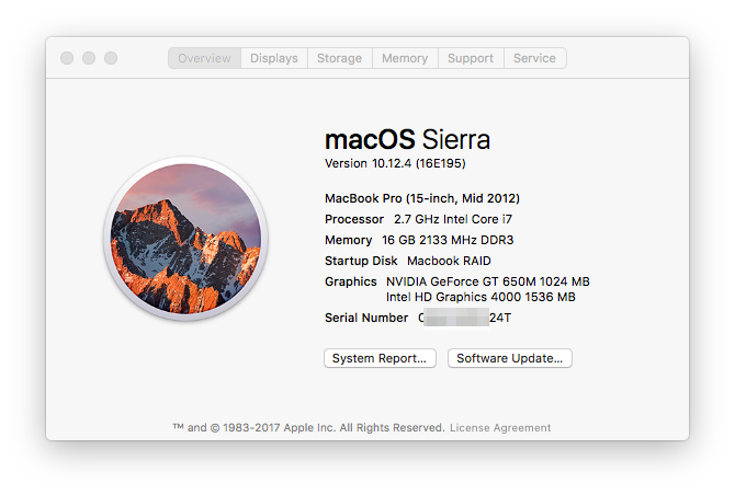

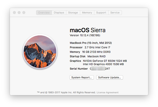

Hi, sorry if this a bit out of topic but I just wanted to share and confirmed that my 2012 Macbook Pro 15.4" can support 2133Mhz RAM (Kingston HyperX Impact). Cheers!
Thanks for your post.
Unfortunately, I cannot confirm that on my MBP 15 mid-2012 (2 of them)
Of course, you can install them and make a screenshot, but, the system doesn't work reliably anymore.
I've tried this on both i7 2,6Ghz and 2,7Ghz! And the display starts to flitter!
SO, NOT A GOOD IDEA!
