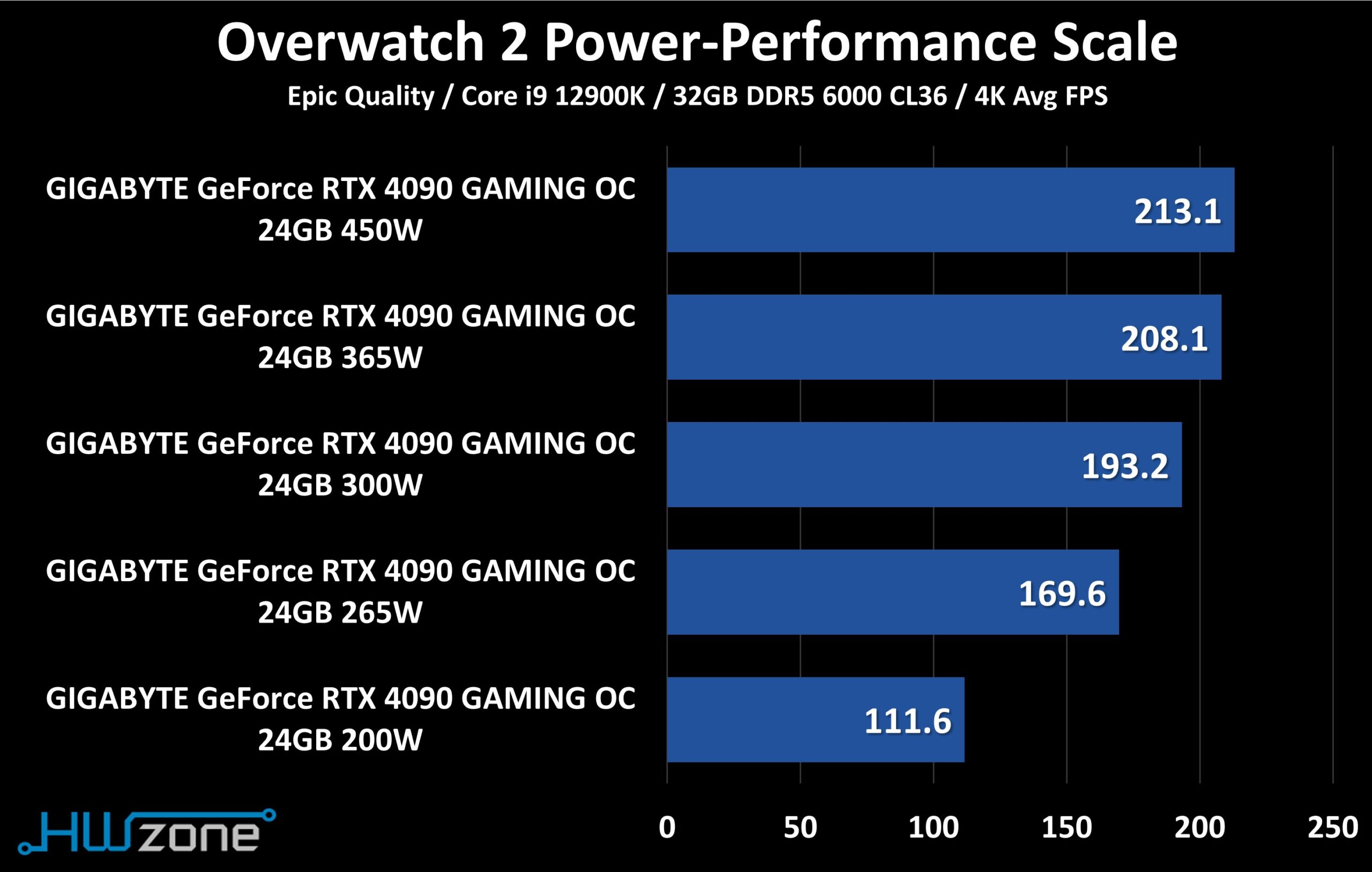

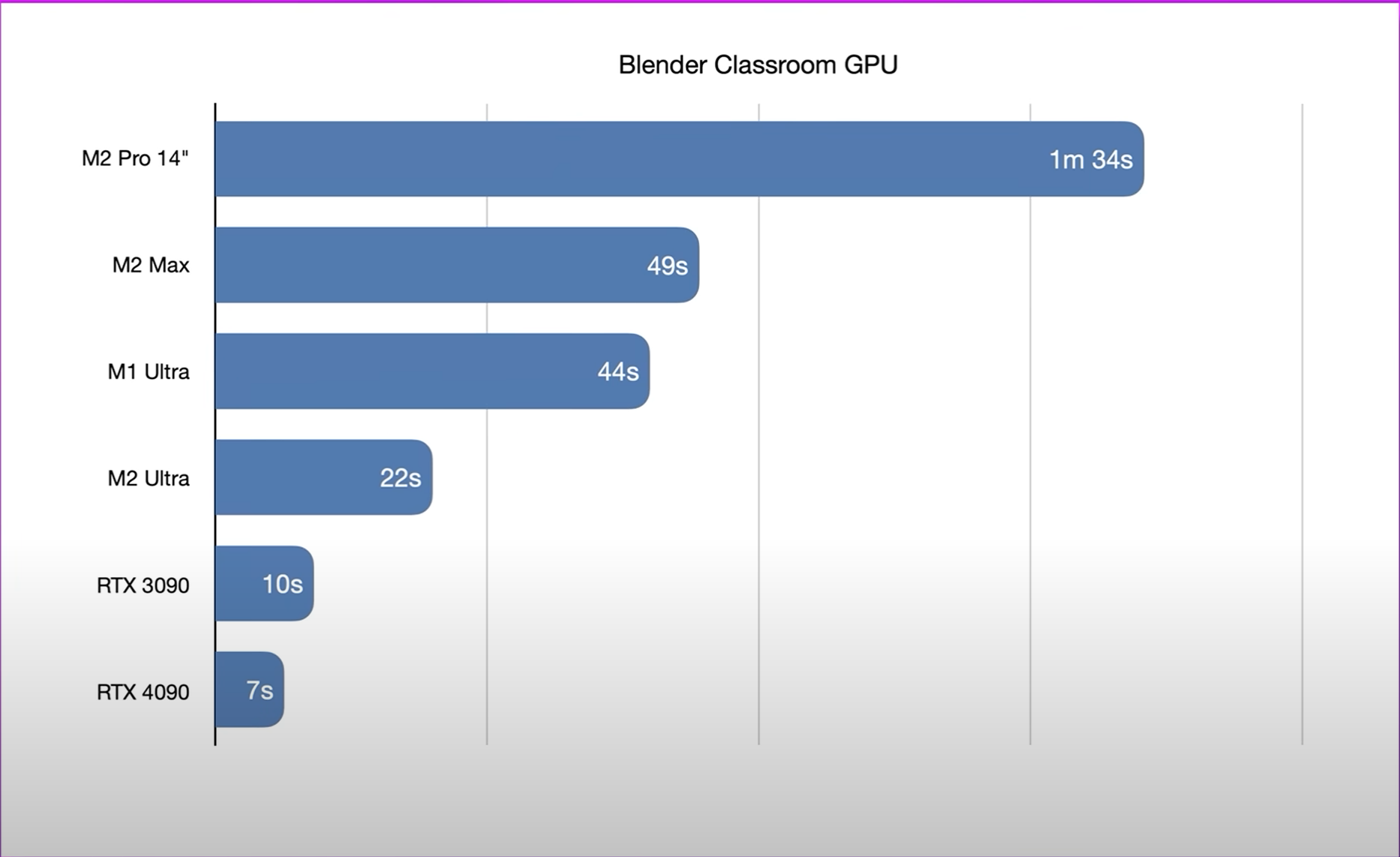

The sweet spot for 4090 performance per watt is around 70% power limit for gaming so about -9.3% performance loss with -33.3% reduction in power from 450W to 300W. Same test needs to be performed for rendering but guestimation is if 4090 at 100% power takes 7 seconds to render Classroom scene then at 300W it's about 7.7 seconds so almost 3x faster than M2 Ultra that takes 22 seconds with a 295W max power consumption.

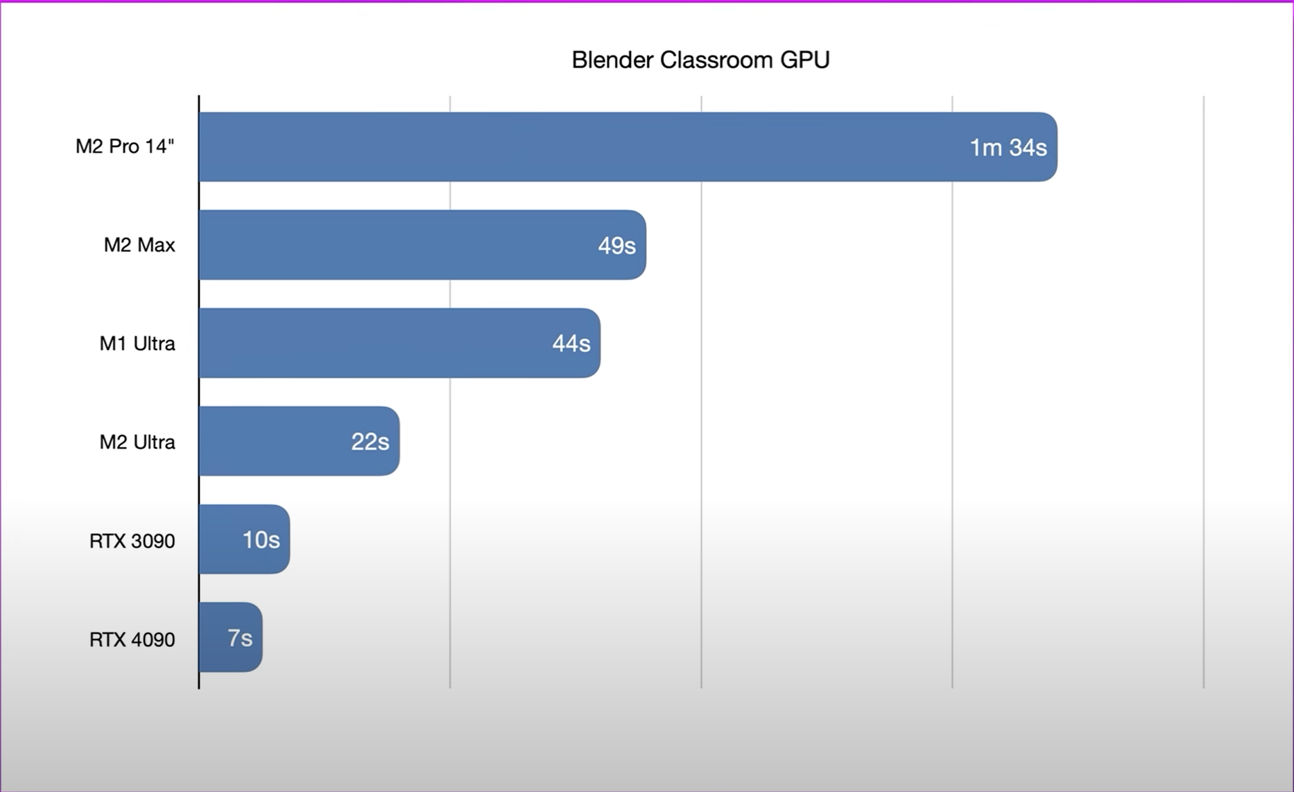

Thanks for the information, looks likeif you want to work on 3D 4090 has got the most value. Not a surprise for most of us.

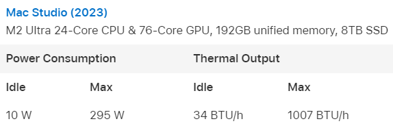

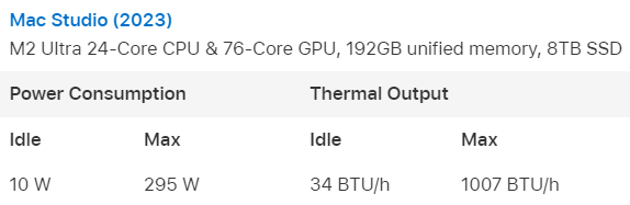

You are confusing full system power with GPU power. At its peak, M2 Ultra GPU probably will consume less than 120 watts. In Blender, I suspect that the actual power consumption will be closer to 80 watts. Needs to be measured for a definitive statement. Same goes for Nvidia btw. I doubt that it will draw full 300W when rendering a Blender scene.

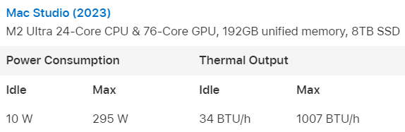

I think the CPU Max of the whole Mac Studio system vs just the dGPU part is a great way to compare Apple vs Nvidia products.
It really highlights how inefficient how Nvidia does things to achieve their raw performance.
It just needs to be emphasized that you're comparing a whole computer vs just a component.

The fun part of that graph is that Apple is doubling their performance per generation for the same class of computer, while nVidia is only getting 30% despite the fact that the 4090 is a much bigger and far more expensive card than the 3090 was.
And Apple Silicon still hasn't played its RT core card yet which is going to provide an even more massive generational boost.
I can't wait to see what happens in the next couple of generations.
Lets say whole PC with a 4090 consumes 500W and an M2 Ultra 150W. With this equation what is the output ?
Can we say at least in sake of power consumption/time consumption an M2 Ultra same with a 4090 PC or what ? I can not understand why we push to compare these two different animals.
just for the to make it clear I just want to understand these subject.
Why is that so important for owners who has got any of them or both of them ?
What is the final output ? I am really curious about it.

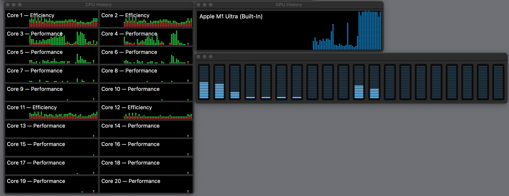

Tally Ho Tech measured in M1 Ultra up to 120 W with GPU and up to 130 W with CPU+GPU.

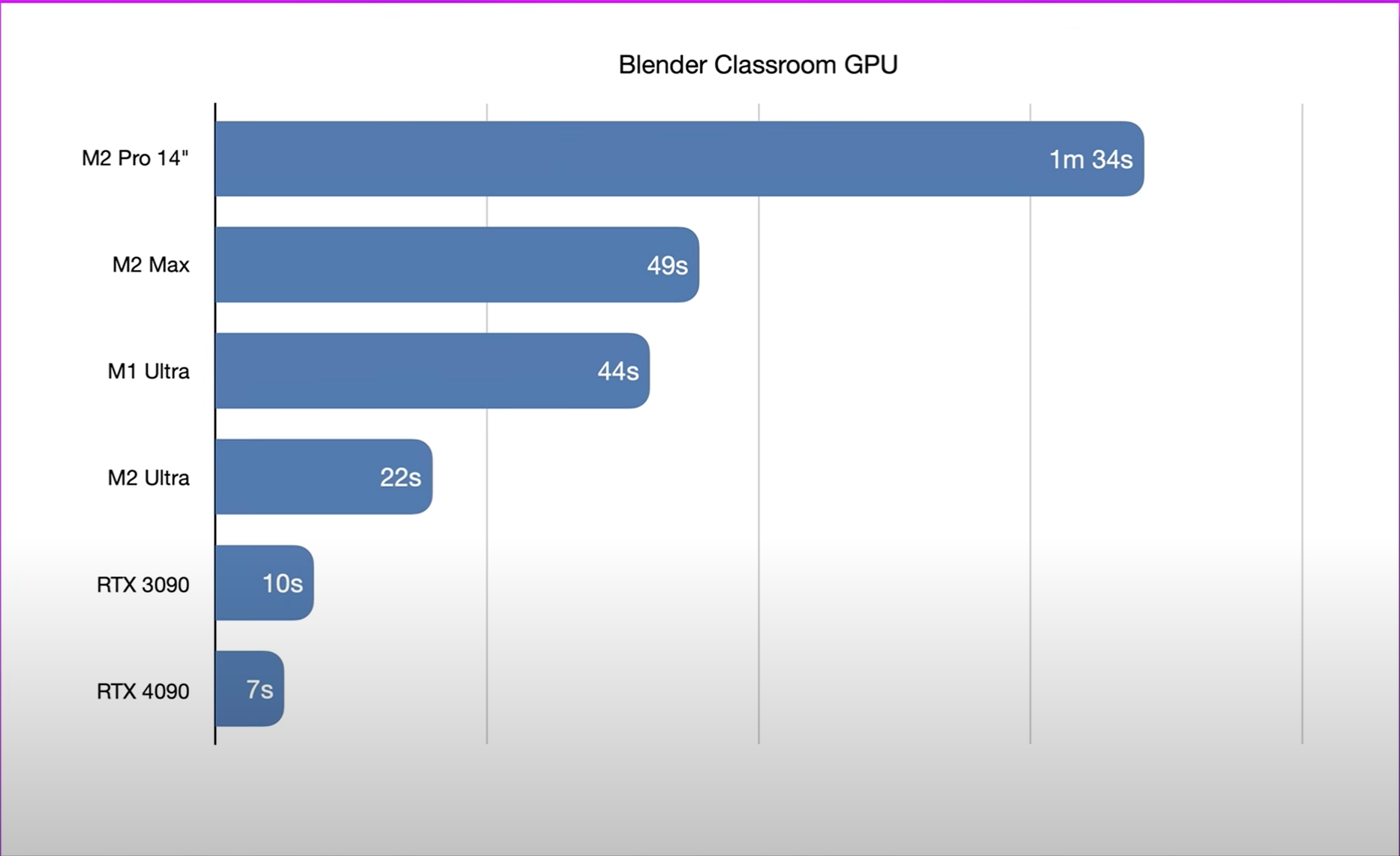

I'm not sure that those Blender benchmarks reflect the true capability of the high-end GPUs. More complex scenes show that the nVidia 4090 got over 30% improvement.
M1 Ultra has scaling issues that prevented it from using full power so it shouldn't be compared with M2 Ultra that seems to have fixed the scaling so at similar 5nm node it should utilize higher percentage of max power. Too bad one can't just upgrade the M1 Ultra GPU but have to throw out the whole box. Or, on a deadline and need to scale to more than one GPU.
I agreed with you, M2 Ultra owners are happy now :).
