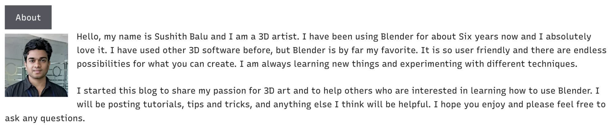

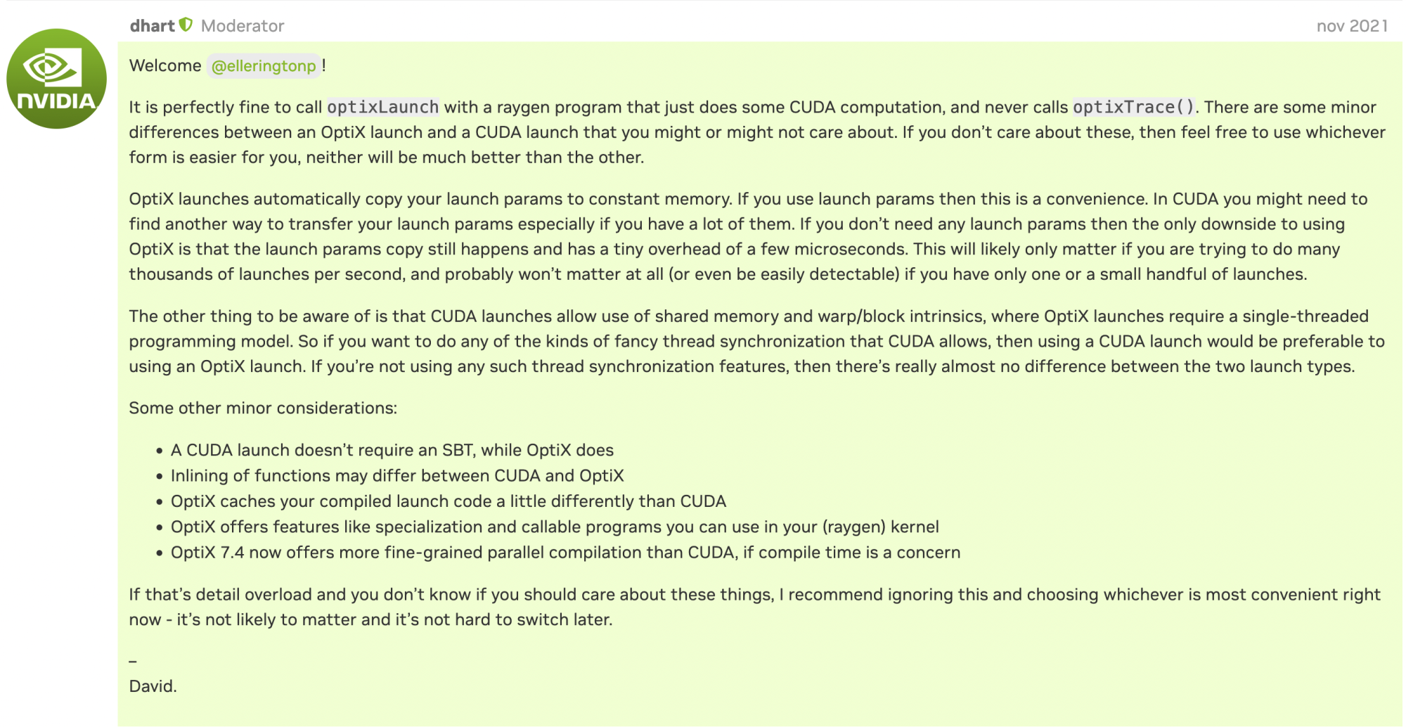

Are you sure that was actually written by a human? It's very repetitive and meanders all over the place, reeks of LLM generated slop.
It gives no evidence that CUDA is better for simple scenes, it just asserts that it is. I personally doubt that claim a lot. CUDA is a GPGPU API targeted at utilizing compute shaders. As far as I know it doesn't take advantage of raytracing cores at all, so if you're using Blender on a NVidia GPU which has RT, you should probably always use OptiX.
The blog is written by ”Sushith Balu” based in Kerala India.
Here is his LinkedIn. Here is their Facebook. They’re on Quora too.
However the blog post appears to be based on an article by the company iRender based in Singapore and Vietnam. At the same time the blog is older than the company article.
They both say ”However, this may depend on the specific hardware configuration and the rendering engine being used”.
Again I didn’t say CUDA uses RT and you’re welcome to add your own links and sources if you find some information about the subject. The discussion was about whether CUDA or OptiX was used in the user test above. My comment was just a side note about the possible speed difference. OptiX is the way to go for fastest rendering with RT cores but in some other cases it’s still better to use CUDA.

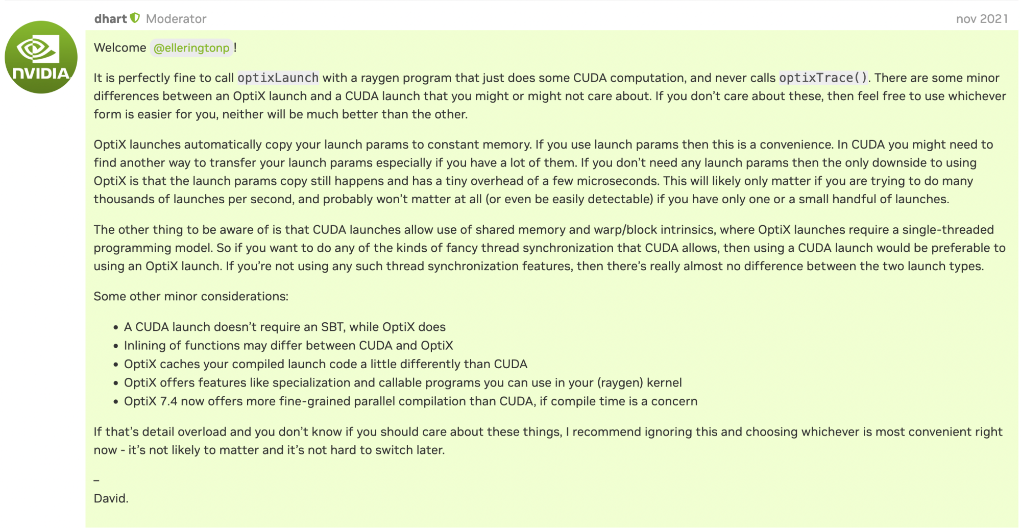

Nvidia gives some explanation but it’s not about Blender but application programming: "CUDA launches allow use of shared memory and warp/block intrinsics, where OptiX launches require a single-threaded programming model. So if you want to do any of the kinds of fancy thread synchronization that CUDA allows, then using a CUDA launch would be preferable to using an OptiX launch."
I hadn't looked that up, but what made me think LLM is that I clicked through to another of his other blog posts that was about how to do a specific task in Blender, and it wasn't the same writing style at all. It was short and focused and clear. Seemed like the writing of an actual human who knew what they were talking about. By contrast, the post you linked doesn't.
I don't expect a 3D artist to know much about programming GPUs, or vice versa - very different skill sets! So what I'm suspicious of here is that maybe when he decided to blog about a topic he didn't feel confident about, he asked a chatbot to write that post for him.
Again I didn’t say Cuda uses RT and you’re welcome to add your own links and sources if you find some information about the subject.
I'm not saying you said that, and for clarity I'm not really engaging with the discussion you were having earlier. I'm only saying that a specific claim - that sometimes CUDA is faster at raytracing than OptiX - seems highly questionable. Take that for what you will.
Nvidia gives some explanation: "CUDA launches allow use of shared memory and warp/block intrinsics, where OptiX launches require a single-threaded programming model. So if you want to do any of the kinds of fancy thread synchronization that CUDA allows, then using a CUDA launch would be preferable to using an OptiX launch."
I think you're reading too much into that response. David is telling the person asking the question that when they use OptiX to do things which aren't raytracing (key phrase: "never calls optixTrace()"), they need to keep OptiX's limitations in mind, and consider switching to CUDA for those tasks.
I'm no expert in this but from what I can tell, OptiX isn't purely for raytracing. It has some CUDA-style GPGPU on the side, presumably so that you can integrate other types of computations into your raytracer. Its level of GPGPU support isn't a full replacement for CUDA because of those limitations with respect to thread synchronization, higher startup overhead, and so forth, but in circumstances where those things don't matter it should be fine to use OptiX for GPGPU work anyways.
But the other direction doesn't make sense. I don't think CUDA can use the RT cores at all (something we all seem to be in violent agreement on), so it'll be stuck doing ray casts using software running on GPGPU compute resources.
That absolutely is something which is possible to do; after all NVidia itself demoed GPGPU raytracing using CUDA years before they shipped their first RT GPU. But the whole point of the RT cores is that they're much faster and more power efficient at that specific task than GPGPU compute ever can be, so if you're writing a raytracer and you want to maximize performance, you're going to need to use OptiX.

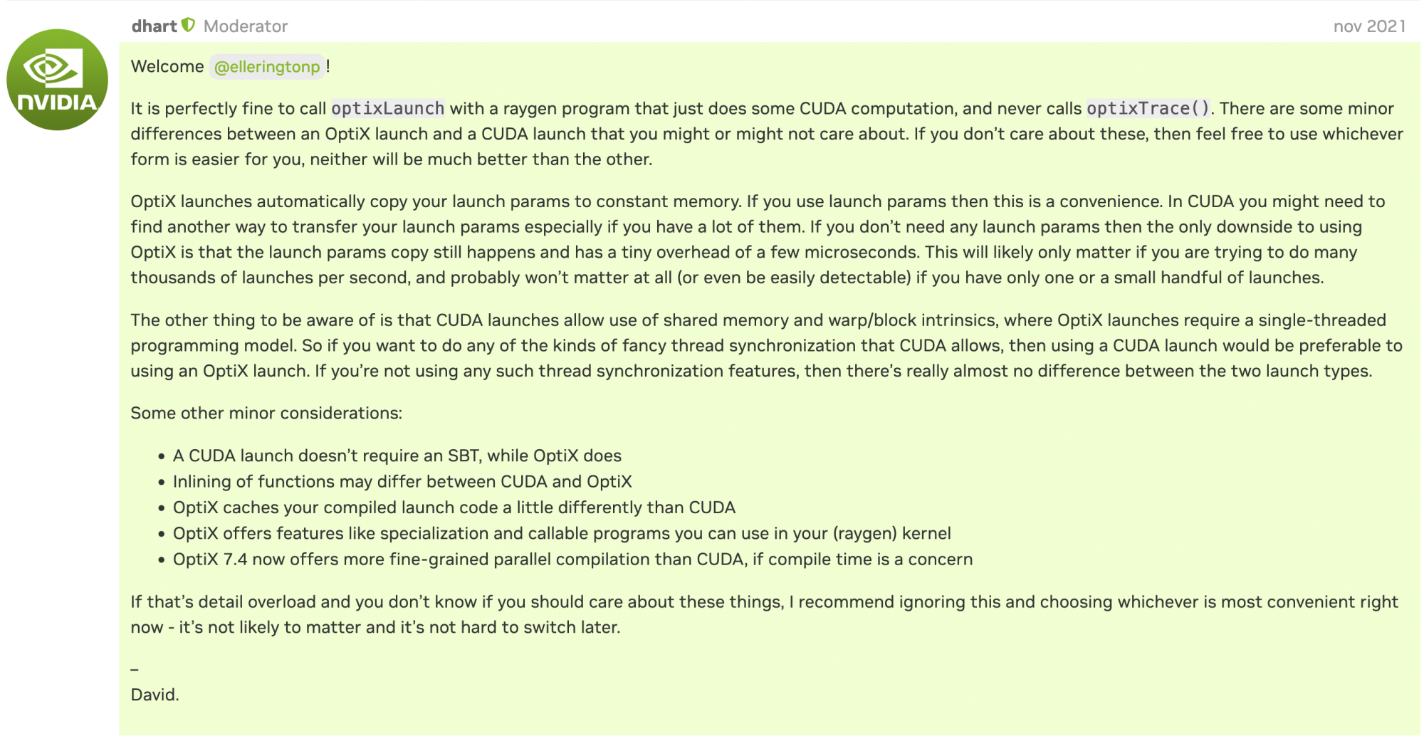

I'm no expert either and pointed out that they weren't talking about Blender but single-threaded programming and multi-threaded synchronization which can affect performance if done wrong as I understand. It was just an example. To be fair he didn't say CUDA is sometimes faster than OptiX at ray tracing but at "rendering simpler scenes or materials". He does say "OptiX is faster for complex scenes with reflections and refractions" which are used in ray tracing. We both agree that CUDA can't use RT.
Yes, RT cores are really fast as we've seen with MetalRT in the new M3 Macs too.

I snipped a bunch. Has Nvidia allowed Cuda to run on the RT cores now? I thought that was the whole point to Optix.
CUDA (CUBLAs) can run on RT* (tensor) cores for matmul for a long time at least after 3000 series but i'm pretty sure it was implemented somewhere closer to 2000 series release.
