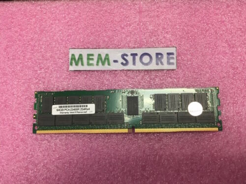

Would either of these work? (not my auctions!)
64GB DIMMs for $175

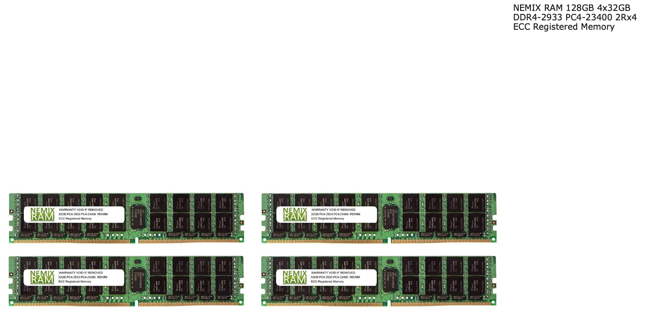

I notice that many of the reviewers have been going with NEMIX Ram, sets for Mac Pro 7,1 supported lifetime warranty, returns etc. I went with 192GB of that.

I bought these from Amazon....
2 of: NEMIX RAM 128GB 4x32GB DDR4-2933 PC4-23400 2Rx4 ECC Registered Memory - Price $476.99 for each set.
Note: This 4x 32GB set is no longer available at this price. It has since been increased to $556.99 per set of 4. 😳 🙁

Ordered both of these, 12x 32GB and 4 x 64GB - they work just fine; though it's a total "no-name" modules, but they successfully passed 96Hrs of torture tests with MemTest Pro; there is a drastic performance difference between 4 and 6 channel memory config in multi-core benchmarks. 64GB also worked just fine in my 18-core iMac Pro - they were intended for it.
64GB DIMMs for $175
