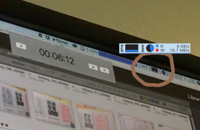

Which APP ?(Base on the monitoring APP, the RAM is not fully filled even on 4x32g)
iStat Menu and Activity monitor, but I will try the ramdisk to limit ram and see the resultWhich APP ?
Note that many memory monitoring apps do not count file system caches as "memory in use", since it will be released if processes request more memory. You might have a much larger file cache with the extra memory.
It would be helpful to know exactly what it is you're doing when you take the pictures. If you are performing a conversion of 309 RAW files to 8-bit TIFF files then your SSD I/O seems extremely low. A read speed of 6KB/sec and a write speed of 16.7MB/sec doesn't seem to match the type of work being done. I would expect much higher numbers than this. The files being cached in memory could explain the low numbers.I did video record the process, just not clear enough to post out, but I can upload if needed
I can see the icon on the menubar RAM usage is not filled up ram at all, the screenshot in end is doing the same task, which is the same thing.
when I'm taking this screenshot is in the middle of exporting TIFF, but one RAW file is just 30-40mb, even realtime reading from SSD and writing to SSD will not have very high read and write speed.It would be helpful to know exactly what it is you're doing when you take the pictures. If you are performing a conversion of 309 RAW files to 8-bit TIFF files then your SSD I/O seems extremely low. A read speed of 6KB/sec and a write speed of 16.7MB/sec doesn't seem to match the type of work being done. I would expect much higher numbers than this. The files being cached in memory could explain the low numbers.

I would think that batch processing 309 files of approximately 30-40MB each at 28 files at a time (the number of cores) would consume more than 6KB/sec from the SSD. At 6KB/sec one 30MB file would take slightly more than 1 hour and 40 minutes to read. Is the system really taking this long to read one file? Obviously not so the measurement is in question.when I'm taking this screenshot is in the middle of exporting TIFF, but one RAW file is just 30-40mb, even realtime reading from SSD and writing to SSD will not have very high read and write speed.
the number Read and Write is keep changing during exporting
sometimes R14 W 20
sometimes R20, W150
sometimes R 200, W120
sometimes R 0, W0
