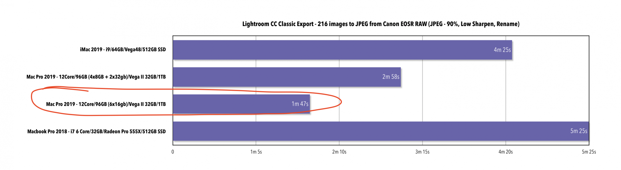

Yes, but you need to buy new DIMMS for those test, I'm not a professional system tester. I just see the differences and sharing here, the closet way I can do is to limited the avaliable free RAM space in a software way, and it is clear enough in the activity monitor how many ram is used and free space and no swap memory, and LR has a lot more than enough RAM Space it need to play with, in all those configurations, so and I dont see any "unfair" that I use 92gb of 6 channels vs a 192gb of 6 channels have almost the same results. maybe still some other factors that need to be consider, but this I think is a close enough way to testing without buying new DIMMs.

Actually, you started out doing the right thing - testing an application that seems to be important to you.
Benchmarks like GeekBench and STREAM are written to bypass the caches and drill down to the raw streaming memory bandwidth.
Applications, however, utilize cache - therefore your attempts to measure LightRoom are good. Unfortunately, you had an experiment in two variables - number of channels and total amount of RAM.

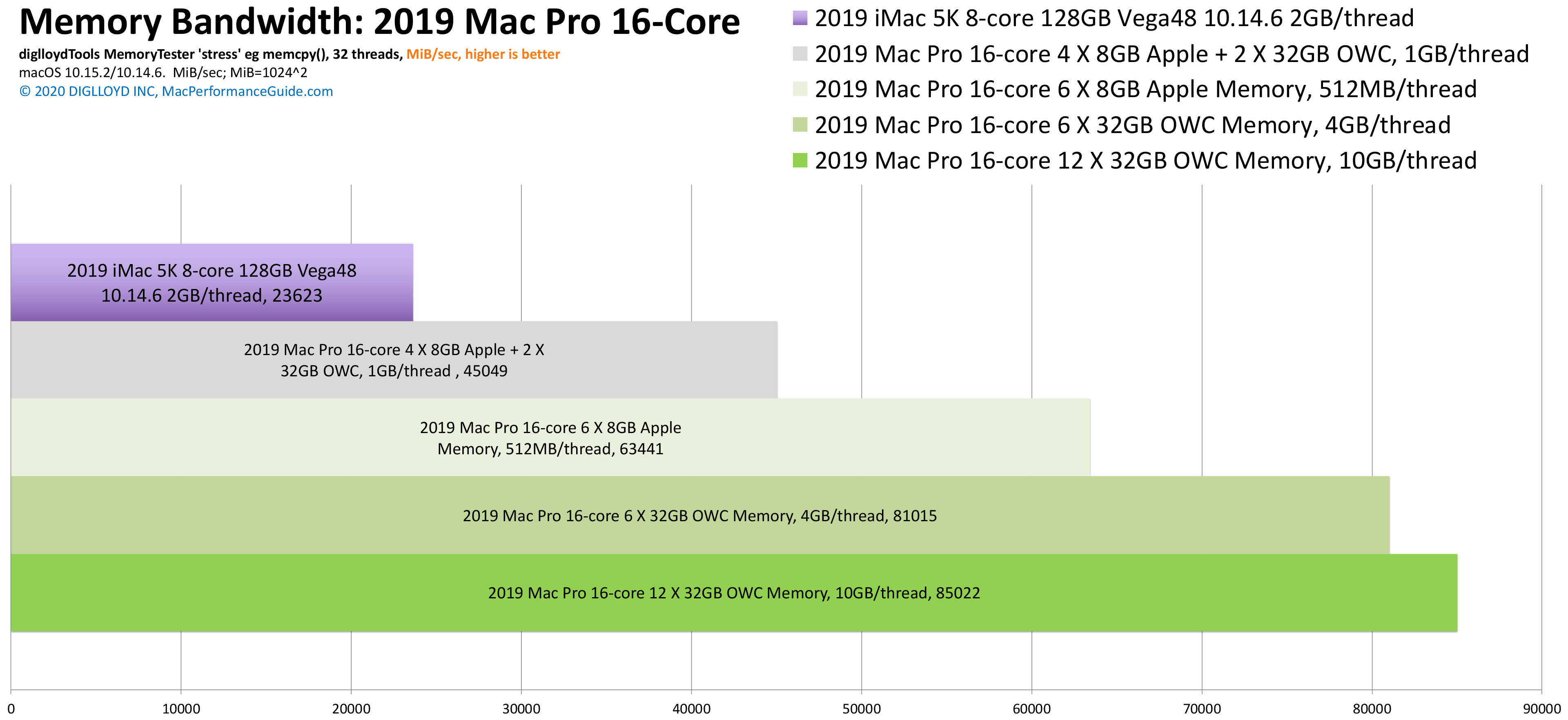

Just Saw this thread there, there a memory bandwidth documents shows different DIMMs setup differences
From page 18
(actually that whole section explained it all... balanced and near balanced etc)
6channels 95% performance
4channels 66% performance ( bit more in reality )
That is 43.9% increase, which is similar to the test results
A couple of possibilities:
  • By sheer coincidence, the mismatched memory sizes on your test helped by an amount similar to the raw (uncached) bandwidth differences.
  • Your LightRoom test happened to be one of the rare programs that with your script was bandwidth constrained, and didn't utilize the cache.
One can't make any conclusions based on a single program - unless that program and the script that you ran does indeed reflect your critical workflow.
Even GeekBench can be useful if you ignore the two main numbers, and look at the component tests. If most of the component tests show a small difference, and a couple show a big difference - that should be a clue that the results are highly application dependent.
With the same problem of having two variables in the experiment....
May I ask what are the 2 variables. except the different RAM setup? Its identical in my opinion. Both have 12 Core/96GB/Vega II and exactly the same drive setup etc.

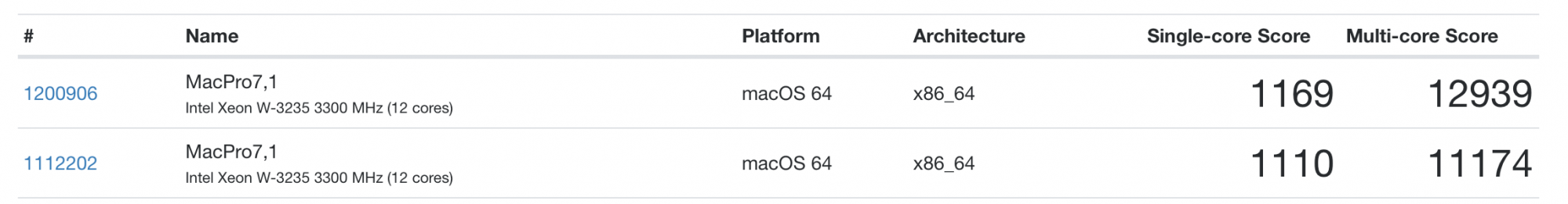

And just to make sure it isn't just Lightroom, Geekbench also sees a performance boost.
It's not ideal but I think this test is closer to it than the previous test. It eliminates a key issue I had with the previous test (disparate memory sizes). Outside some laboratory testing I think this is the best we're likely to get and I'm willing to acknowledge the move from four to six channel appears to have significant gains in this specific real world use case. I guess my next question is why is there such a variance between the two? Especially with a 12-core processor.
