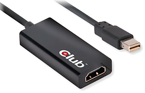

The mini display adaptor from Club3 has positive feedback and it should work theoretically.
I'm going to purchase another hdmi cable 2.0, hopefully this will solve my problem.
