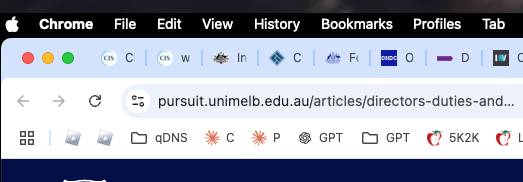

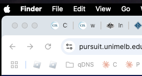

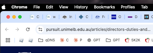

On a 40", 5120 x 2160 monitor the UI (text size for) at HiDPI, 3840 x 1620 - Apple OS Menu Bar, Chrome Bookmark Bar etc, is in the goldilocks zone.
Not too zoomed in, and not too tiny.
5120 x 2160 native UI feels like trying to read 6 point type from 3 feet.
HiDPI, 3840 x 1620's UI menu scaling (down from 512o x 2160) basically feels like a 27" ASD, but sized up to a 40".

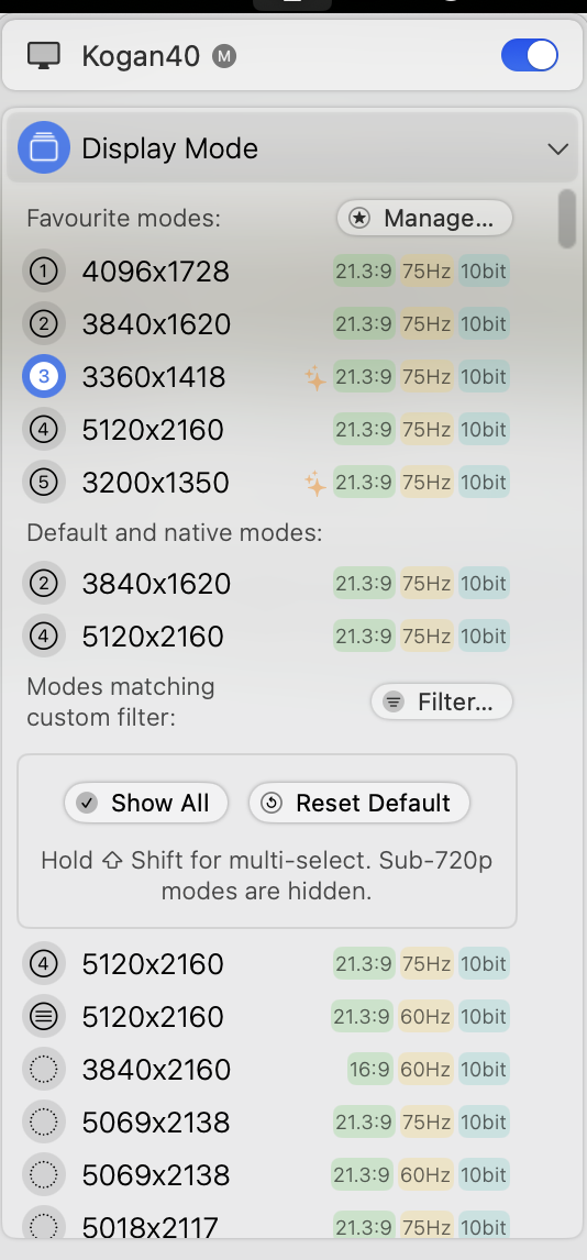

Dumb question on resolutions.
For 4k/UHD (3840x2160) monitors:
  • 27" (163 PPI): scaled resolution sweet spot is at 2560x1440
  • 32" (138 PPI): scaled resolution sweet spot is at 3008x1692
Translating that to 5k2k/WUHD (5120x2160) monitors (~1.34x horizontal resolution of 4K):
  • 34" (163 PPI): scaled resolution sweet spot should be 3440x1440
  • 40" (138 PPI): scaled resolution sweet spot should be 4042x1692
However, throughout this discussion I've seen 3840x1620 touted as the ideal resolution for the 40" ultrawides. Why is that?
Because the maximum horizontal pixels you can get on Pro/Max/Ultra chips are 3840px. It's the framebuffer limit since M1 and Apple hasn't raised it.

Sweet spot is subjective and depends on the res, size and viewing distance.
I find 2560x1440 appropriate for my 28" 4K screen, but at the same viewing distance prefer 2880x1620 for the equivalent of a 32" 4K monitor, or in my case 3840x1620 for an ultrawide version of that.
The problem is that MacOS maxes out at 3840x1620 (7680x3240 render res), so 4042x1692 is not even an option. It's all about Apple's dumb **** scaling system.
Considering BetterDisplay can create virtual screens with pretty much any HiDPI res up to 16Kx16K afaik, MacOS doesn't have issues with actually handling them, so the issue seems to be entirely a hardware limitation, or one imposed by Apple where any render res above 7680x4320 is not possible.
