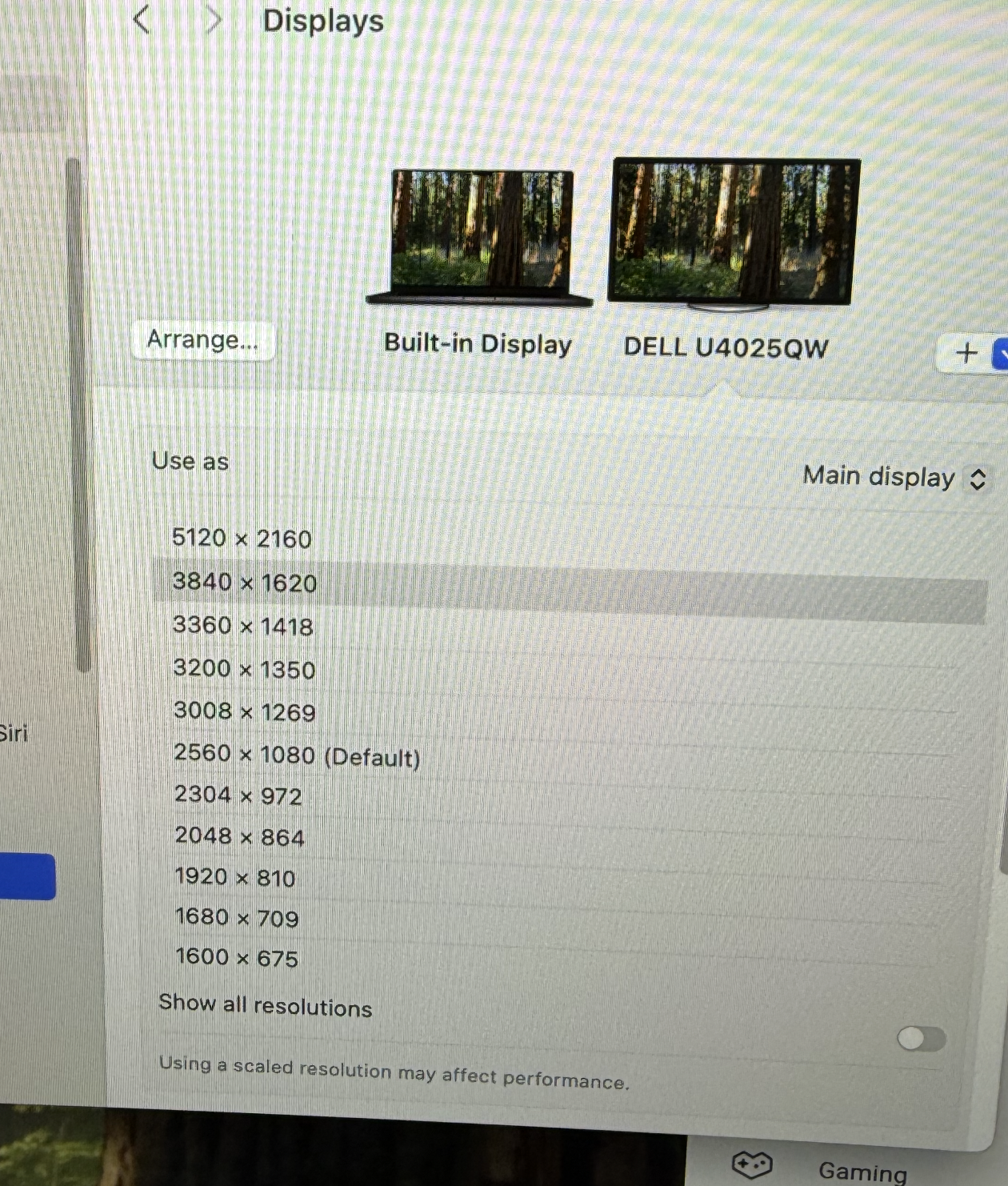

FWIW, I just replaced my LG-40WP95C (was not able to do 3840x1620 in HiDPI) with the Dell U4025QW and to my pleasant surprise the option for 3840x1620 was available. I'm using an M4 Max MacBook 16 inch.

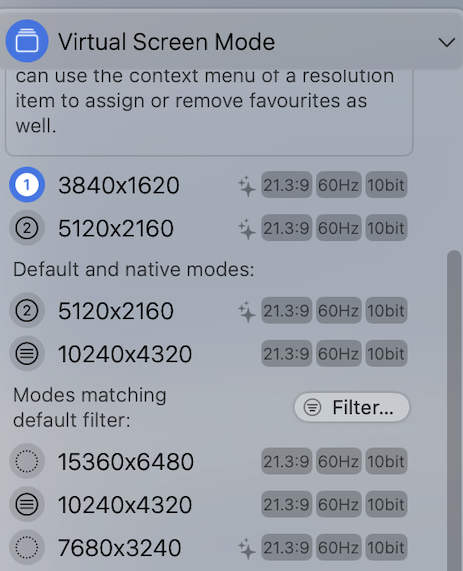

For anyone considering/holding off on an M4 Mac Mini because of the issues with the LG 40WP95C or other non-120Hz monitors, I'm happy to report that with the Mirroring functionality in BetterDisplay everything ended up working just fine at 3840x1620 and looks really crisp (on the base M4 Mini). The performance impact is basically non existent and it "just works". Do be sure to use the "virtual screen mirroring" and not the "full screen streaming" which I had enabled at first (and which is flaky).
I do hope that Apple will fix the native support for HiDPI at this resolution of course.
