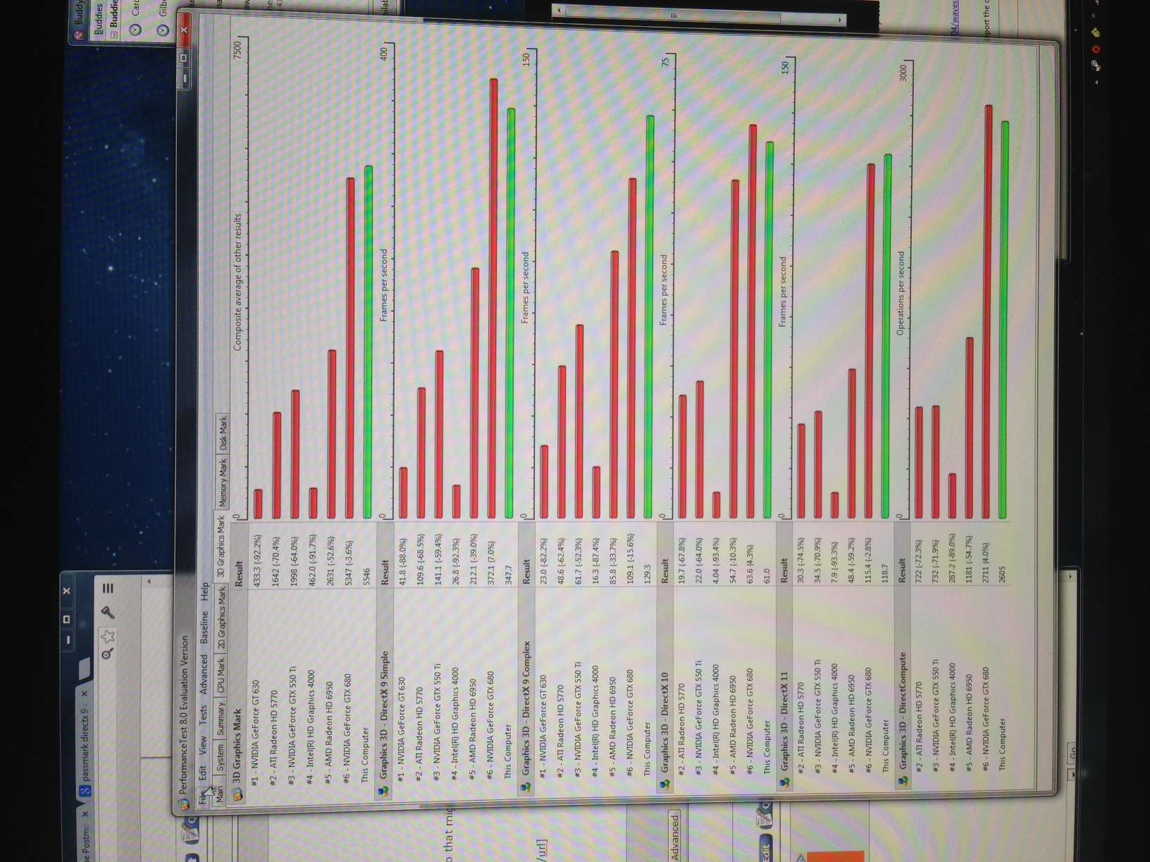

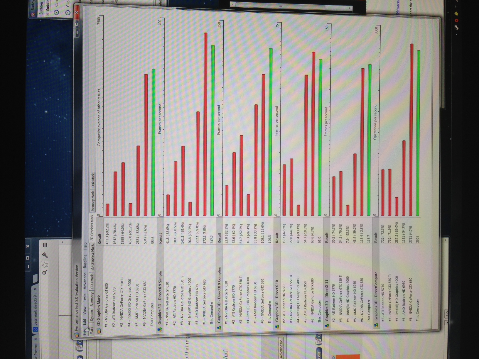

Since this is the benchmark thread, check out these results for a 285/425 overclock in PassMark.
i7 3.4Ghz, 32GB RAM. 314.22 drivers.
Faster than a desktop 680GTX overall. :D

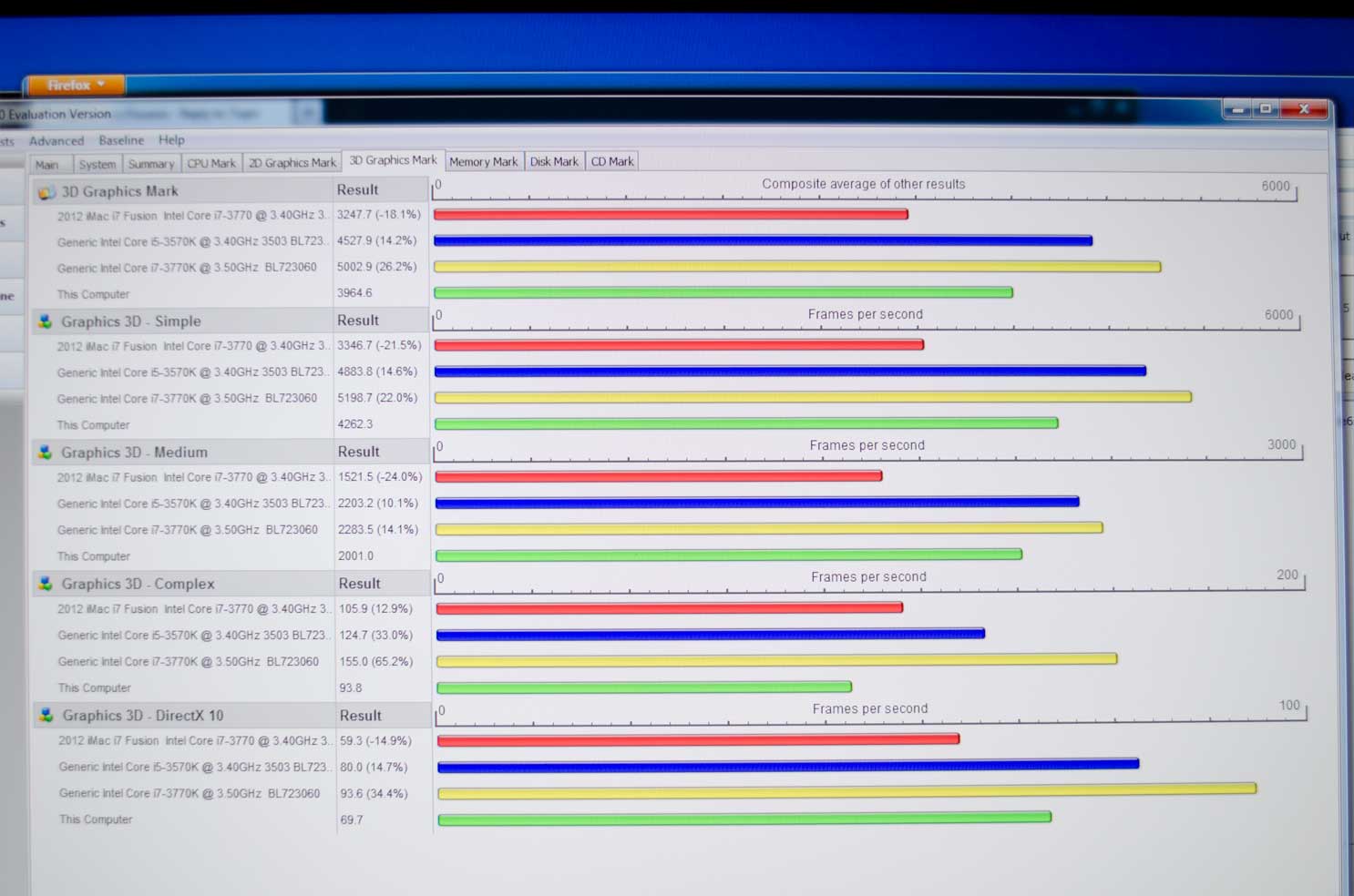

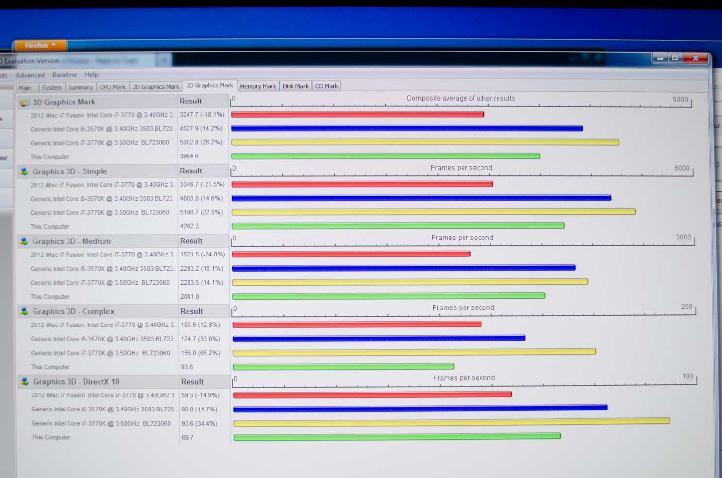

I only have the trial version of PassMark, but here are my results for the GPU. I used the iMac late 2012 i7 680mx benchmark downloaded from PassMark. As a comparison I downloaded from PassMark two benchmarks for computers with the same CPU (i5 and an i7) and a geforce GTX 680 (listed as a generic intel core...) The "This computer" is my iMac overclocked at 285/425. So in this comparison at least, the overclocked 680mx is not coming close to the desktop 680 GTX.
At that overclock 680MX is performance-wise between GTX670 and GTX680 at stock speed, but overclocked dekstop cards will obviously win out...
Btw., the summer heat finally arrived here, and I noticed the iMac got a few degrees hotter during gaming. So I compared 285/425 vs 250/375 performance-wise. I've only tested Crysis 2 and Far Cry 3 so far, but the difference was about 1-2 fps (framerate around 40-50). Possibly 250/375 is a sweetspot in terms of performance vs. heat/power consumption. Judging from these cases anything over 250/375 just seems like unecessary strain on the GPU and iMac overall. Maybe other games might behave differently though...
We don't know if those PassMark profiles you downloaded were from overclocked systems, though... That may well be a 680GTX overclocked, or an overclocked processor... or a combination of the two.
