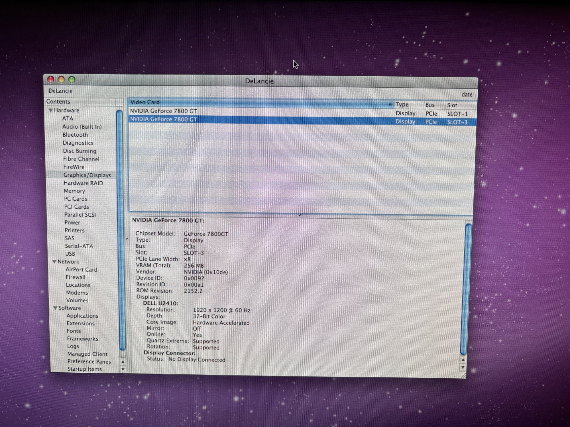

I flashed #26 to my card and sure enough it works superbly. Thank you so much for your diligent work.

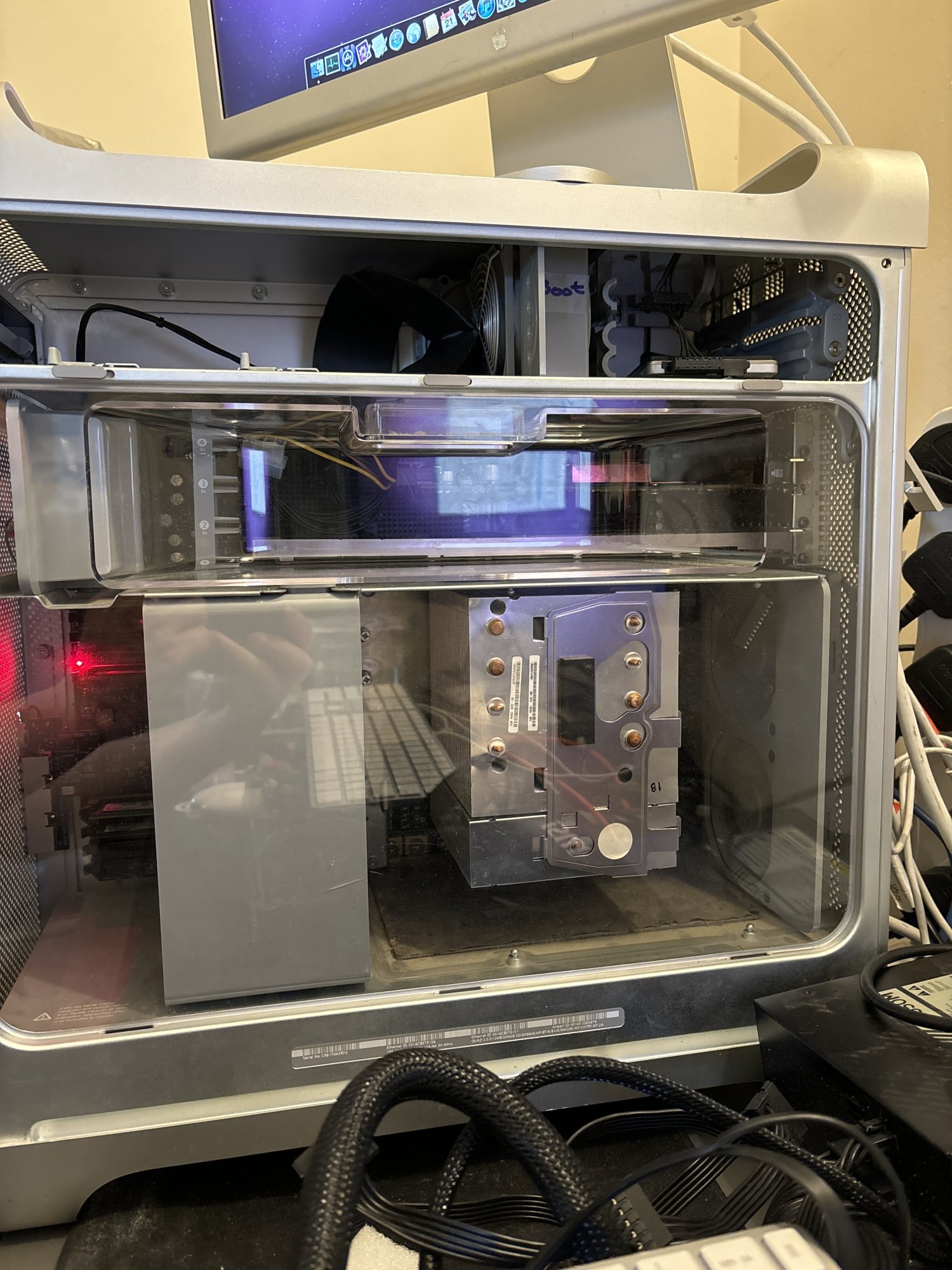

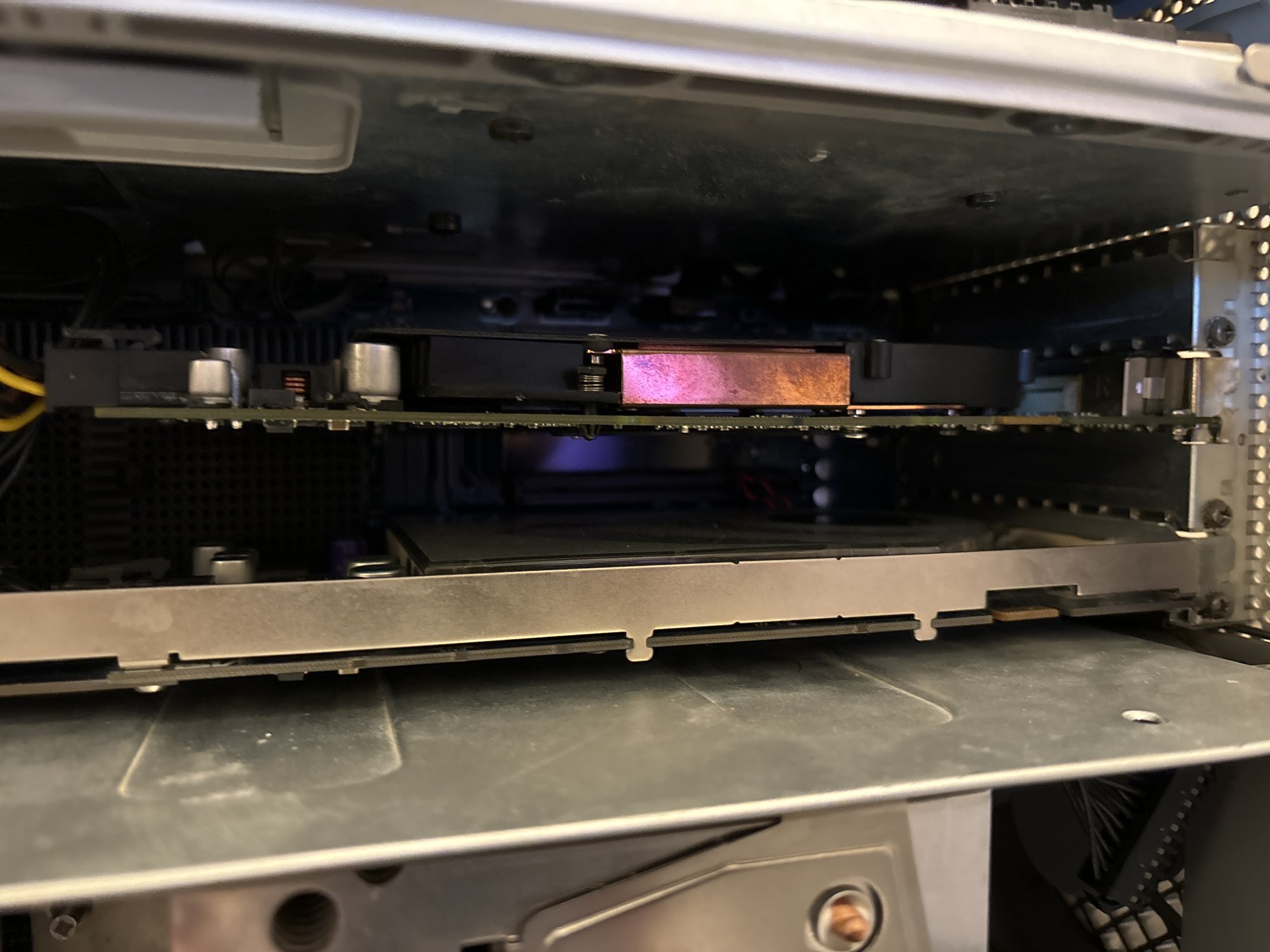

The happy couple in situ

That's correct. The Apple GeForce 7800 GT is purely there because I have it and it makes testing easier.
No I just used the ROM #26 image that joevt provided above. I dumped the PC ROM image before proceeding but we didn't use any parts of it as far as I know.
