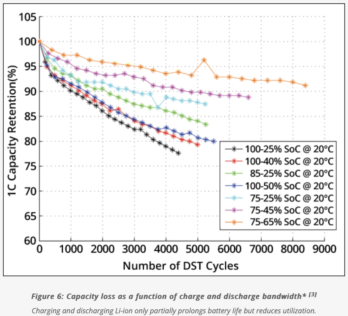

It is very hard to know what the benefits of affecting one of many variables is in such a complex system. Battery University isn't much help because it's just a hodgepodge of information with few truly useful citations. The plots they show don't even come from the same dataset. It's useful for understanding broad behavior patterns of different batteries, but not useful in answering "what changes if I do something specific with a specific battery".
If you take this BU plot, for example:
it says charging to 100% and discharging to 25% give 4000 cycles before reaching the 80% capacity you've been keeping yourself to all along. That's once a day for 10 years. That wouldn't seem worth it. To be clear though, I don't believe this plot applies to the iPhone battery-- which is why knowing what we're talking about matters.
Apple says iPhone 15 will keep 80% for 1000 cycles, or about 3 years of fully discharging if they're using the standard definition of cycle.
For me, that hardly seems worth artificially limiting myself to 80% and having to think about it all the time.

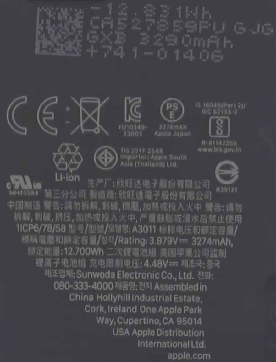

Here's the iPhone 15 battery labelling:
So what are you claiming is the fixed maximum capacity here? This pack is labeled with two (the second being in the small regulatory text after the Chinese for "Rated Capacity"). Or did you mean the charge capacity rather than the power capacity? It also has two values. It claims the charge voltage is limited to 4.48V, which is strikingly high when most of us are familiar with cells that charge to 4.2V. The numerical differences seem small, but capacity to cycle life changes rapidly at the extremes so we can't just say it doesn't matter.

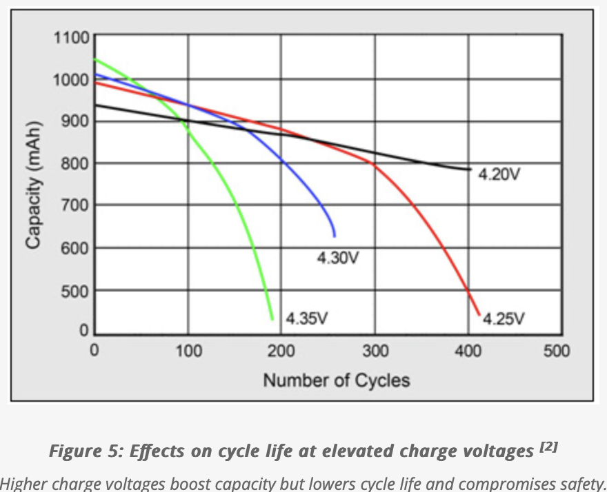

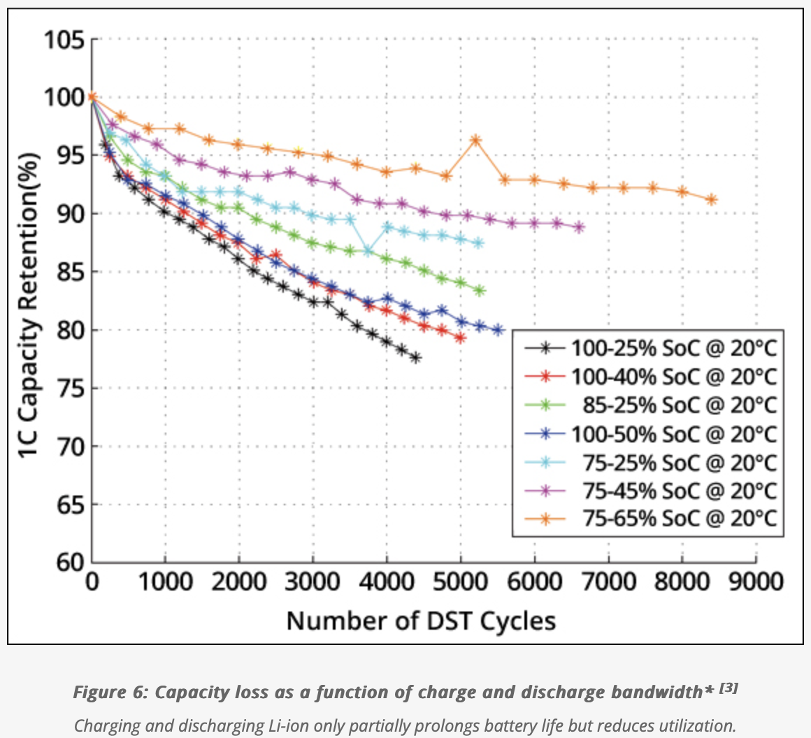

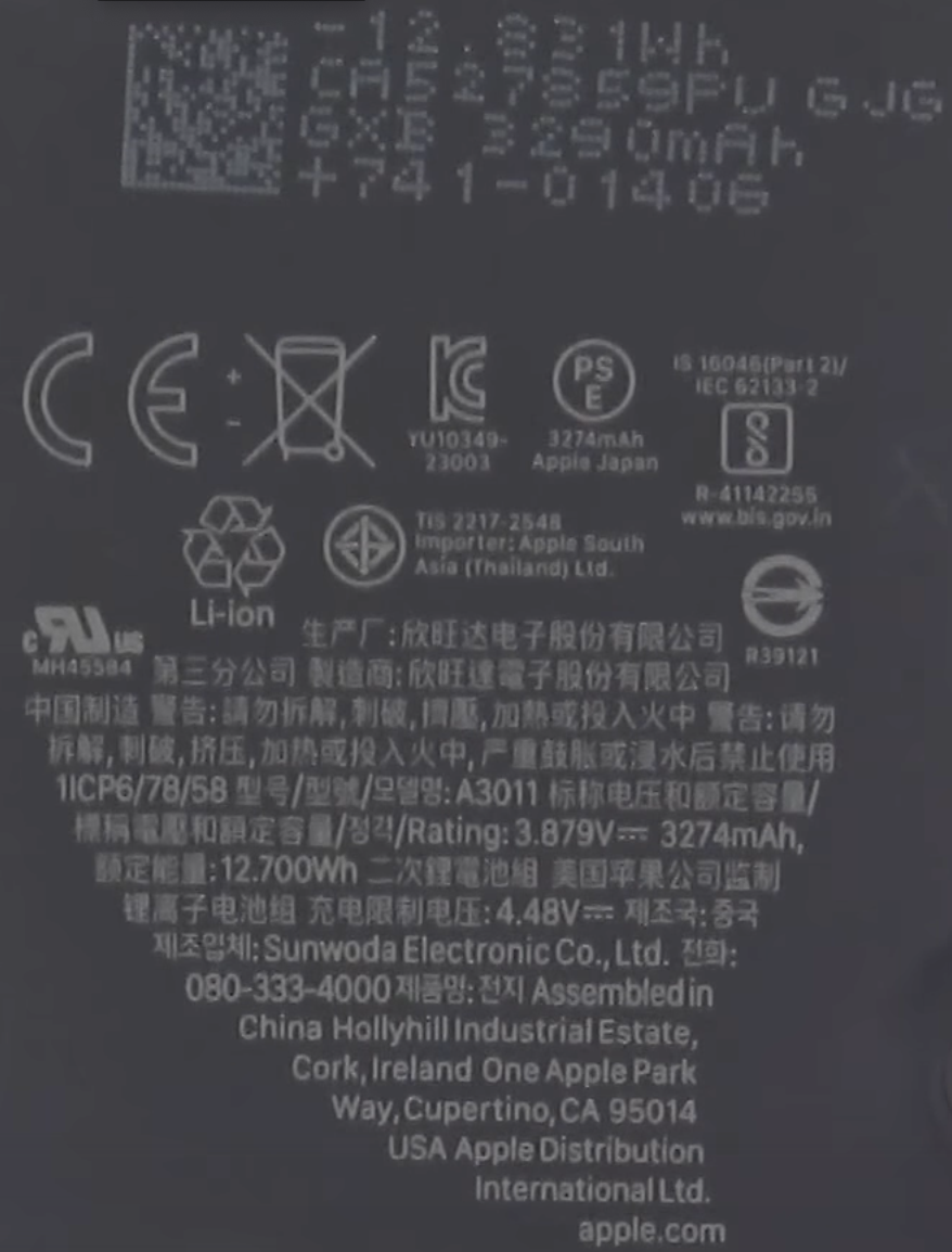

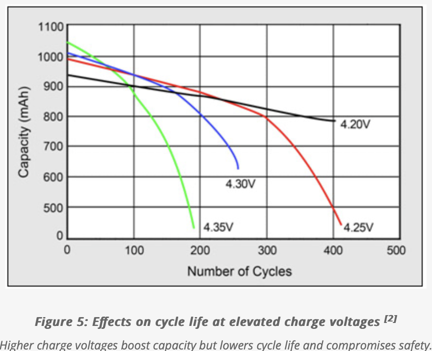

BU will have us believe that charging above 4.2V gives marginally more capacity for rapidly decreasing cycle life.
The cynical view I'm sure someone here would have is that Apple would do this because they want good specs on the data sheet and they make money from battery replacements or phone upgrades-- but if that's true then why did Apple just raise their cycle life from 500 to 1000 cycles?
My guess is that the battery construction and/or chemistry are different. Apple works closely with their suppliers, often on the basic science and research in addition to manufacturing. So to say it's a fact that Apple can't change is simply wrong. It's also wrong to think we can take data from one place and apply it to another without understanding the differences.
