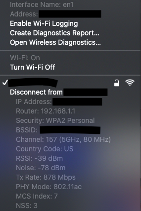

Thanks @troop231 for this hardware update. As soon as I received it a month ago, I brought it to my local Mac repair specialists who removed the stock WiFi hardware and put in this one for a fee as I don't have the required tools. I had to show them the instruction and run it through with the guy who asked "What do I do with the fourth wire? Are you sure it's compatible? You won't have BT!" while I explained that it's built-in as a radio rendering it unnecessary.
In the kid's room, it managed 575Mbps. In the dining where it's closer to the router, it's as shown in the screen cap attached. Router model is Asus RT-AC68AU (N600,AC1300).

Thanks @troop231 for this hardware update. As soon as I received it a month ago, I brought it to my local Mac repair replace specialists who removed the stock WiFi hardware and put in this one for a fee as I don't have the required tools. I had to show them the instruction and run it through with the guy who asked "What do I do with the fourth wire? Are you sure it's compatible? You won't have BT!" while I explained that it's built-in as a radio rendering it unnecessary.

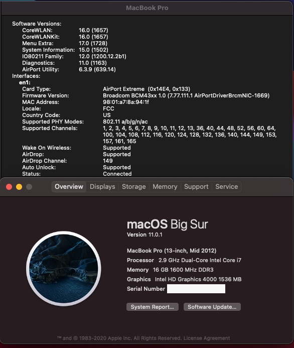

OK so after a few months of research and a lot of patience from my side I finally managed to upgrade my 13' MBP to its limits. The last part was installing Big Sur on the machine which was quite tricky at the start. I had already read lots of similar experiences online and getting FileVault to work was a very common challenge. After a second clean install and a few restarts I finally managed to get that to work too! Running Big Sur on a 2012 MBP has been surprisingly smooth so far and the new Wifi card certainly enhances that experience; for one it is immediately recognised by the software and hence functions like handoff work smoothly. Also my laptop does not seem to struggle when running the new OS which means theoretically you could use it as an everyday computer.
There are however some BIG limitations. Firstly getting FileVault to work can be very tricky and not as straight forward, so unless you don't mind having it turned off (which is a HUGE safety risk if for example your computer is stolen), you'll have to manage to turn it on so you can keep your data safe. Secondly there is obviously no easy update option which means when the next update comes out you'll have to do another clean install and then restore from backup (and there is no guarantee you won't experience issues with FileVault again. Also, so far I have not been able to access safe mode while running Big Sur. Lots of people recommended installing Big Sur together with Catalina so that you can at least access a functional OS in case things go wrong.
I personally installed Big Sur on a separate SSD which I purchased for this reason. Over the next few months I will attempt to see whether this arrangement can work long term, and if it goes wrong I can always switch to the old drive which runs Catalina.
