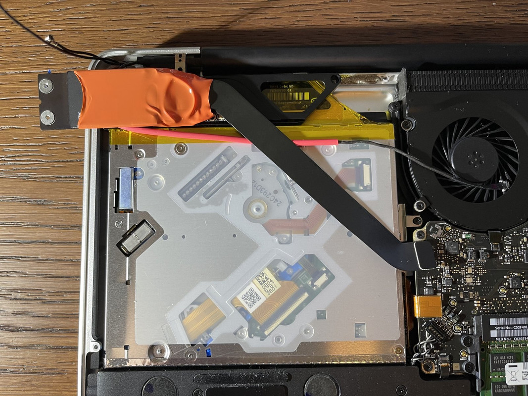

I received my adapter to the US promptly, thank you. But I have run into an issue with my 17" A1297.
I'm trying to install with a BCM943602CDP, but this card is waaaaay too long to install without folding/bending the 30pin cable. You can see in this picture:
Yes, I know you can see the legacy bracket underneath, I was just eyeballing how long a different card would need to be in order to have the same/original placement for the 30pin cable.

I've received support from @jrumball, and realize now that the BCM943602CDP is not supported with his adapter.

By the way, @BeatCrazy , you can cut that card. The extra long don´t have any circuit.

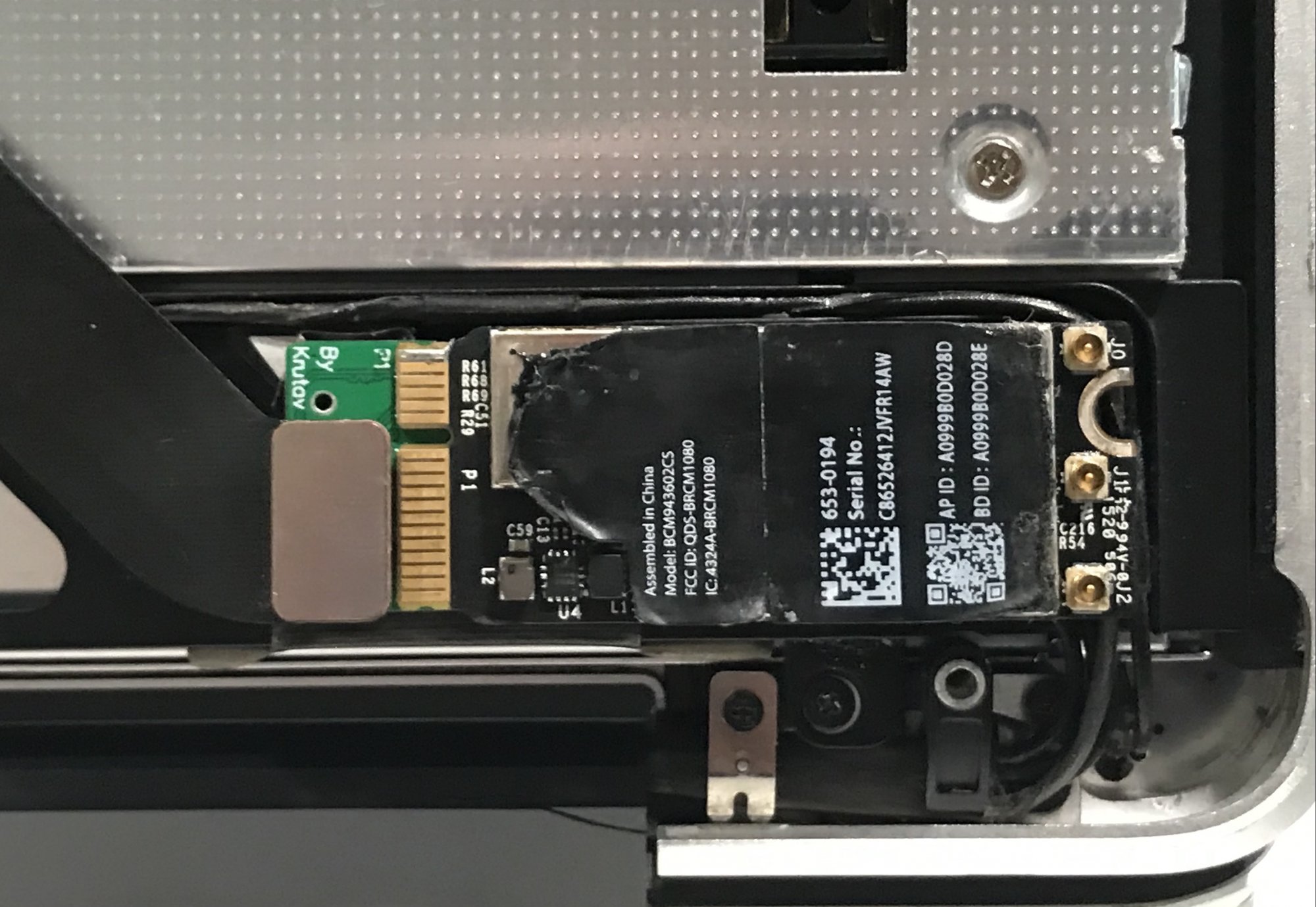

I appreciate the tip about cutting the CDP card. I've already ordered a BCM943602CS, as it was inexpensive at $11.

Glad to report that my $2 open source adapter works great with a new wireless card! It can be downloaded for free from my GitHub and assembled in 30 minutes. BT 4.2 and WiFi AC are working great as well.
