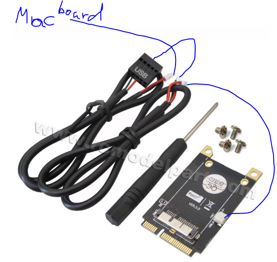

the adapter i bought with 4 TO 2 pin connector,easy to install
[doublepost=1468441172][/doublepost]

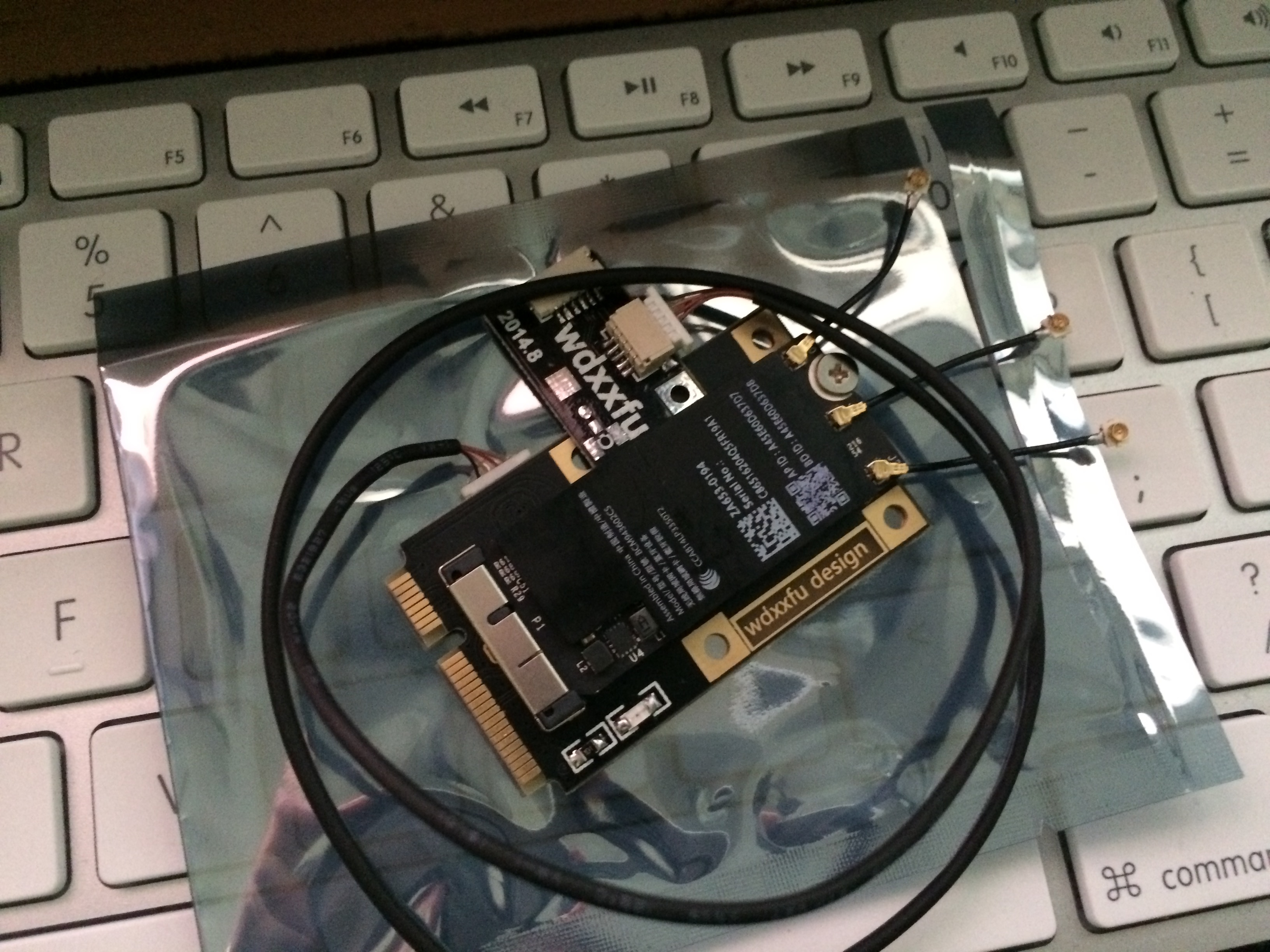

Those who bought this adapter card with the given 2 cables as shown in the picture, I have verified that what xnathanh suggested in his post works. I cut off the usb connector of one cable and connect (red to red, black to black) it to the other end of the other cable. This leaves us with 2 white connector at both end of the merged cable. One end goes to the adapter card, the other goes to the Bluetooth connector on the Mac motherboard.
Both the wifi and Bluetooth are detected by the system.

I installed OSXwifi's Broadcom 802.11ac/BT4 card in MacPro3,1 and the device is working nicely. I swapped #1 and BT cables again. Even then a slight interference seems to pop up when CPU (8-core 3.2 GHz) is heavily loaded but it's not noticeable and doesn't bother me. There is no need to connect a USB cable in 3,1 but I connected #2 cable to port 2 and all four ports are now occupied for this ac card to work. I was taken aback when I first started my Mac and the BT device didn't appear in System Report but turning on the BT in System Preference and a rebooting the machine fixed that.

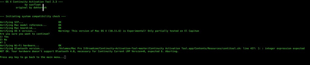

Ok so I have a 2010 3.33 6 core MacPro. I bought the OSWIFI card (http://www.osxwifi.com/apple-broadc...-with-adapter-for-macpro-2009-and-macpro-2010) a year or so ago and after a bit of initial fiddling to get it working, it was stable under Yosemite, both Handoff and Continuity are working.
I did upgrade to El Capitan last week but then realized I'd lost Handoff and Continuity - the latter I use a lot, so I did a fresh install of Yosemite after trying to restore unsuccessfully (seriously messed up preferences) from Superduper. Yosemite is working just fine with Handoff and Continuity.
I have a separate test boot of El Capitan and want to know how/if it is possible to get Handoff & Continuity working.
So far I have tried disabling SIP and replacing the cloudpaird file, not working. I'm expecting that I need to run CAT, but I'm not sure which version, so if someone could point me in the right direction I'd appreciate it.

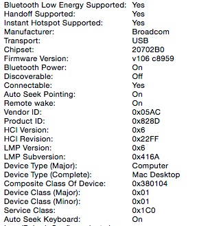

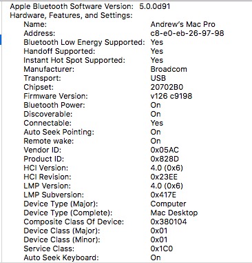

This is what I see in Yosemite:
This is what I see in El Capitan:
TBH, no idea, but the driver in Yosemie and El Capitan may be completely different. And you better contact OSXWifi to ask them if they know any info / solution on this matter.

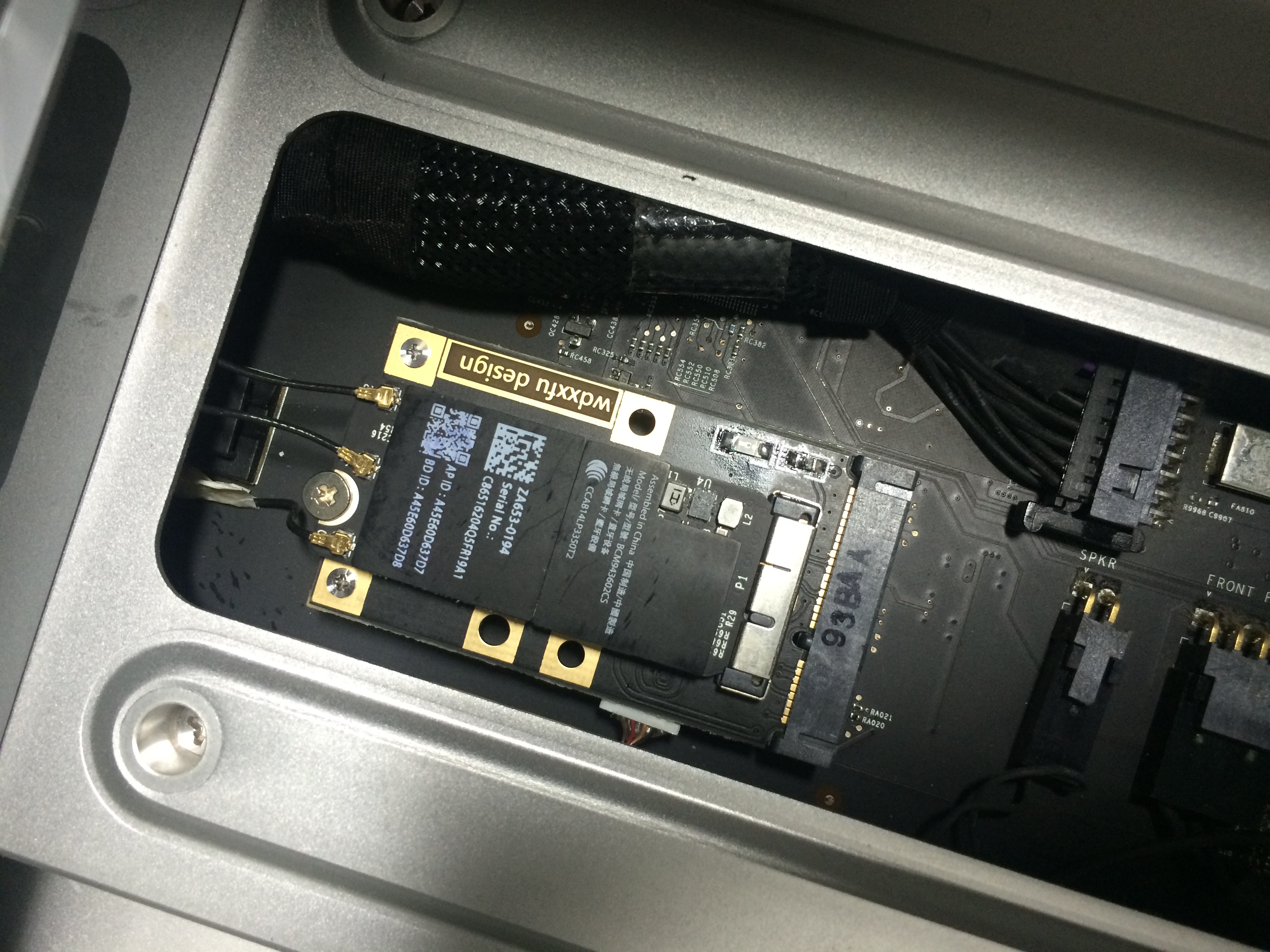

I just upgraded my old MacPro 2009 with this latest AirPort card. No CAT required, just plug & play. So cool! The installation's easier than I thought.
View attachment 650236 View attachment 650237
Thanks for the sharing, you pick the package 2?

I did bought the 2nd Package but I use it for my iMac (A1312). As usual, easy installation and no CAT required.

I am very disappointed with the "support" from OSXWIFI, they have not answered my 3 emails regarding my Broadcom Card not being recognized in El Capitan.
I am totally mystified as CAT can see the Airport card, but isn't recognizing the Bluetooth - it's all one card!!!
Rather than take another gamble and spend on another internal solution, I have just bought a Gmyle dongle from China and hope I can get that working with the help of CAT - will take a month to get here, so in the meantime if anyone has any suggestions on how I might get my internal card working it would very much be appreciated. As El Capitan is a test install I'm willing to try anything!!
