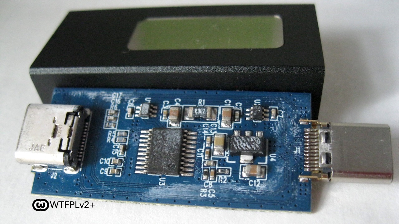

I bought too Plugable USBC-VAMETER; I hope to post a report about it within a week.

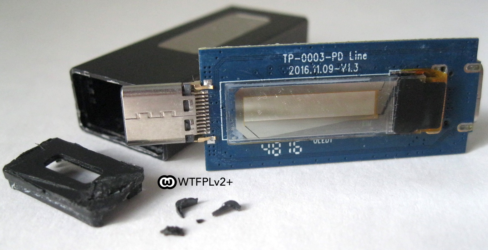

I lied. Even if I would had claimed "next year", it would be a lie. I am not going to write a report nearly as long as that one about Satechi Type-C Power Meter. I do not "quit" due to lack of time; I "quit" because I am not motivated and I do not care. I dislike both Satechi Type-C Power Meter and Plugable USBC-VAMETER. They both flicker, neither seems durable.
Their circuit designs are similar. Between Type-C receptacle and microprocessor, their circuit boards are almost identical. See reference designators, clockwise from left: C9 C10 C15 R4 R5 R6 C16 C17 C6 U1 C3 C4 R1 C1 C2 U2 C7. Plugable USBC-VAMETER main controller (U3) is STMicroelectronics STM8S003F3 (package marked 8S003F3P6). Like Satechi, Plugable shunt resistance is nominal two milliohm (2 mΩ, mark code R002). Both units emit faint high-pitched noise. (It is very faint, not likely to be noticed in any but a silent room.)
If wanted to own one of them, then I would choose Plugable USBC-VAMETER. It is slightly more intelligent than Satechi's: Plugable's does not display an arrow when measured current is zero, and its measurements are rounded to three hundredths. (So Plugable might display 1.93A and 1.96A while Satechi display 1.92A 1.93A 1.94A 1.95A 1.96A 1.97A.) Plugable's receptacle is anchored to circuit board at its four corners, making it more durable than Satechi's; its C plug is not well braced, just like Satechi's. My specimen was assembled with cyanoacrylate (SUPER GLUE); its vapours coated the whole circuit assembly. After cleaning, its screen display is appreciably brighter.
