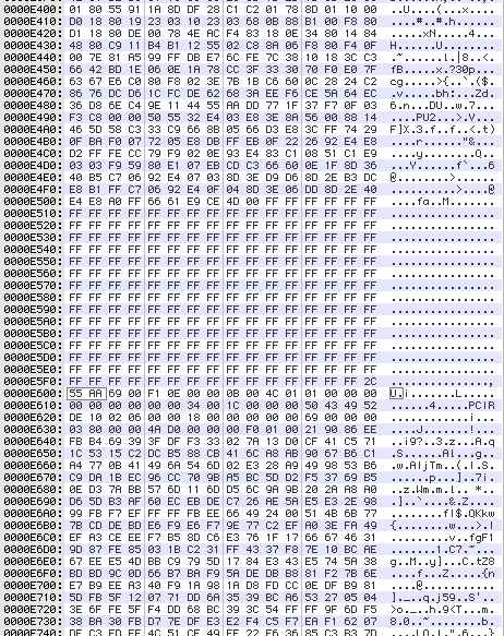

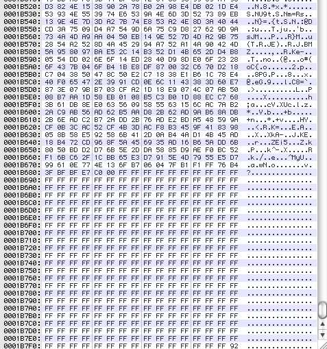

What we NEED is to do the same thing Pipolomo42 did fro 4870 .....move the PC BIOS into the Mac ROM, replacing the 8800GT PC BIOS but correcting for this insertion.
Could open up ALOT of cards to work on Macs if we figured this out.
Are the efi start and end flags the same on the 8800gt rom? If so I'll probably try exactly the same process that pimpolomo42 did and hope for the best... At the least, I found a purpose for my old pc.. testing and dumping roms...

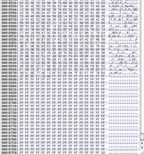

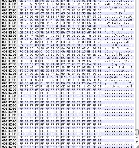

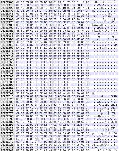

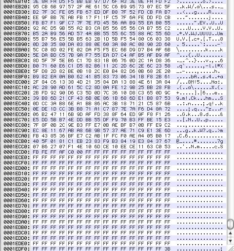

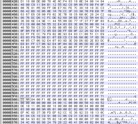

I show the place in the ROM where the PC BIOS ends and the EFI starts. The second device ROM starts with a "55AA" just as the first one does. All of the "FFF"s are place fillers, which must be counted for, I believe.
Note the third line down at begining of both Mac EFI ROMs...The 64bit one is "de101106" and the EFI32 one is "de100206". These are the different device id of these cards. There is supposedley a device id 602 ROM for 64bit cards, it would be great to get ahold of it too.
These are from the EFI32 and the EFI 64.
The end shots are just that, the end of the ROM.
