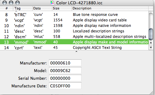

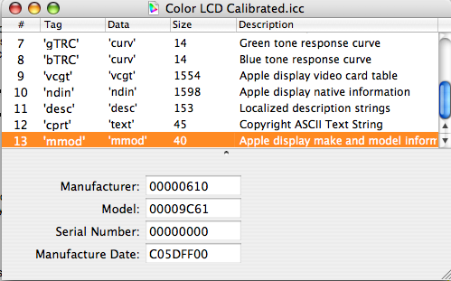

I just remembered I did this screen shot a while back, my manufacturer number is 0610
My manufacturer is 0610 also, and my screen is the 9C61 version. Either the manufacturer code is meaningless or AU Optronics makes both the 9C60 and the 9C61 screens. Perhaps others can verify this.
Another explanation could be that the 9C61 is the new and improved screen that an earlier poster in this thread was talking about.

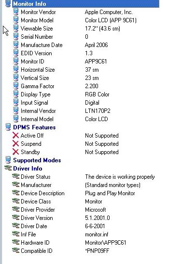

For whatever help it might be this is the Astra report on my 17" MacBook Pro C2D. The screen is a glossy screen.
The info looked a bit thin but it turns out to be a Samsung panel.
It looks like the 9C61 screen has been found. Thanks for the legwork. Nice that it's Samsung who makes it...
So we know it's 6-bit. Notice the response time, though? 25 ms. :(
All the claims that Apple chooses 6-bit panels so they can get fast response times are pure hooey. The panel is SLOW. So much for gaming or watching movies without ghosting. This ought to put to rest the stupid idea that 6 bit TN panels are faster than 8-bit SIPS panels. Nonsense.
